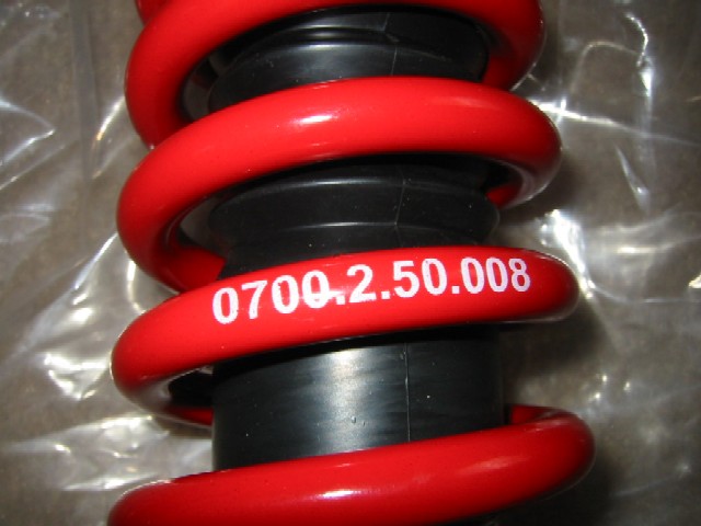

And the other one:
Name:	rear coilover - smaller.jpg

More Numbers:
Name:	rear numbers - smaller.jpg

it looks like u got the right ones and slammed got the wrong rears..........where did u order them from ?

I ordered from Urban Import, No problem. Arrived on Thursday, so these are the correct ones:
0700.2.50.008 & 0530.2.50.010 ???

The ones that are NOT mine. They start with 4 #s instead of 2.

We don't know yet. We are waiting for UrbanImport to tell us that.

OK talked to Hayame this morning. They are trying to get ahold of the factory to see which is the correct part # for the rear as they don't have any instock to cross reference. As soon as they find out what the correct part # is they are ordering a bunch of them so we can take care of any people who might have received the incorrect rears. On behalf of Hayame I apologize for the trouble this has caused.
