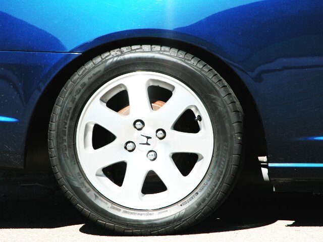

Rear...
It took a while for the rear to settle. It was actually a bit higher.
Time to raise the front a bit. The front is now lower than my GCs and it makes the profile of the tire look weird. I've come to the realization that the lower profile your tires are, the better your car will look even lower.

^^those look really good. Why do you want to go any lower on the rear??
To even it out with the front?
At any rate, I said before that these springs take a long time to settle and now, I have a small finger gap in the rear. The car just seemed to get lower and lower all around, which ended up being a bad thing. Now I'm too low.
I don't recommend going this low because:
1. It will destroy your front fender molding(s) - exposing your headlight wiring harness and wiper fluid.
2. It might even hit the top fenders
3. The struts will be at their limit - although the ride doesn't get worse, the struts will begin to bottom out - this is all around, too.
I'm going to raise the FRONT (sorry, edit) a bit and give the rear more preload since it's quite soft. The rear could also use some negative camber since I seem to have the rear tire hitting the wheel well. I didn't have that issue before my accident. I got a shitty alignment.

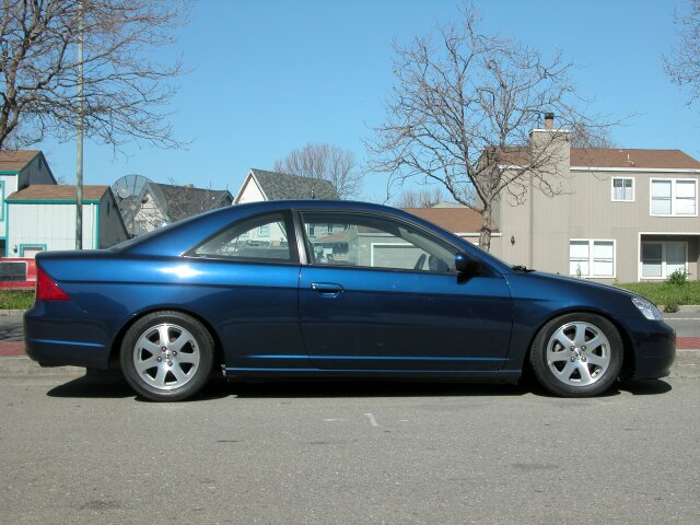

Originally posted by BlackSI
can I see some pics of it from a distance fully lowered on hayame? just to get an idea?

Originally posted by SlammedBlueEM2
Now I'm too low.
how dare you say that.. no such thing... haha j/p.. ya i'm only at 2.5" and blah i already scrape at work... its not even my front that scrapes, its my mid pipe.

LOL. My midpipe looks bad... the entire mid-pipe used to always scrape when I had GCs and I think it still does. Other than that, the muffler has taken abuse, too.
"If you ain't scrapin, you ain't low enough."

Originally posted by cdub604
hows the ride w it dumped all the way? its gotta b better than stock shocks and cut race springs lol...
Well, it is better than stock shocks and any lowering spring but the struts bottom out in the front and it hits the upper wheel well (expect the molding to rip off your car.) All in all, you don't want to go that low. You won't even be able to turn fast at that height because there's very little shock travel - it's too low.
Which is why I mentioned the front needs to go a bit higher but not by much just for daily driving.
slammed, that's a perfect drop in the rear. i want mine to look like that (maybe a tad higher) but i have an ugly gap because of a good amount of preload. i assume you have the height set at the lowest point?
The height is at it's lowest all around. It needs preload. If it raises the car, then I guess I won't be slammed for a while.
And I'll say it again for the 3rd time, it takes a LONG time for the height to actually settle.
