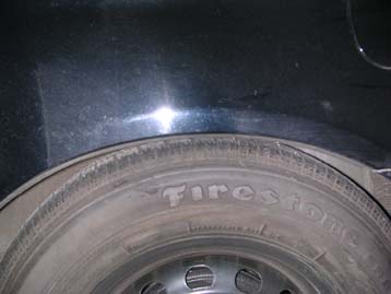

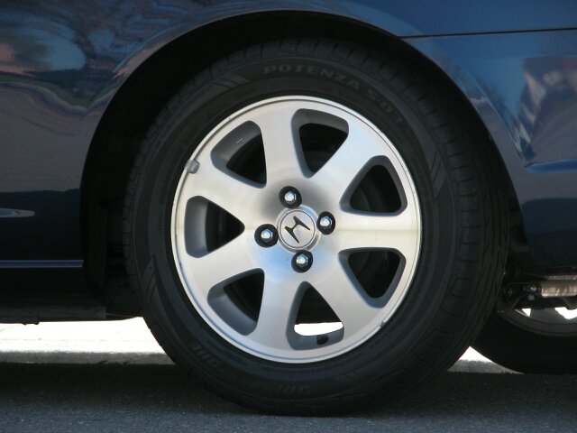

Rep Power: 417
Gap

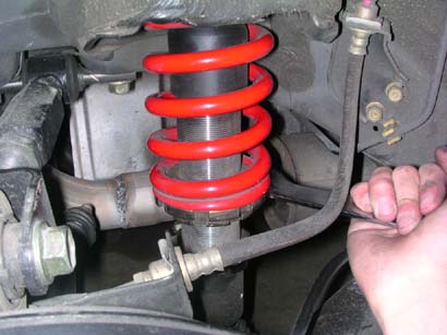

I can still go about 1" lower if i took off the preload

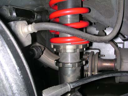

Rep Power: 417
Ignore: Raise it by turning the 2nd locknut counter-clockwise

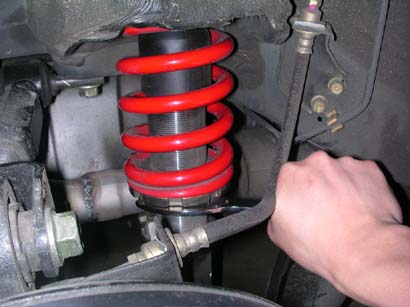

Rep Power: 417
Ignore: Lower by turning the 1st locknut clockwise

I basically have no gap. Well you can say i have like .1-.3in depending on the angle you look at it(I also have my fenders rolled slightly) but its basically none. I also have subs in the back that lower its slightly as well(i'll take them out and take pictures tomorrow, too tired right now). Slammed also has tires that have .16in less gap. Not sure if this adds up to the difference

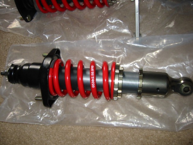

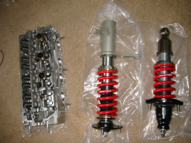

OK, so here is what I have:
Should I not put these on, due to some wrong part number thing?
That is also a pic of my DH-Racing Ported Head, just arrived & I couldn't resist. Still waiting on my new CAM & built block before I install it. But I wanted to put the coilovers on, without problems obviously, so do I have the right ones?
Name:	coilovers & ported head - smaller.jpg
