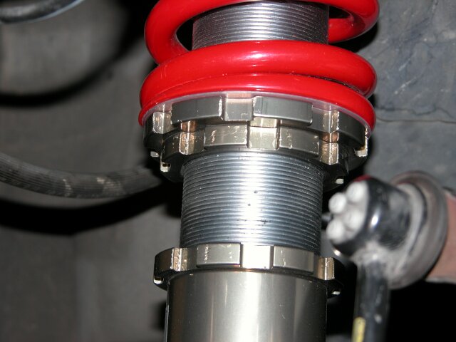

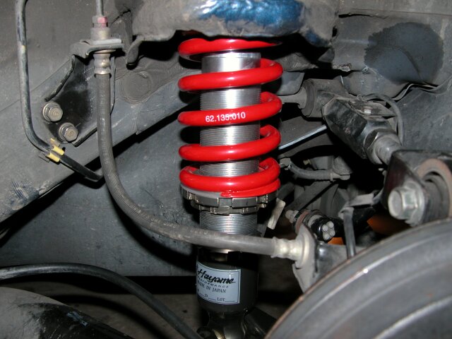

I can't figure out what's wrong... did you (UrbanImport) send out the wrong rear shocks? Someone or Hayame has got some explaining to do.
This is what my rear looks like - keep in mind, it's now at stock height in the REAR.
Also notice the missing dust boot. There's VERY little preload set.

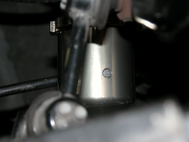

At stock height in the rear and the threads are already passed the hole in the lower perch. I only have about 1 inch left to lower.

I dunno if this would be relevant or not, but there's really not a lot of preload set.
