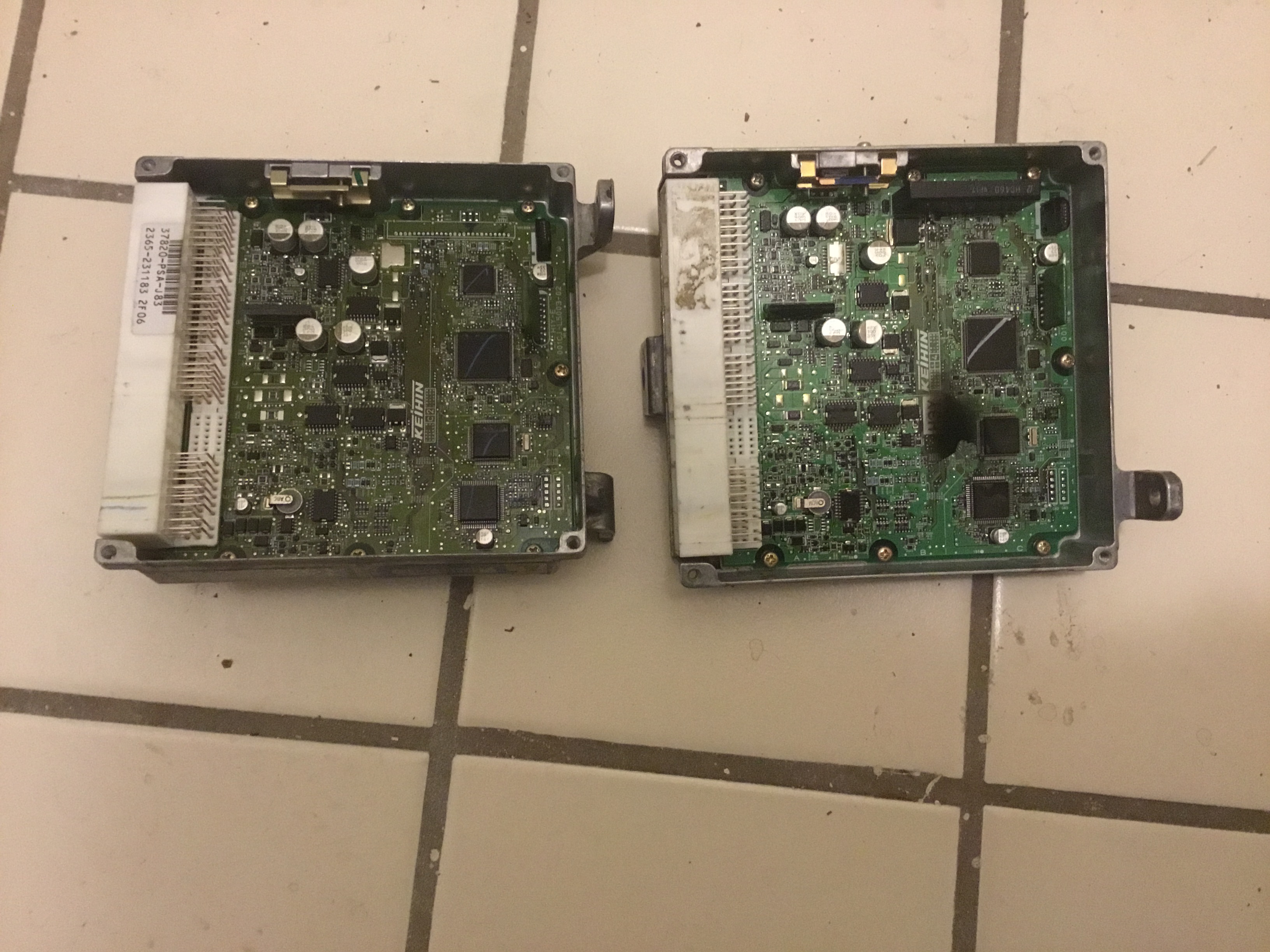

Info about installing a JDM PCM in a USDM car
So I spent $15 on a JDM PCM, part number 37820-PSA-J83, and I don't regret it. I plugged it in and turned the key, but I was sure it wouldn't start since the green key light was flashing. But to my amazement, it started! I was shocked! I literally have no idea how it started. But then it died about 5 seconds later... I could tell by the way that it died that it ran out of fuel. So I manually powered the fuel pump, and it started right up and ran! I drove it down the street and back, and it ran perfect! I scanned it for codes, and it has a P1713, as well as a P0135, and P1253 because I didn't hook up VTEC yet. Those are the only codes it didn't have before though. I am still not sure about why it's setting a P1713 or P0135, but I will definitely report back when I have more information!
UPDATE: I hooked up the VTEC system correctly, and now the only unresolved codes I have is P0135, as well as P1713 if I put the shifter in 2. Not sure about those codes, I'll have to investigate further.

Re: Info about installing a JDM PCM in a USDM car
Here's a picture of both PCMs side by side: (The JDM is on the left, the burned USDM is on the right.)

The other thing I forgot to mention is that the case of the PCM is physically different, as you can probably see in the picture. I think it’s because JDM cars have the drivers seat on the right side of the car. So I think I am going to put the circuit board from the JDM PCM into the case for my USDM PCM, since the mounting holes don’t line up.

so what's actually fried on the old one? did a trace burn off the board? a component melt? got a better carnage pic?
I think a trace burned. I’ll get a better picture when I get home. I’ll take the circuit board out and get a picture from the back too. I wasn’t too focused on the burn mark when I took that picture, I was more focused on getting a side by side JDM vs USDM PCM picture. There are quite a few differences, as you can see.

Re: High RPM on the highway
UPDATE: It was the PCM. I replaced it, and the trans shifts perfectly now. Thank you to everyone who helped!

Can you 'feel' any difference in performance with the JDM pcm?
Yes. It seems to perform a bit better with the JDM PCM, especially at low RPMs. Here’s the details: https://www.civicforums.com/forums/1...ml#post4745327
