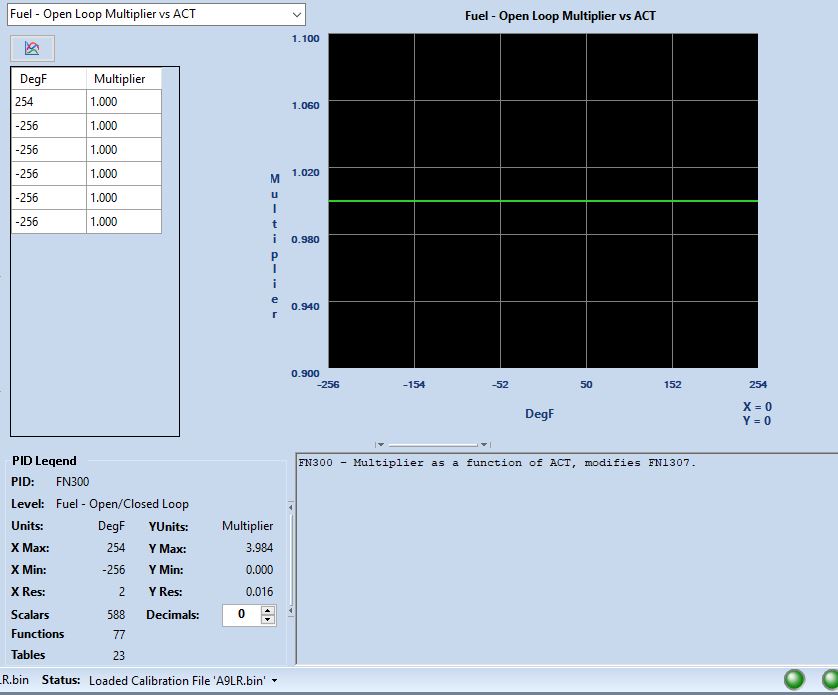

Re: Can I use my AC for more power?
more fuel? ... are you sure about that? o2's should keep that inline. on mine Air Charge Temp effects timing quite a bit:
but ACT does not effect my fueling(unless i change something):
ECT effects fueling. mostly to help with startup enrichment, or to cool the motor when temps get too high. ...but not ACT. i think people mix them up
i'm playing with 1992 ford stuff though, maybe a honda is different/smarter

Last I knew, the IAT told the computer the air temp so it knows how much fuel the engine needs. Colder air is denser, so it needs more fuel. I don’t know if it effects the ignition timing. I think if the intake air reads above a certain temp, the ECU pulls timing so the engine doesn’t detonate.
