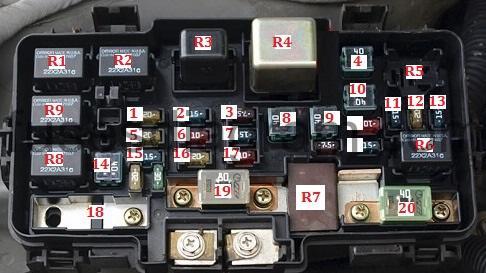

What size fuse do I need?
About a year ago, I put my battery in the trunk. It’s an Optima Yellowtop D34 if it matters, and I used 2 gauge copper welding wire. It just occurred to me that I probably should have a fuse on one of the battery cables for safety. But I’m not sure what amperage fuse I would need. So what amperage fuse do I need? I am thinking I will put my amp clamp around one of the battery cables and measure the amperage the starter draws while someone is cranking the engine, and get a fuse a little larger than the amperage the car pulls from the battery when its cranking. Is that a good idea? Thanks.

Re: What size fuse do I need?
What was the factory fuse size for the main fuse and the starter? Use that.
You mean fuse 19 on this picture? If so, it’s an 80 amp.
There you go

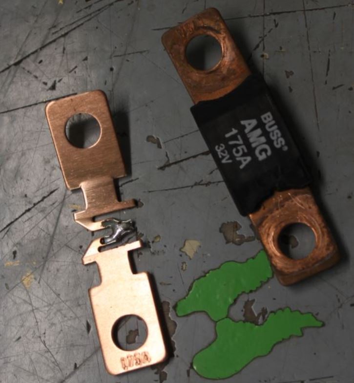

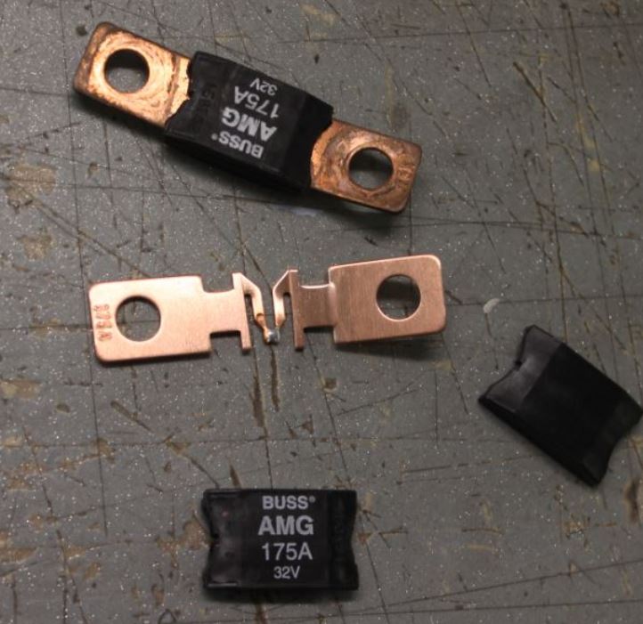

did you ever see the inside of a MEGA fuse?
all that 2awg welding cable, bottlenecked into this:

i usually add a bit of solder to at least help widen the bottleneck. solder has such a low melting point that i doubt it increases the amperage rating much. just makes me sleep better because these things keep me up at night.

a better option than an 80A fuse would be 100A, due to the length and thickness of the cable. my wire size chart lists 95-115 as the correct size for 2awg wiring. a 100A circuit breaker would be better yet if you can swing it. you'll be able to reset it and it'll have a bit more of a path for your electric to flow vs than what you see inside the fuse.
Cranking amperage will blow those fuses in a heartbeat.
Attachment 112160
Attachment 112161
i actually had the one pictured on my mustang for a few years without it blowing, which suprised me.. it's supposedly a "slow blow" so maybe that helps? when i relocated the battery to the trunk(since in a rwd drag car) i was terrified to just have a thick power cable from a 600a battery running to the front. the car is shakey and violent so over time everything either chafes, loosens, or just falls off. the wimpy fuse was the best do on short notice
Your solder blob upped the amperage capacity of the fuse significantly higher than the stamped rating.
It's not about the melting point of the solder, (because now your solder is effectively a shunt)...... it's about the amount of current that can flow through it (the critical part of the fuse PLUS the solder glob) before it gets hot enough to melt both parts and open the circuit.
You are completely correct.
