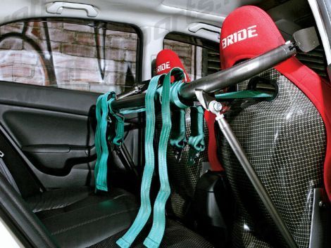

What will help is a tie bar between the seat belt top mounts.
Even more so if you're running no rear seats then you can run a bar between the seat belt mounts and then an x frame to where the rear seats used to be.

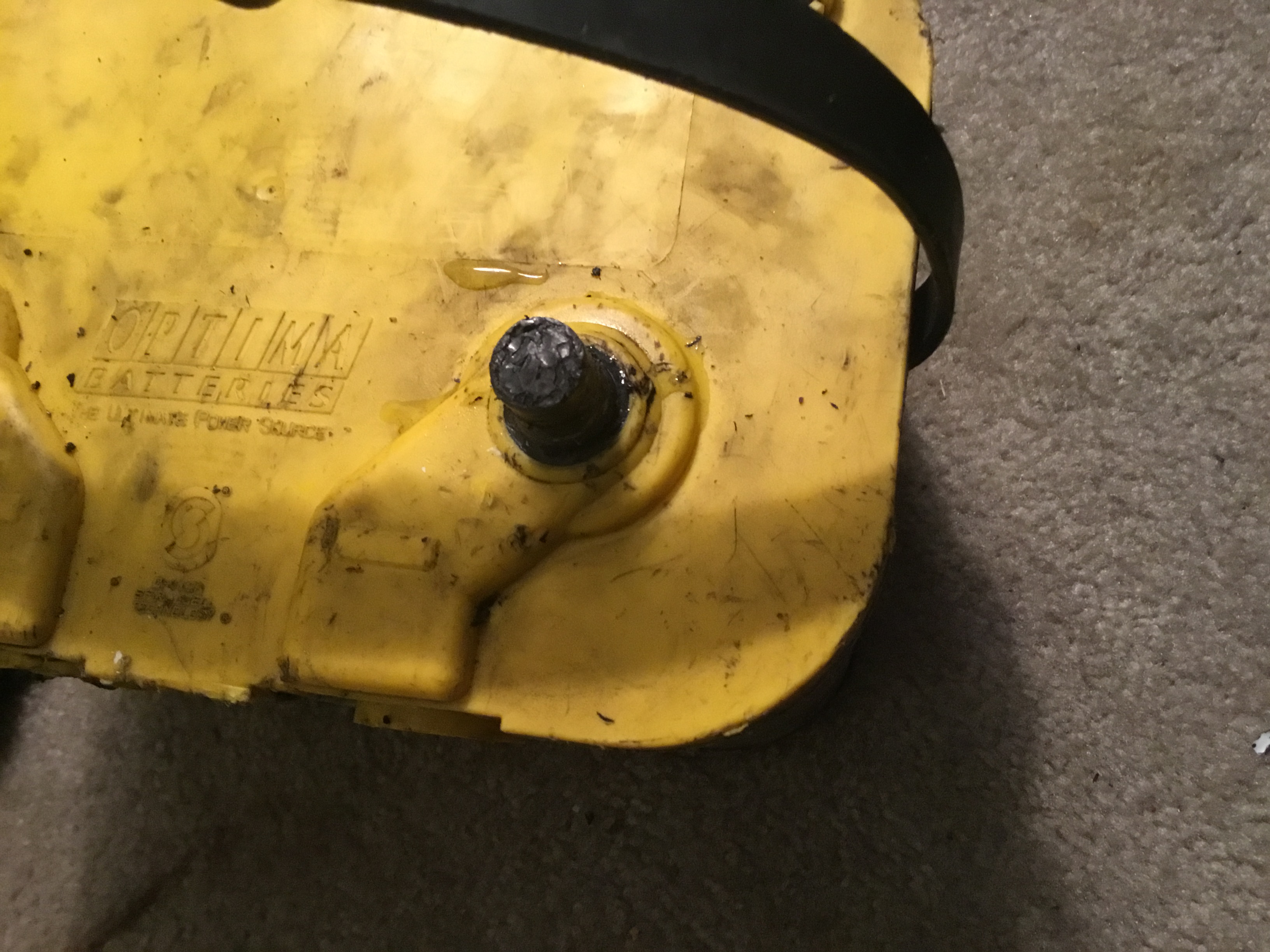

Can AGM batteries leak acid?
I noticed a small amount of clear liquid by the negative terminal on my Optima Yellow Top D34 battery. I don't see how water would get there since it's mounted in my trunk, but I don't see how acid could leak out of an AGM battery either. The battery is from 2007, but it still works fine. I recently had it tested, and it tested at above its CCA specs. I wiped the liquid off and tilted the battery and nothing leaked out. Do I need to worry about this? Thanks.

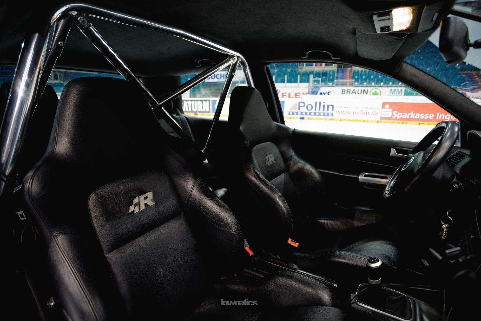

They are known sometimes as "seat belt bars" or "harness bars". I'm not sure if there is a company who makes them for 01-05 civics. I've seen them for EP3s (type r), DC5s (rsx) and older EG civics.
there are also c pillar x braces, but these mount in the rear, not off of the seat belt posts. With how the em2 is made I don't think this would be as effective as it is in hatchbacks.
Then you have half cage roll bars.

Re: Can AGM batteries leak acid?
It was probably just condensation. Heat can build up inside the battery and when it escapes it hits cooler air and condensates. If it tested good then no need to worry.
Ok, thanks. I guess if it does it again, I could sprinkle baking soda on it and see if it bubbles. I'm not sure if it's even possible for an AGM battery to leak. But yea, the battery tested good, so I'm not too worried. I don't remember the numbers, but the CCA tested at well over what the battery was advertised at.
Sure they can leak acid. AGM part just reduces chance lead plates break free and short out.
I thought the acid was absorbed in a spongy material, so therefore it can't really leak?
UPDATE: Apparently AGM batteries can leak acid. It did it again, so I put a pinch of baking soda on the liquid to test it, and it's acid. I think it's broke after 11 years. I cleaned around the terminal and smeared silicone around it to try to seal it. Hopefully it quits leaking.
