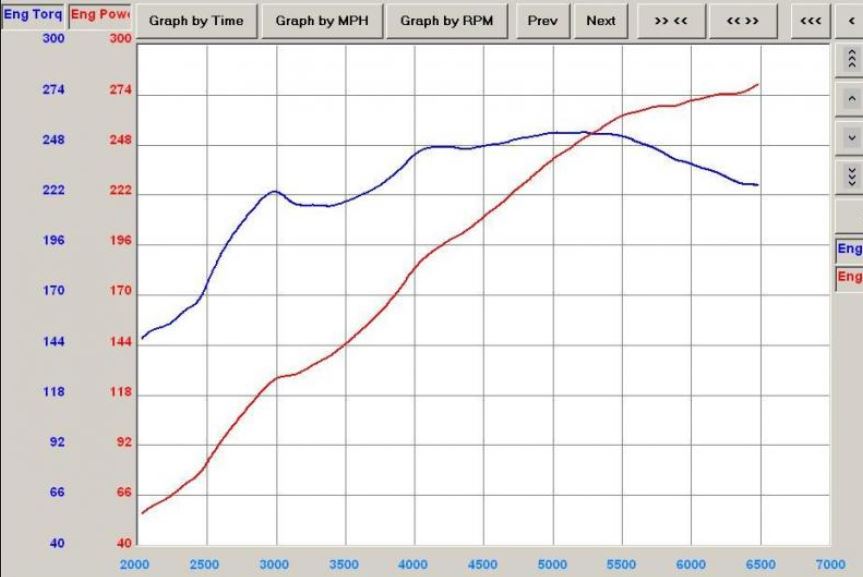

i'll take a shot at it.
on a 4cyl, the HP and TQ is pretty low at 2000 rpm compared to 2500rpm. because of this the 500 rpm drop, engine load to maintain speed will increase(lugging). it will require more air, fuel, and a higher throttle position to maintain speed
notice how much the graph climbs in that 500 rpm
random 2012 civic turbo dyno just for illustration purposes

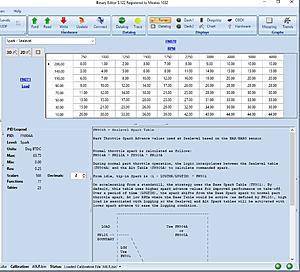

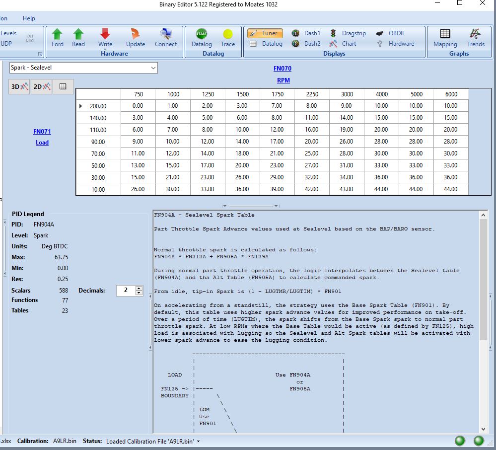

this is a screen grab showing how i have adjusted the spark table on my mustang.
notice how as load increases, spark decreases. if that 500rpm drop causes your load to increase from 10% to 30% to maintain speed, you're squirting more fuel and losing 10° of timing. you also must realize that the wasted energy spinning the oil pump, water pump, P/S pump, alternator, trans fluid pump, etc 500 measly rpm at 2500 is not causing a loss you could ever measure. if you deleted the spinning the oil pump, water pump, P/S pump, alternator, trans fluid pump, etc from the equation at 6500rpm you might free up what like 10hp? so at 2500 rpm vs 2000 rpm, the (maybe) 0.25hp difference is more than offset by the increased load.
personally i feel that some of the ecomodder crowd is a bit nuts, lies, etc, and that if your car would get better MPG at highway speed with the taller gear, honda would have built it that way. they are smarter than us. lowering the car a bit, lowering the front air dam, and adding more air to the tires would net you more economy. IMO. they post 80 mpg but at what cost? tailgating semi's, coasting and shutting off the car, rolling the last 400' at the grocery store with no power brakes before parking, etc.
besides, you deleted power steering already, so you should scratch that off the list. a power steering delete on my 92 mustang would only add 4hp at 6250 rpm and deleting the AC was not even measureable. i looked into it in my quest for speed

Great explanation, thank you. I agree that there will be increased load on the engine cruising at a lower RPM. However, I disagree that Honda would have put in a taller 4th gear if it would improve MPG. Efficiency isn’t their only concern. With such a weak engine to start with, most people probably wouldn’t be happy with throttle response if 4th gear was geared taller, among other things. I also disagree that losses from overcoming internal friction and spinning accessories isn’t significant. Just removing the alternator can improve gas mileage 5-10%. I’ve tested it. If you don’t believe that the load of the alternator is significant, just turn on your headlights at idle. You can hear the idle change from the headlights. Also, the power steering pump is a significant load too. I saw over a 1 MPG improvement in my gas mileage when I took my power steering system out. No idea how much power the oil and water pumps draw, but it’s probably measurable. As for the effect that internal friction has on fuel consumption, it’s quite significant. Even with the spark plugs out, turning the engine over takes a noticible amount of torque just from internal friction. I’ve heard that 20-30% of the fuel an engine uses is used to overcome internal friction, and I believe it. I agree that running higher pressure in the tires and lowering the car will improve mileage. I’ve done both of those things, and it did help slightly.
