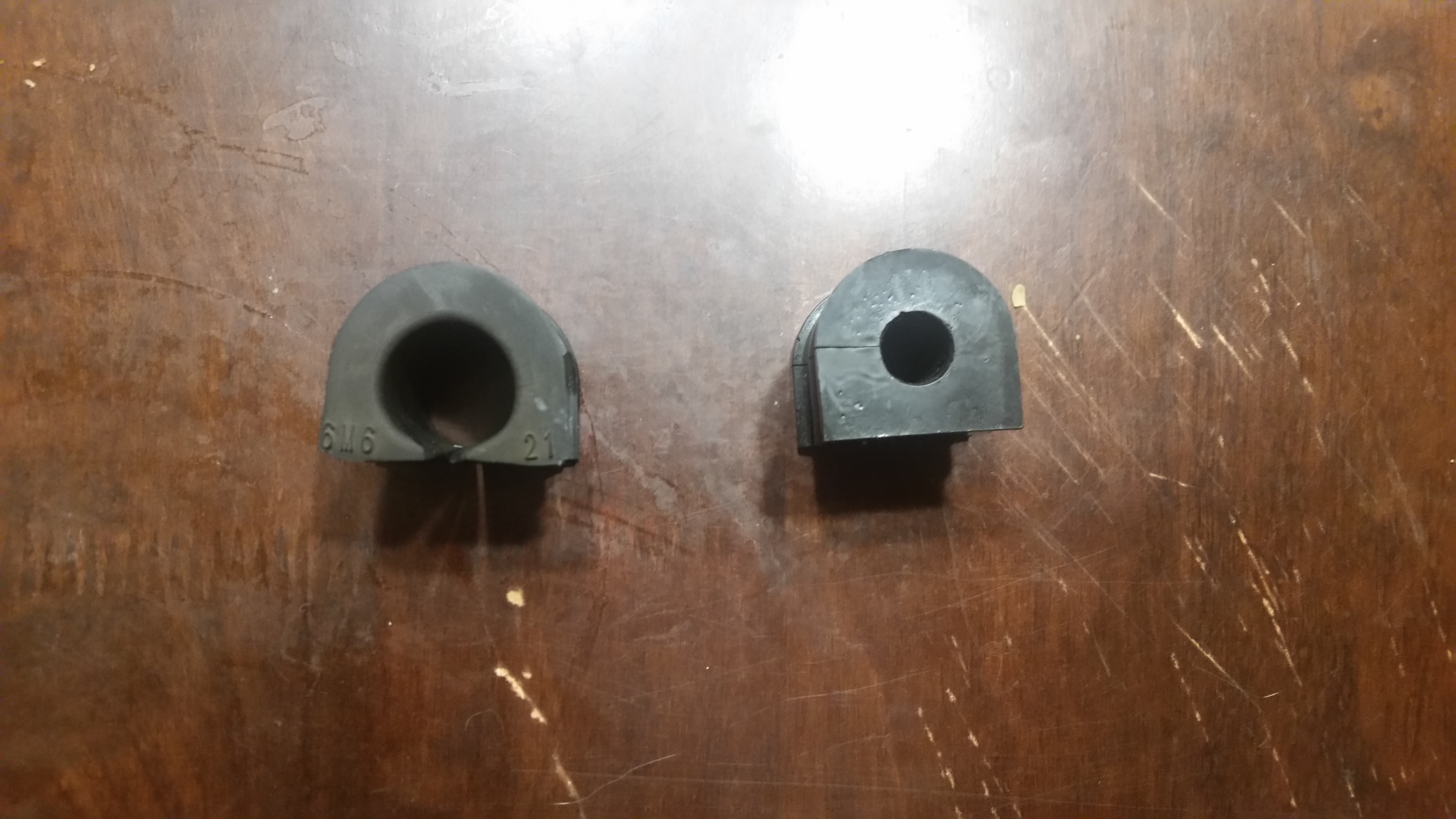

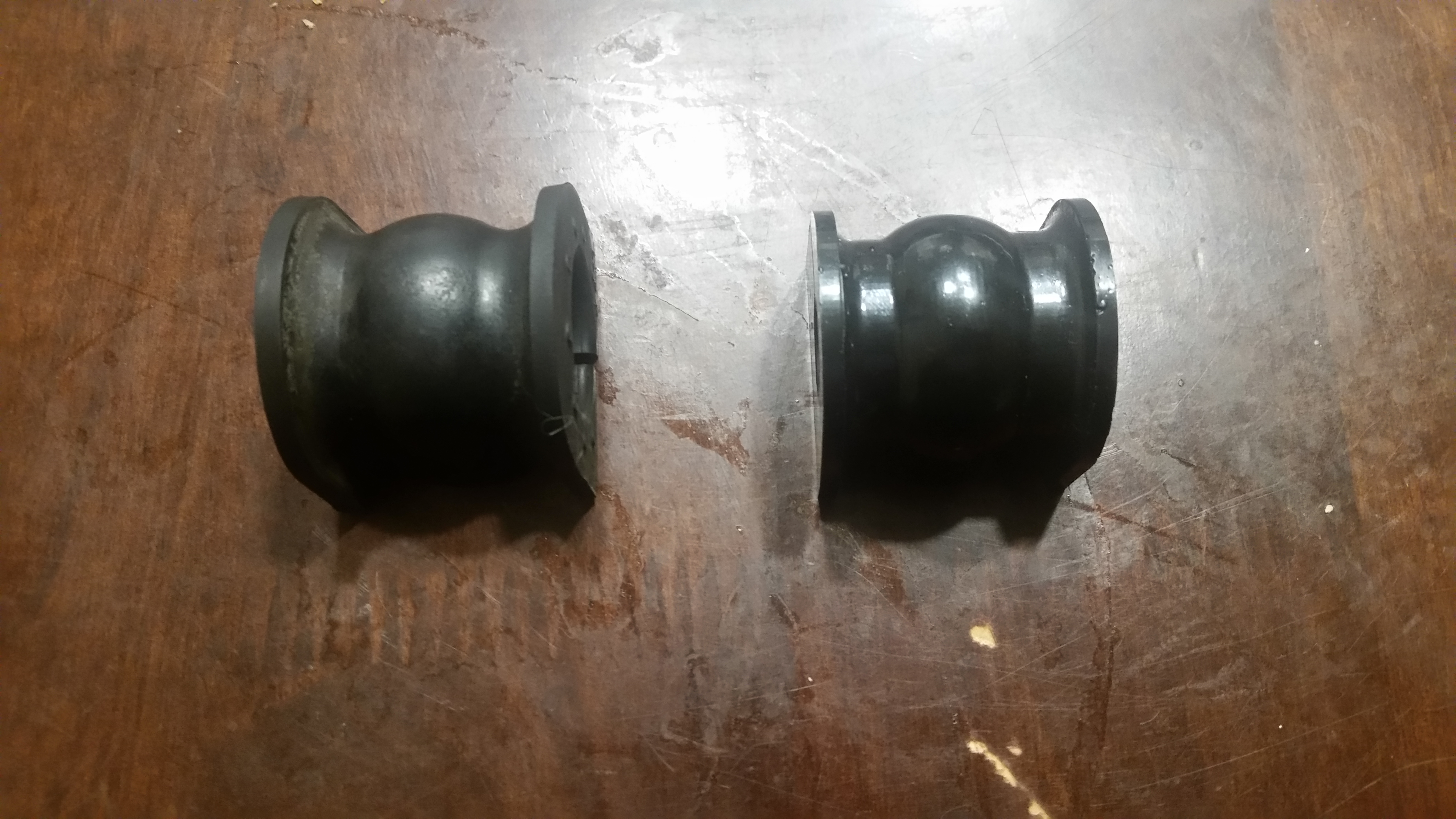

Rubber vs. poly bushings- A durability experiment
I was curious about the durability and longevity of polyurethane vs. rubber bushings, so I came up with a couple of tests. Here are the "before test" pictures of each sway bar bushing after being used for 2-3 years. After cleaning both bushings off with soapy water, the poly bushing shows no signs of wear, but the rubber bushing shows slight signs of wear. It has a few cracks, but nothing too bad. The next test, however, will simulate an oil leak or spilled oil that drips onto the bushings. What I did is I sprayed both bushings with motor oil to see if either one deteriorates. I am re spraying every day for a week to see what happens. I'll post back in a week or so with the results

Re: Rubber vs. poly bushings- A durability experiment
Is the oil you are using to the coat bushings at ambient temp or engine operating temp?
