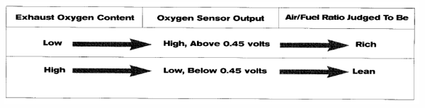

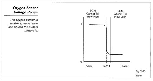

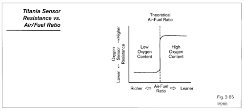

I always wondered what effect the o2 sensor oscillating between rich and lean has on
An O2 sensor, by design, has to act the way it does. An O2 sensor can only detect when the oxygen content is above or below its designed threshold, and its voltage switching point (typically 0.450v) reflects that.
The PCM constantly tweaks AFR to keep the O2 sensor switching (as long as the PCM wants the mix at stoich), because that's the only way it can control the AFR in CL.
[img]https://cimg0.ibsrv.net/gimg/www.civicforums.com-vbulletin/600x153/80-af_sensor4_052b6d85d62e54c56ca9ce90252a94a6d9dd7ab 3.gif[/img
[img]https://cimg7.ibsrv.net/gimg/www.civicforums.com-vbulletin/500x266/80-af_sensor5_20408051edb6ade6085319f451d024499ed7cac 5.gif[/img
[img]https://cimg6.ibsrv.net/gimg/www.civicforums.com-vbulletin/500x228/80-af_sensor14_24b4fab5d90e888ef5cd4096a8e5a40b9a991b cc.gif[/img
Thanks. Does the same thing apply to A/F ratio sensors too?

....yes
Old Jan 18, 2018
  #651
Rep Power: 512
Re: Effect of o2 sensor oscillating rich and lean?
Um... AFR sensors are O2 sensors..
Not reallysomuch.
Because an AFR sensor can more accurately report the true AFR in real time under many more operating conditions, the PCM doesn't always have to constantly vary the mix high/low to obtain a desired average.
On a scanner with a very quick update rate you can watch the STFT fluctuate rapidly on a system that uses an O2 sensor, but on a system using an AF sensor the STFT moves very slowly by comparison.
Mixture has to be swung high/low to run the self test on the cat as well.
