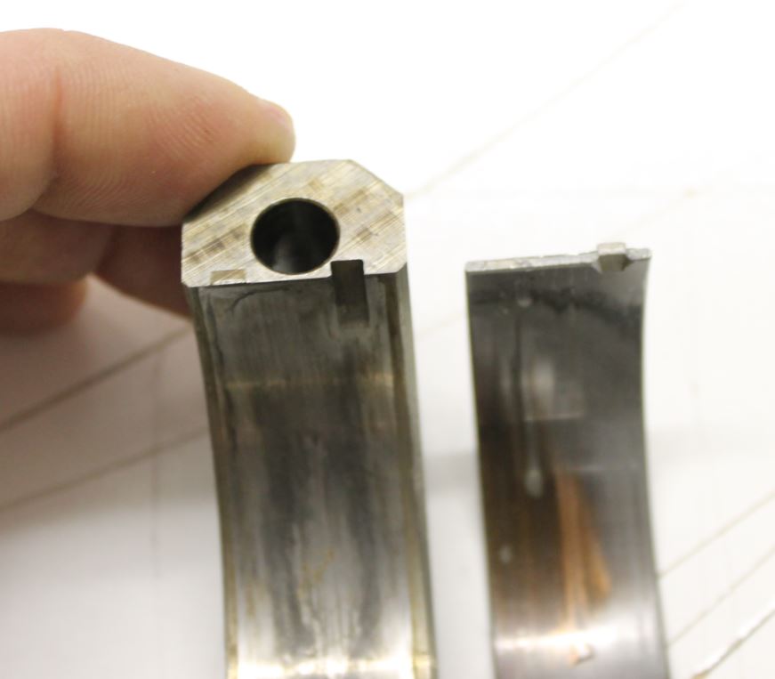

Why aren’t bearings fastened down?
I recently started wondering why cam, crank and rod bearings are not fastened down so they can’t spin. If the bearings just had a peg on the back and the bearing cap had a hole, spun bearings would physically not be possible since the peg would be holding it in place. So why don’t car companies do it? Just because it would be more expensive?

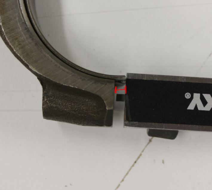

there is a dimple in the bearing and the cap that lines things up and helps it line up and not spin

then there is bearing crush. the bearing is bigger than the hole it fits into. when torqued the crush makes locks it together tightly. i'm showing it exaggerated here but this one actually measures 0.0075" taller than the flat on the cap before you tighten it

Re: Why aren’t bearings fastened down?
There are no cam bearings to spin.
All other typical bearings have a tab on one end to prevent spinning. It's cheap, it works great, it's reliable AF, and it's been this way for eons.
If a bearing "spins", 99% of the time it's because of an underlying lubrication problem.
That means it is NOT the fault of the bearing, the journal, whatever is spinning in the bearing, nor the engineers that specified this type of bearing for the application
BTW some engines DO use pinned bearings.
Attachment 112022
Attachment 112023
and also bearings go in clean and DRY on the backside, which also prevents them from spinning. that bearing in the picture has had 70k miles of pure abuse, yet when i removed it, the back is still dry and still has no oil on it. i think a lot of people screw this up and lube the backs
besides if that bearing did not spin when required to, what would the outcome be? would the crank snap? would the rod twist like a pretzel? scary to think about.
I thought those tabs were the only thing holding the bearings in place. I didn’t realize that the clamping force is mostly what was holding the bearings in place. However, wouldn’t a peg on the back of each bearing that fits into a hole in the cap completely eliminate the chance of it spinning?
The tabs on typical bearing shells are plenty adequate to prevent this.
