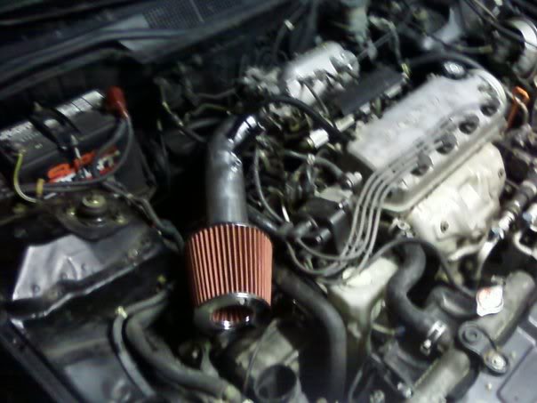

this is my engine
i found this one online
i really like the black head and the heatshield that isnt there
so what i wanna know how can i paint my head black like that? will spraypaint work?
and will taking the heatshield off my headers affect my proformance?
thanks

Re: Ask Me About DIY Stuff V2!
oh nice. wow im surprised they did all that!
for the engine, you can take the valve cover off and paint it with hi temp black. you can paint the heatshield too if you want. i would leave it on, it keeps heat out of the engine bay and also keeps the exhaust hotter, both of which are good things. you can get aftermarket header like in the pic, and get it jet coated from jet-hot.com which will be just like a heat shield.

where can i get hi temp paint?
Old Feb 27, 2010
  #672
any auto store, but look at the different types of finish like glossy, enamel, flat, etc. just make sure its rated for a hi temp. regular paint will fall apart onthe engine.

sorry for all the questions but i just wanna know exactly what im doing before i start.
so should the engine be cold when i paint it? should i take th valve cover off the engine to paint it? how long should i wait before i drive again?
Old Feb 27, 2010
  #674
most people remove the valve cover, otherwise its impossible to paint the whole thing with all the cables and stuff on it. you want to at least wipe it with degreaser and then alcohol so you have a good surface for paint to stick to. then just follow the directions on the paint can. every paint has different drying times but its a good bet you need to wait at least 24 hrs.
