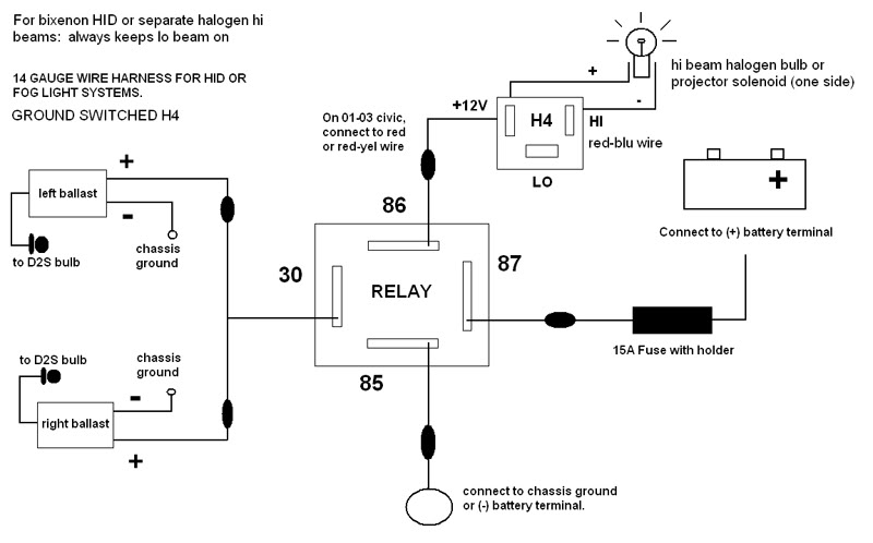

I am having problems with my fog lights.
I bought these fog lights:
http://www.winjetauto.com/Product/Se..._ID=1000001610
Everything is grounded and wired correctly but I am not getting any power. My friend checked out with his tool and he said the brown plug that is with the switch harness is not giving out any power. He said I can wire it to my headlights instead of using the switch to get power. How would I go upon doing that? My fog lights have its own relay, is it safe?
(03 civic lx sedan)
P.S. I don't know a thing about cars so it would be nice if anyone could explain in depth.
Old May 29, 2011
  #903
Rep Power: 811
Re: Ask Me About DIY Stuff V2!
you are better off doing the wiring yourself. the oem system is terribly complicated with all the plugs and connectors for no reason, and the aftermarket ones never even work to begin with. this is how i made my relay harness for the hids. you can use the same thing for fogs except substitute the hid ballast for a fog light halogen bulb. for the trigger (86), you can tap any wire since it only carries a low volt signal (headlight, park light, any power wire you want to turn the relay on with). and doing it this way, you do not even touch the interior of the car for wiring. everything is outside in the engine bay and all you do is connect power from the battery and ground to the chassis. for example if you tap the 86 wire to the +12v headlight wire as shown below, the fogs will come on whenever the headlight is used (lo and hi beam mode).
