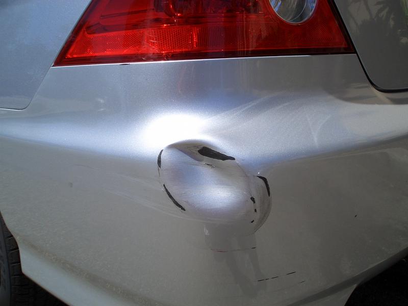

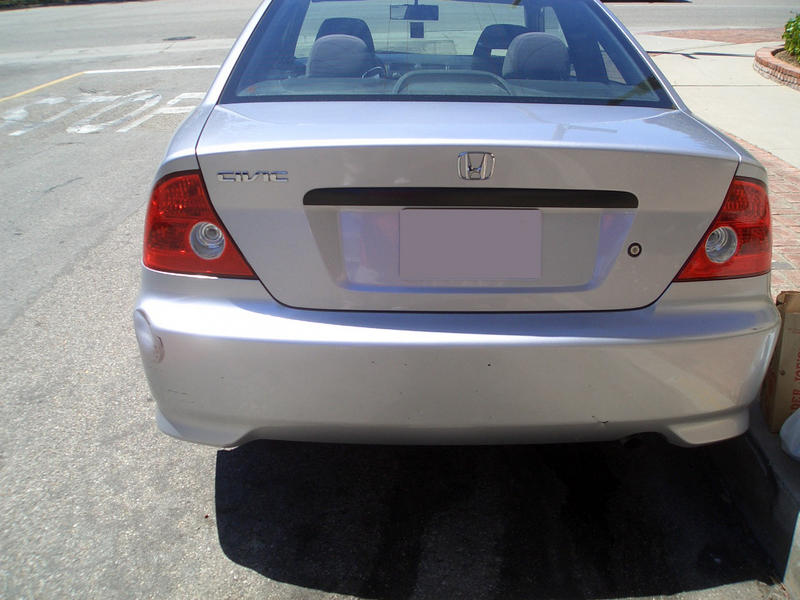

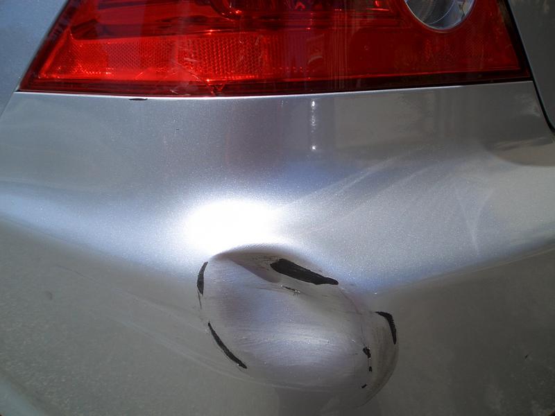

I read up on how you can push a dent out of plastic rear bumper by using a heat gun. This would reduce having to paint to that dented spot. What do you think of that option gearbox? Thank you

it will never come out completely, and a heat gun could warp the plastic even further. even body shops dont bother repairing bumpers, they just replace. ive seen painted aftermarket bumpers on ebay for around $200. even if you manage to pop it out somewhat, you will never have the body line in it and you still need to paint and blend. its worth a shot with the heat gun, but dont expect too much.

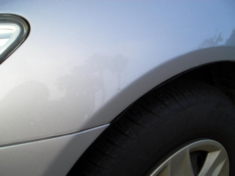

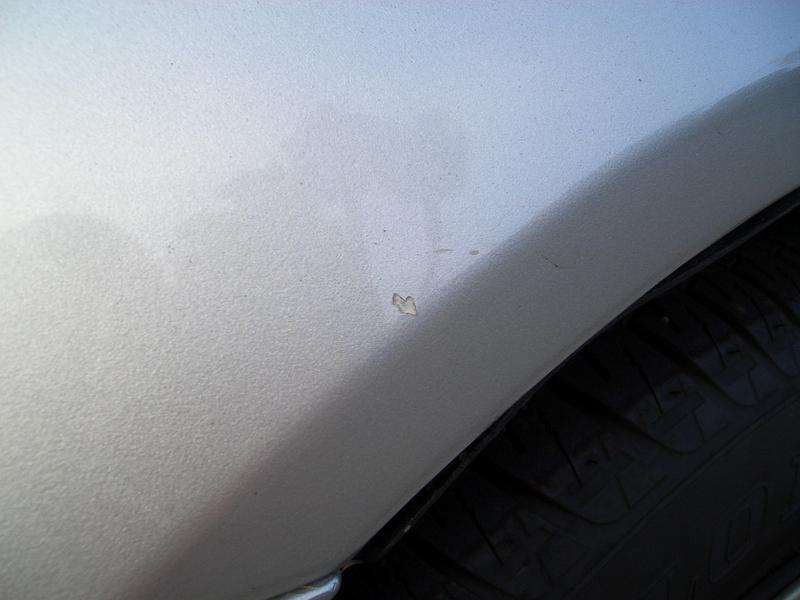

I have a chip above drivers side wheel well. This is were I had body damage and was fixed by body shop about 3 years ago. Do I go back to the body shop and have them fix this or can I fill this crack with dealer paint bottle? Thank you again inadvance. Gearbox your answers thus far have been "fantastic" - bless you man! I have learned more from you than any other source. The beer is on me.

and for the previous question, that is a tiny chip! i would not go get body work done just for that, because they will have to repaint the panel and we all know how hard silver is to match. it might look much worse. just use some touch-up paint. you can smoothen it out after 24 hrs with some scratch-x. but try to only apply the paint in the chip and not around it. i have about 50 of those on my car and i just put some paint to cover it up and prevent rust.
