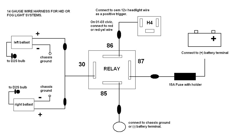

Hey Gearbox, I'm trying to connect my ballast to my stock headlight plug, are those the correct places to insert the spades?

idk, i only know wire colors but i would not recommend connecting a ballast directly to the stock headlight wiring, the wires are too thin. depending on the side (driver/passenger), the +12v constant will be the red or red/yel wire. the red/wht is the LO wire which becomes a ground when lo beams are used, and red/blu is the HI wire which becomes a ground when hi beams are used. technically to keep your ballast from turning off when you use the hi beams, you should hook the ballast power to the +12v headlight wire and ground the ballast to the car body or battery (-) terminal. but like i said, its a bad idea to use stock wiring. better to make your own harness like this with thick wire and a relay and fuse.

Oh shoot, you are absolutely right. I have the (+) and (-) spade connectors coming out from the Relay. In that case I would connect the wires from the Relay to the stock H4 plug but only use one of the H4 connectors as a trigger right?

vinnie, the diagram really says it all. i dont know an easier way to explain it. just follow the diagram. the new harness lo volt trigger wire is tapped to the +12v headlight wire. this tells the relay to open and allows power from the battery side to pass to the ballasts.
