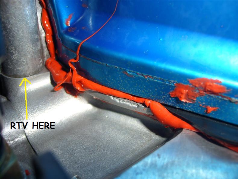

Originally Posted by speedfoos
try putting some hb right around the edge of were the camshaft holder meets the top of the head out side of the valve cover which would be right were 24 goes if you had the rocker assembly off. That is about were the hb is supposed to go.
If you look at bottom picture to the left of the big goop of orange stuff right where the rocker assembly/cam holder meets the top of the head you want honda bond all around that edge that will probably stop the leek without having to pull the whole rocker assembly.
Sorry I would have put up pics but I can't find my stupid camera.

I will confirm that you do need RTV under the parts the hold the cam in on both sides of the engine. It says so in the honda manual

Damn Honda manuals. Always being right.
If I was such a good mechanic I wouldn't be having all these little issues that bother the **** out of me. If I was smart I would have left the ****ing Ebay CAI and DC shorty on there and just dreamt of boost instead of living it.
Thanks fellas. I'll crack the VC off tomorrow and have a look-see. Cuz if I remember right, to pop the cam out, that driver's side motor mount has to come off to get the upper timing cover off, which means, the PS pump comes off, plus the Ingalls Stiffy, and the PS bracket has a hard time clearing the wrap on my turbo mani.

you don't have to pull the motor mount off to get the cam out. Lets see if I remember this correctly,
you can take the valve cover off,
untorque and loosen all the rocker arm assembly bolts,
rock the rocker arm assembly or go underneath it with a flathead screwdriver to pop it cause it tends to stick even after you have undone all the bolts,
once it is loose you can get under those spots with some hondabond,
grab the edge of the cam gear pull it all little to the passenger's side and press down on the rocker arm assembly to get it to seat,
then start torquing all the bolts back down the rocker assembly will fully seat it's self then just put the valve cover back on
