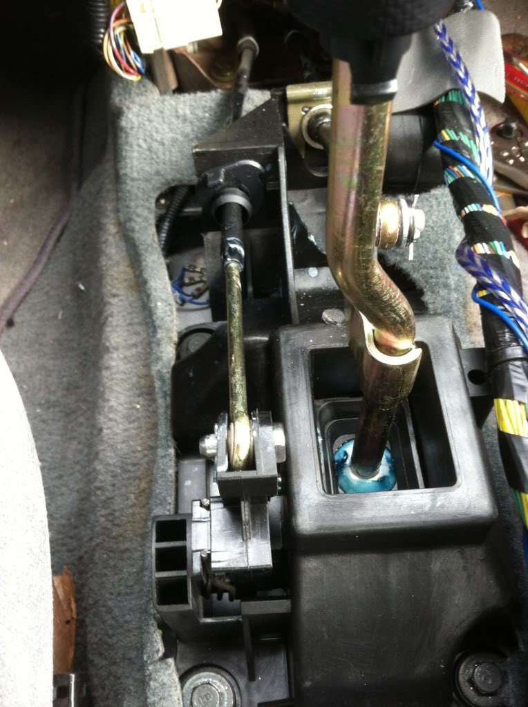

Just installed a Revo Short Shifter. Should have done it along time ago, shifting feels great!! I'm sure my 160k mile OEM one could have been replaced with another OEM one and felt better. Feels more like the shifter is bolted directly to the tranny. If anyone has $100 bucks they want to spend, get a Revo
Is that thing hard to install? I changed out my bushings to aluminum ones and I know it's just a little extra work to get the shifter out. But it was really hard to take out the cotter pins or whatever they're called. I'm considering getting one.

^its really easy

Like sleepy said, it is really easy. Just get some needle nose pliers and pull on cotter pins. Mine were a pain and I had to pull pretty hard. I bought new ones at Home Depot along with a washer to tighten up some of the slack in the connector. If you look at my pic, to remove the cable on the left you first need to twist it to the left (large flat head). It will unlock it then you can pull it out. The middle cable you need to use a large flat head to pry the metal clip off then they both slid out and you reverse the instal.

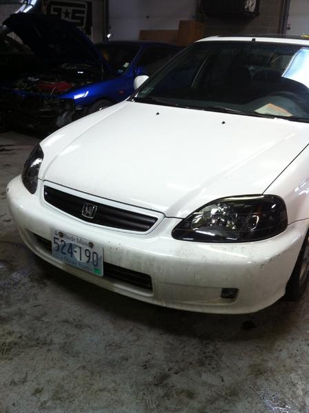

Got my headlights black housed/cleared and my grill painted. Came out awesome! Going to black out the emblem this weekend.

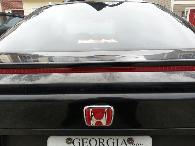

put these on
p.s. i know the front H isnt supposed to go in the grill but thats where i wanted it so thats where it went. thanks

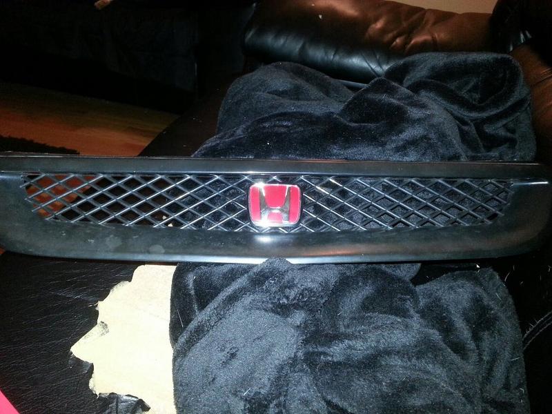

After paying the last payment, i ordered a new grill and window shade things, can't remember the right name for them at the moment. Hopefully get those by the end of the week or beginning of next week ill install them! Took off the valve cover to clean it and try and decide what type if paint i want to paint it with, and realized its going to need to be sandblasted due to a shitty "factory" paint job done on it before. Also installed a USB plug into the dash a few weeks ago to charge my iPhone, love that thing and not having to struggle with an adapter that blocks the passenger cup holder!

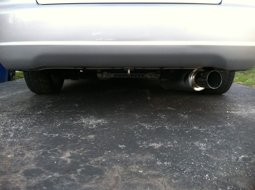

Installed HKS exhaust. Sounds great and looks cool. Thanks Kenny for the YouTube video of your exhaust.

Np, glad it could help make a decision for ya.
It's a great exhaust
