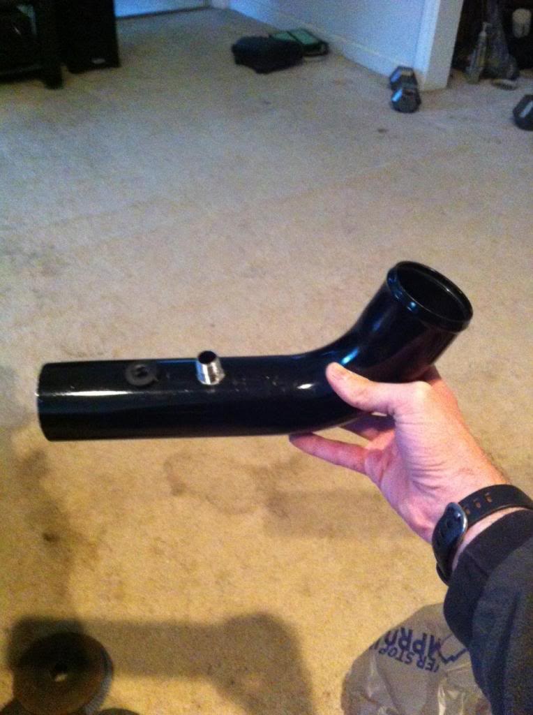

Finished making my CAI.
Modified the intake pipe to hold the air sensor gasket and a piece of 3/8" galvanized pipe for the vacuum tube. Then I put a K&N RU-4860 on it and took it for a spin. Trimmed the vacuum hose a little cause it had a little kink in it and it's all set.

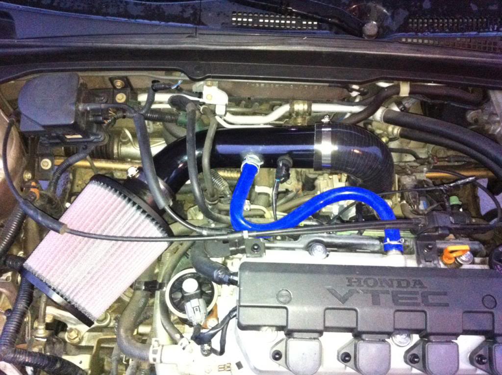

But overall the car runs good and sounds pretty good, a little louder from the 3k - 4k RPM range but not terrible. I don't really care about speed just MPGs!

^ looks good. It's a SRI, CAI would put the filter outside the engine compartment.

short ram intake?

Correct.
A cold air intake will put it down behind the radiator closer to the ground.

cool deal, thanks!!
