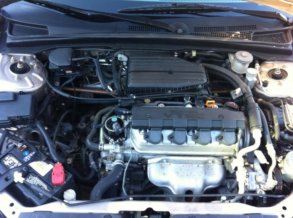

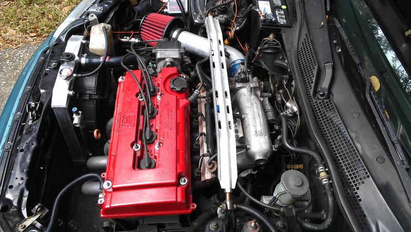

Went and got and AEM dry flow filter , did some research and found its
one of the better ones to run with a CAI set up. It really cleaned up the
engine bay i think and matches the valve cover n my new hoses lol
also made a rack for my ECU and remounted it as the previous owner had
it in a not so great spot.

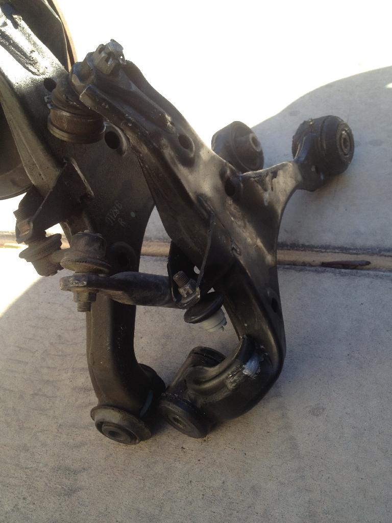

Been kinda MIA on the forums lately, but just thought I'd share that repairs on my car are underway. Here's the FR LCA compared to its replacement, which has been installed on the car already.
Managed to find a 2002 EM2 at the local pick-n-pull and grabbed an LCA and knuckle in great condition. They threw in the attached endlink, brake assembly, and strut assembly, free of charge, only issues with any of it were a shot compliance bushing and rubber boot within the strut assembly, the latter of which I'm not even remotely using. ES bushings were pulled from the old LCA and reinstalled on the new piece, and a new bearing for the knuckle should be here tomorrow.
One new rim I've received and had a replacement tire mounted, other rim/tire has been replaced with the "full-sized" spare I've had chillin in my dad's garage. New fender needs paint, and I'm awaiting a new driveshaft that should arrive with the wheel bearing. Reassembly, paint, and an alignment, and I should be good to go.
Old Jan 9, 2014
  #1847
Re: What did you do to your civic today?
Yeowch, that looks rather pretzel-like.

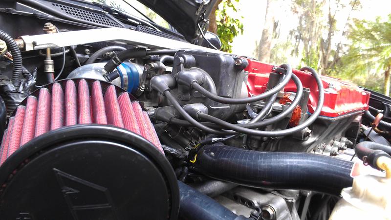

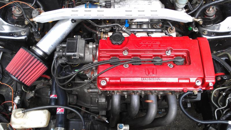

went to install an ebay CIA with a KN air filter to find the tubbing doesn't work very well with holding the air sensor module. Also the tubbing configuration isn't the best. So ordering a few more pieces and going to try to get it in this week. Left that big resonator box off the stock air intake for now. I'll post some more pics once I Frankenstein it together.

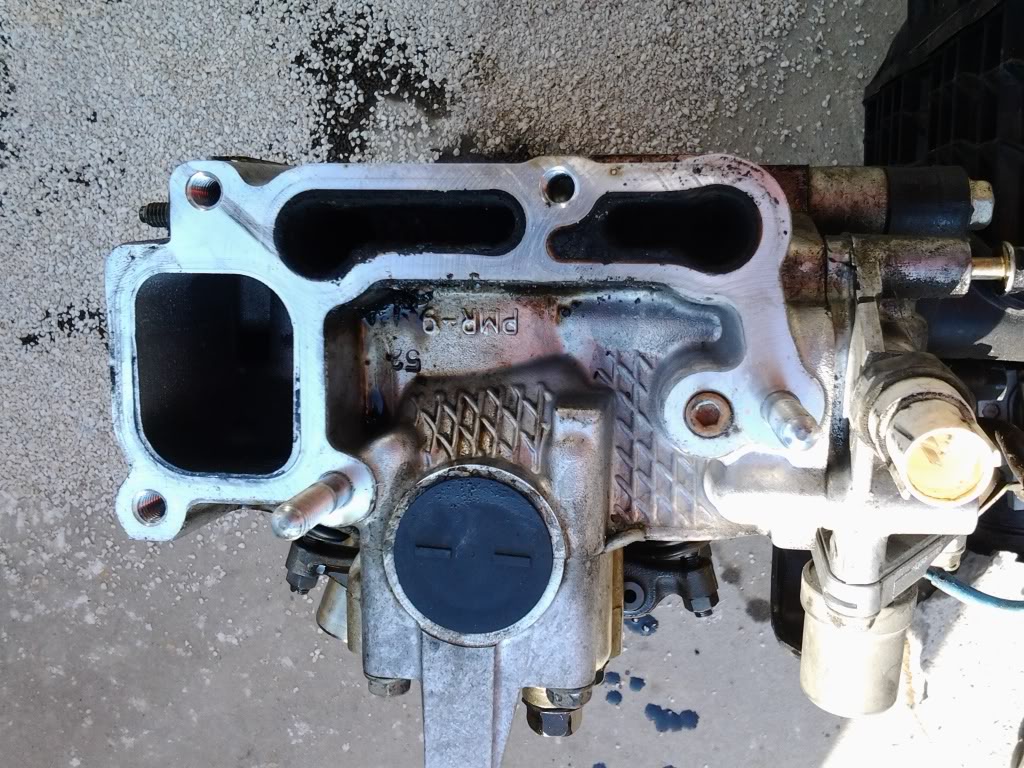

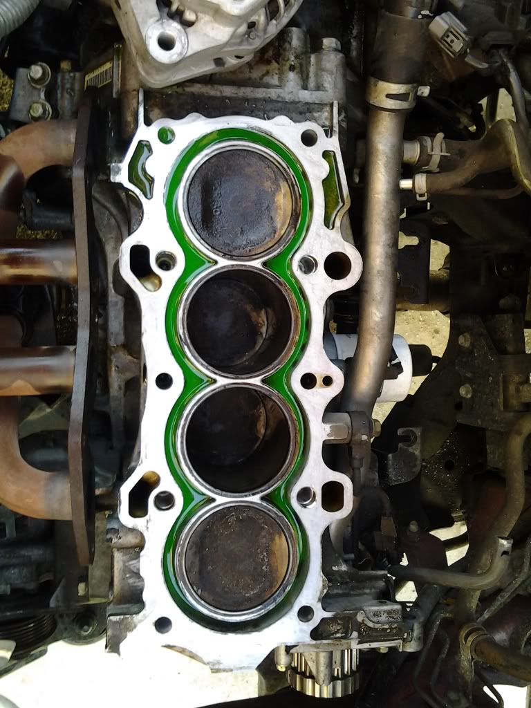

So the problem with my motor was... I'm not sure... head gasket showed no sign whatsoever of failure, nor did the egr gasket (the only other thing it could be) BUT, the timing belt ended up being the ORIGINAL to the car!! :yikes: It was very nearly to the point of failure. Got the car back together and drove it around all day yesterday with zero issues. I think there may have been some Divine Intervention that saved my motor from catastrophic failure.
Pics:
Sorry I forgot to take a pic of the timing belt, it was pretty bad, and was an original Honda belt...
Old Jan 29, 2014
  #1859
MLS head gaskets usually don't. You have to know exactly which cylinder(s) were affected, then look for the "black paint" lifted off the gasket in that area.
Old Jan 29, 2014
  #1860
noJeepshere's Avatar
Civicless
Joined: Jun 2013
Posts: 62
noJeepshere is an unknown quantity at this point
The stock gasket wasn't an MLS gasket...
