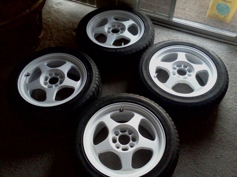

i bought these for mine, will be on later this week, i know some people hate on rotas, but imma pimp on a budget lol

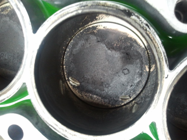

Got the head off. My suspicions were correct. Every exhaust valve is bent, and the pistons all have knicks in them from the valves. not sure if it matters that they are knicked? Im thinking ill install the other head I have. Im done the (mild)p&p, gasket matching, and valve lapping. Have arp studs, top end gasket set, and a neuspeed front strut brace in the mail. Gonna find a machine shop to inspect and machine the heads mating surface awhile and hot tank it.

My concern might be: Are the top rings squashed into their grooves now?
How deep are the dents, how close are they to the ring groove area, how far down is the ring groove, and....do ya feel lucky, punk?
Most people (paying customers) opt to do valves only, they don't want to tear pistons out to inspect rings.

thing is i do all my own work, i have a motor that im using the head from. only thing wrong with that motor is the bell housing is cracked. if i had to i could pull the pistons out of it. i just dont want to do anything i dont have to.

Ouch. That looks deep.
I wonder if you can push the piston toward a dent to push the ring in, then move it away, then see if you can slide your thinnest feeler gauge down past the TOP ring.... That's all I can think of without pulling it out and putting your fingers on it.
But like I said, most people opt to run with it even after they are (hopefully) warned about possible compression loss and oil consumption before making that decision. Most come out ok (or I never hear about it if they don't).

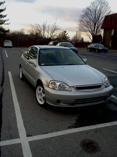

Put my new wheels on, all i need to do now is color match the side skirts then get in low.
