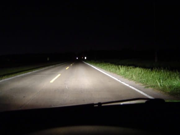

i had those before and had a body shop paint em to match the car. did not affect light output since it does not shine that high to be covered. and you can use 3m double sided mounting tape to attach em.
some pics of the headlight bulbs in 01-03 civic h4 housing.
stock bulb
philips xp

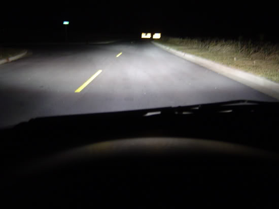

4300k hid kit (notice the poor beam pattern with many hotspots and holes, just use it for color comparison).

wow! that xp is bright! r u sure that doesnt blind oncoming traffic? if you compare xp to the blue vision, is the only difference a "whiter" light?
thanks for the pics btw really helps when deciding what to get or what to keep.

they are not that bright and still completely legal for lumen output. i do get flashed occasionally with my hids now but only if im coming up a steep hill and light below the cutoff is shining all over ppls cars. otherwise normally they look about as bright as parking lights.
you prolly need to re-aim the headlamps after changing the bulbs (true for any bulb you replace not just the xp). just drive around and see if they look okay. if its hitting the ground and you have trouble seeing in the distance, theyre too low. if they are shining at other cars mirrors and it looks like you can see everything like hi beams, its too high.
