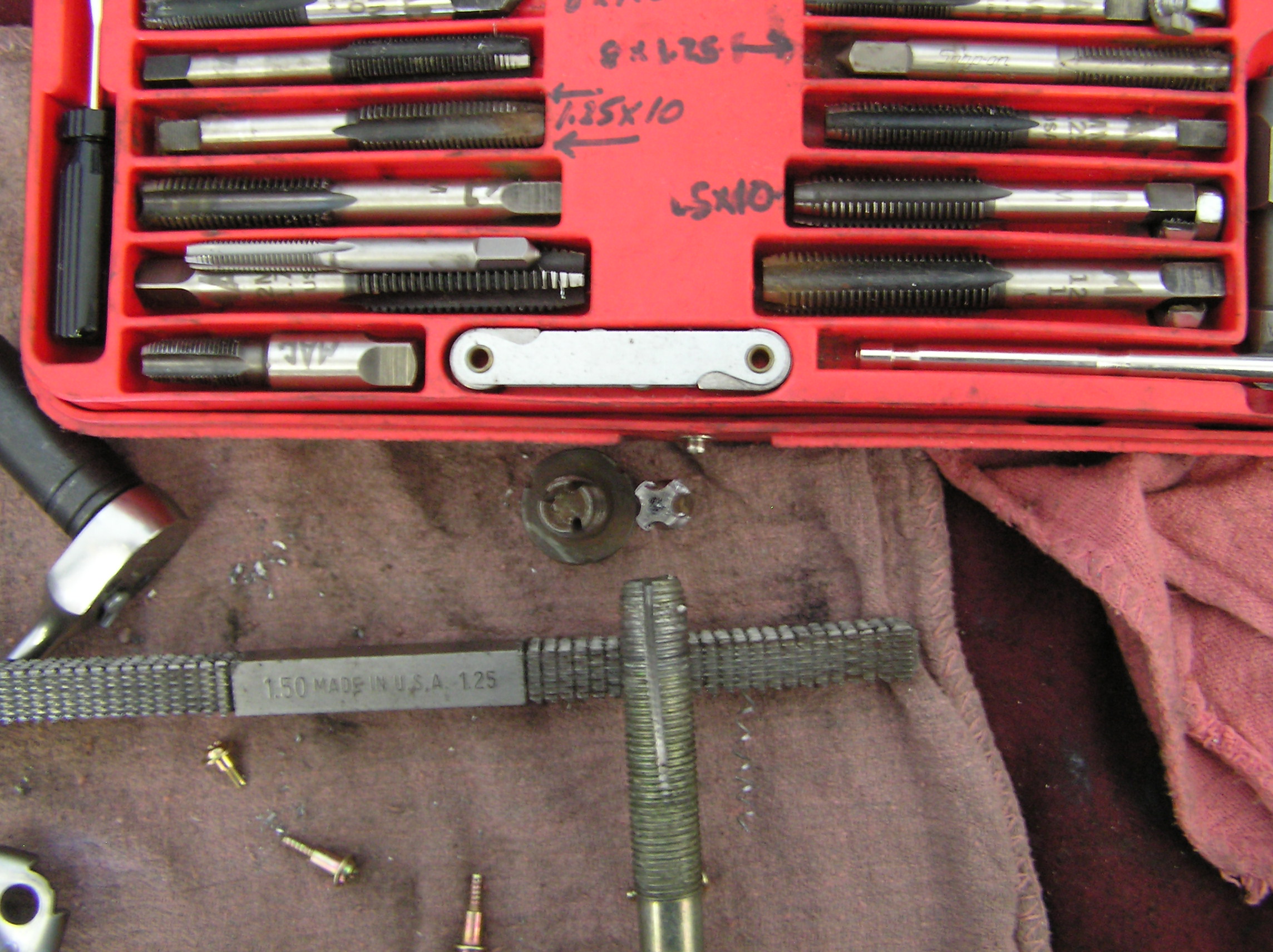

I keep hearing it said to "Take an old head bolt and grind one side off to make a thread chaser."

Ever seen a real thread chaser?
Ever seen a real thread tap?
Can you slice up a bolt to resemble one and make it do a similar job?

Aren't those stretch bolts? If they are, then you should not be reusing them.
Aluminum threads should not rust without the steel touching it (dissimilar metals, aluminum).
Fix that thread First thing. They need to be clean and lubed for proper torquing of head.
The red case holds a tap set (for comparison or whatever).
The 2 items standing up in front of the case are a tap on the right and a 'sliced' bolt on the left.
In front of that is a thread file with a sliced bolt laying on top of it.
The slices can be made with a hacksaw. Cut 3 or 4 slices.
(I used a cutoff wheel on these, but you probably don't have one at your disposal.)
After cutting with the hacksaw, use the thread file to clean up the edges of the freshly cut threads.
The bolt is still softer than a tap but its purpose is only to clean up existing threads, not to cut new threads.
If cleaning up the existing threads is futile, deeper surgery may be needed to effect reliable thread repairs.
@Mad Dog, those are not TTY bolts.

I have a hacksaw, a vice, and a thread file.
I will give this all another shot today
I will use one of the messed up bolts as this thing I see

File, saw, messed up thread.
I also have a Harbor Freight Tap and Die set, and a Heli Coil on the way (10x1.25mm)

ACTUALLY upon closer inspection, this bolt will do well since its just dirty. Cleaning it up now...
If it has the correct size tap, why not use it?
