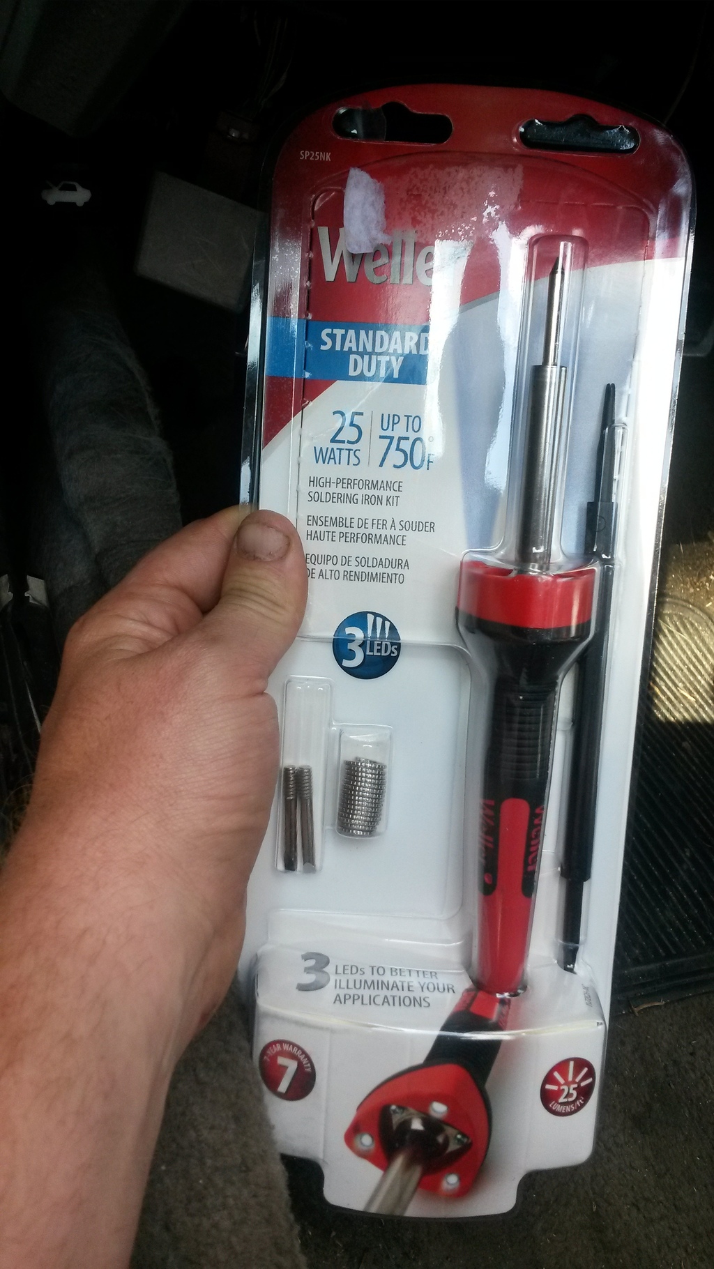

Came back with the compression tester.
Going for soldering iron now.
Progress!

I am fussing with solder on the main relay right now. Going to let it dry and harden..

Well...at least you have good taste in soldering irons.
Solder takes about 1 second to 'dry'
Old May 22, 2015
Re: First post! And.. issue. My 1995 Honda Civic..
I use a butane soldering iron 99% of the time.
Solder does not dry LOL, it cools and hardens.
It's ready to run as soon as you can touch it with bare skin.
Good luck!

Did the resolder job work on the main relay? Does it run reliably now?
I think the resolder job was a fail.
Going out to get a new.. will check back and re-read last night's action plan and new posts when I get back.
If it runs after and stays running I do it again..
