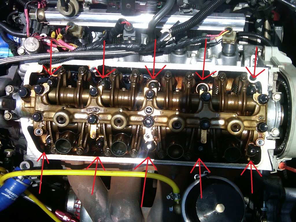

OMFG, those are still cam and rocker shaft bolts.
Old Jul 12, 2015
  #182
Rep Power: 518
Re: First post! And.. issue. My 1995 Honda Civic..
HEAD bolts
HEAD bolts
