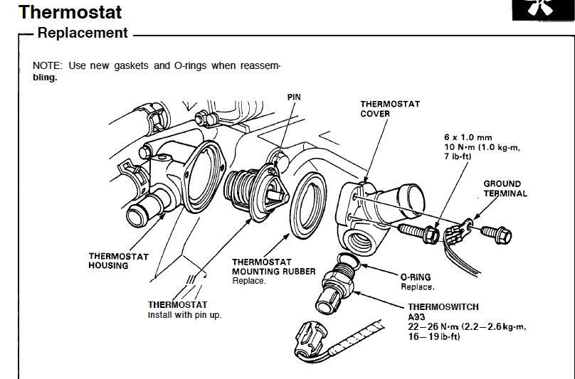

Bunch of ground wires are supposed to be attached to the thermostat housing, go there.
Check, clean, wire brush to bare metal, tighten.

First 15 seconds....What are you doing? I did not mean it needed more ground wire to the battery ... and that is not the thermostat housing. I assume the original chassis and engine/trans grounds are still intact.
THIS is what I meant when I said ground wires on the thermostat housing:
The computer and the main relay all obtain their ground through the wires at the housing.
At the end when you finally get it to run then open the hood.....*FACEPALM*
I can't believe you are running it without the valve cover. You see all that oil mess it's making? You realize you ruined the timing belt, right?
You should replace the timing belt now....it's contaminated with oil. It's life expectancy depends on it staying clean and dry, and you now have oil splattered on it.
It probably won't let go today or tomorrow, but the oil contamination will eventually ruin the rubber.
But YAY it runs! Congratulations
