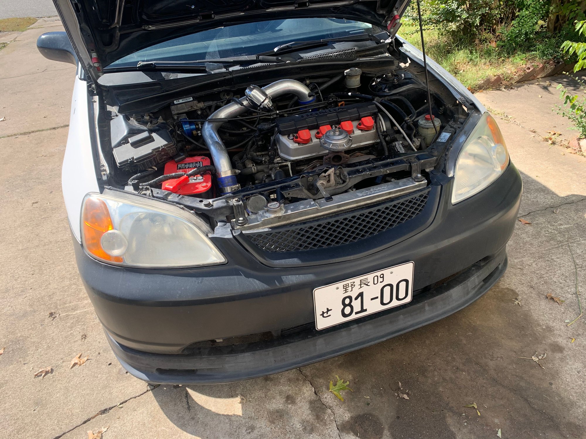

And it's back in!!!!

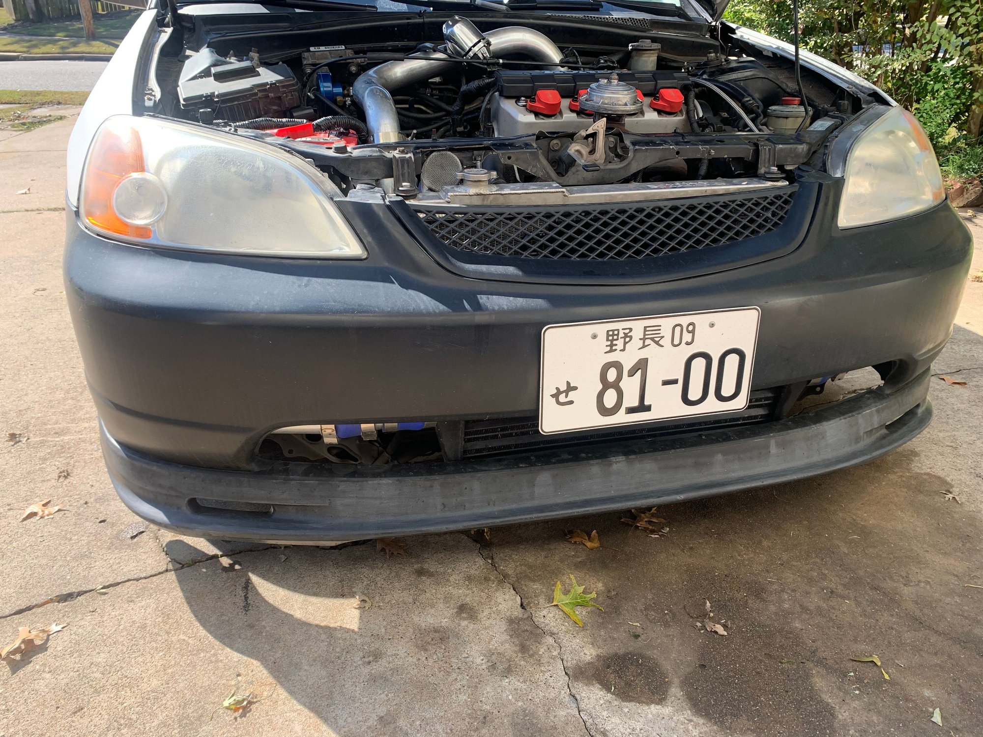

Time to detail the engine bay a little bit.
New fuel pump comes in tomorrow and then it'll be ready to start up!

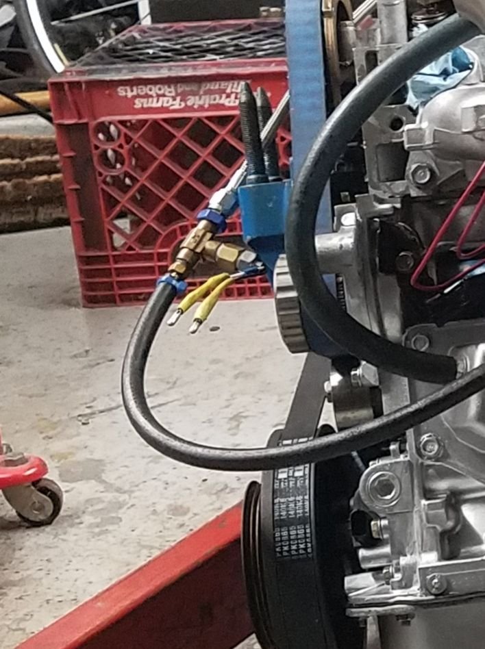

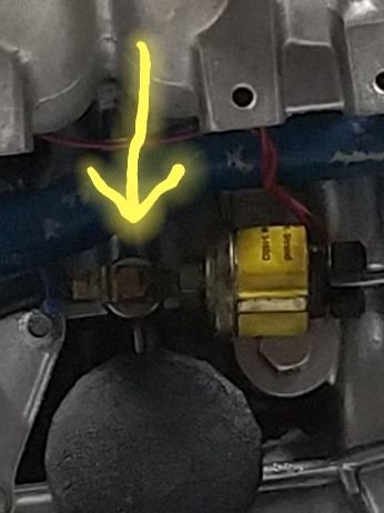

I don't have the oil light hooked up anymore.
I have an actual oil pressure and oil temp gauge in the car.
The oil pressure is just off the block. I installed a brass tee to handle the pressure gauge and the turbo oil feed line.
I have the oil temp gauge located near the half way point of my turbo oil feed line.
Oil Temp on the turbo oil feed line
brass 4-way block handling the oil pressure and the turbo feed line.

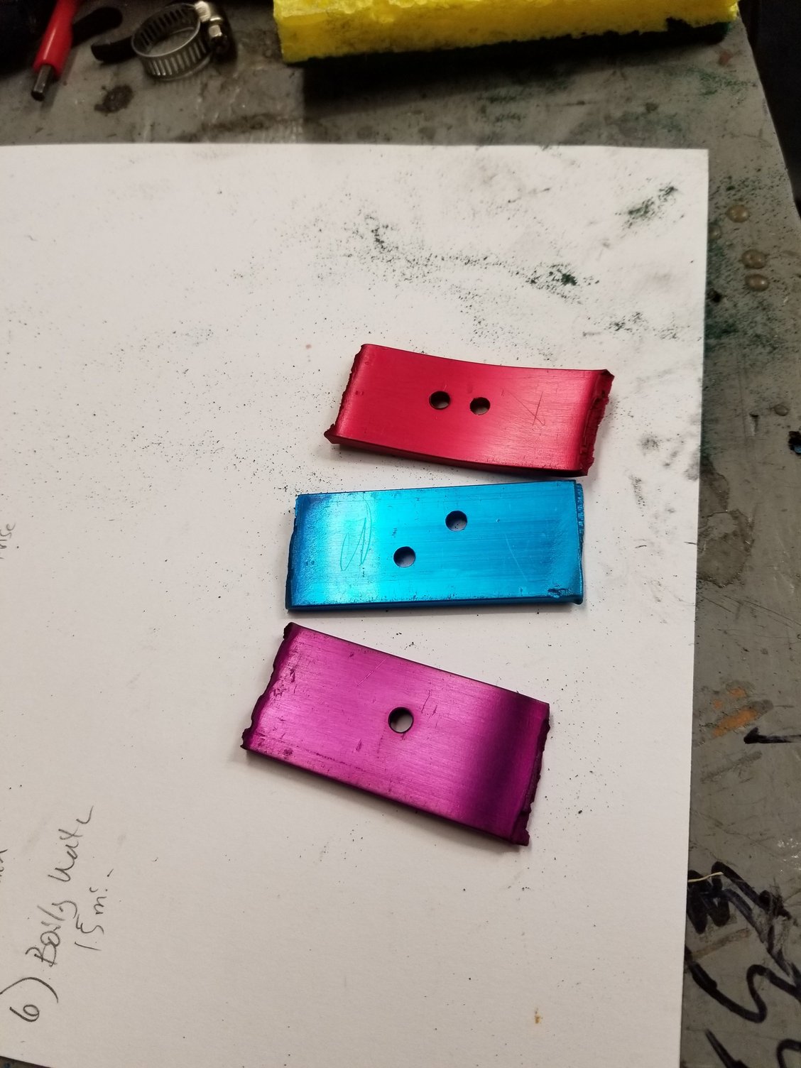

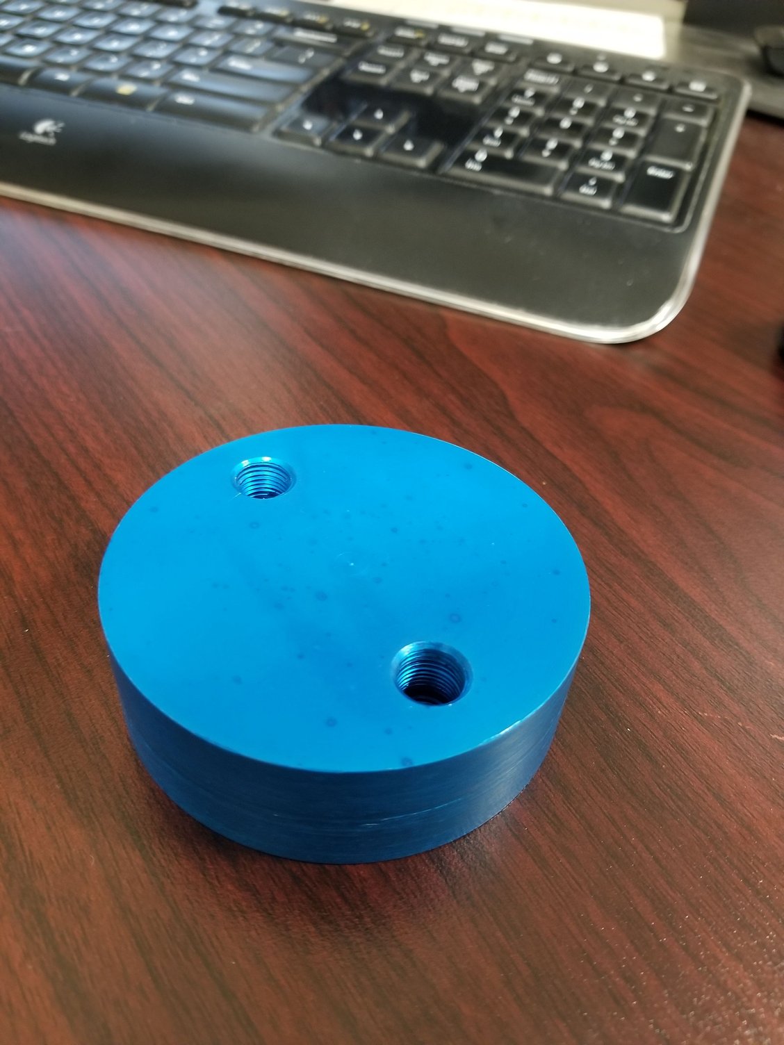

Been waiting for a month to test at the track but do to my daughters all star cheer practices and rehearsals, things have been a bit crazy around the house.
In the meantime, i have learned the basics to anodizing aluminum!!!!
Old Jan 20, 2020
  #351
Colin42's Avatar
Posts: 9,646
Likes: 1,283
From: Barrie, ON Canada
Rep Power: 223
Re: Ktuner and the D17
Very cool, wife was ok with you doing science experiments on the stove?
Old Jan 20, 2020
  #352
piano55man's Avatar
Joined: Nov 2016
Posts: 508
From: South Texas
Rep Power: 123
piano55man is a glorious beacon of lightpiano55man is a glorious beacon of lightpiano55man is a glorious beacon of lightpiano55man is a glorious beacon of lightpiano55man is a glorious beacon of lightpiano55man is a glorious beacon of lightpiano55man is a glorious beacon of light

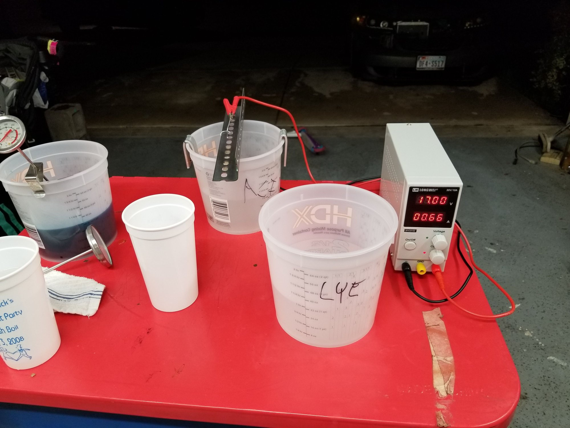

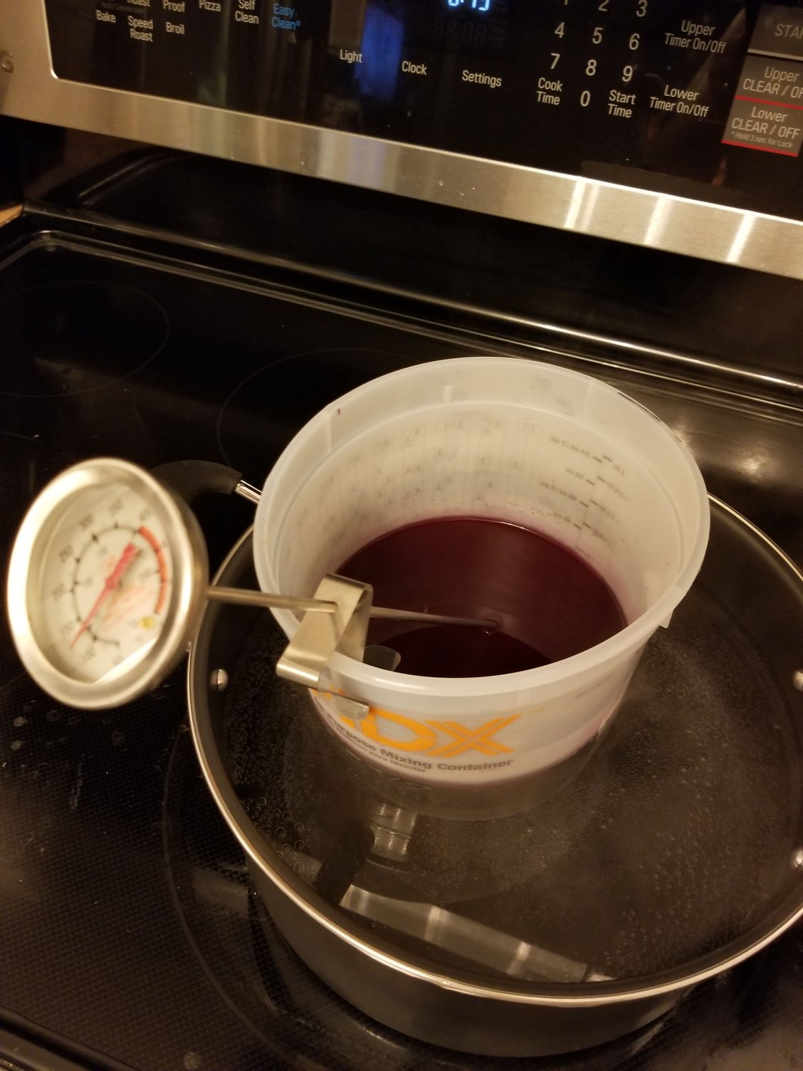

Yeah, about that...she wasn't home for the first round of "cooking"....
The only stove work is heating up the dye to about 150 degrees, putting the piece in the dye for 8 minutes, then placing the dyed piece into boiling water for 15 minutes to seal everything.
It does have a "breaking bad" feel to everything....

Right on dude, how durable does it seem? Didn't know you could anodize at home
Old Jan 20, 2020
Seems to be durable enough...
I used the following videos:
I used RIT fabric dye!!!!
I used a bottle of the dye to 2/3 gallon of distilled water...I didn't know how much to use so i started with that amount.
I didn't keep the aluminum in the dye for the full 15 min. Instead, i kept it in till i liked the coloration.
For the blue i used Aquamarine
Red i used fuchsia
Purple is used purple
Old Jan 20, 2020

Making my own turbo leak tester..(just because i can)
Cut it on my lathe last week, tapped, counter sunk, and anodized it last night.
I think the color blotches was caused by using tap water instead of distilled...
