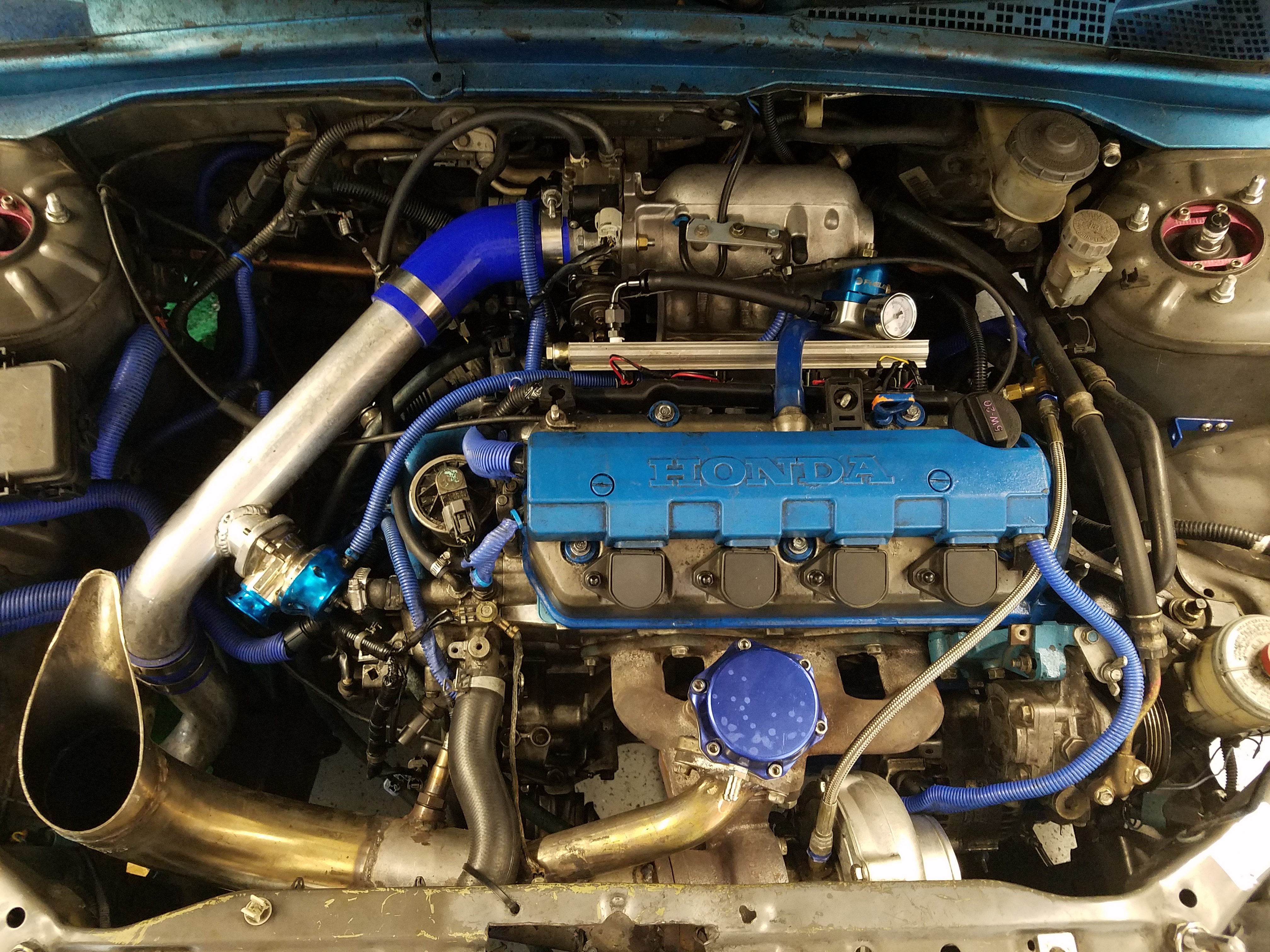

Re: Ktuner and the D17

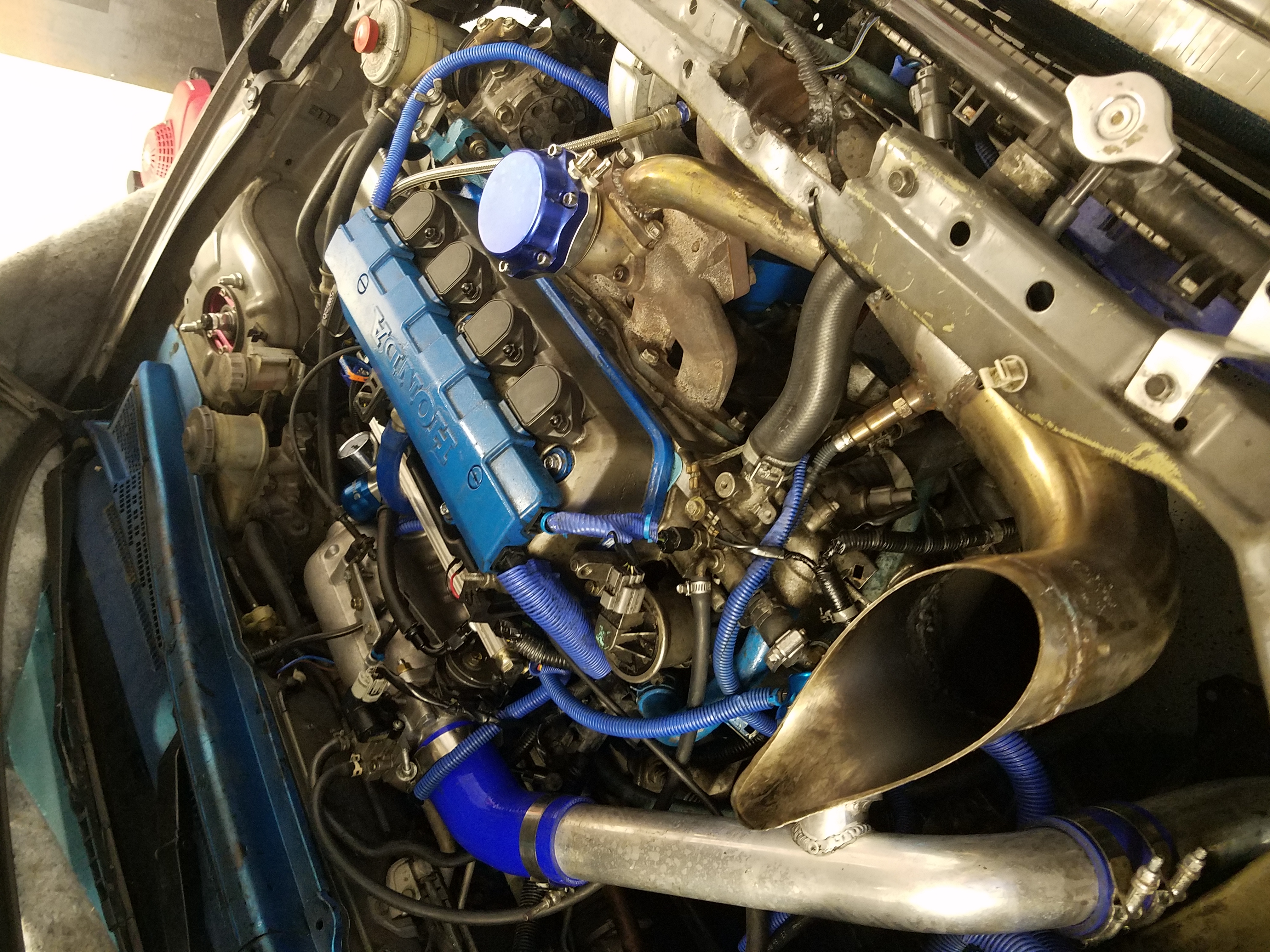

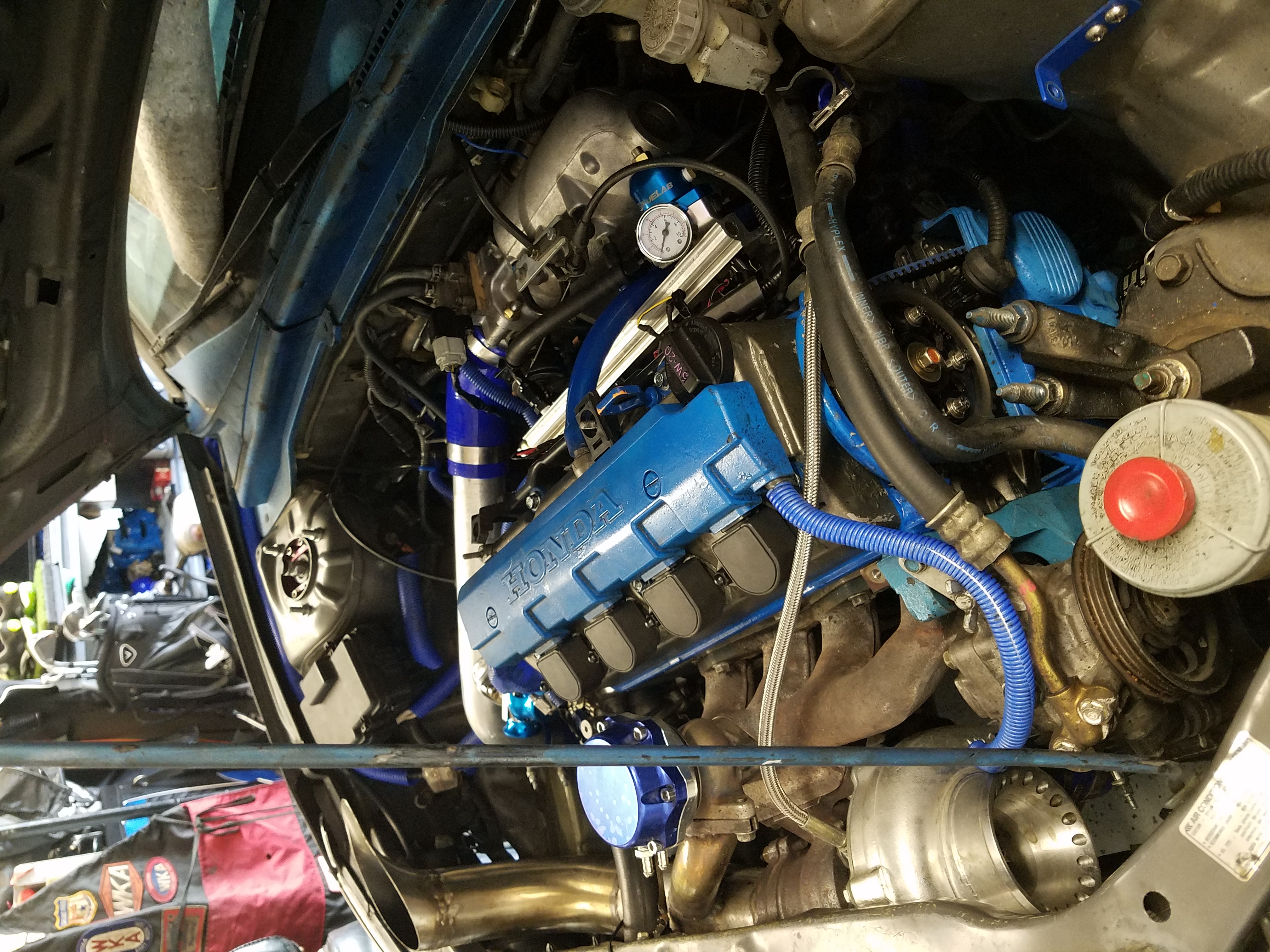

engine ****....for some...
ID:	112417   Click image for larger version
ID:	112418   Click image for larger version

Nelrodjr is an unknown quantity at this point
Looks good, have you done all the work yourself?

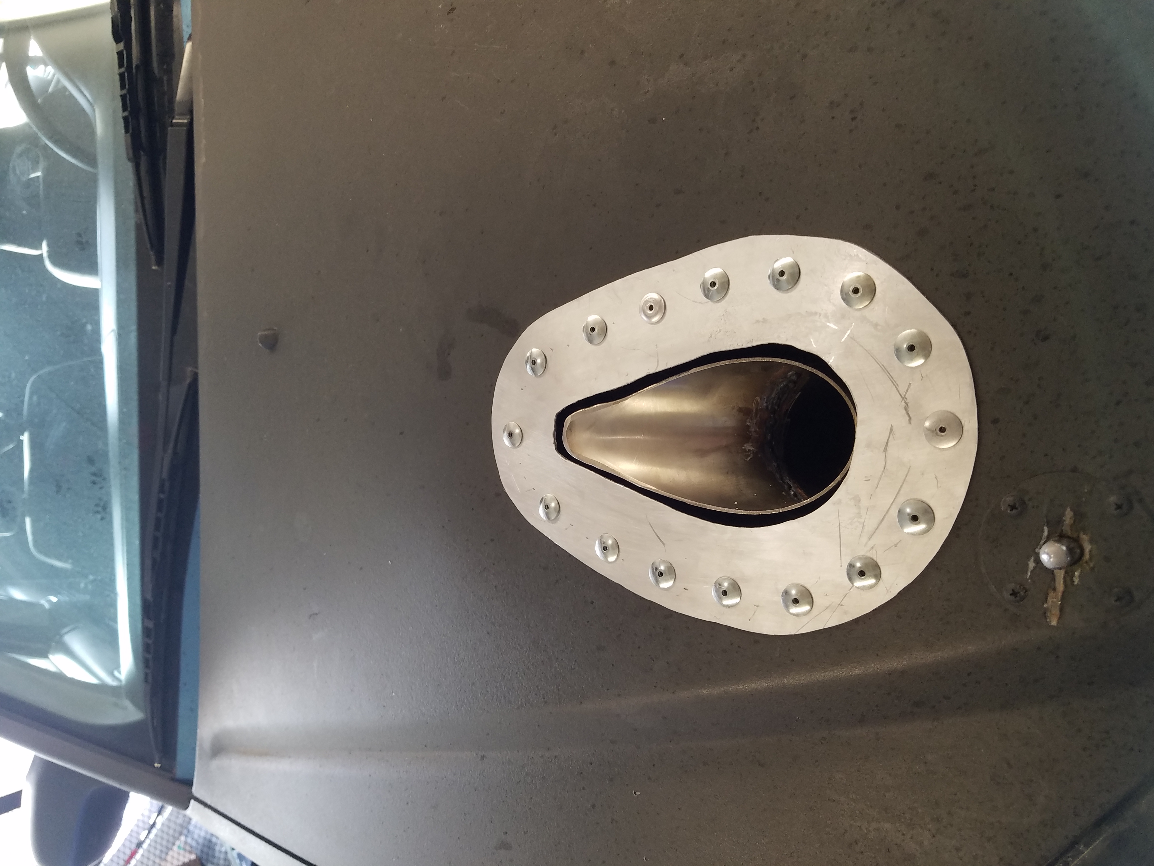

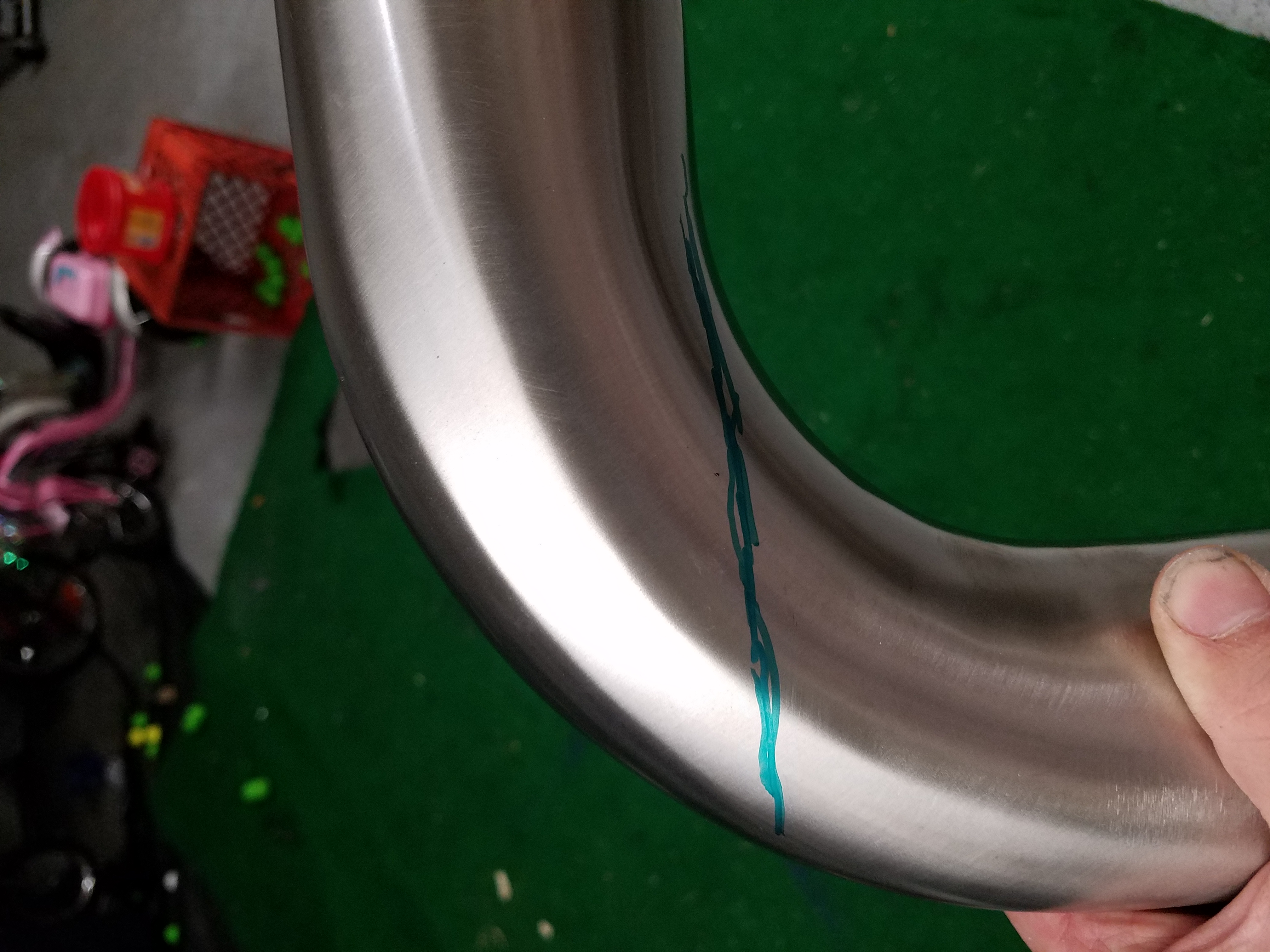

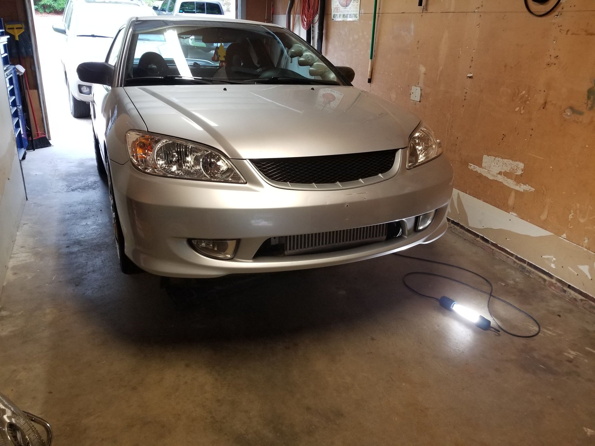

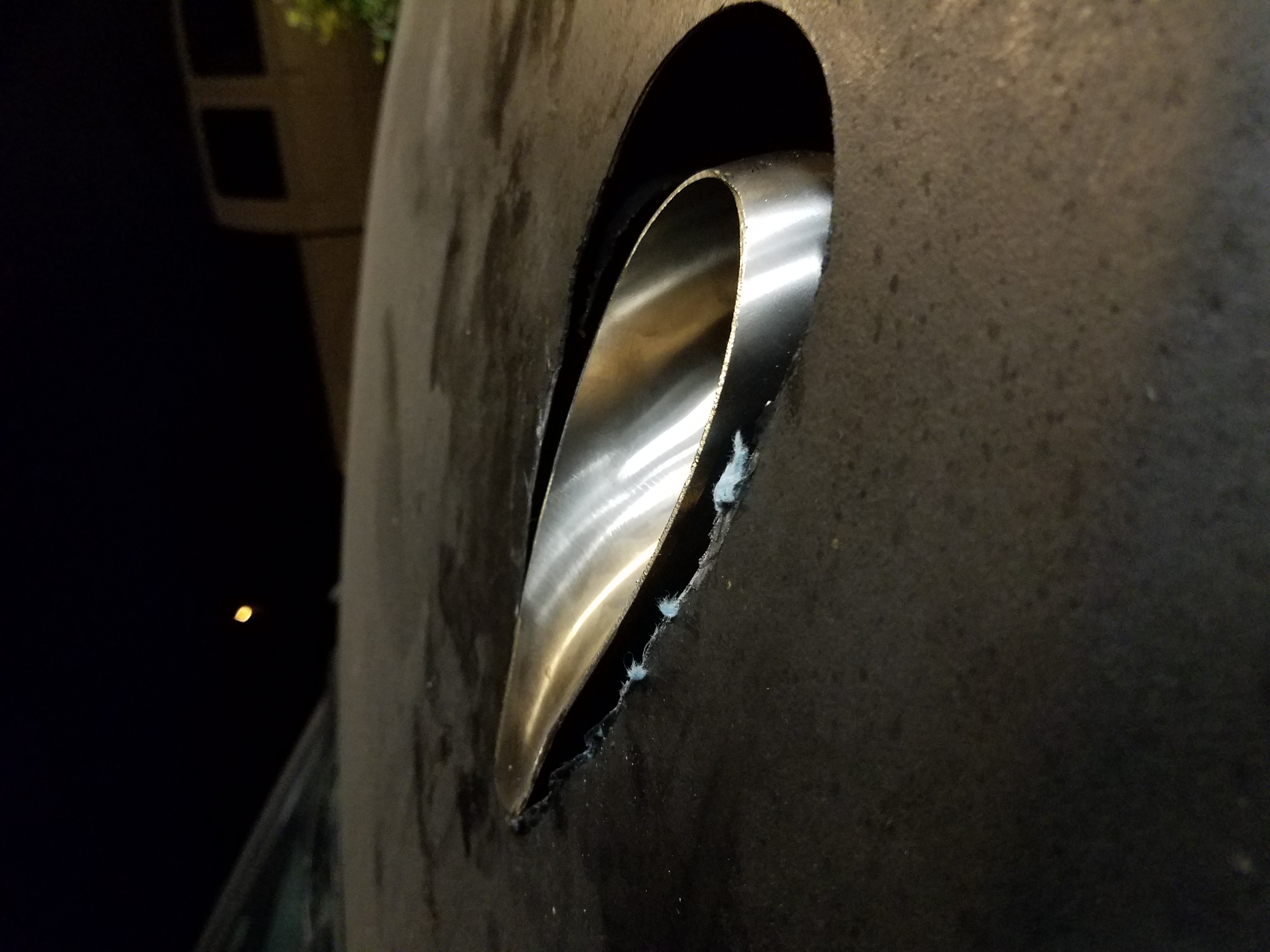

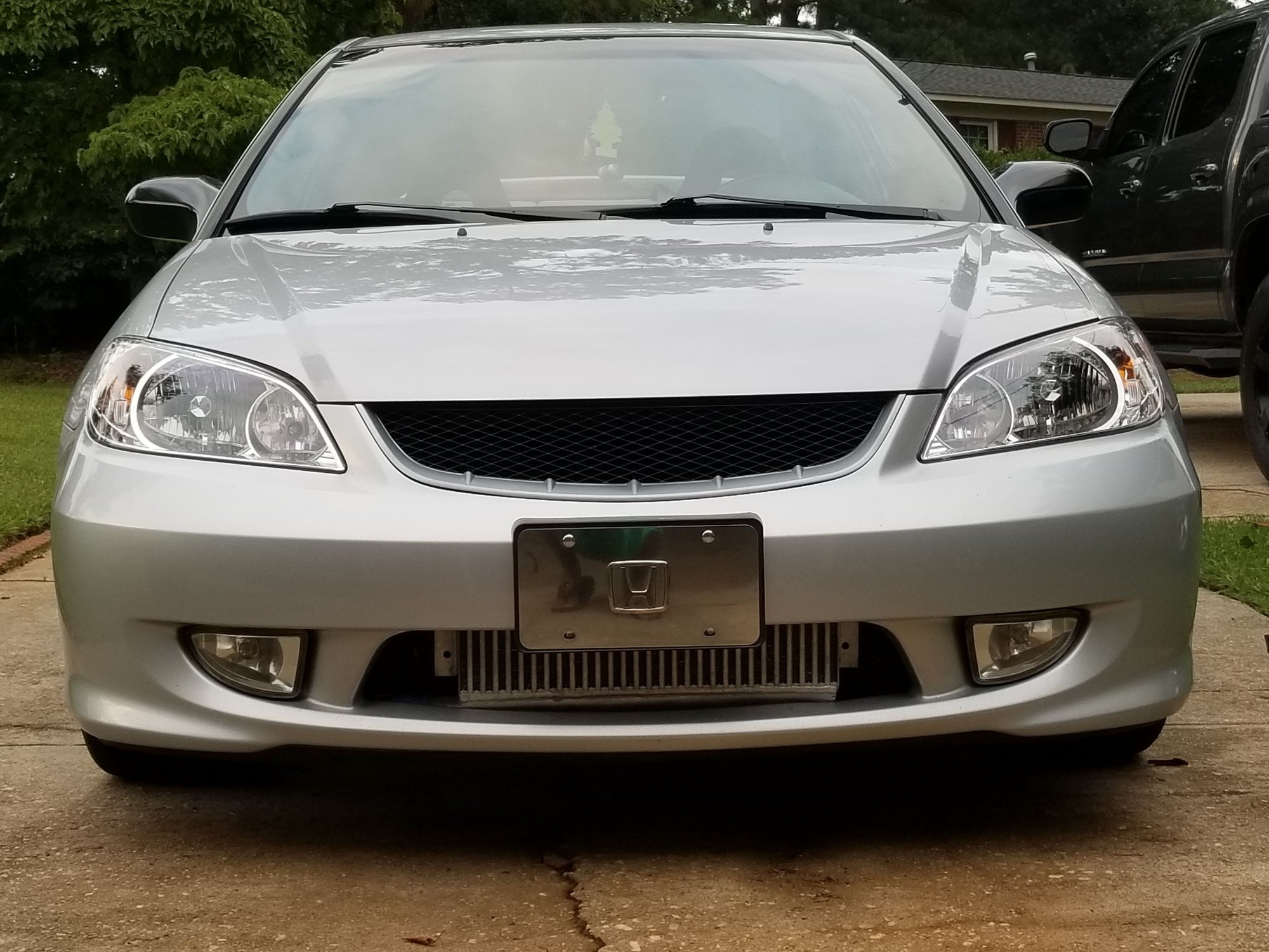

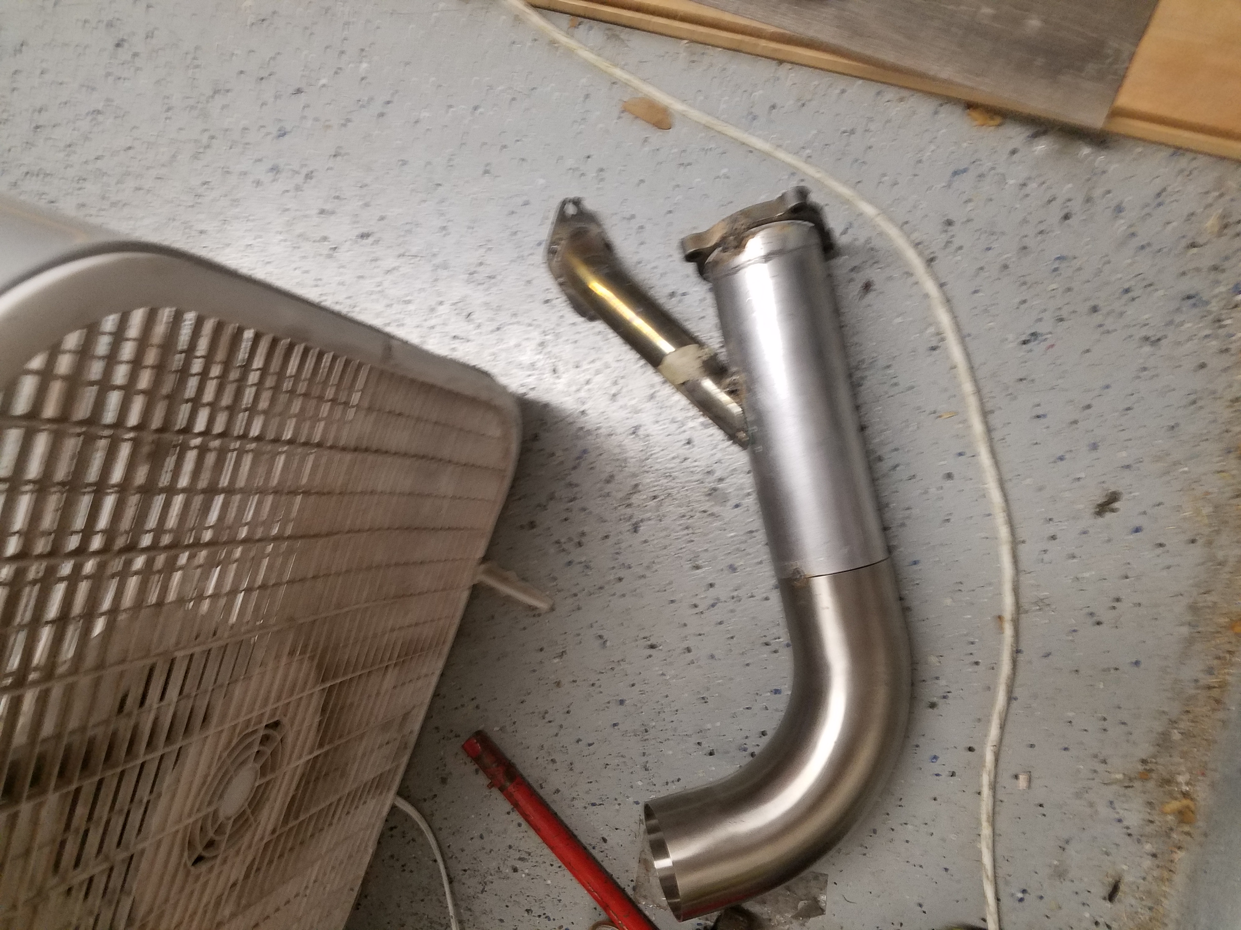

Yes, i did most everything.
I designed and cut the exhaust along with tack welding it. A good friend did the actual welding.
I ported and polished the head myself then had a local race shop bore out the engine, polish/balance the crank, install king racing bearings, and install the bottom end. I installed the rest of the engine and turbo.
I made VTEC killer style rocker arms...it's constantly in VTEC. I did this since it's mainly a race engine and won't be run under 3500 rpms much. It did take some tuning time but it does idle.
I did the intake swap myself.
The intake swap is not that hard at all as long as you have a drill and a dremel. It was easier since i have the egr turned off...I'm getting ready to make a delete plate.
Here is the link for the swap instructions... https://www.civicforums.com/forums/1...2-ver-2-a.html
Since i went with a bigger than usual t3/t4 turbo, mines a gt3582 61mm , i had to get rid of the AC. I live in south Texas, there's never a need for AC down here........
If you have any questions please feel free to PM me.
If you have any
I still have the stock D17 throttle body on it....which I know is restricting me a bit.

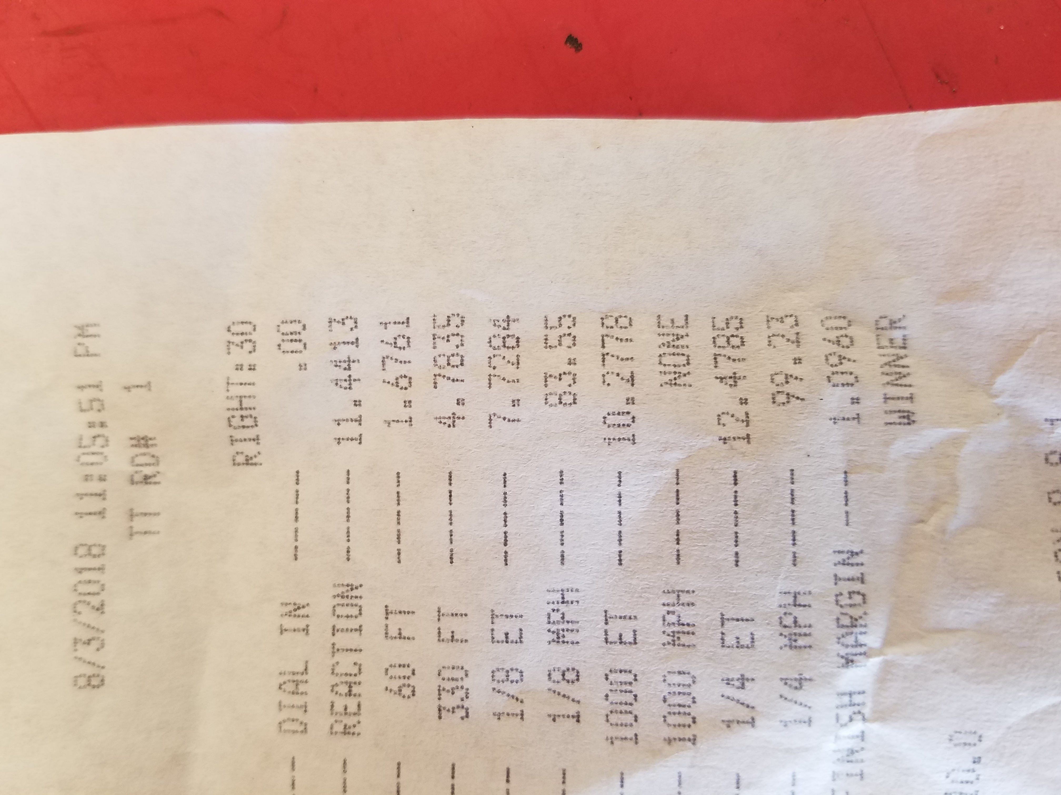

Happy to report a 12.47et with 12 lbs of boost!!!
Old Aug 4, 2018
  #201

it was roll racing but i was running 10 mph in the traps.

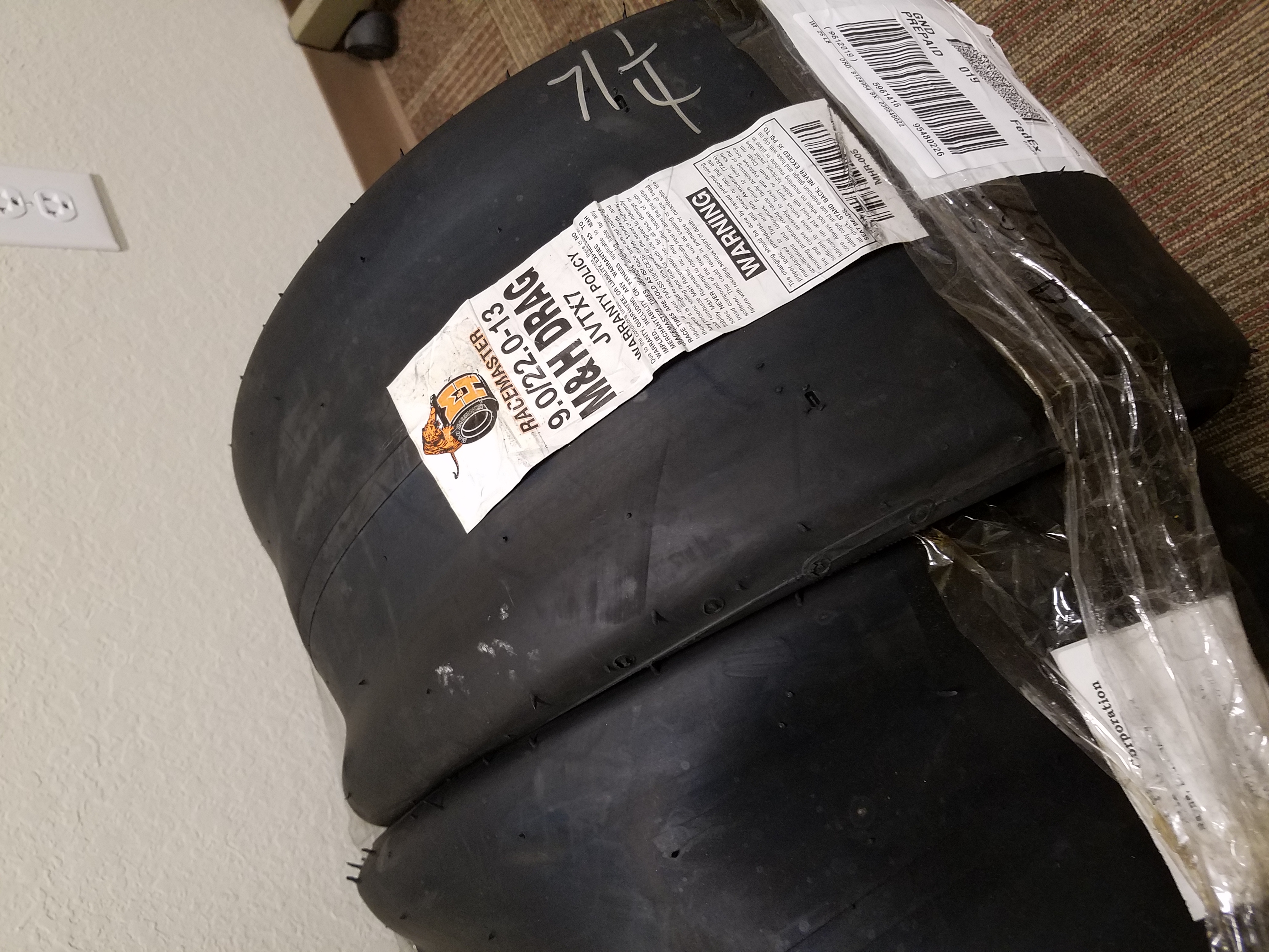

22-9-13 M&H slicks ordered from Summit!
tires....360 total.
I sold some racing kart parts earlier this week to cover the expense.
BTW i was instructed to buy slicks in pairs due to roll out specs.
