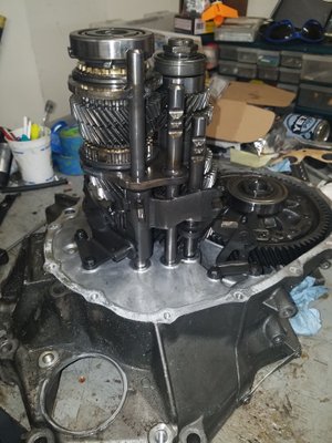

Just got real when i pulled the tranny apart...
Going to re-seal the tranny and throw in a lsd block.

Installing a LSD block.
While it's all apart, going to put new seals in it.

Re: Ktuner and the D17
LSD block for a d16 does not fit a d17 tranny....
I will be putting my lathe skills to the test this week cutting the differential gears down so everything will fit.
Man, nothing is ever easy with this 7gen...lol

After cutting the inner large gears lip down the lsd block fits and is installed!

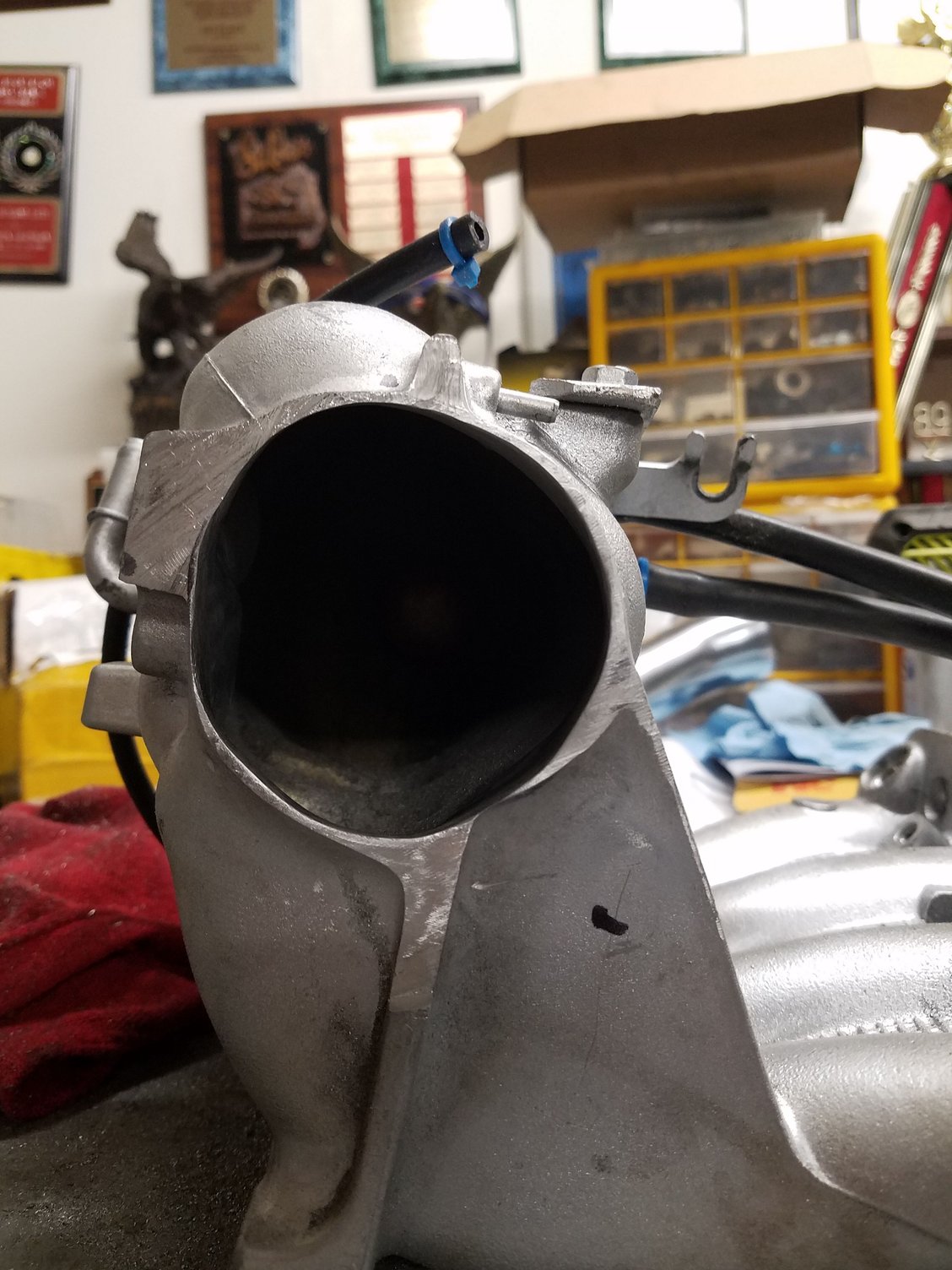

So last night i cut off the throttle body flange of my D16y8 intake manifold and started porting the opening from the stock opening to 70mm.
I cut the flange off because it didn't look like there was enough material for a 70mm hole.
I made a replacement aluminum flange that will accept a 70mm D series TB...now i have to rewire the TB sensor to accept the old version.
I have a buddy who is going to tig weld everything back up. I'll post up pictures tomorrow.

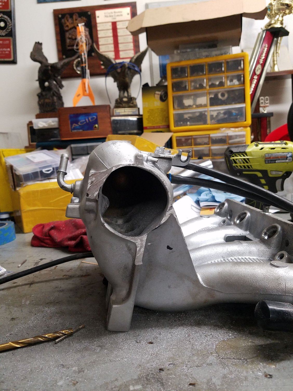

I cut that little tab off
Hand placement is about as close as it's gonna get. Time for the tig!

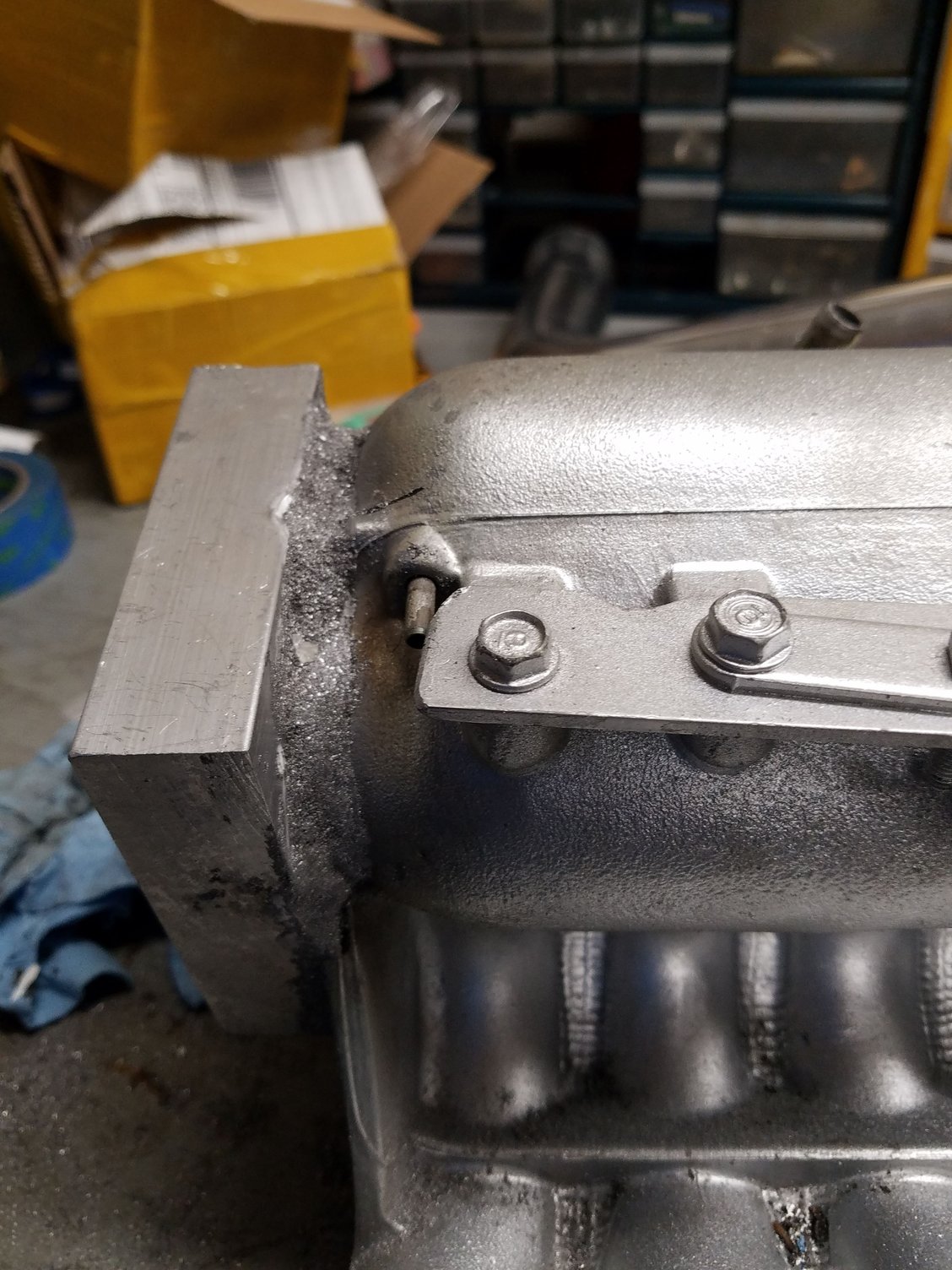

Not enough space to tig the whole outside so we did the whole inside and about 1/2 of the outside.
Used jb weld for the outside and as it was drying, i sprinkled grindings on the jb weld. My theory is it will help strengthen the bond but also makes it look nicer...
