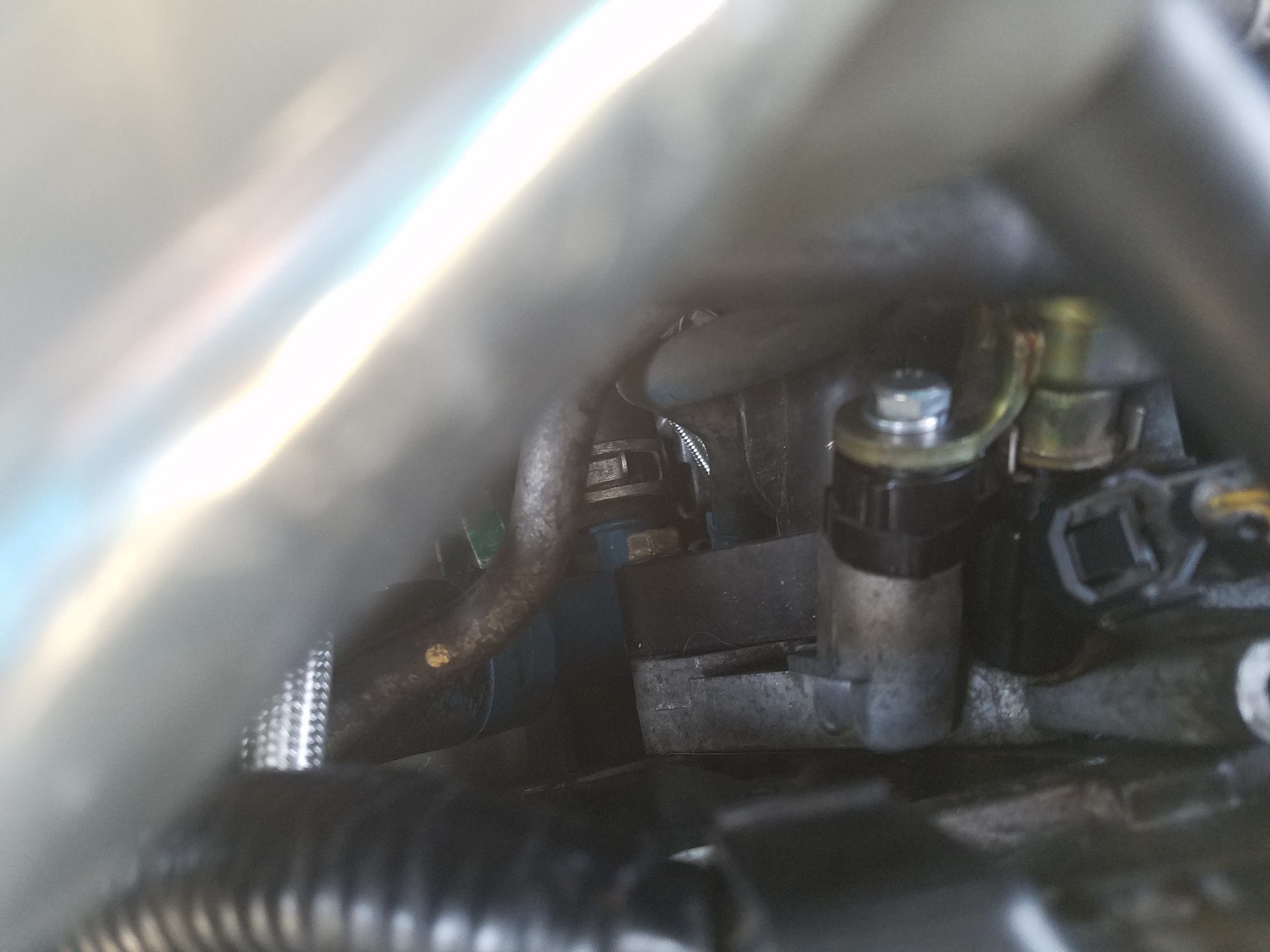

Added the 660 cc injectors last night.
Since the new injectors are a bit taller, I added an extra black plastic washer traditionally used for the fuel rail along with a longer bolt.

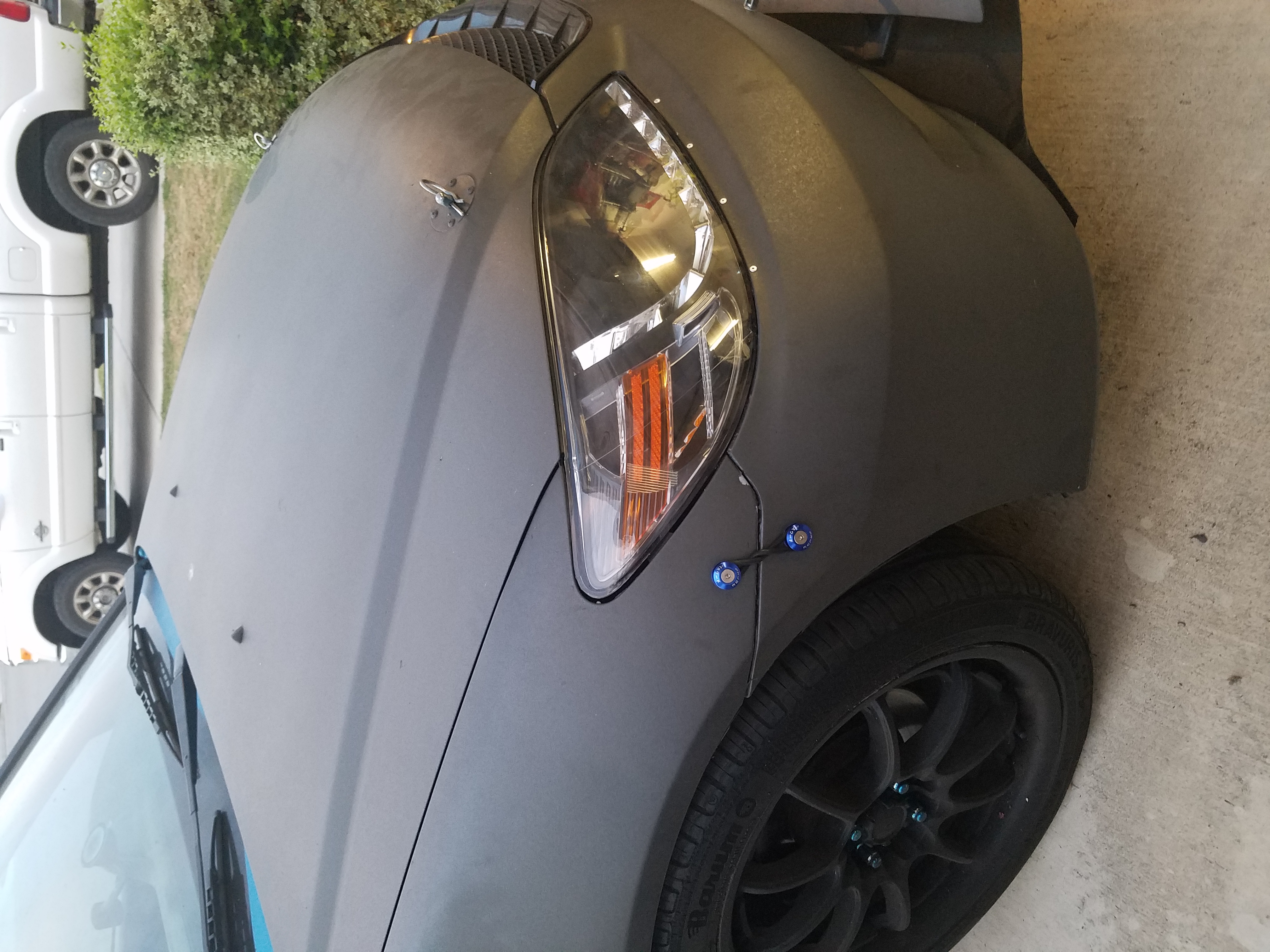

added these fun quick releases last night as well...

upgrade those hood pins to some flush-mount aerocatch ones

because the front wing and stock car plastic help out soooooo much with the aero package i have....

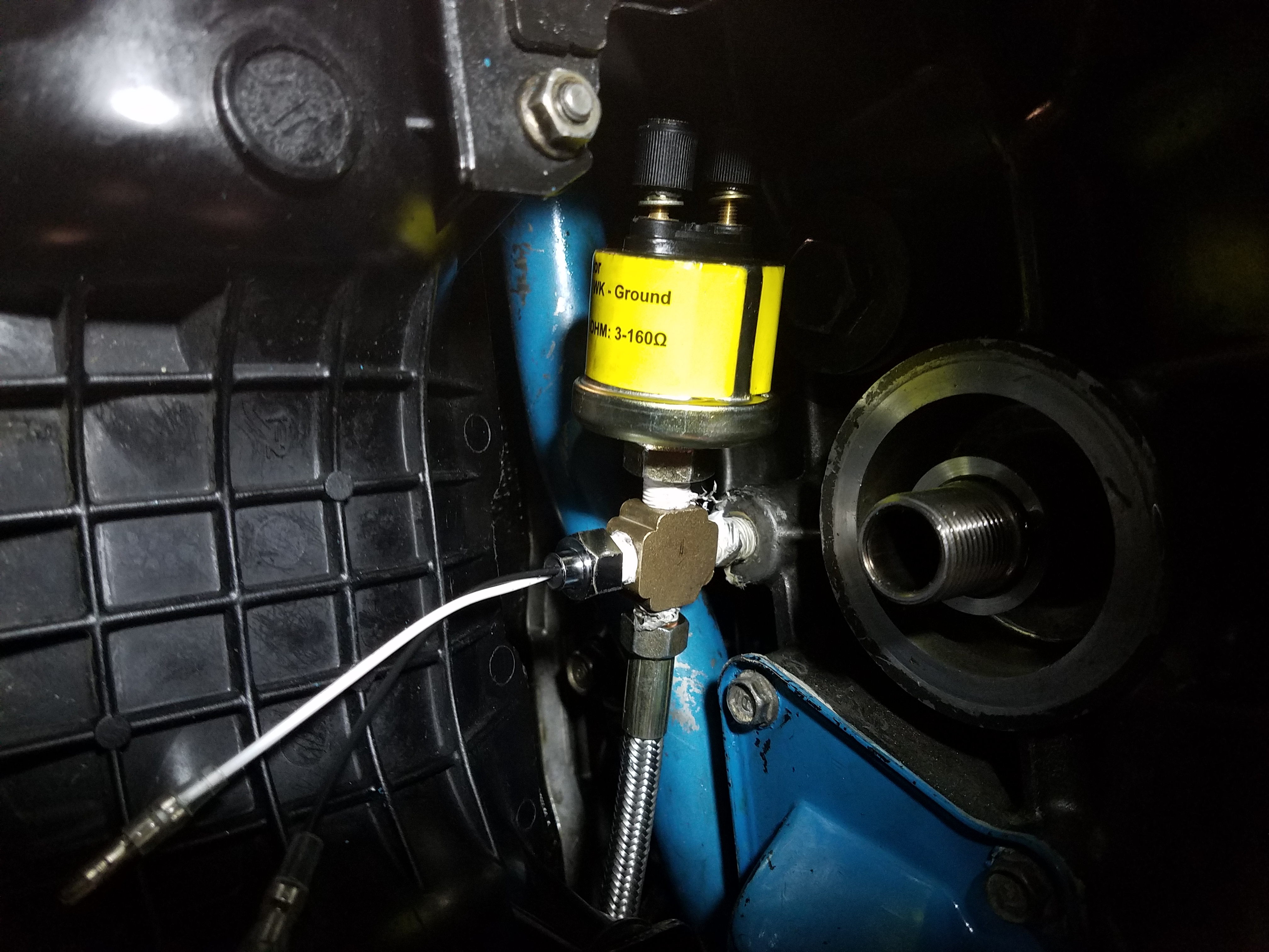

Last night, i changed out the oil distribution block that the turbo oil feed and oil sensors come out of. I had a small oil leak coming from that area. Sure enough, the original brass block had a crack in it. I guess i don't know my own strength...
Took the rice rat out for a test drive last night....
These things come alive when the boost kicks in.
I took my last tune and added 25% fuel to the whole fuel map so i wouldn't be too lean.
BTW i switched back to the stock injectors for the time being. I couldn't get the car to start with the 660cc's. That will be for another day.
Anyways, car came alive on WOT!!!!
Engine ran way lean on idle and way rich on WOT. No biggie, got home and made my fuel adjustments.
Now i have an oil leak coming from the oil drain line.... I'm sure this is an easy fix.

So all the connections where good...the line actually had a small tear in the middle of it.
fixed it and now no leaks!!!!

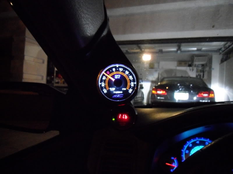

Here you go, night time illumination pics. I'm pretty sure the boost gauge was hooked up when I took this pic, hence the indicated vacuum. As it sits right now, it reads right at 0
edit: only daytime pic I could find showing the gauges. On the AC Autotechnic gauge, when the car is off, it's kinda smoked so you can't really see it, but when the car is on, the meter portion illuminates and you can see it just fine. The AEM gauge comes with 4 interchangeable faces, 1 black and 1 white of each AFR and Lambda reading. I have mine to read AFR with the black face.

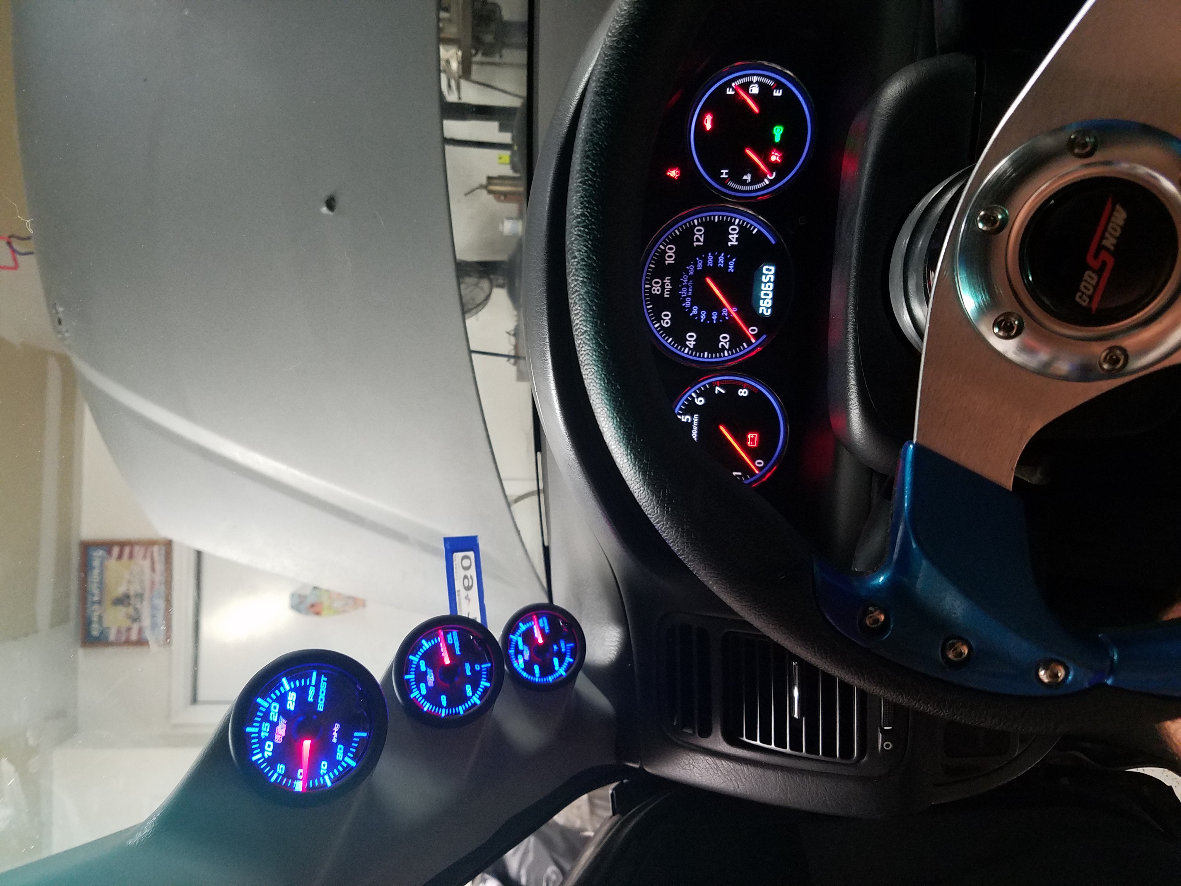

glow shift gauge pod delivered.
went with oil pressure, oil temp, and boost.
