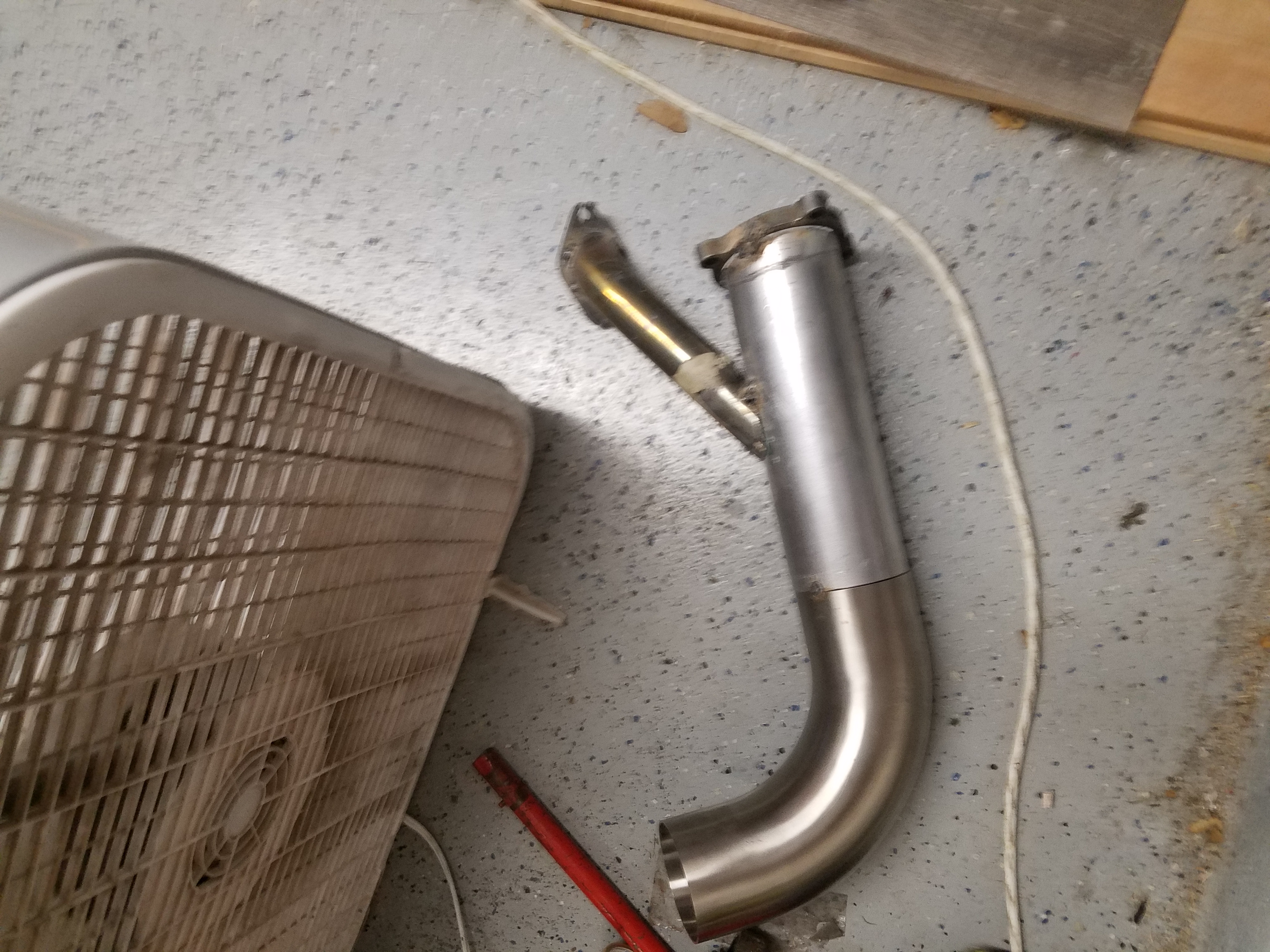

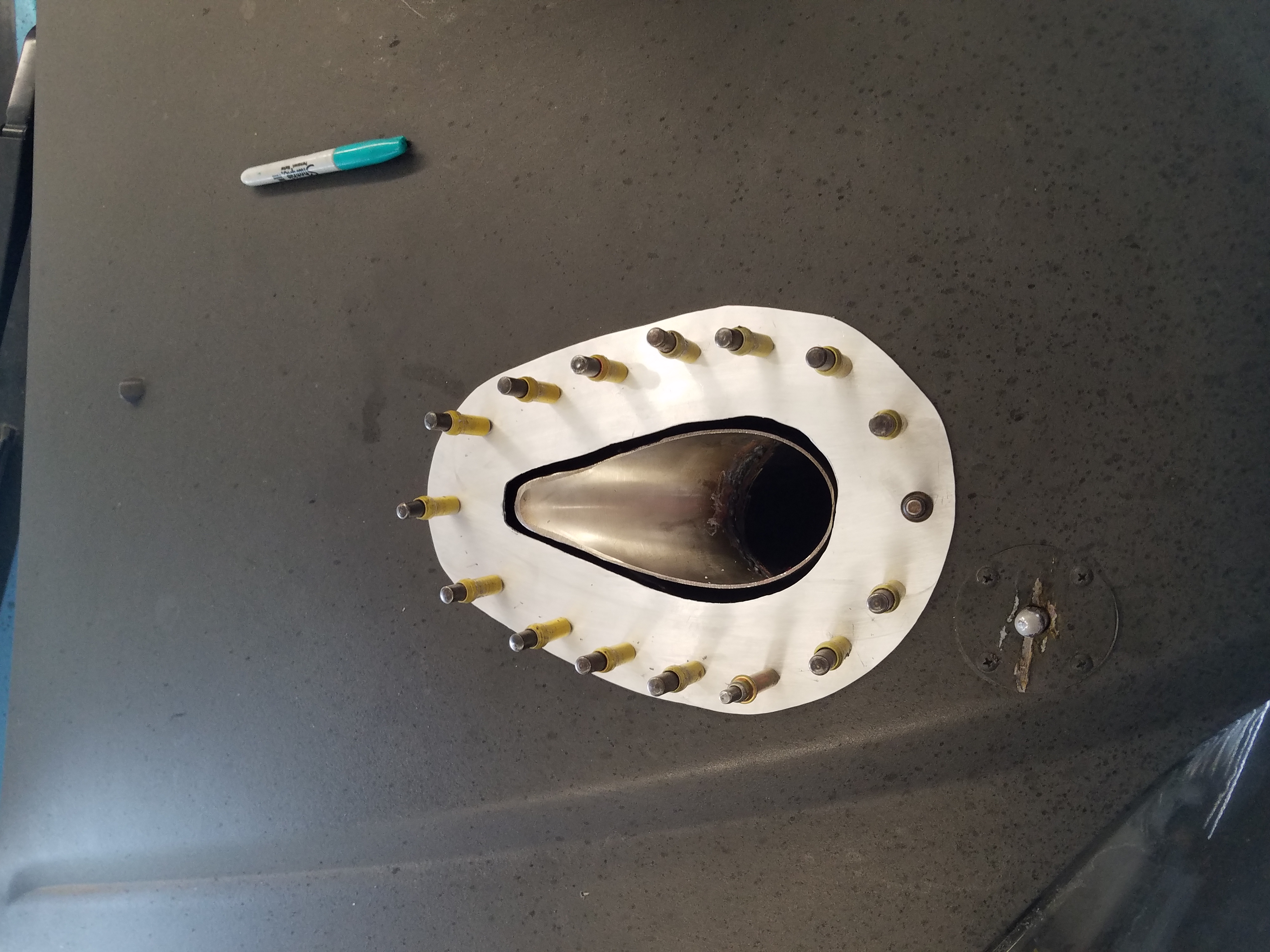

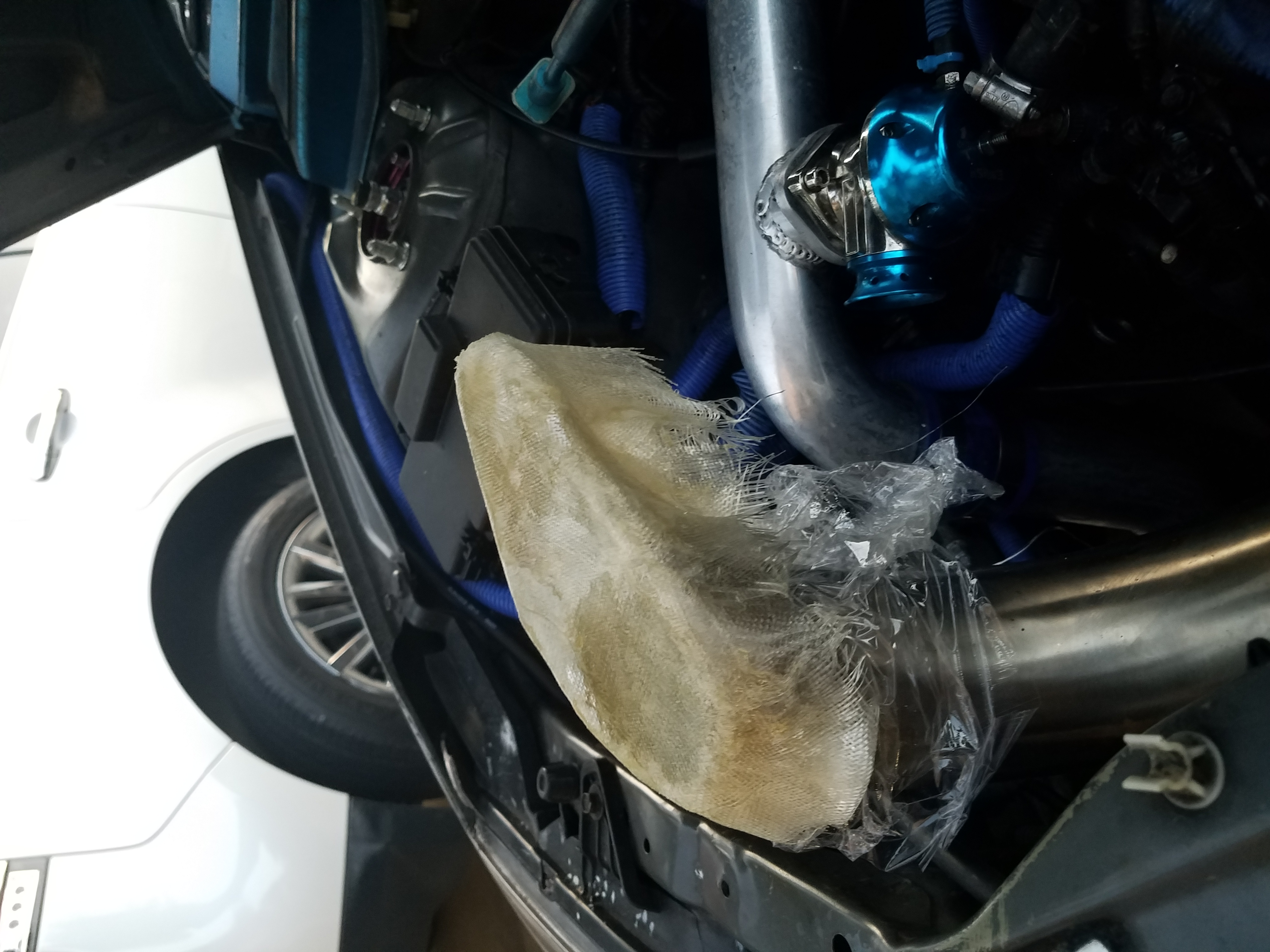

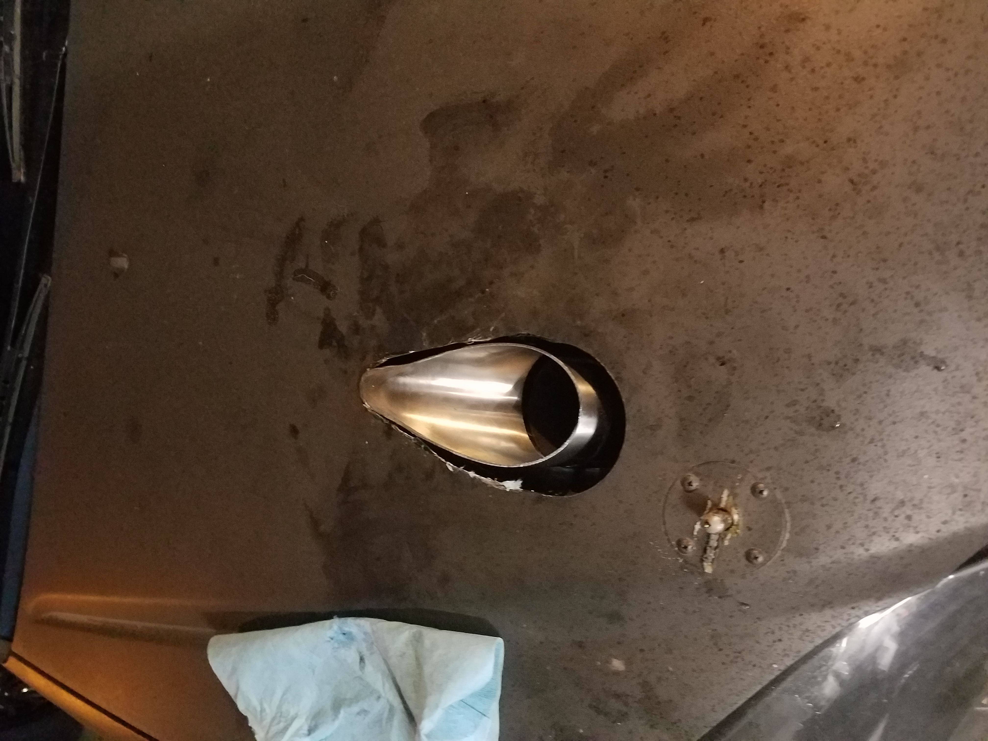

Re: Ktuner and the D17

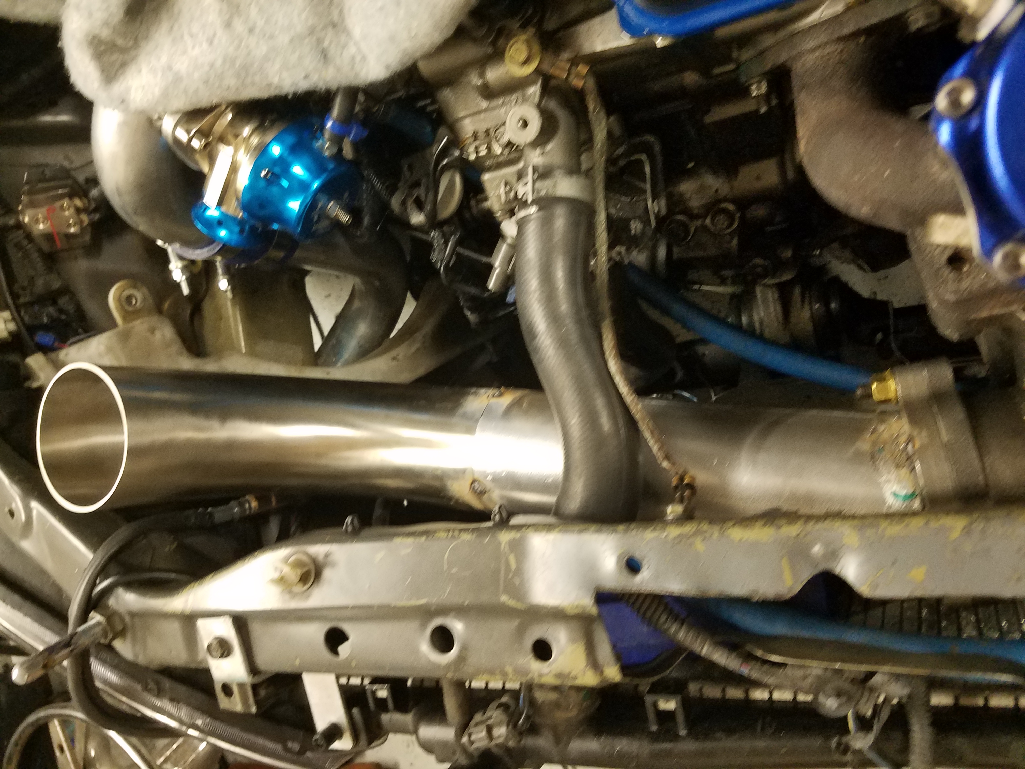

Exhaust is tacked together.
ID:	112103   Click image for larger version
ID:	112104   Click image for larger version

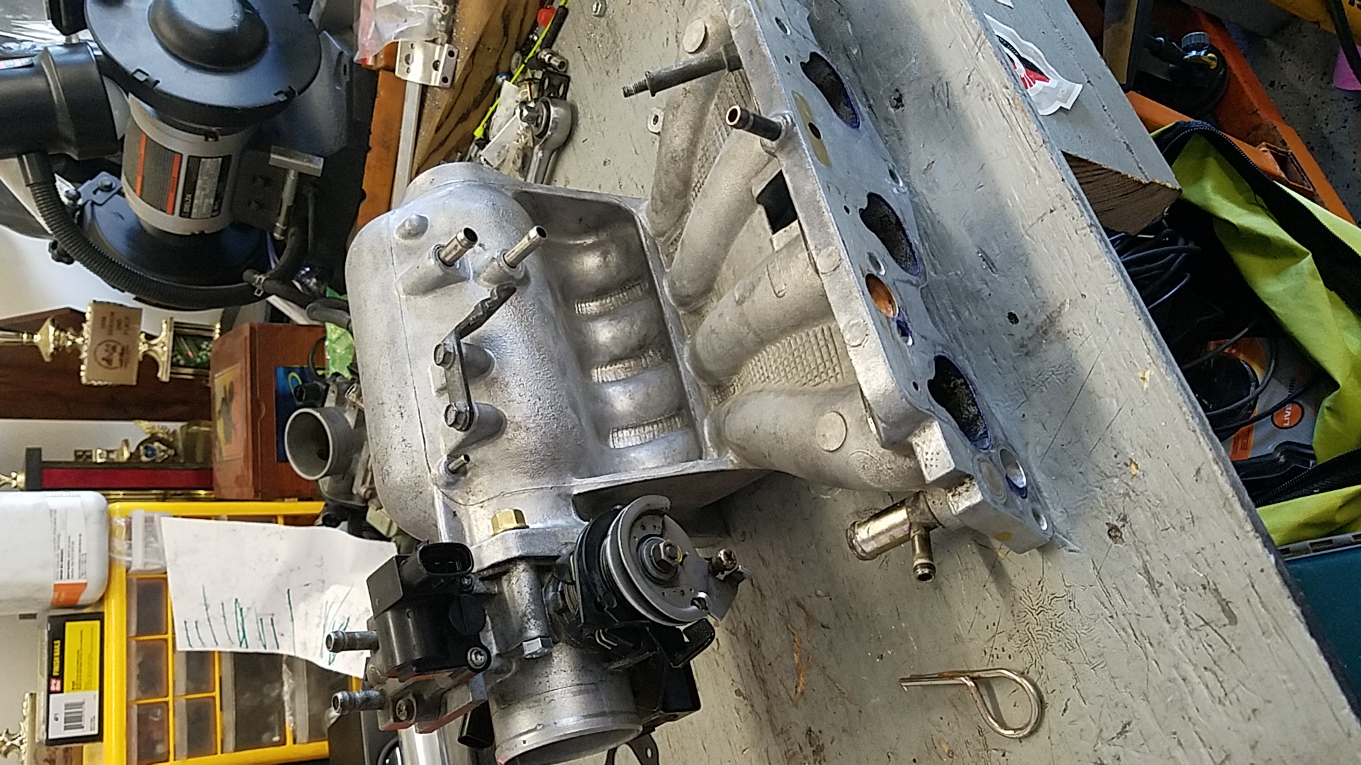

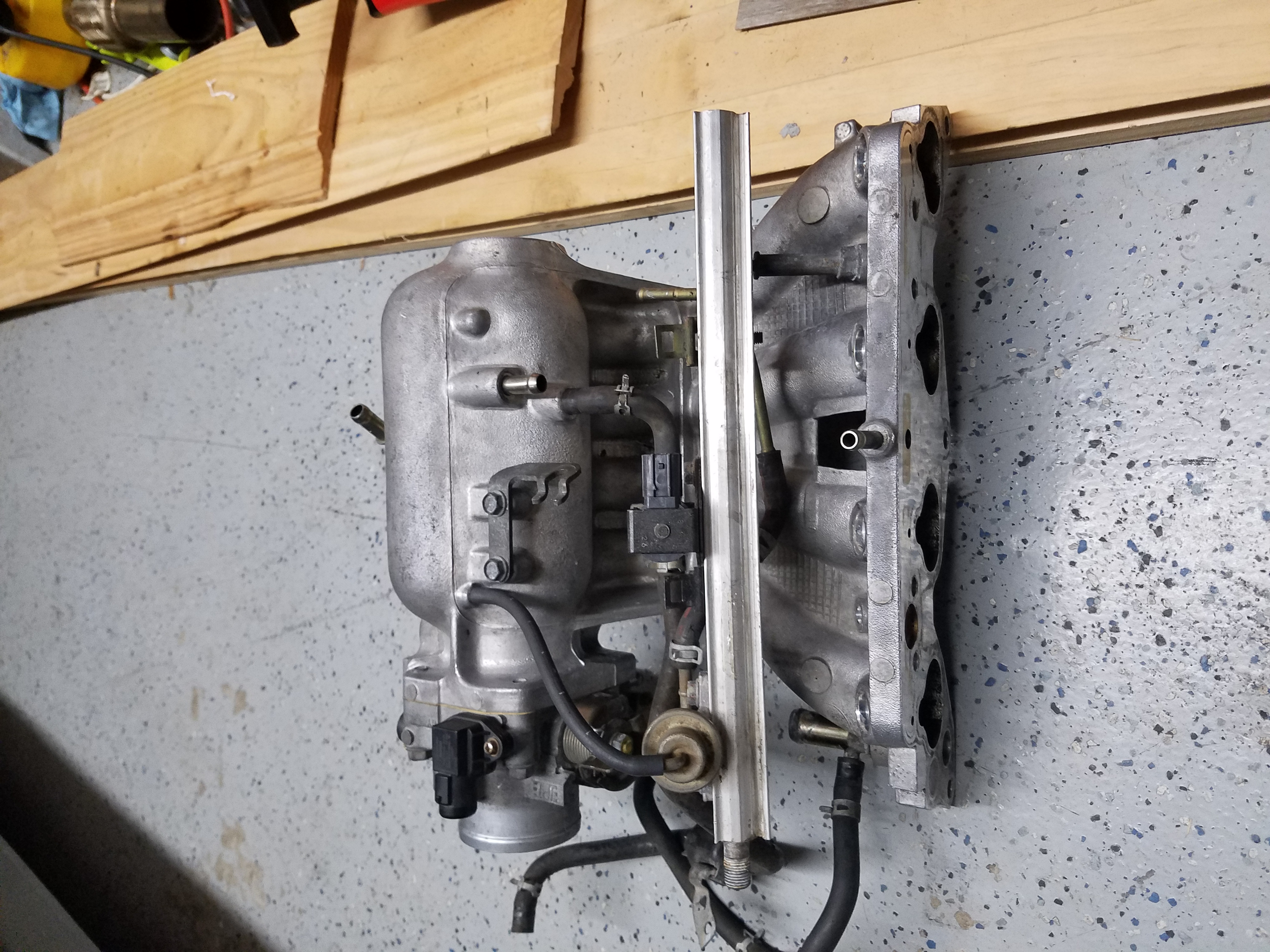

Things are starting to get real.
My plan is to cut the flange off and have the d17 aluminum flange tig welded in its place, that way i can use my new 800cc injectors.
Also, when it comes time for the dyno, I will have official numbers on how much this intake helps.
I'll make a few runs on the the plastic intake then switch over to this one. I'll use the same injectors, injector rail, and throttle body on both intakes, same sensors, and same boost amount.

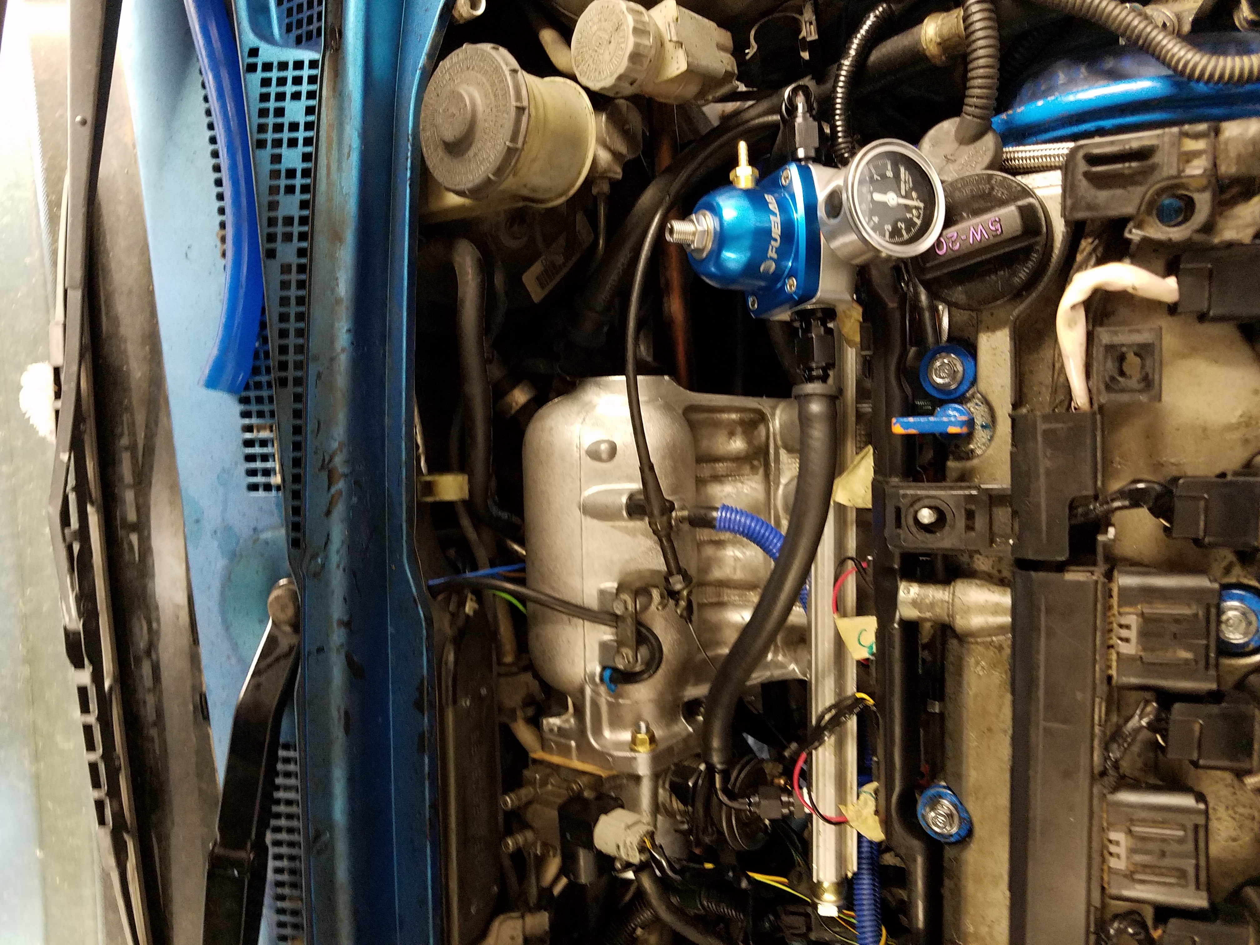

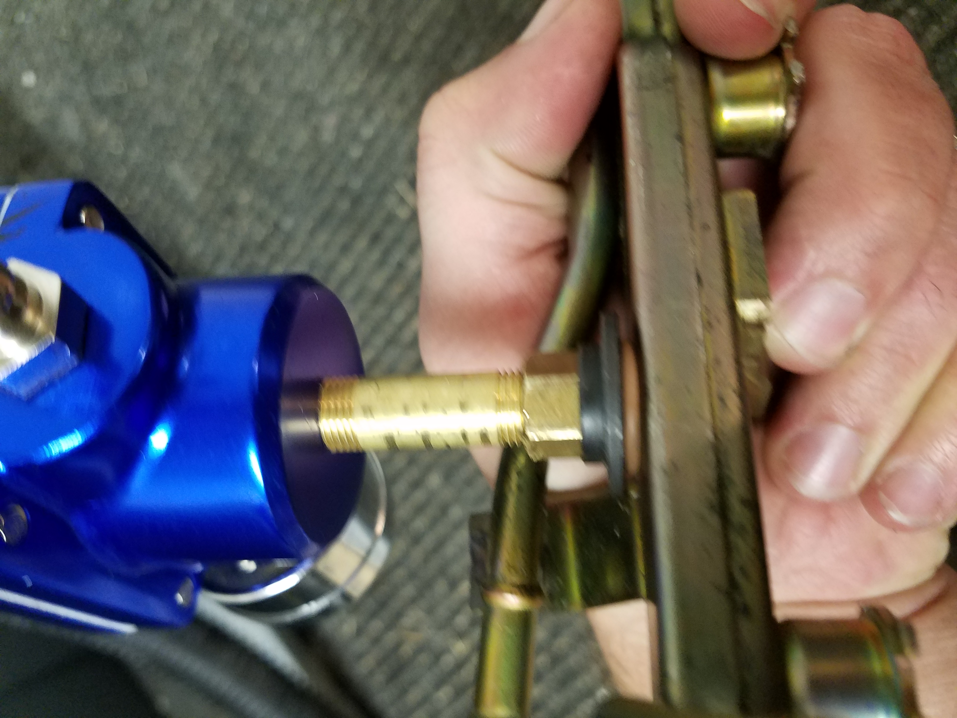

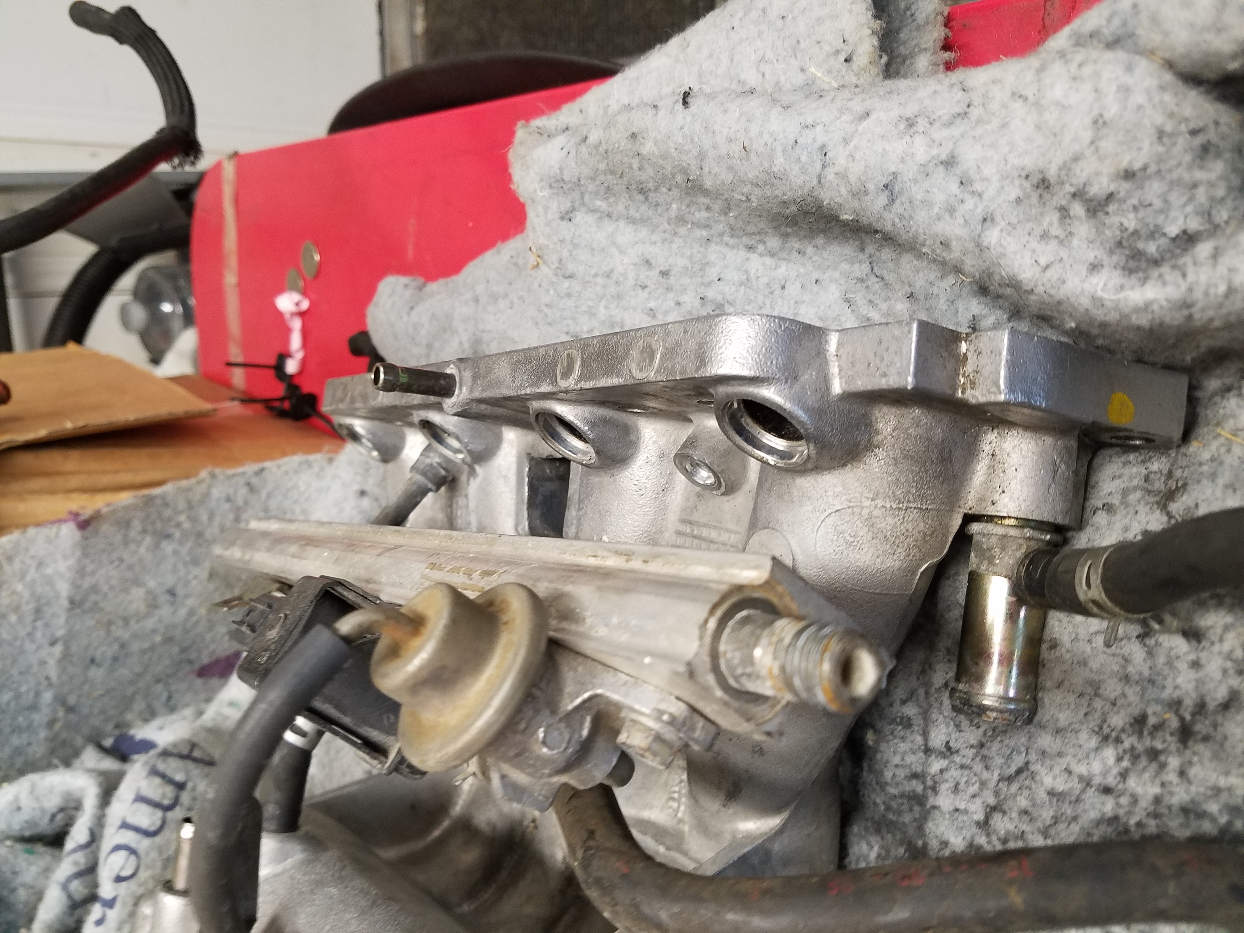

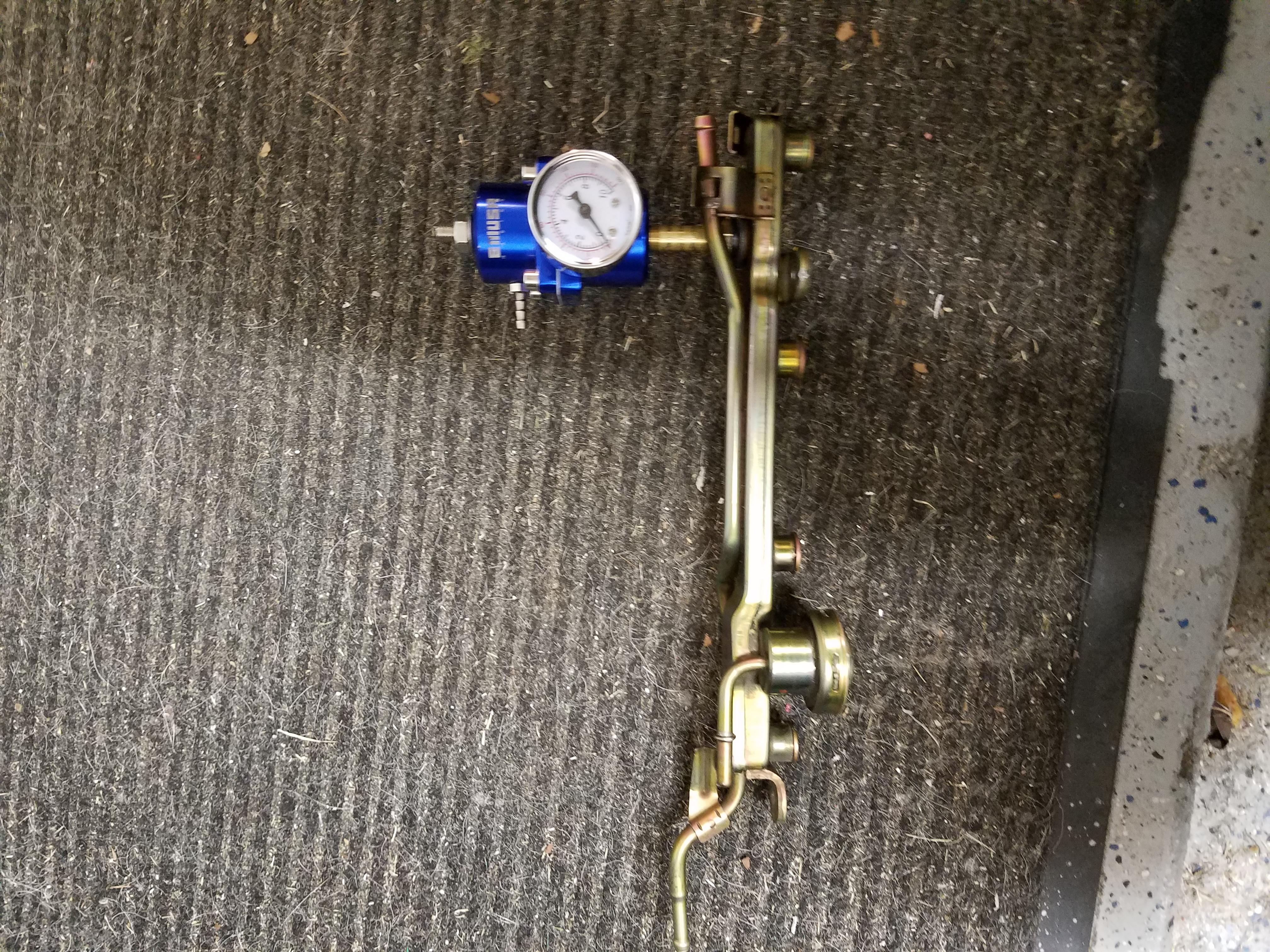

Modified the oem Fuel Rail last night...
ID:	112124   Click image for larger version

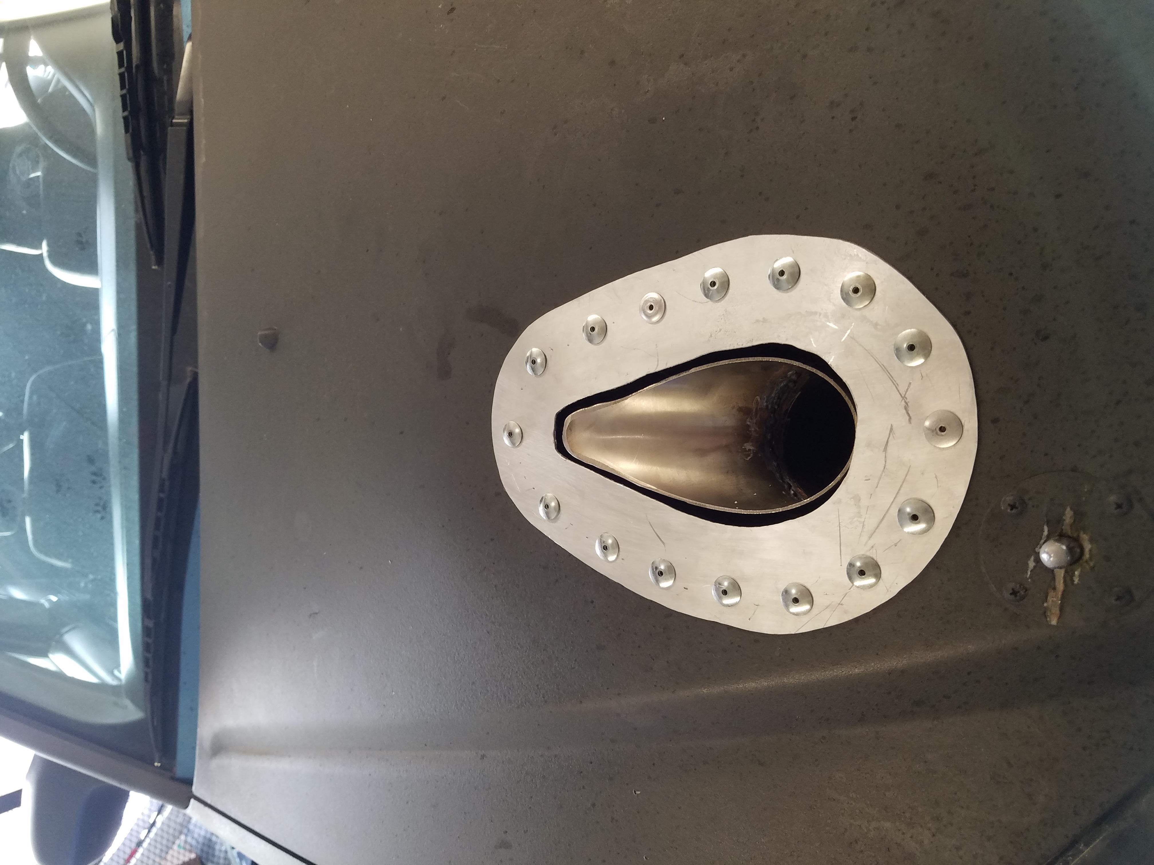

I'm looking at buying this exhaust tip for my hood

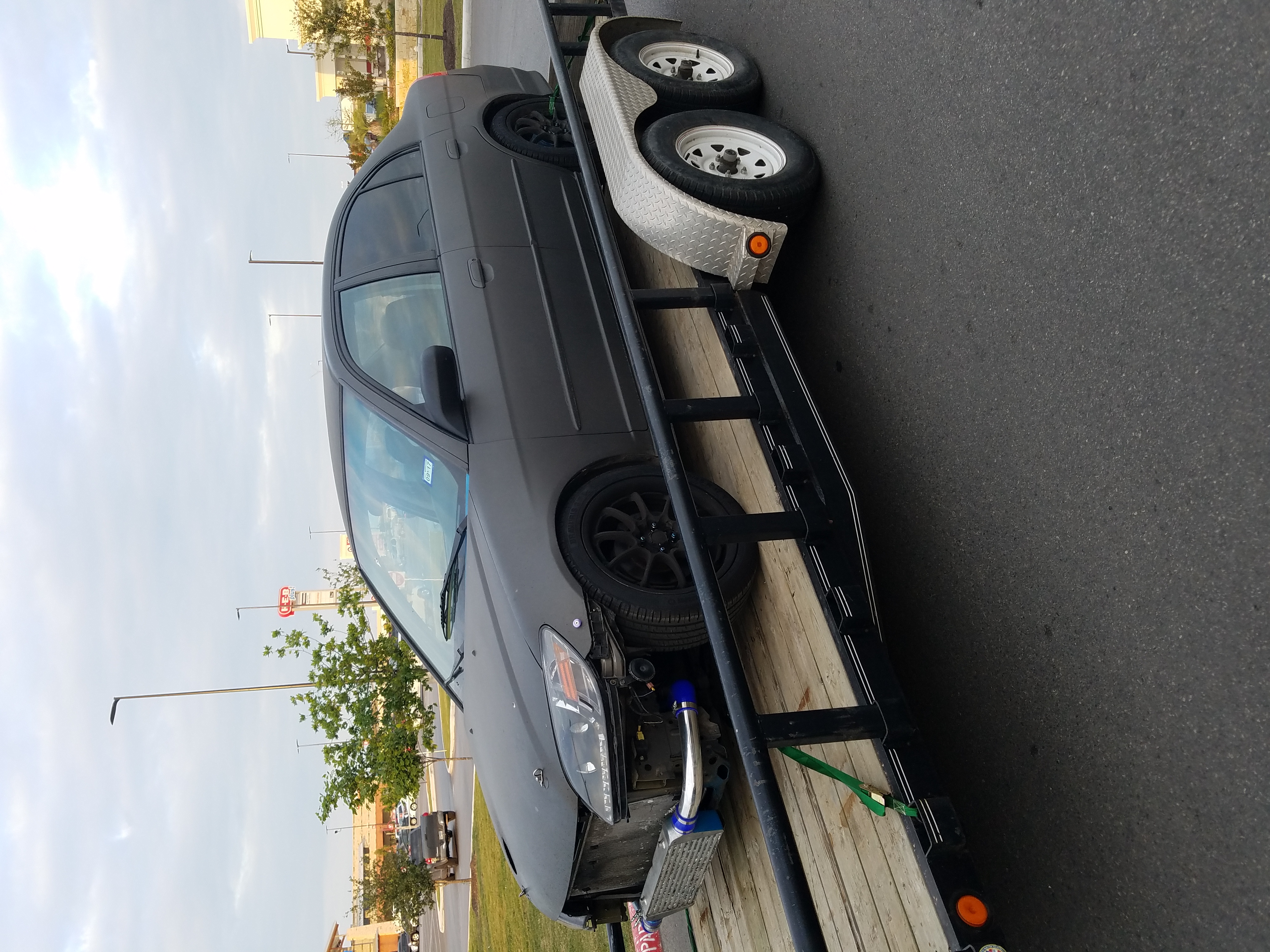

Loaded up and ready for my tune.
Drained tank yesterday and filled up with E85.
Chad Berryhill with Chadata Tuning in San Antonio gonna be working his magic tonight.

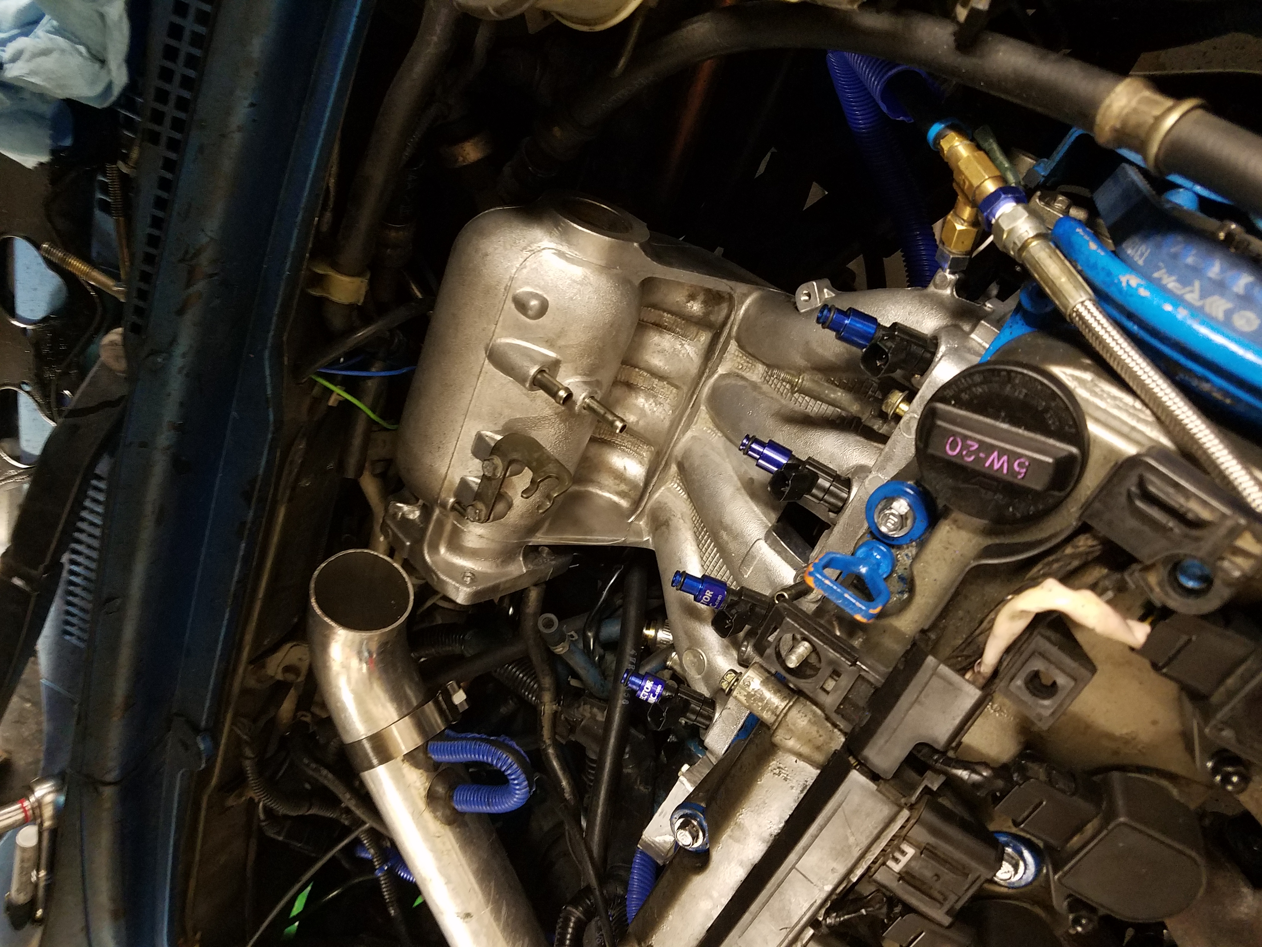

Mock fitting of the d16y8 intake manfiold done this morning. Also installed 6an snap lock fittings on the inline fuel pump along with new fuel line able to handle E85 and methanol this morning
There is not much room for error with this manifold.
Going to use the stock d16y8 fuel rail with injector top hats.

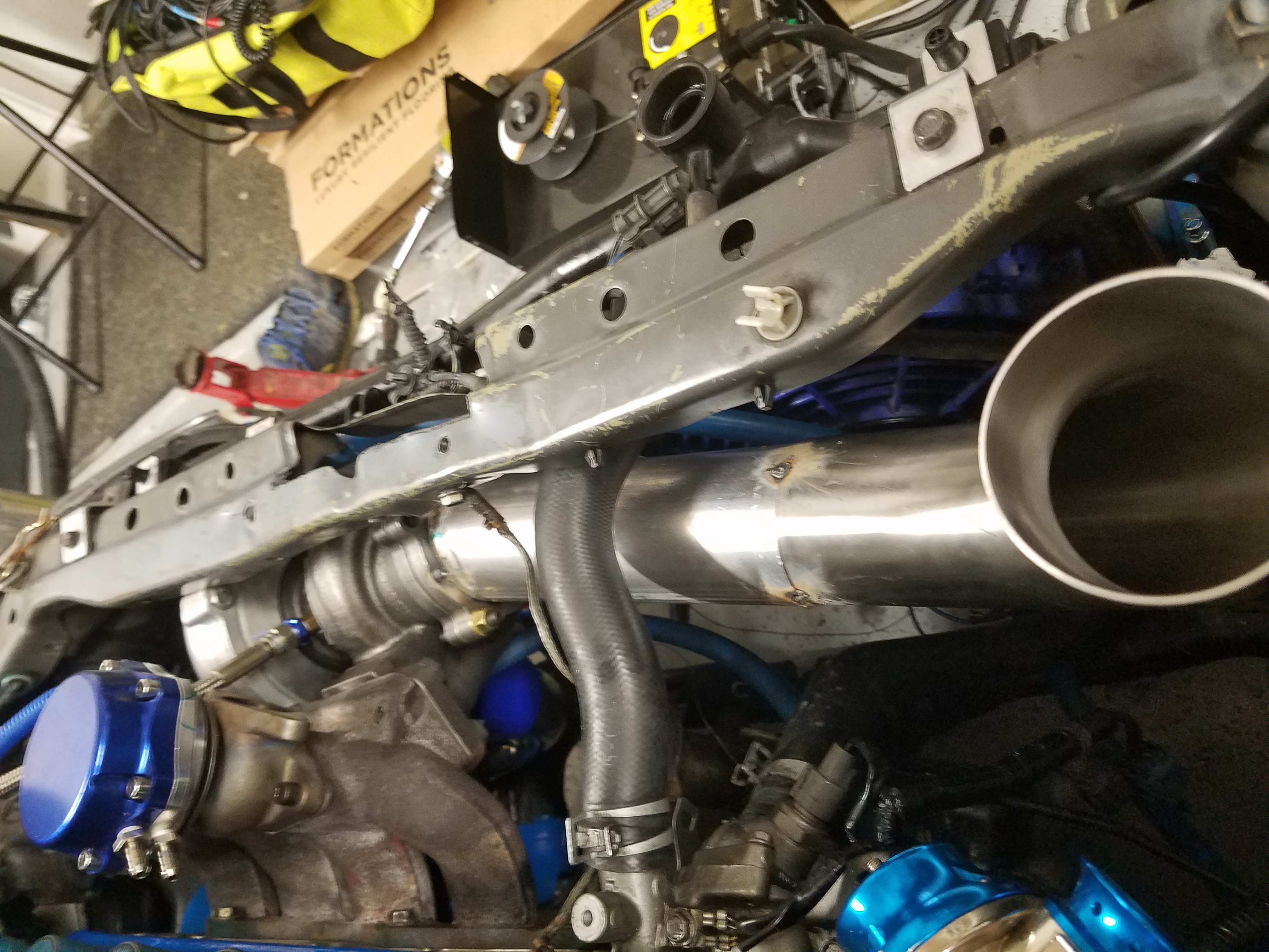

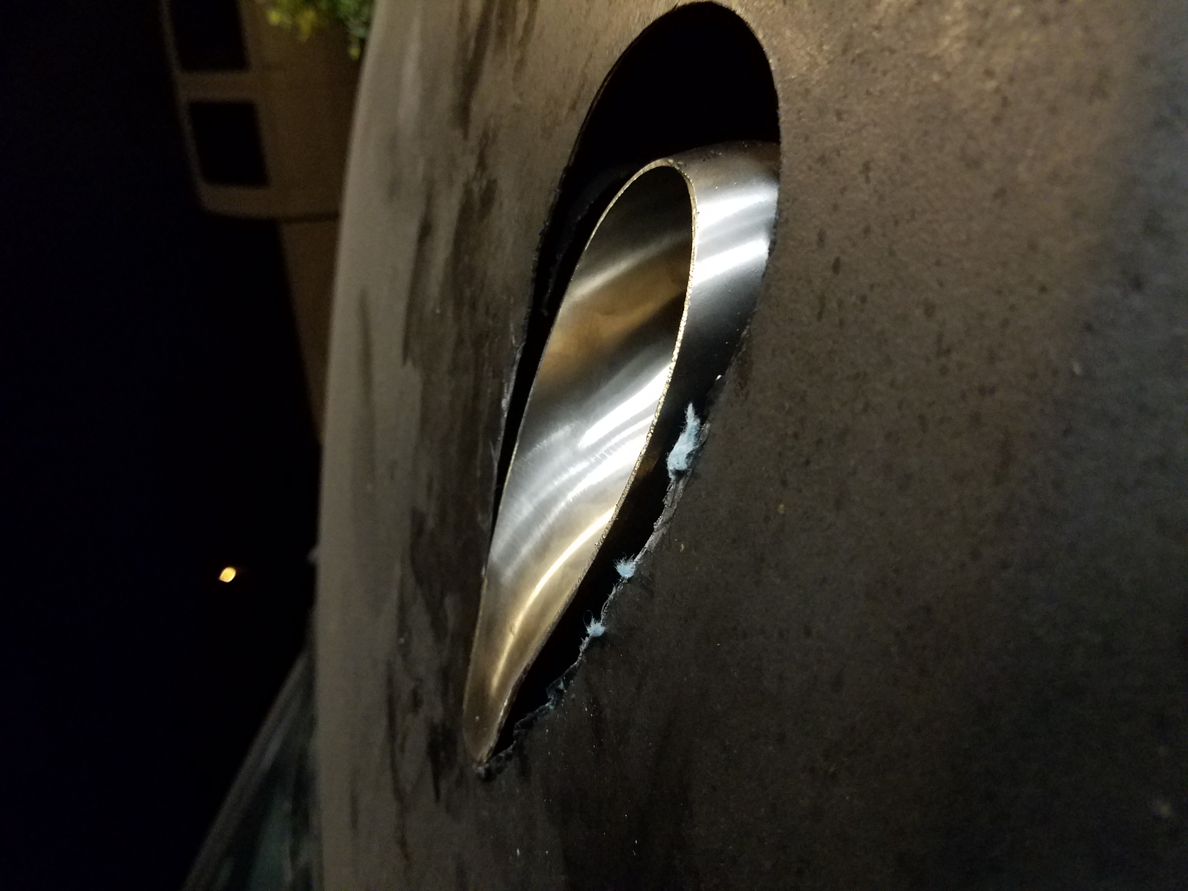

Worked a bit last night on my exhaust...

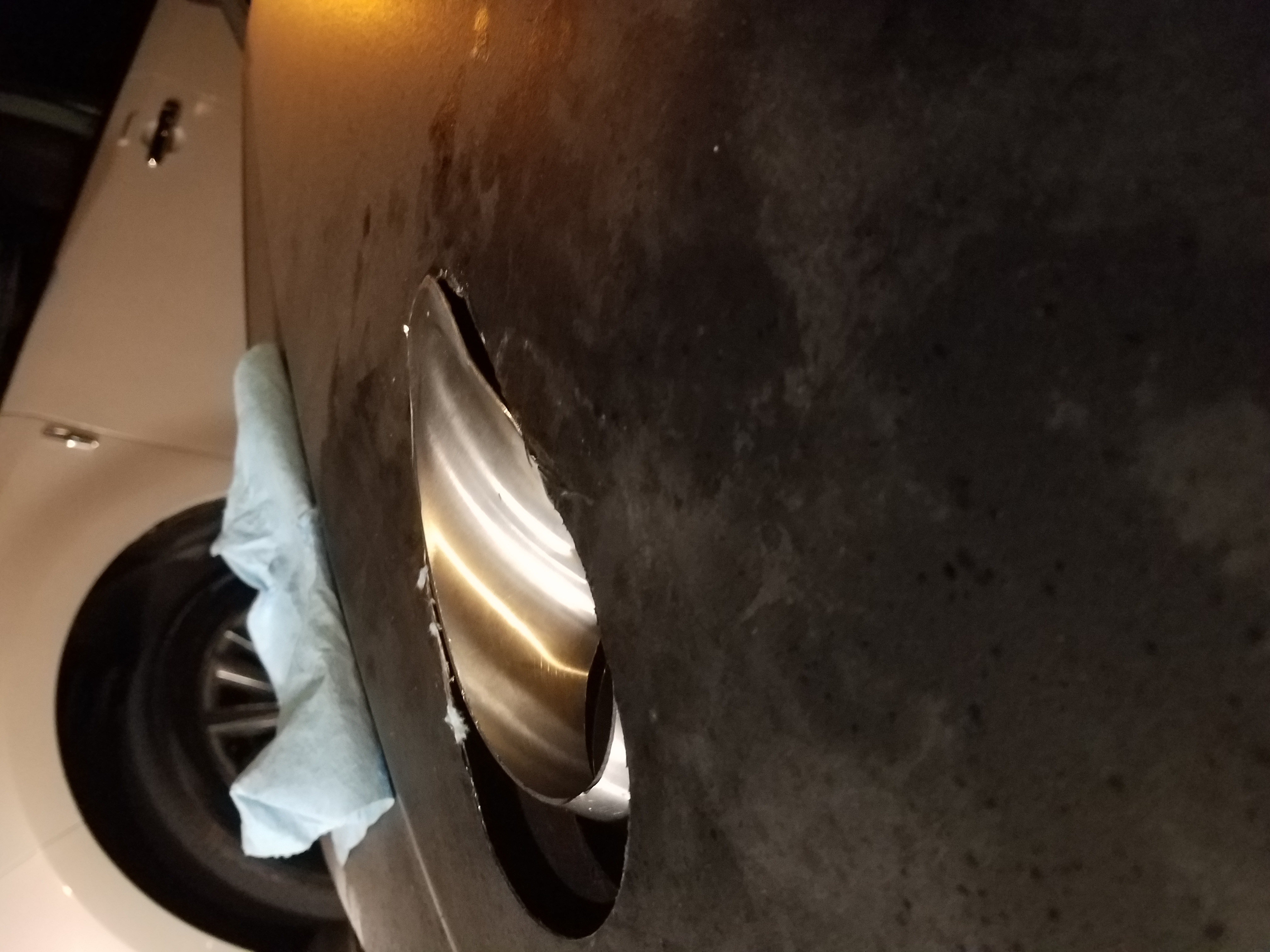

Got to break out the clecos!
Exhaust is finally finished, now i can get the tuning finished....
ID:	112280   Click image for larger version

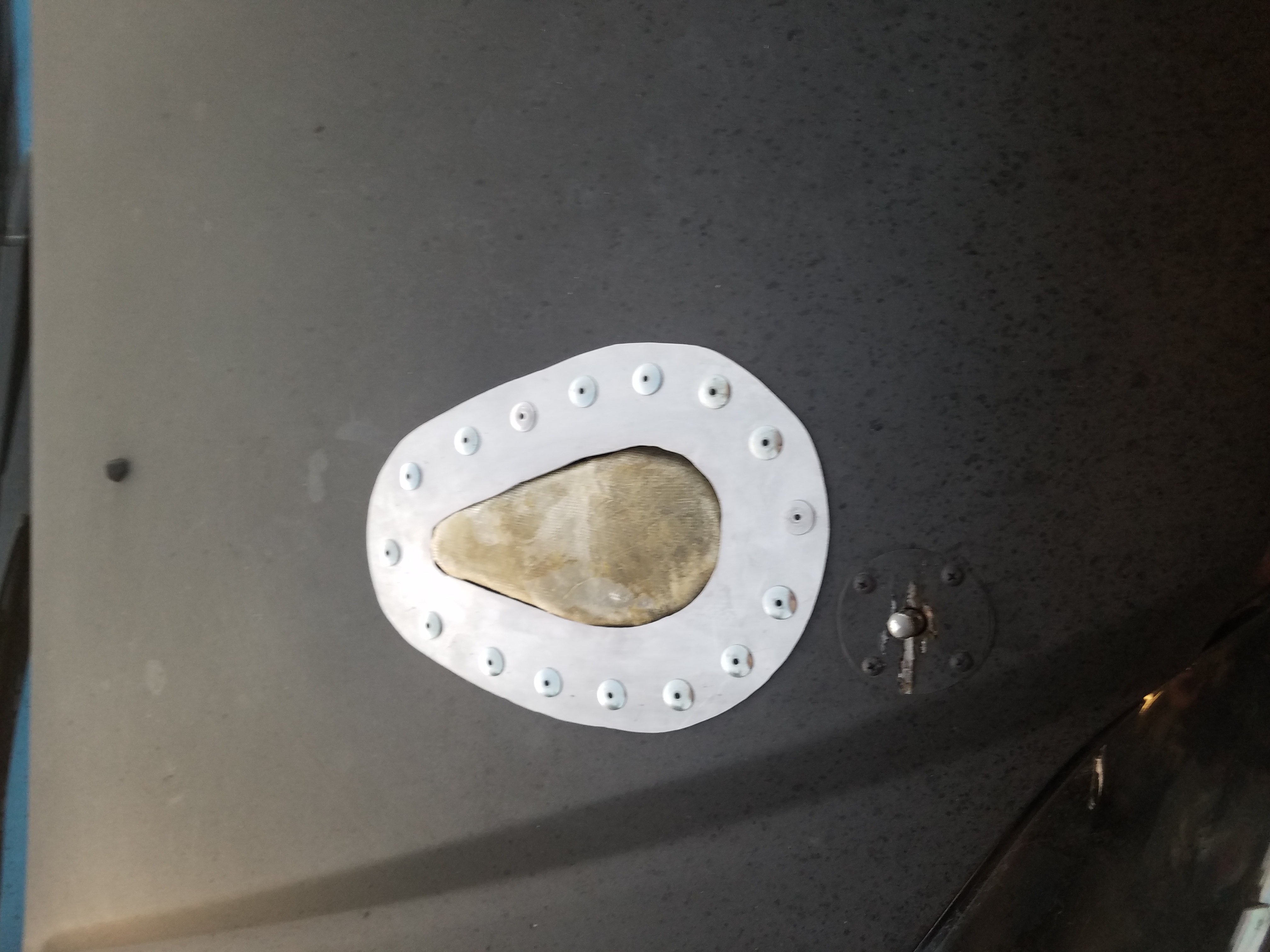

Thanks...
I made this last night out of fiberglass to help with the rain issue/jackass dropping shidizzle down the pipe...
just need to detail this up a bit.
ID:	112287   Click image for larger version
