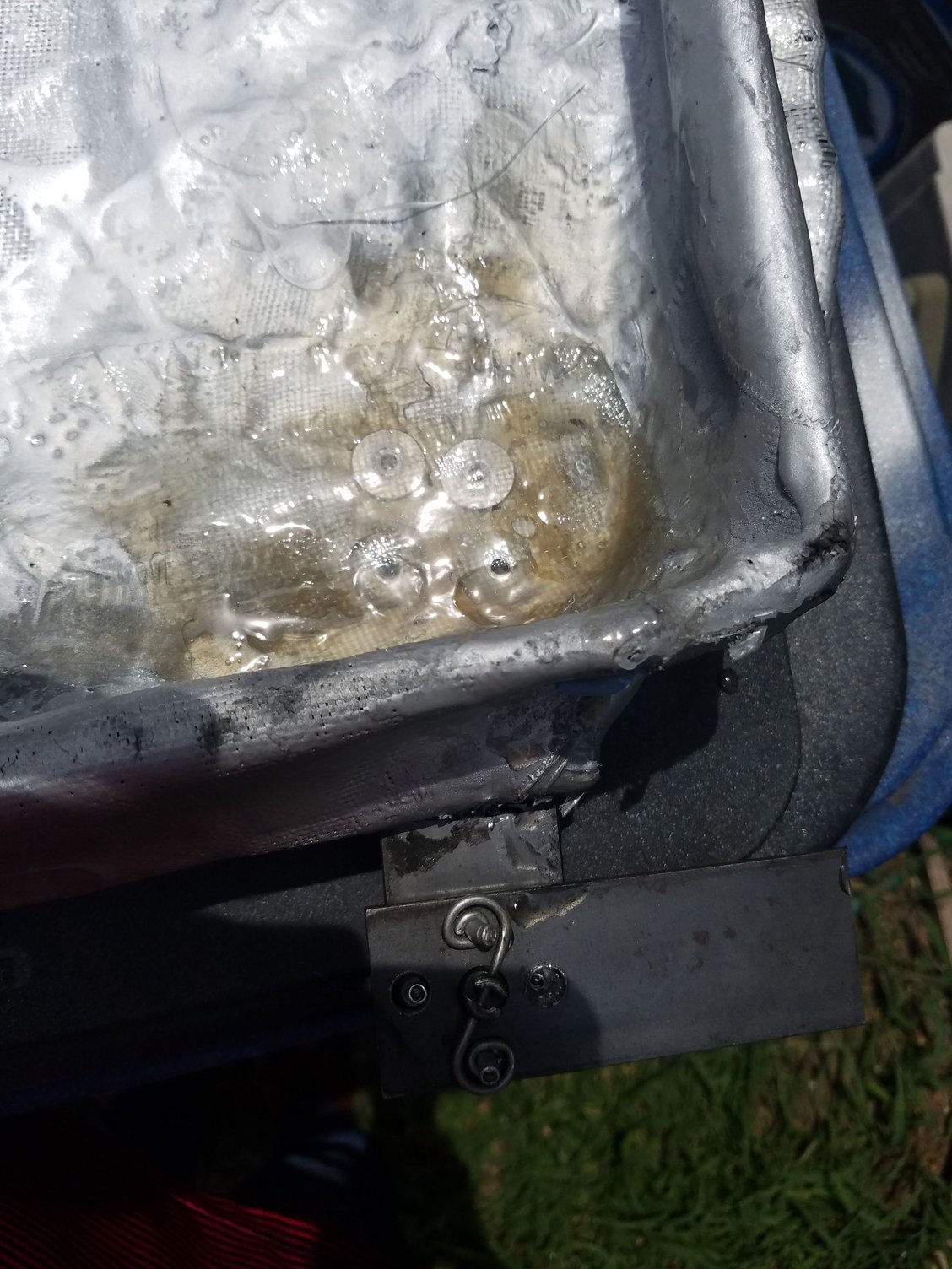

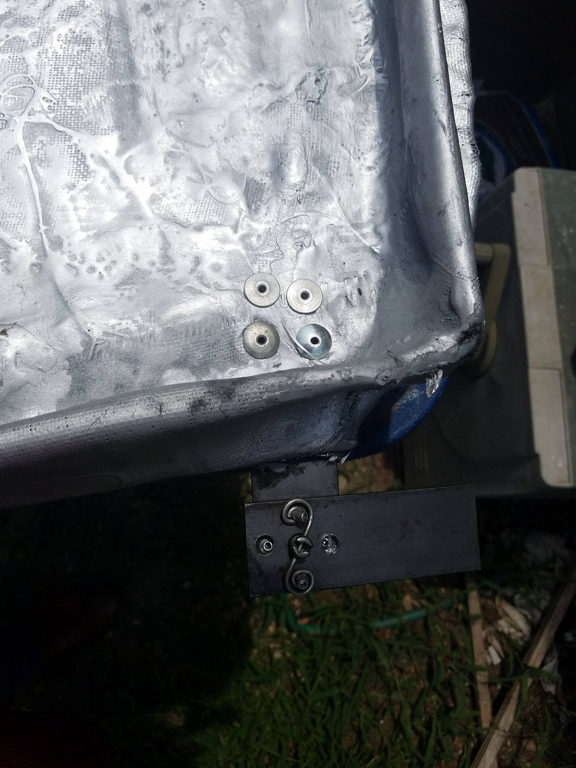

Pop Rivet the braces in
Bottom View
Fiberglass over rivets to help keep them from leaking.

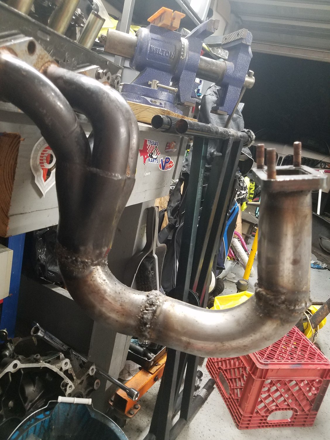

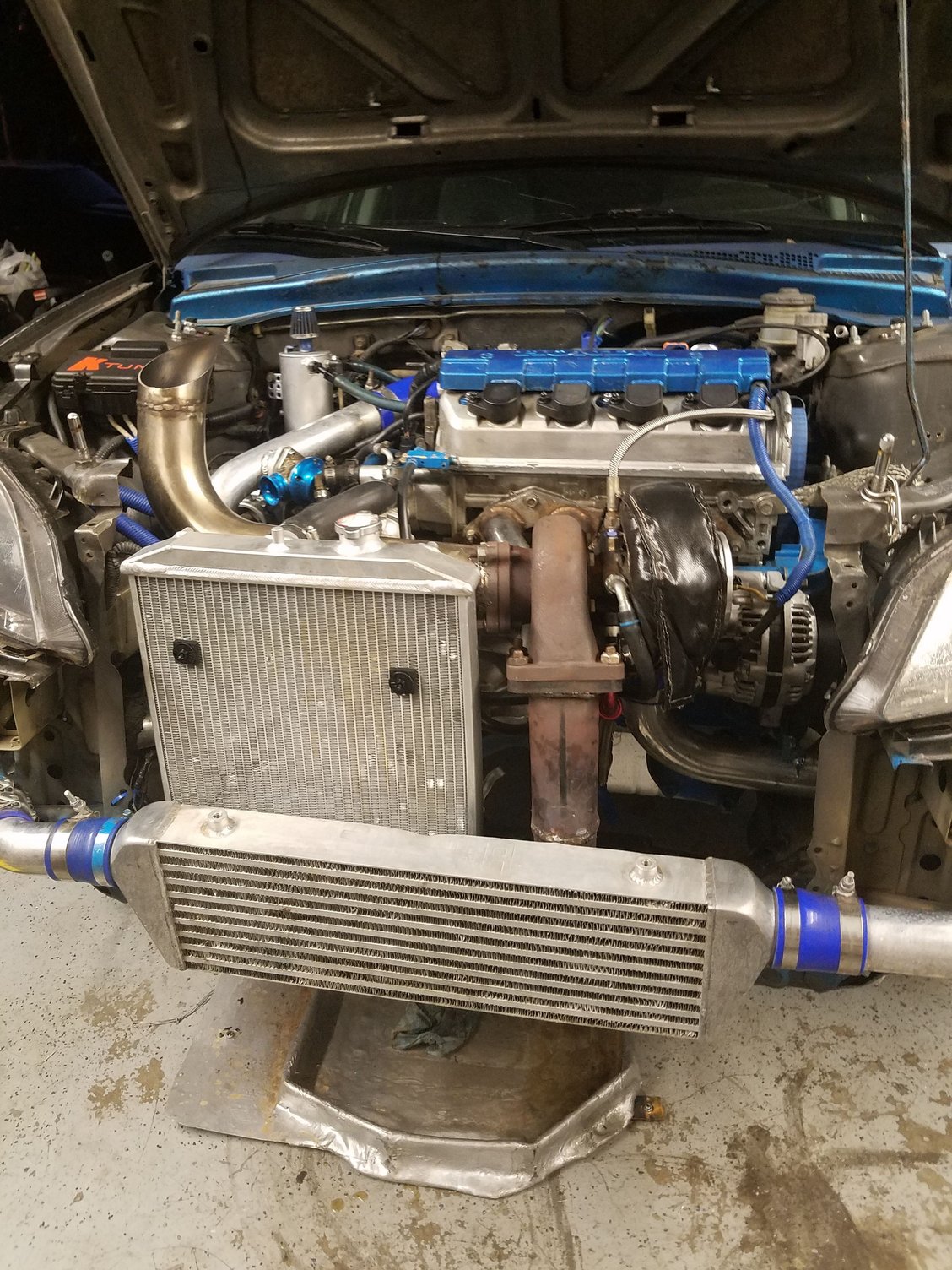

Time to work on a new manifold.
This is just a simple mock up.
Going to use mild steel since that's what i can weld.
I'll be utilizing a header built for the A-1 and going from there...

Here are some better pics of the mockup

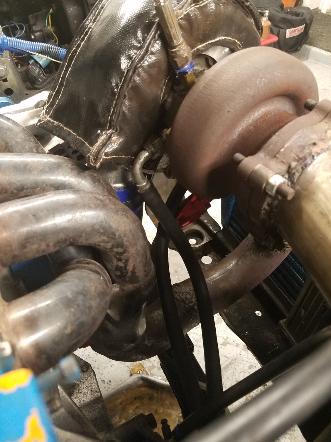

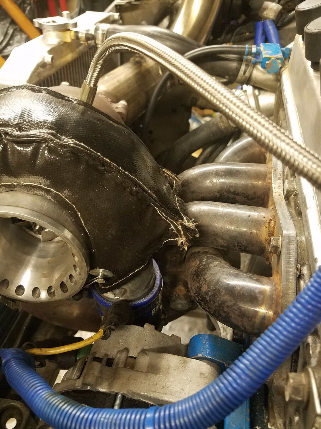

I had to do some extra welding on top of the welds....for pin holes.
It's mounted with the turbo in the car.
Started it up and man it sounds smooth...wayyyyy different tone.
I'll be mounting the waste gate and a couple of support brackets this week.
My welding sucks but it'll work!

I had to move the mount way out due to the turbo size.
My biggest issue was it hitting the alternator.

Hey it’s functional and doesn’t leak
A grinder and paint make me the welder I ain’t

Exhaust wrap will definitely be used...

Some more pics.
I'll be adding the waste gate tonight/tomorrow.

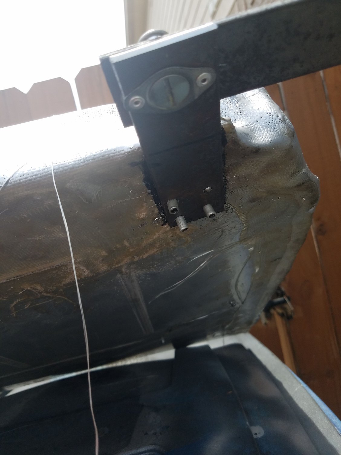

Waste Gate pics...
What crappy welds....

stick weld or flux core gasless? lol

flux core gaseless... i'm finding out that this = uuuuuuuuselesssss

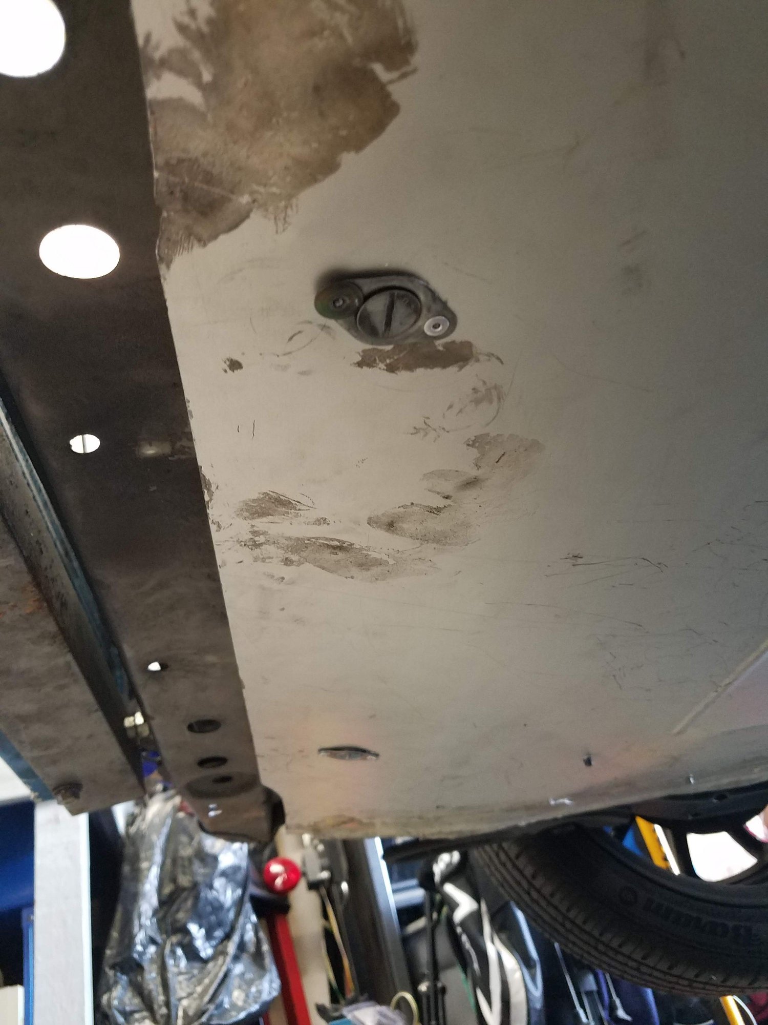

Random thought on that catch pan. What if you can up some mounting points to the subframe and put some structural reinforcement on it? It'd double as a subframe brace, no? It'd also be heavy as **** though. Lol
4 points is all i want to add to it.
the pan itself is aluminum/fiberglass. I don't think it will help with reinforcement that much...

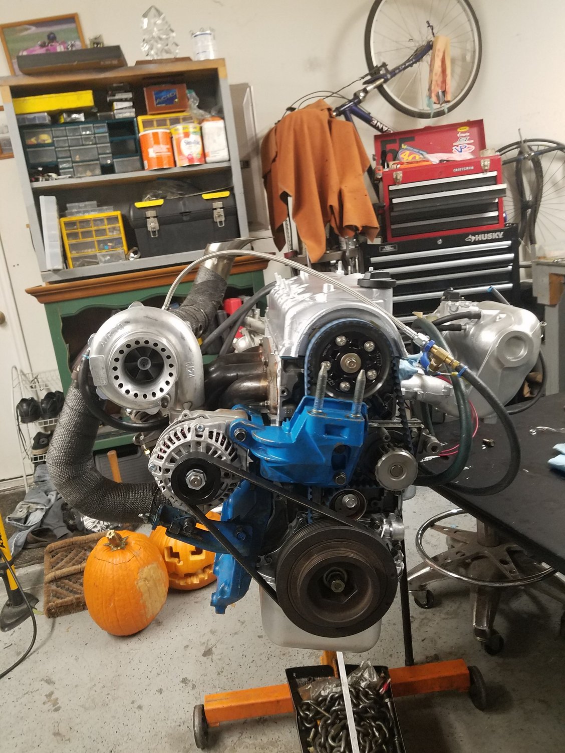

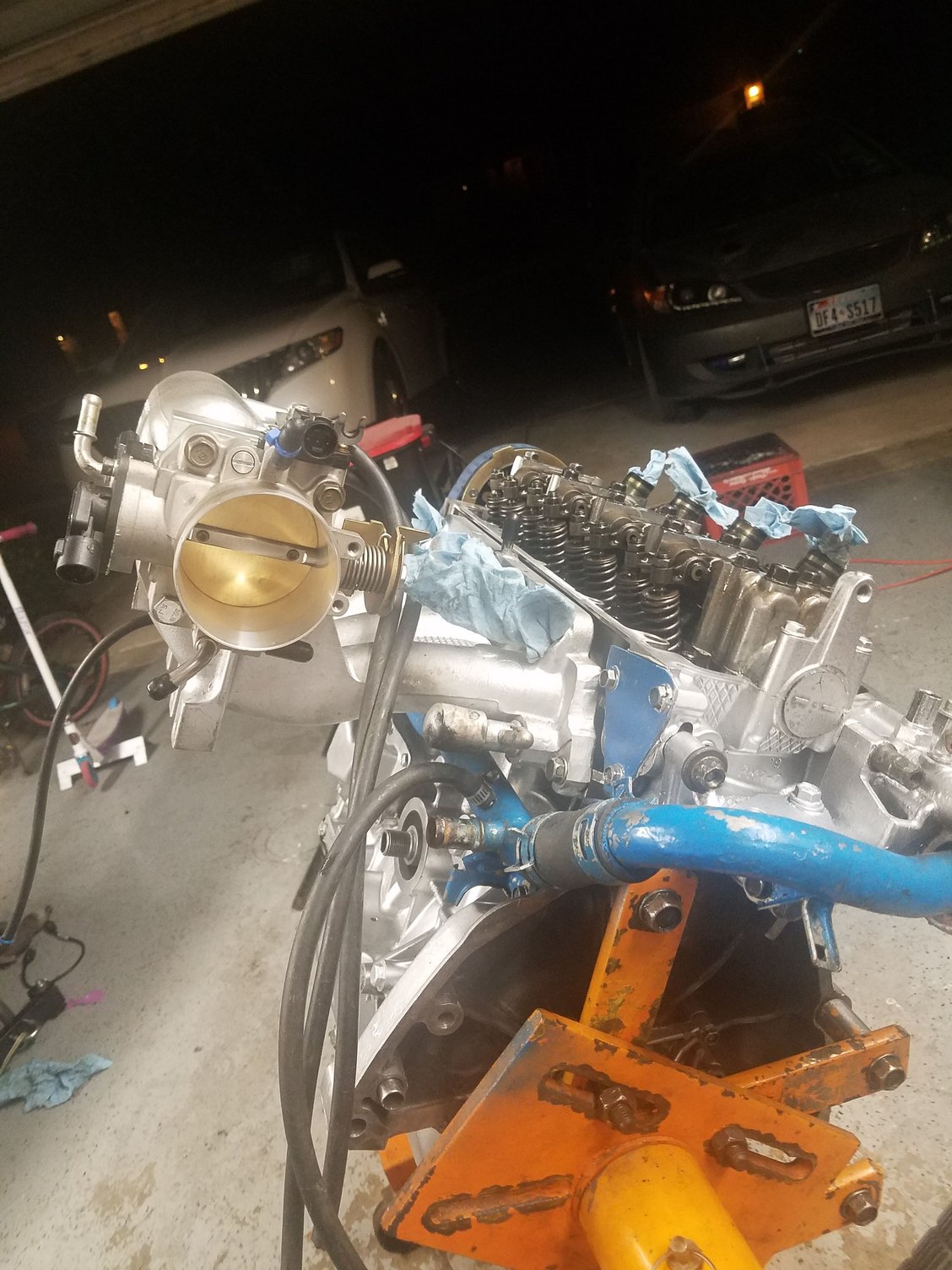

Finally getting the engine back together!!!
