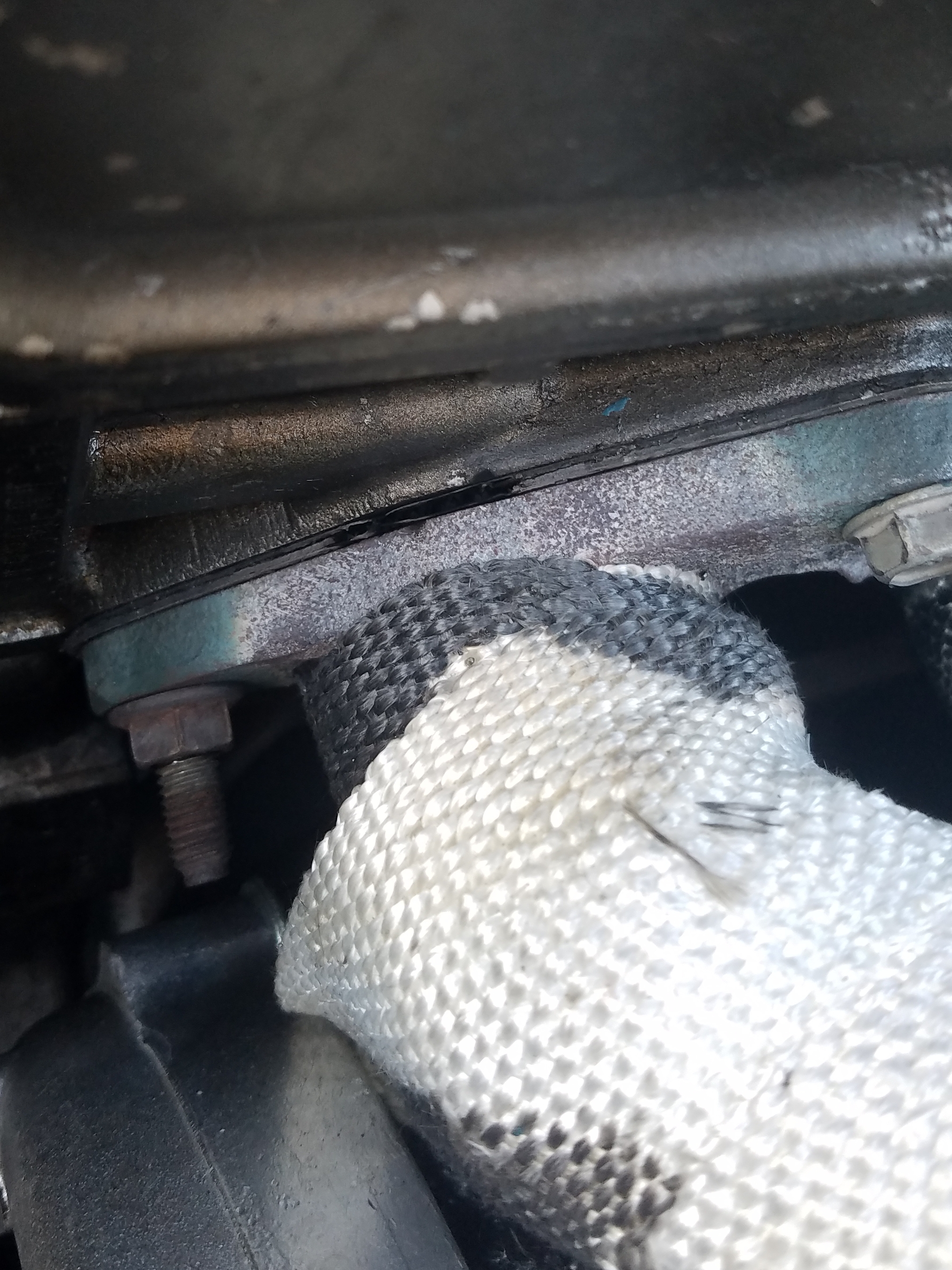

found the leak....
Fixed and now pushing 10 lbs with no problems.
Setup is now a nice daily driver...
