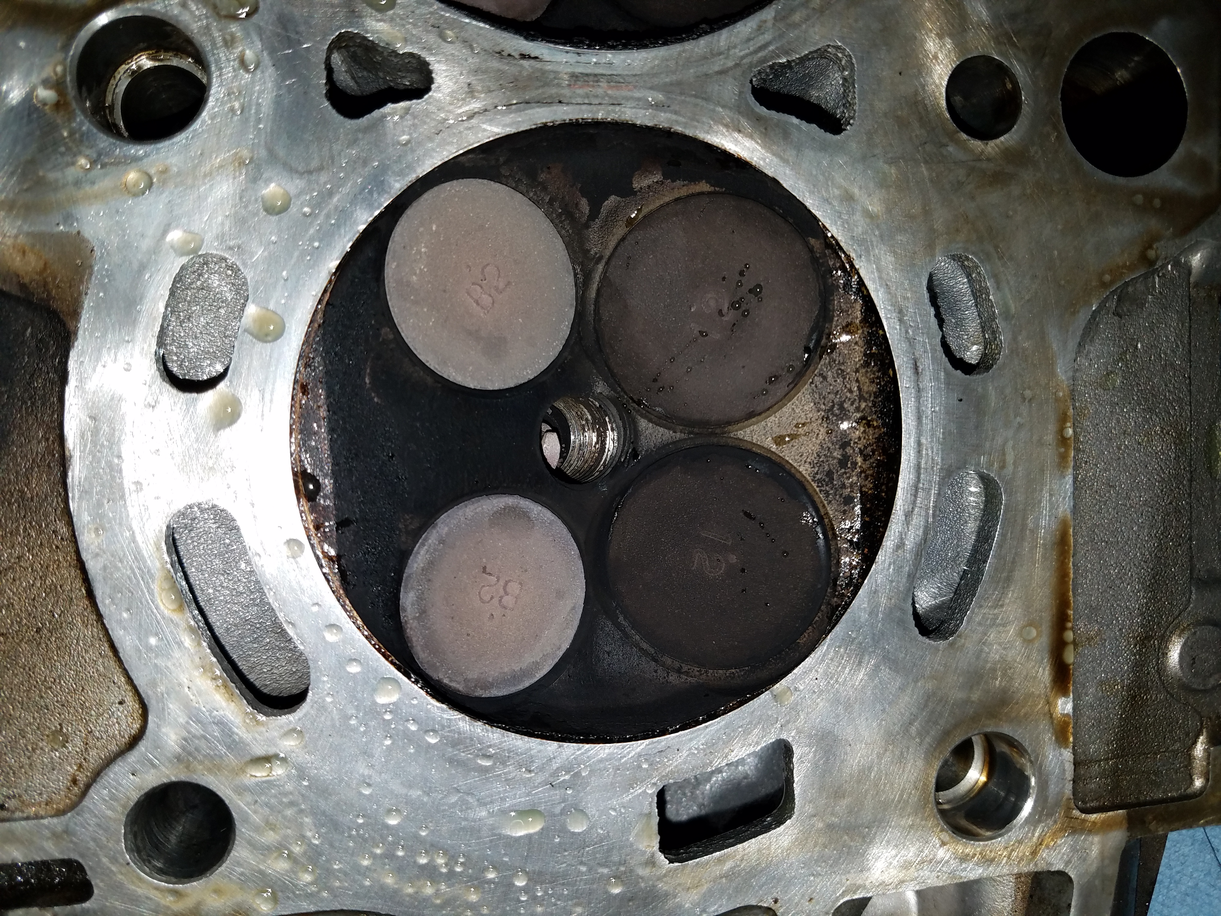

adding more fun.....
This is my A2 head.
I have the Crower stage 1 cam patiently waiting on my porting and polishing...

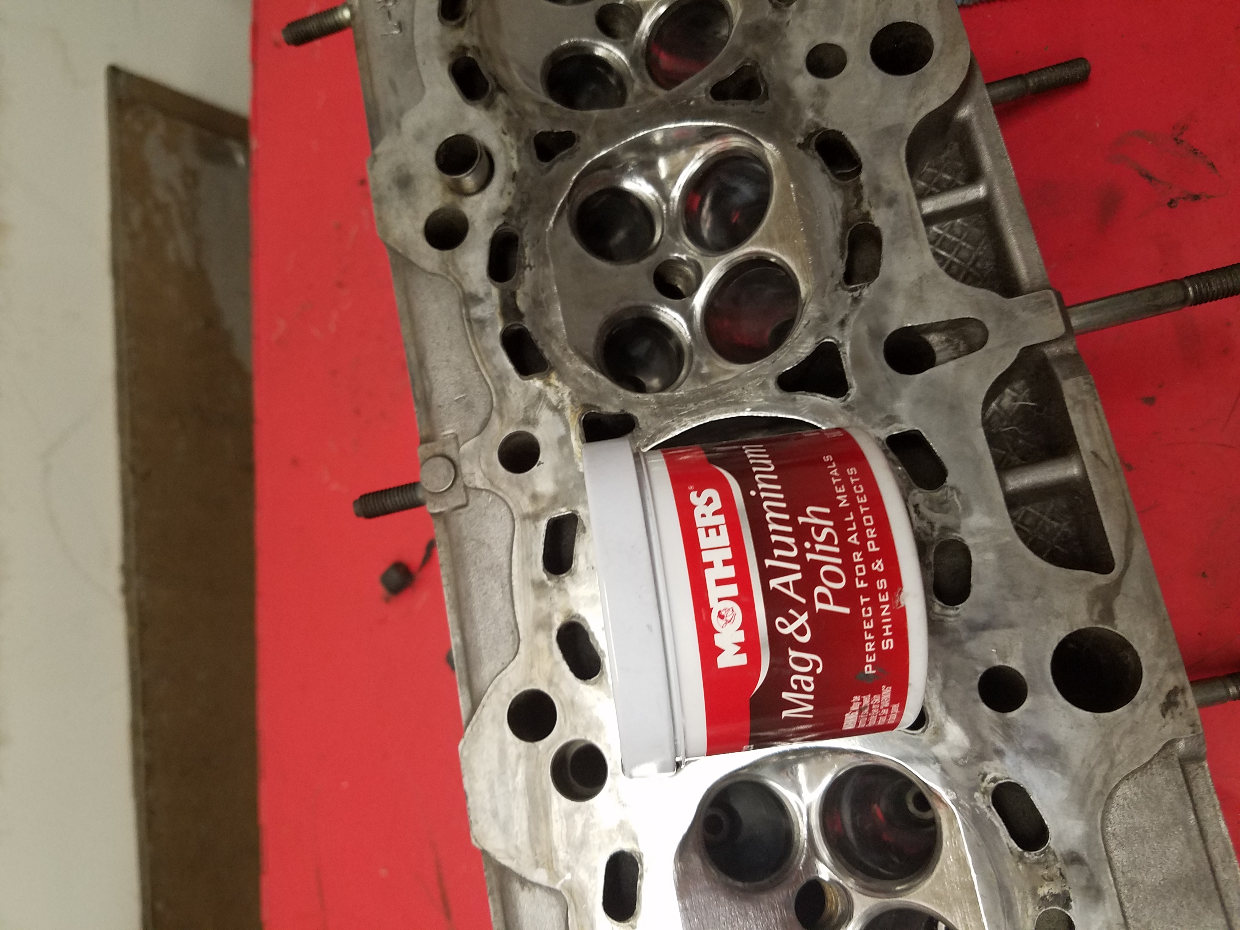

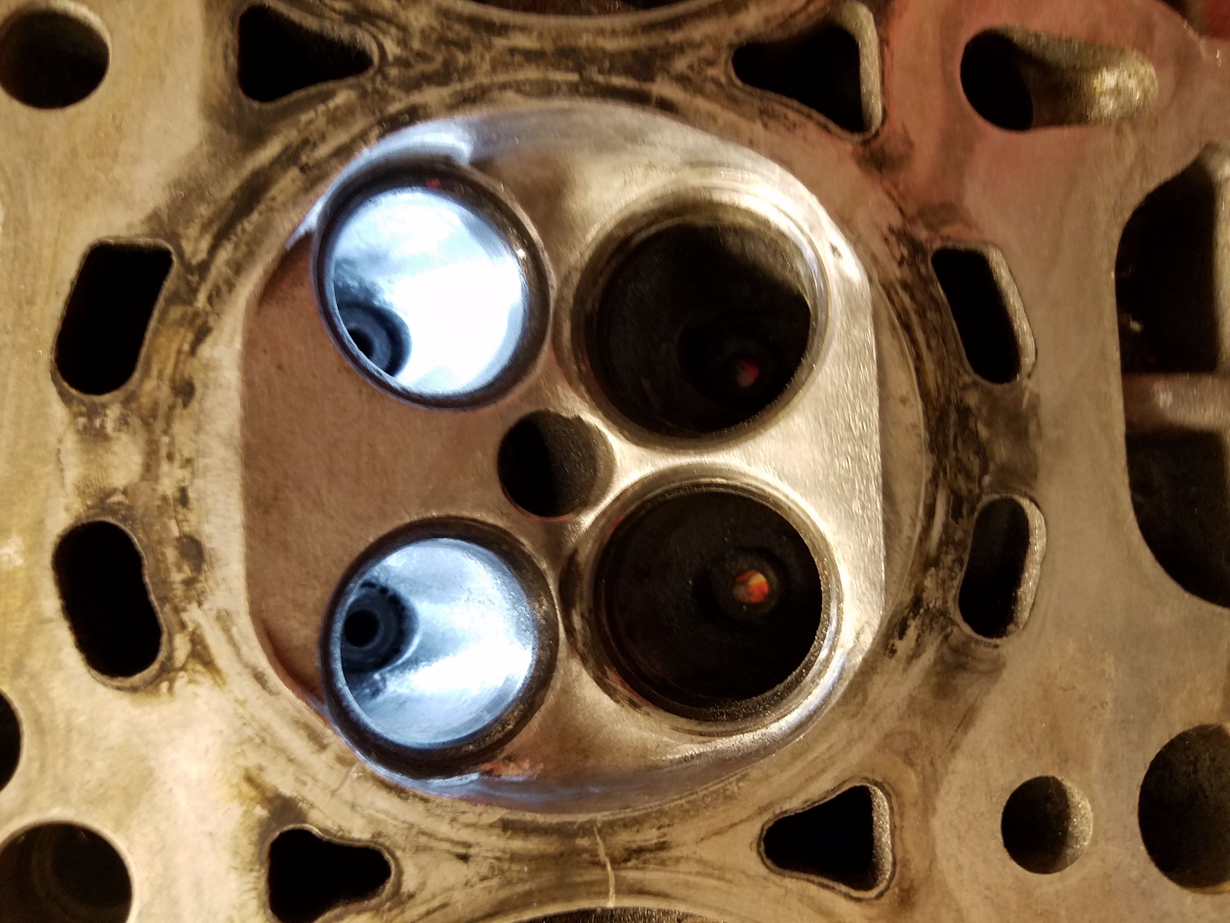

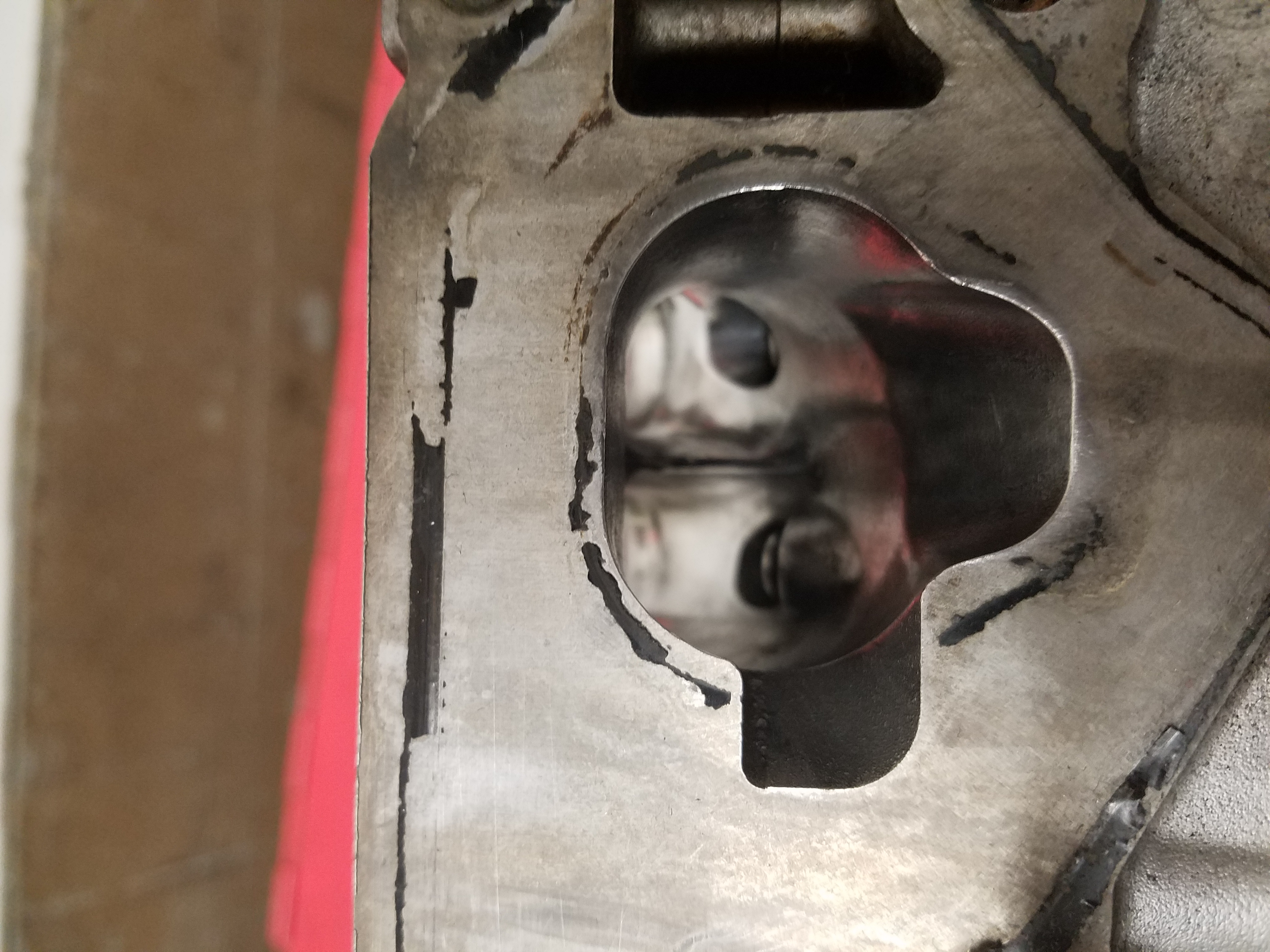

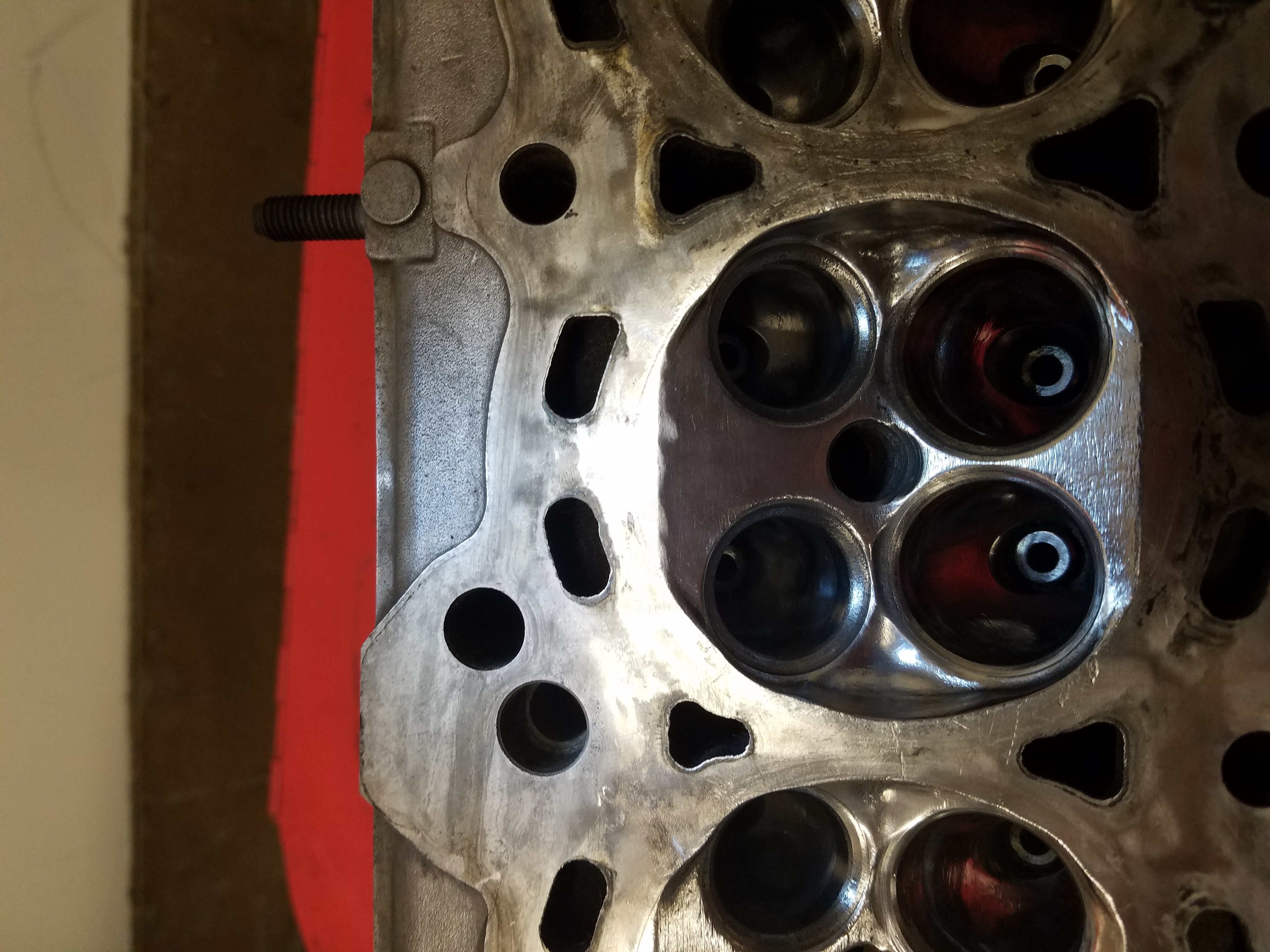

finished with the polishing...
ID:	111851   Click image for larger version
ID:	111852   Click image for larger version
ID:	111853   Click image for larger version

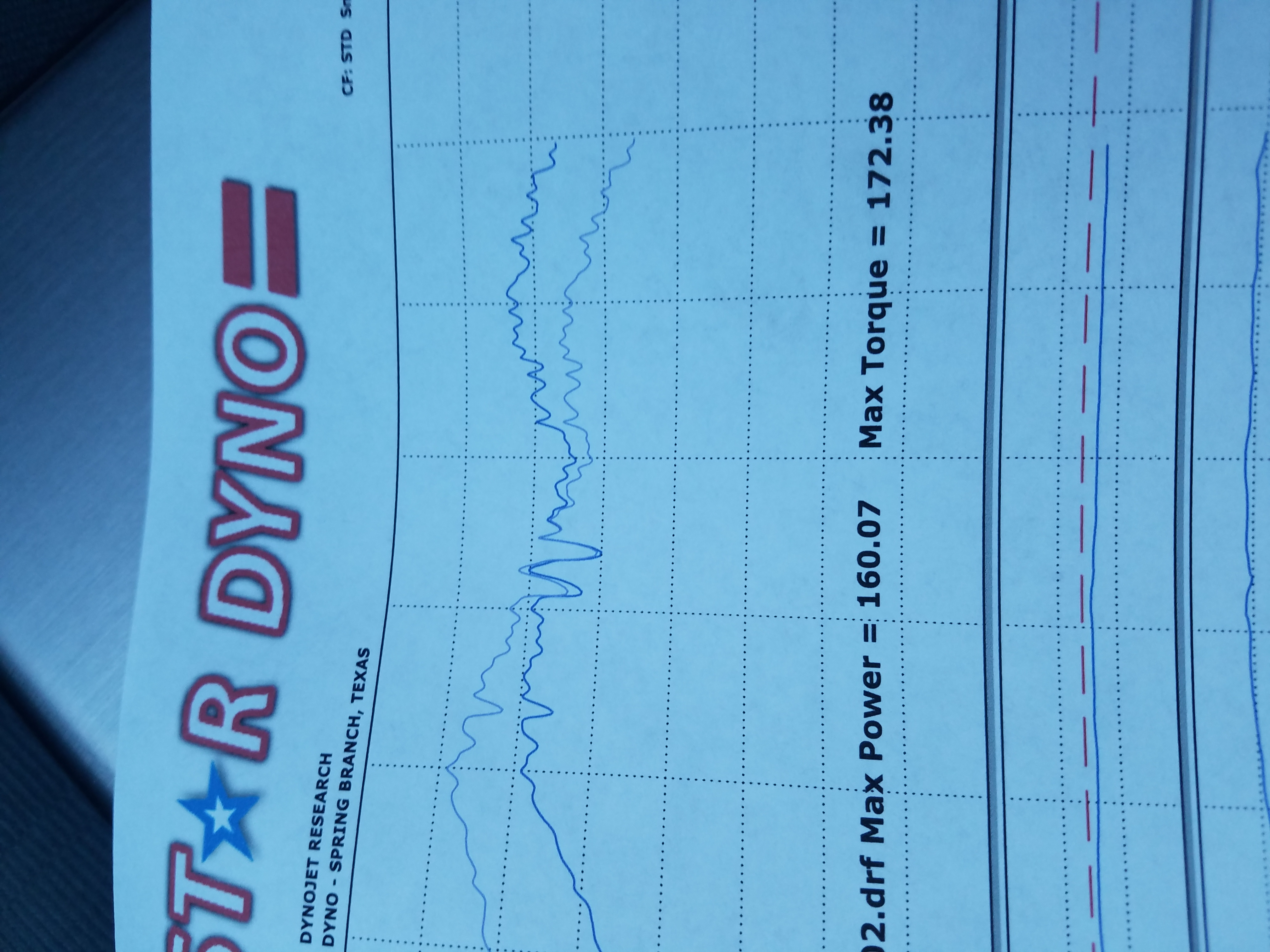

Dyno Sheet

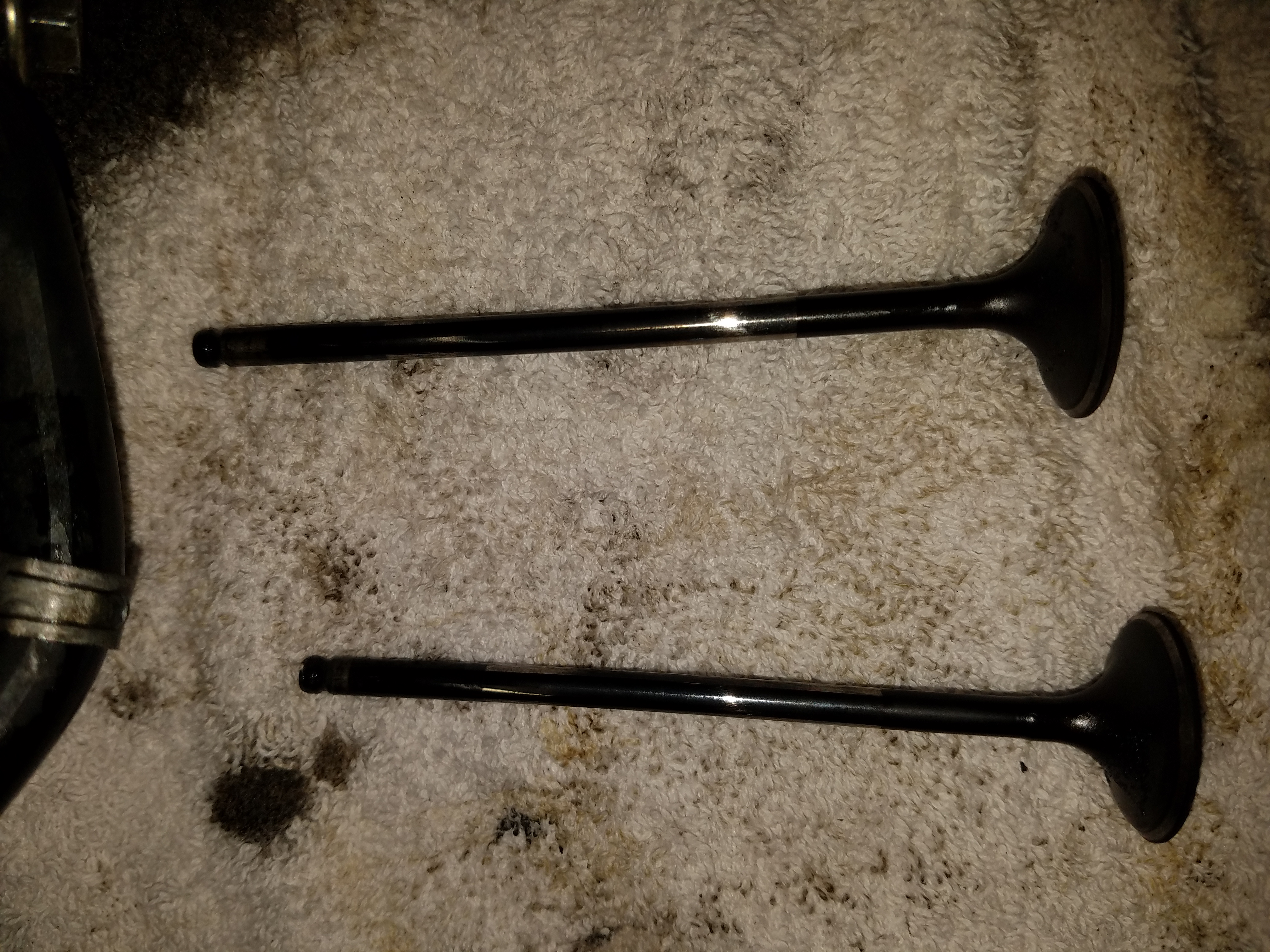

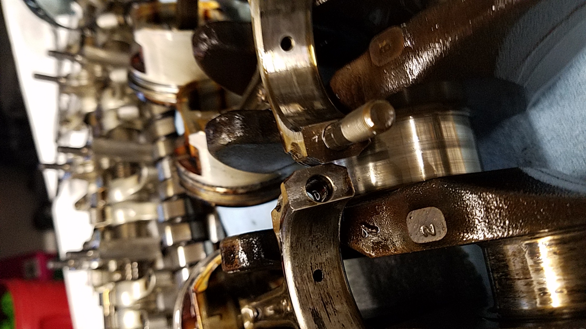

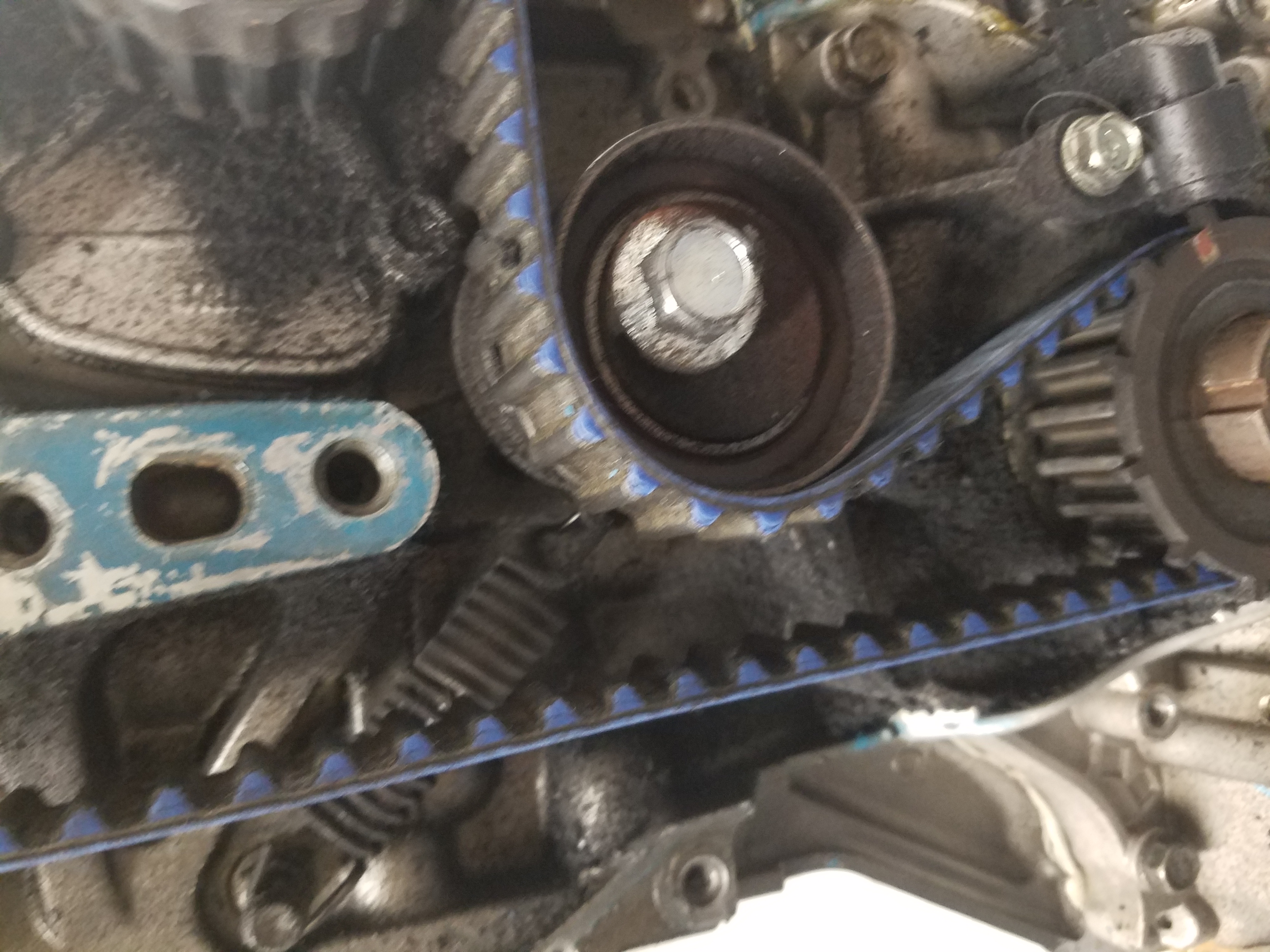

break down process...
ID:	111861   Click image for larger version
ID:	111862   Click image for larger version
ID:	111863   Click image for larger version

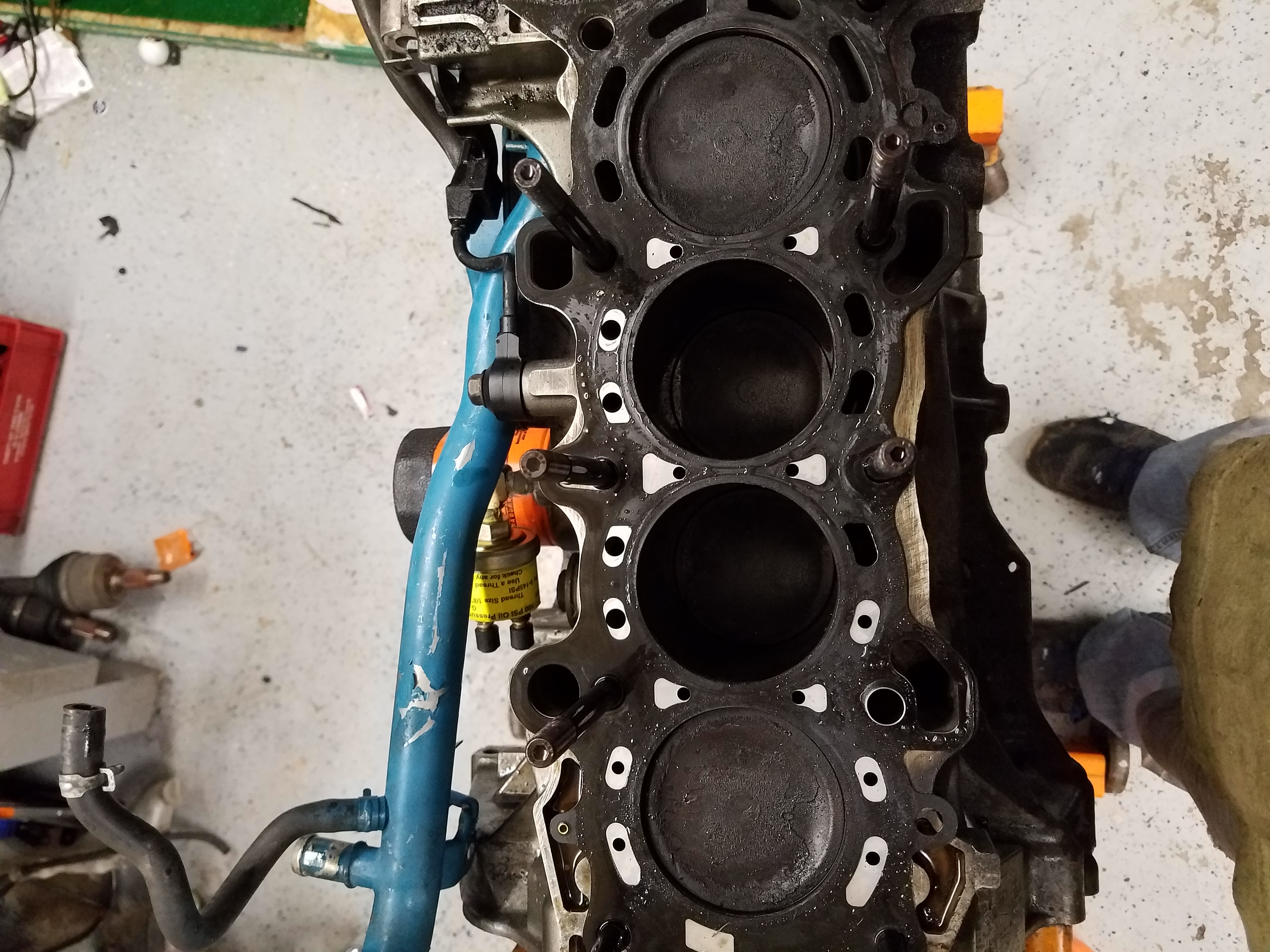

Re: Ktuner and the D17

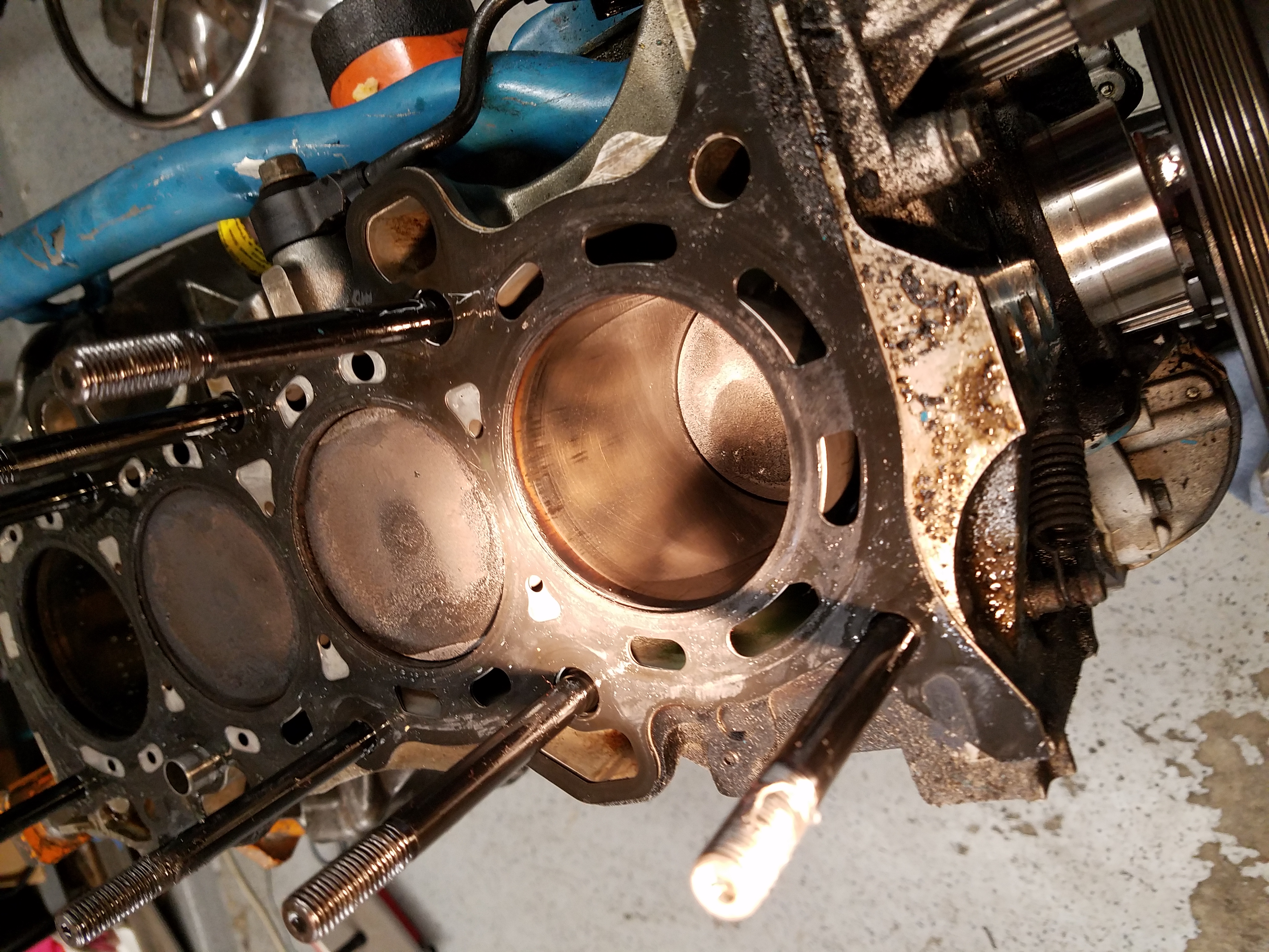

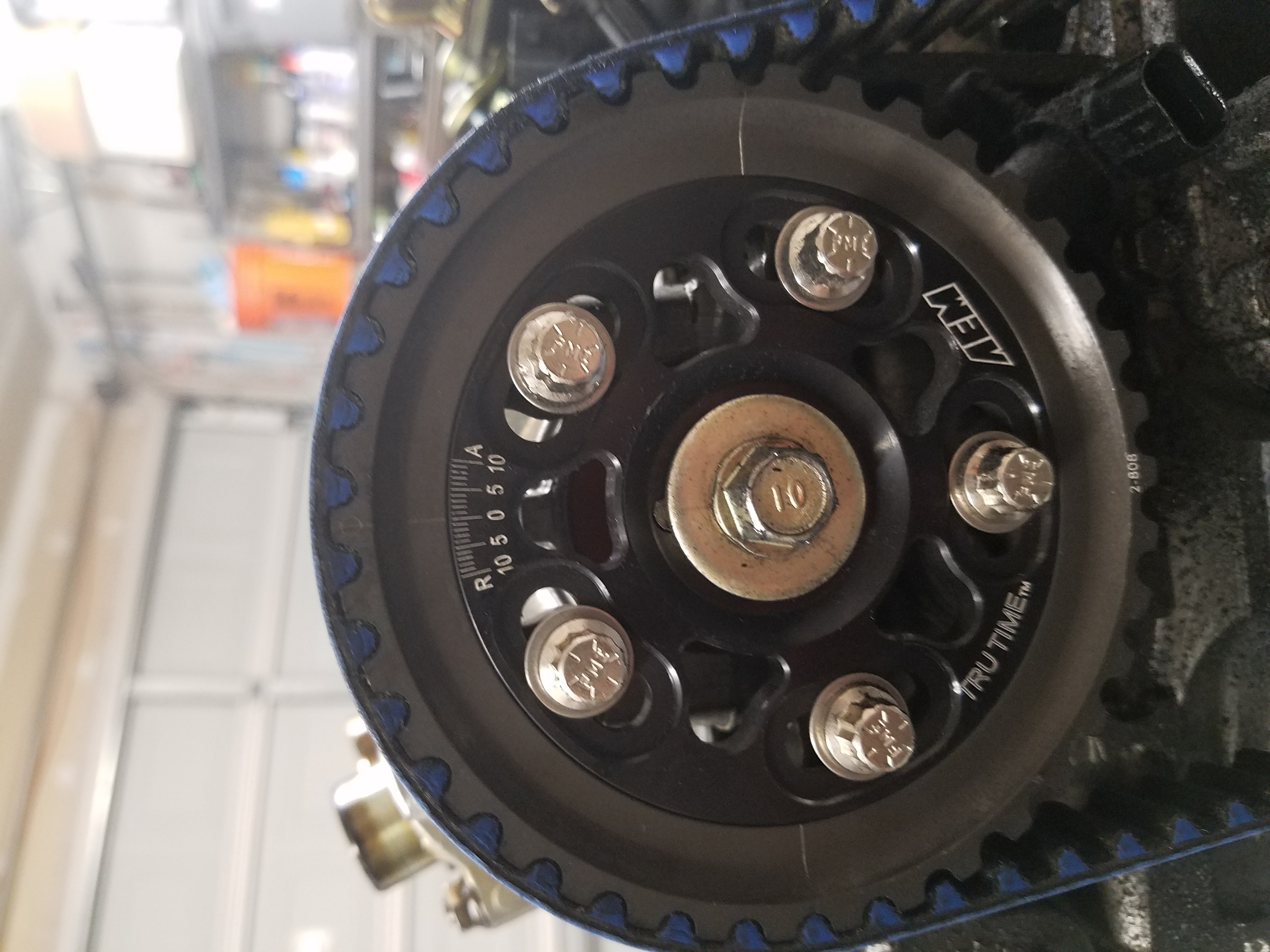

up to this point everything was looking good...
ID:	111865   Click image for larger version
ID:	111866   Click image for larger version
ID:	111867   Click image for larger version

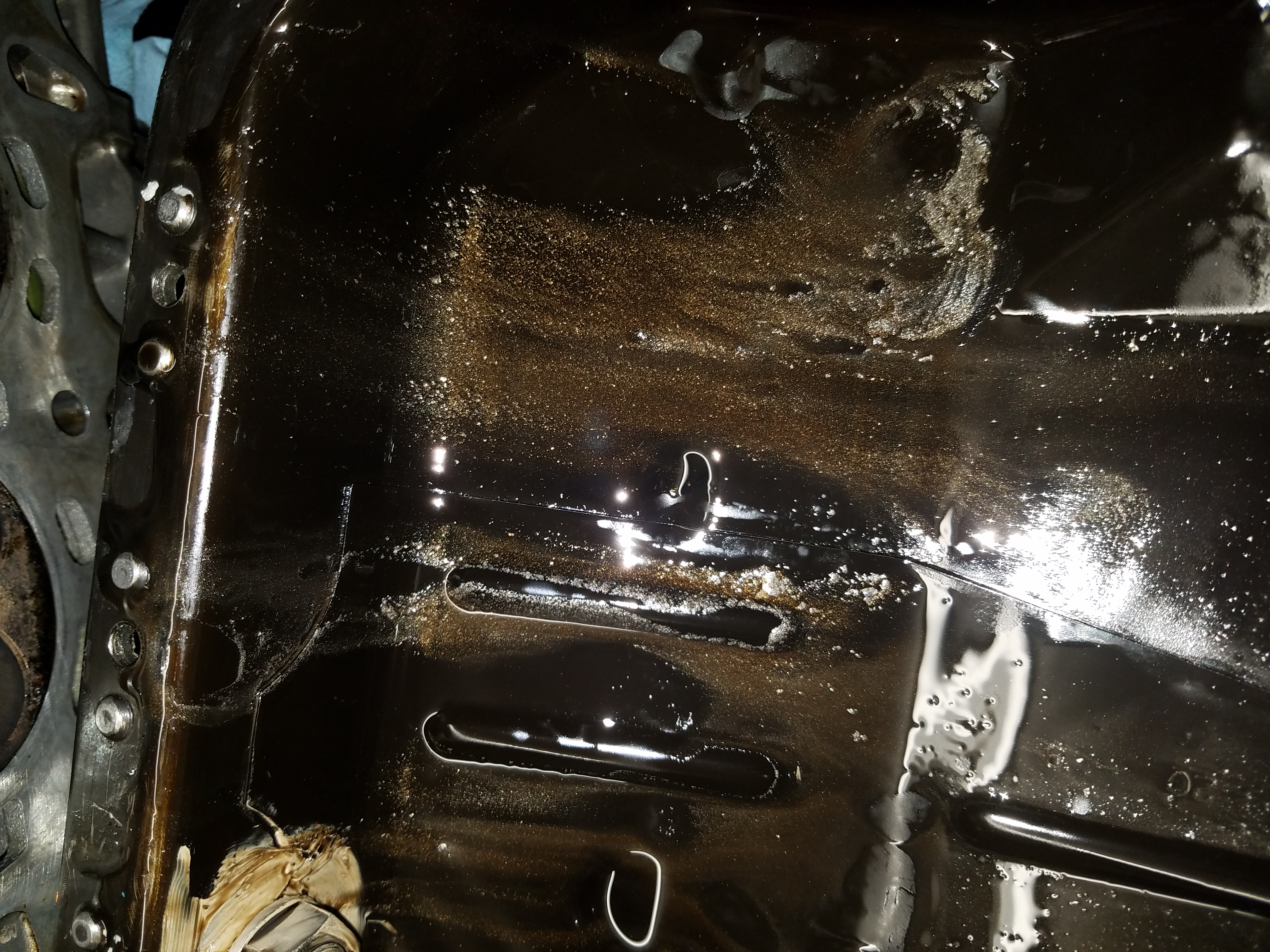

Then i came across the shavings in the oil pan...
Side to side comparison... most of the rod bearing melted to the rod end (pic on left)
ID:	111869   Click image for larger version
boo... at least a rod didnt saw through the block

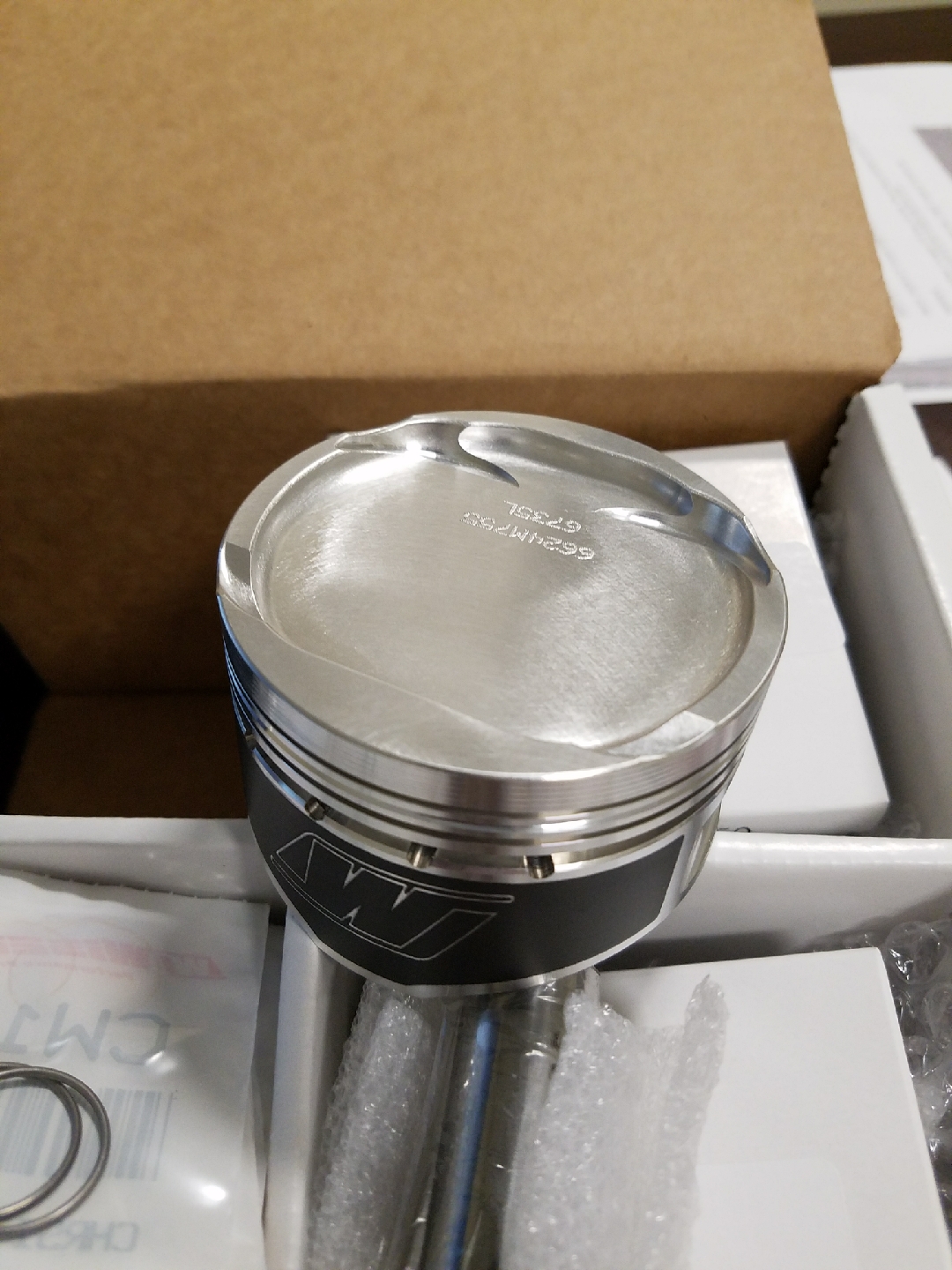

Wiseco 75.5 pistons ordered

Guess what just showed up??????

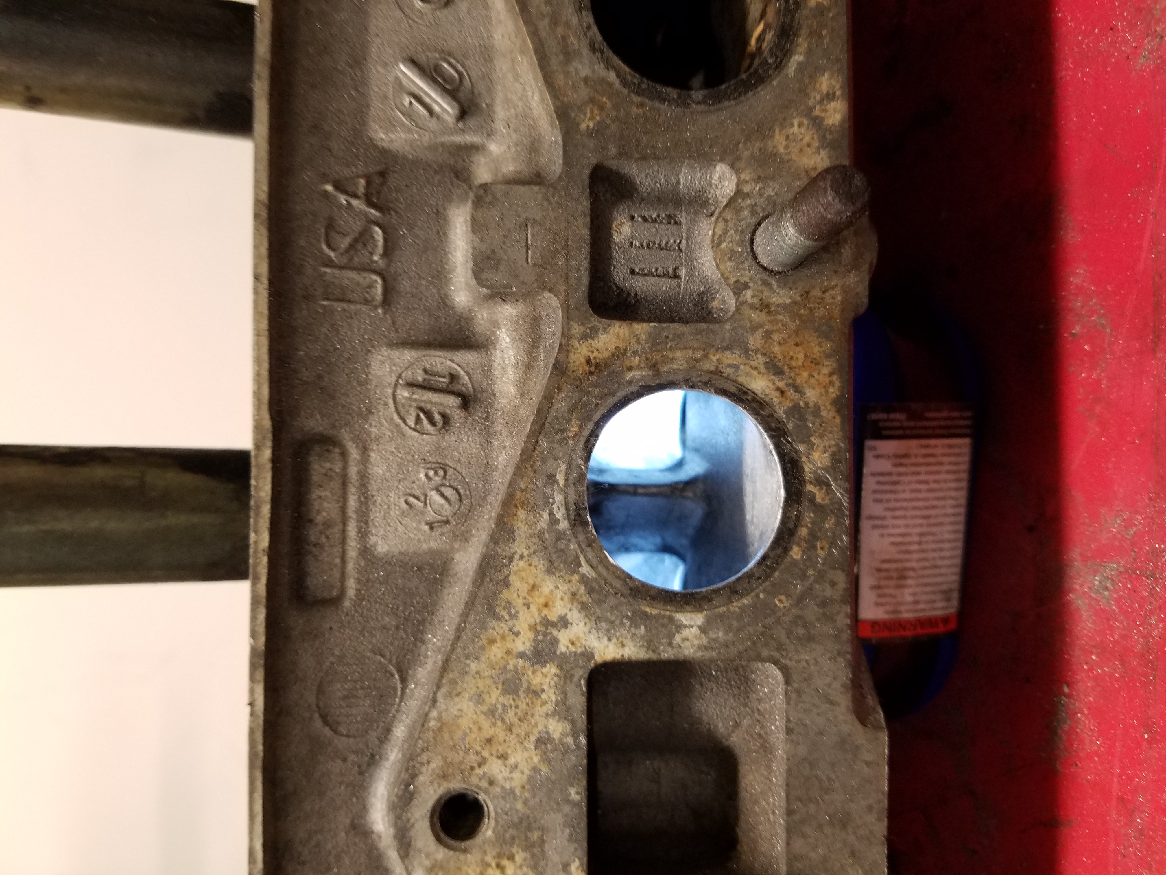

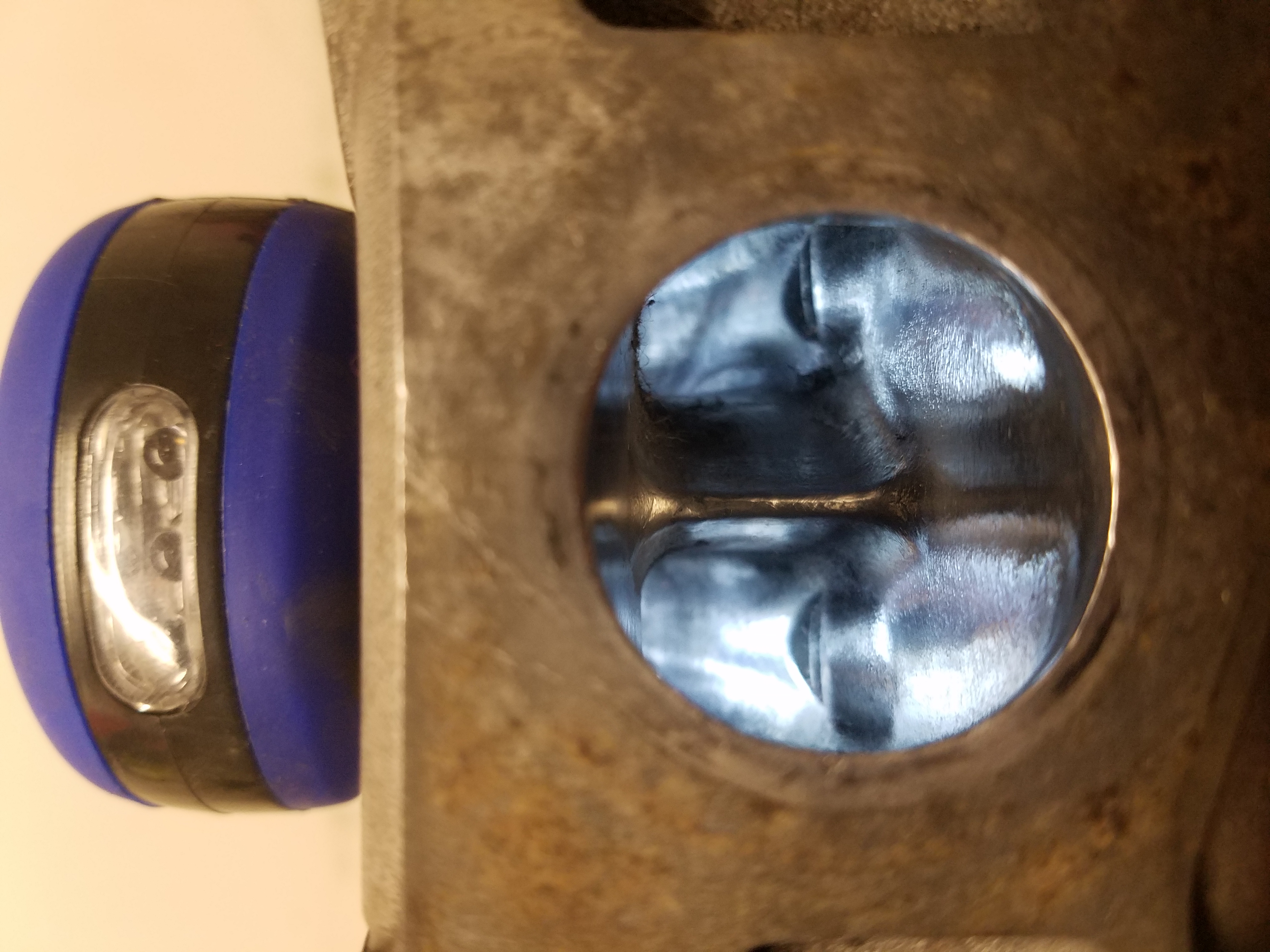

quick question to anyone who may know...
I just dropped off everything to my machine shop and the owner said that this was the first time seeing a block guard. He obviously knew where it went, but the question he had was how far down is it supposed to go/pressed in? Are they supposed to be flush/just a bit below the top of the deck or quite a bit further down?
So Matt over at HA Motorsports says to install block guard down 1/4"-1/2" below top of deck and THEN bore the cylinders out...

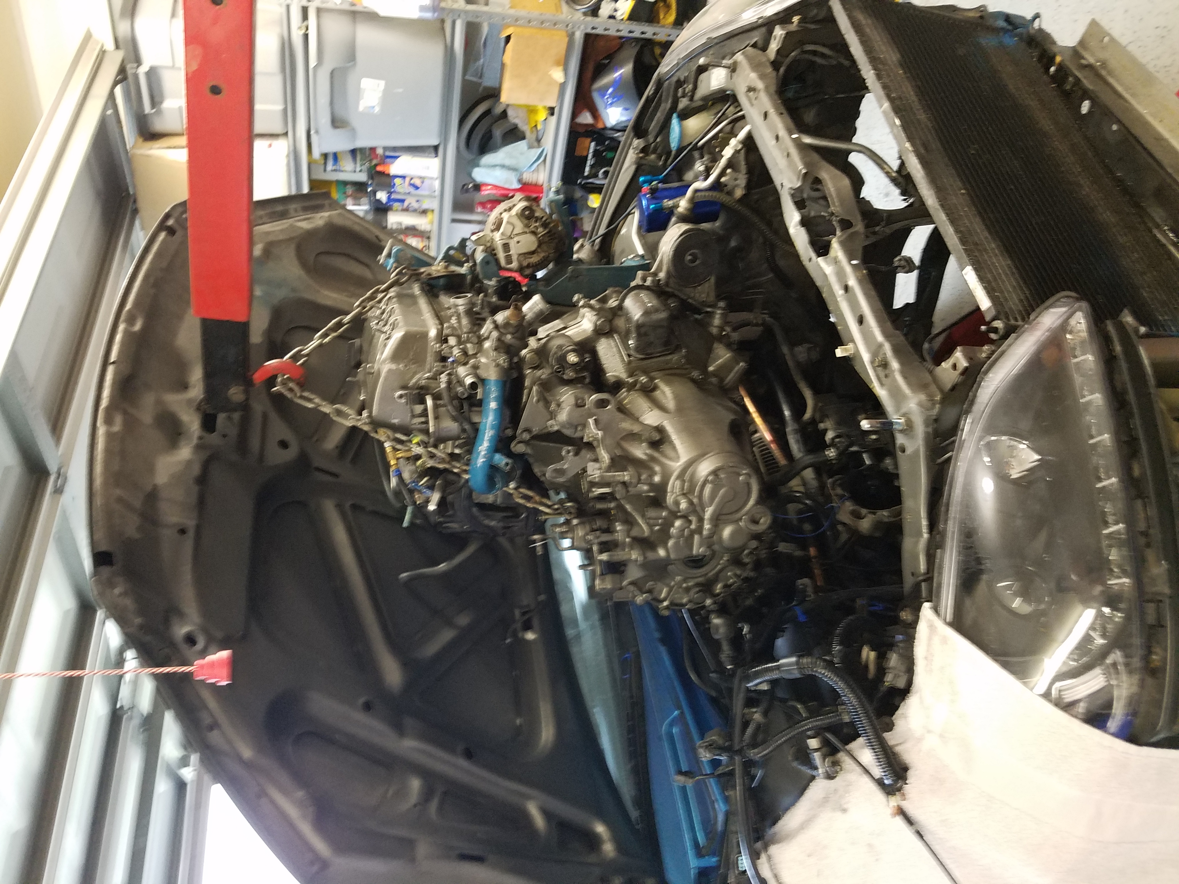

While the engine is at the machine shop, i decided to pull the AC this weekend.
I'm thinking about pulling the power steering and making a closed system with the existing hoses...anyone have experience doing this?
