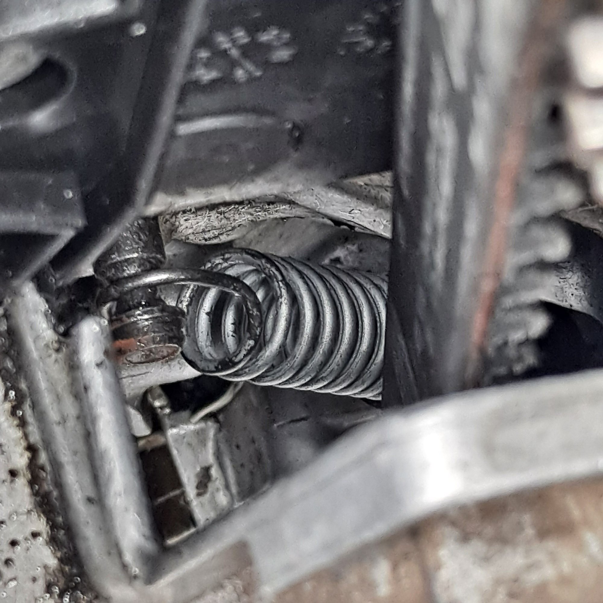

not my call Aunt is paying and she wanted cheap. So in farting around with this heap I managed to move timing 2 teeth. Not wanting to disassemble I left the mount and ps bracket on. Resetting the timing once again! I had a helluva time getting the tension spring to that post because I couldn't pull it towards the block. I had my neighbor help guide it on with needle nose and a flathead. I am wondering if the spring is damaged?
I havent torqued down the tensioner bolt just yet.

You get what you pay for. They might work for an hour, day, week, month. We get people posting almost daily with issues from using duralast sensors
Should be fine

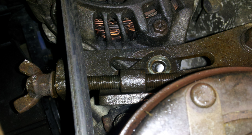

So P0300 303 and 304 codes now. Keeps idle @1k but it's ruff. I don't have the alternator or ps / ac belts attached. I can't find the adjuster to the alternator underneath. Does someone have a photo ? And my phone only does mp4 how do I convert?

Funny enough, I was just looking at a thread I posted this pic in of the alternator adjustment. View is from the driver's side looking toward the block. It is missing a bolt in this pic, and that's the empty hole at the top

I had to have dropped that damn bolt adjuster and just cant see it.
