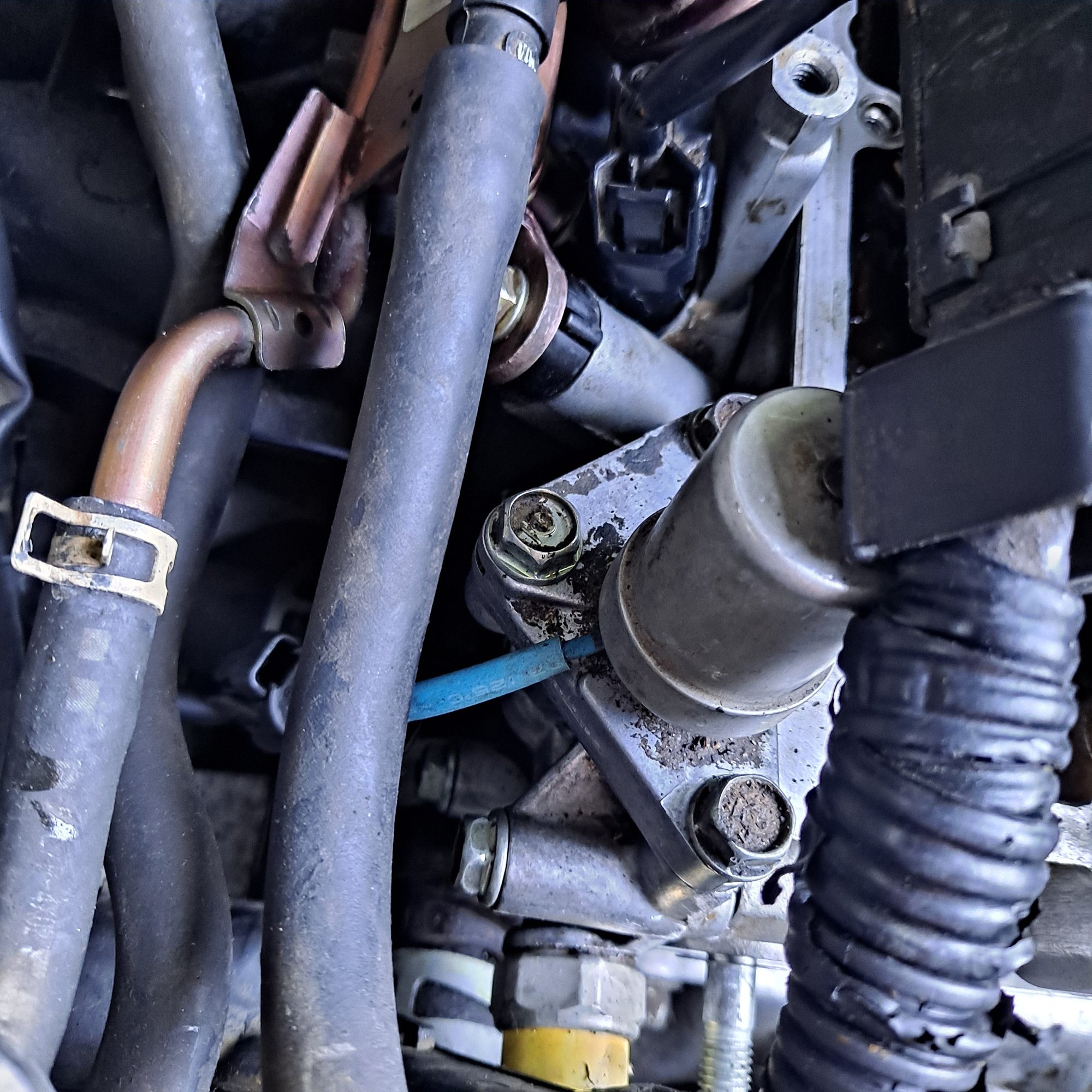

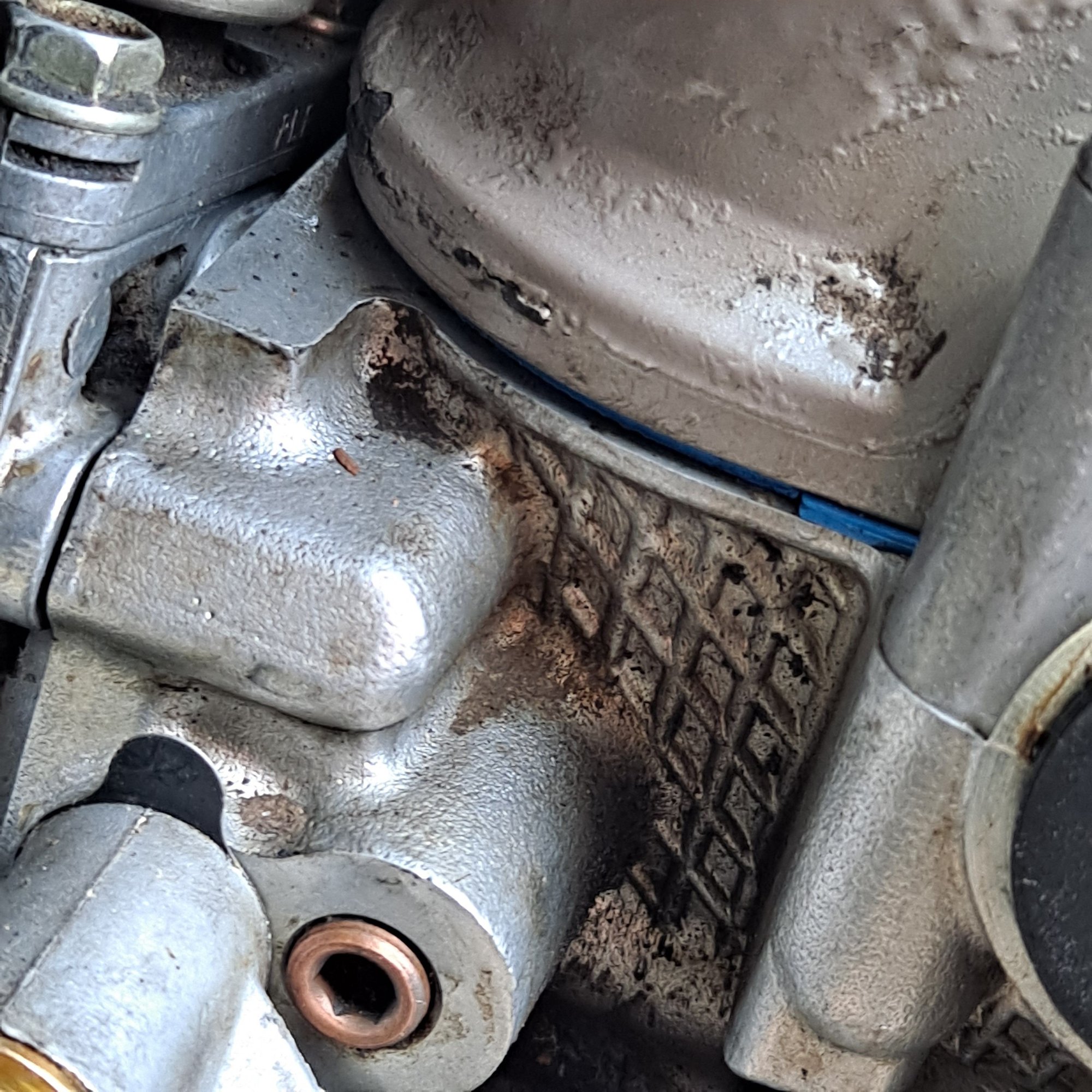

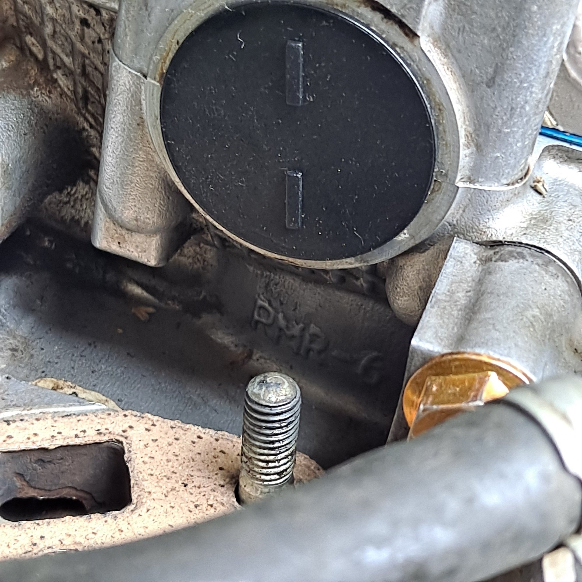

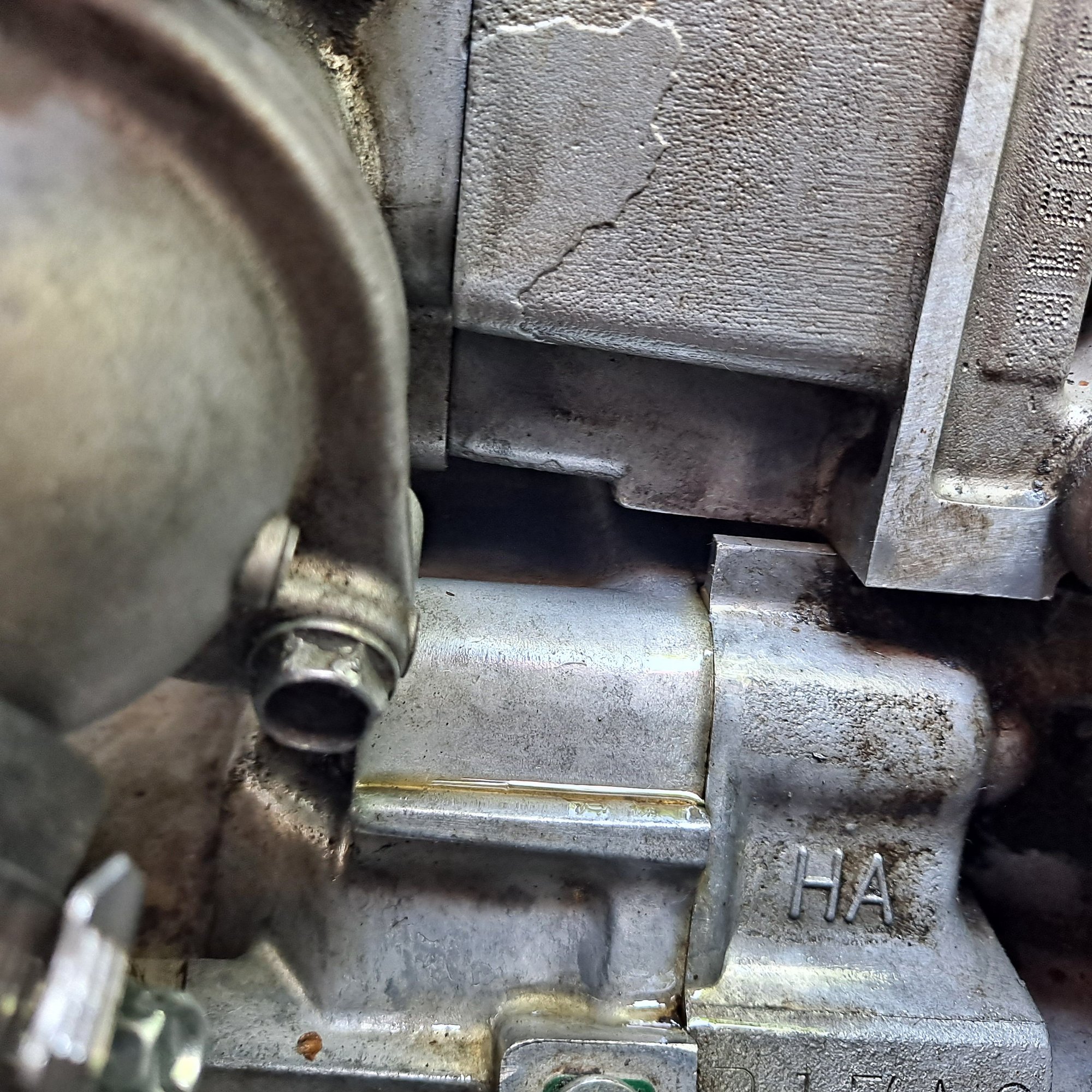

Leak is coming from under and betwixt here. Cylinder head bolt? Possibly overfilled oil ?
Doesn't leak from here.
Concerned about the gap but no oil leak.

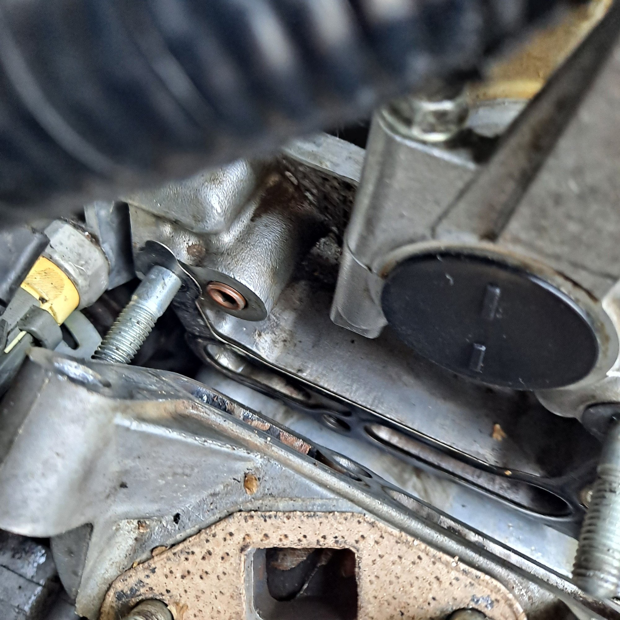

VTEC solenoid ? on the back of the head is dripping/ streaming oil from the bottom then along the ledge to the front of the block. New gasket though. Torque spec anyone? No idea on the no spark issue yet.Any ideas?
a1 Mc c cut
This is going to get the finger of the day.

9ft-lb for the vtec solenoid
edit: technically 8.7, but whatever. lol.
108in-lb (technically 104.4) if you're so inclined.

Screen or no screen in the top gasket /filter?
the screen just crushes which cannot be correct. Looks like the mesh will get into the oil flow after a while but the gasket is made for it. I replaced the back gasket with a similar filter and it fit fine. This is just weird. Wrong part for year? Just remove the screen? Honda tac TF outta of it?
Old May 31, 2023
  #105
Rep Power: 512
Re: Trying to get things sorted.
I recall the screen being on the interface between the block and the vtec solenoid assembly. I don't remember a screen there. Someone else wanna crazy check us?
I don't actually recall taking the top off the assembly like that, come to think of it.
edit: found this amazon listing for a generic VTEC solenoid gasket kit for the D16 and D17, the one you have a screen on doesn't have one here
Amazon Amazon
