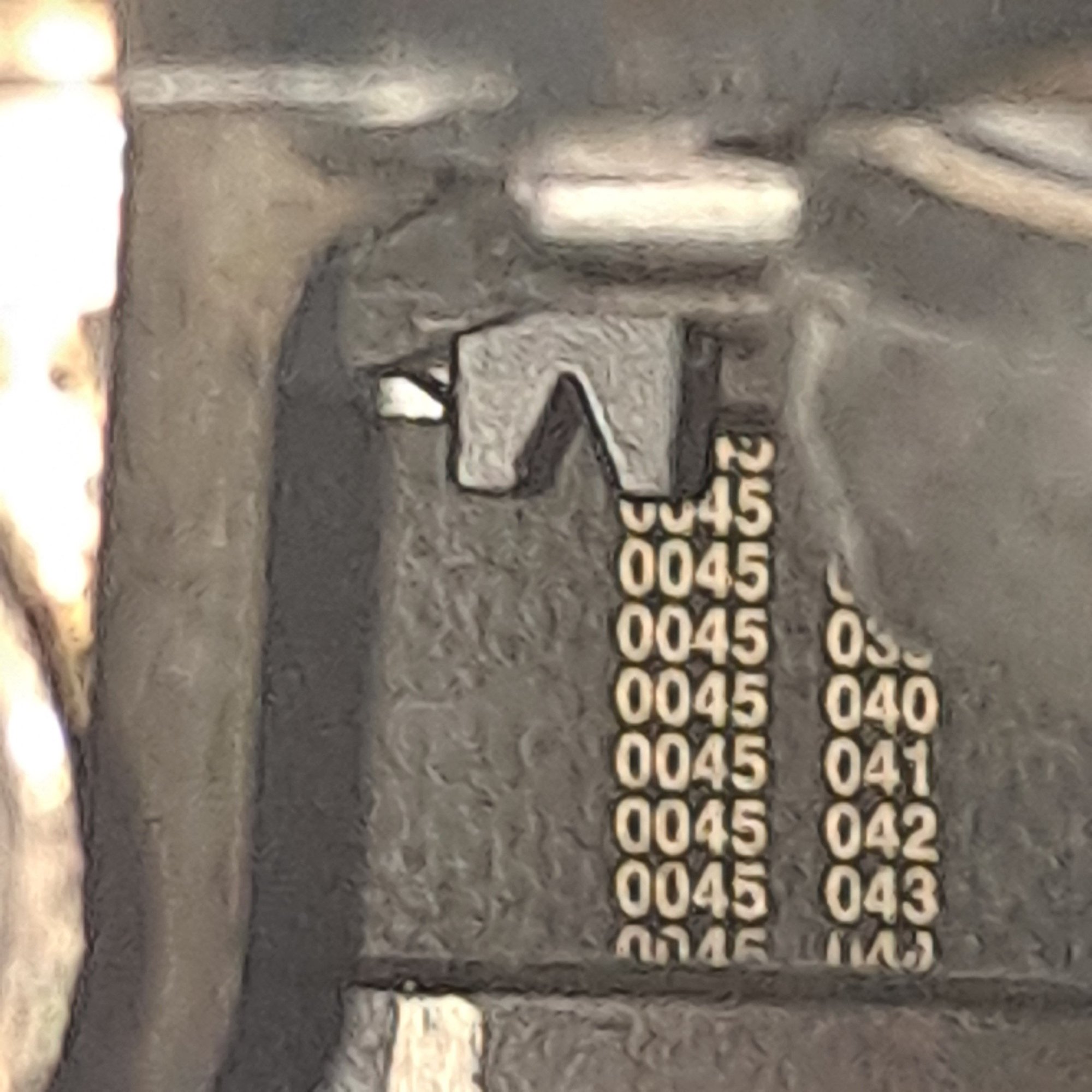

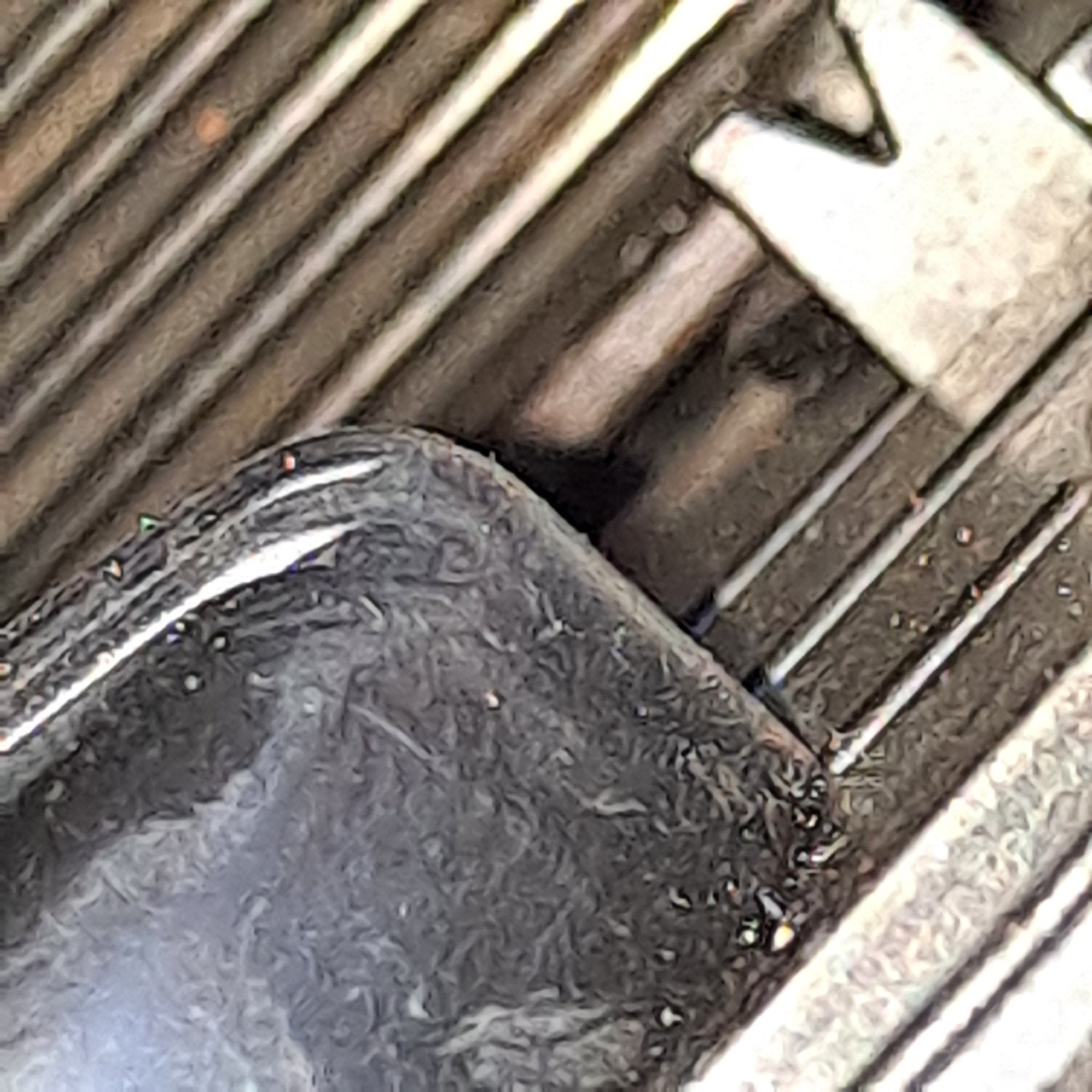

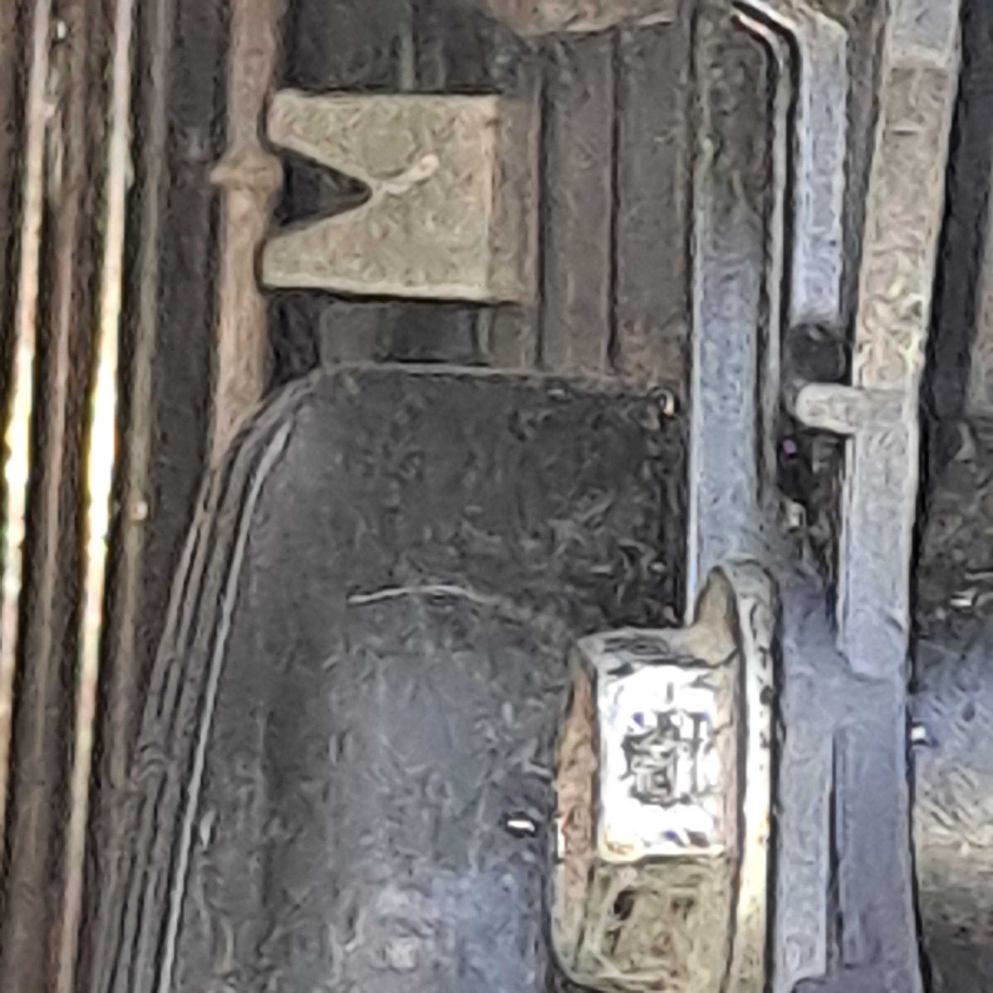

Re: Trying to get things sorted.
Thoughts? Looks off by a click but bifocals can play tricks on depth perceptions. What would make it move ? It was dead on and I used the Honda crank tool to set the harmonic balancer and crank bolt. I didn't see it walk. Do I really need a new tensioner / belt to get it realigned?
I usually find it easiest to set the cam at TDC then look at the crank alignment. Appears to be off a tooth based on the pictures. If you just replaced the belt/tensioner, you can reuse.
So I am looking at taking all the covers off the belt off the tensioner off then doin the dance 💃 do I sacrifice a chicken b4 or after ?

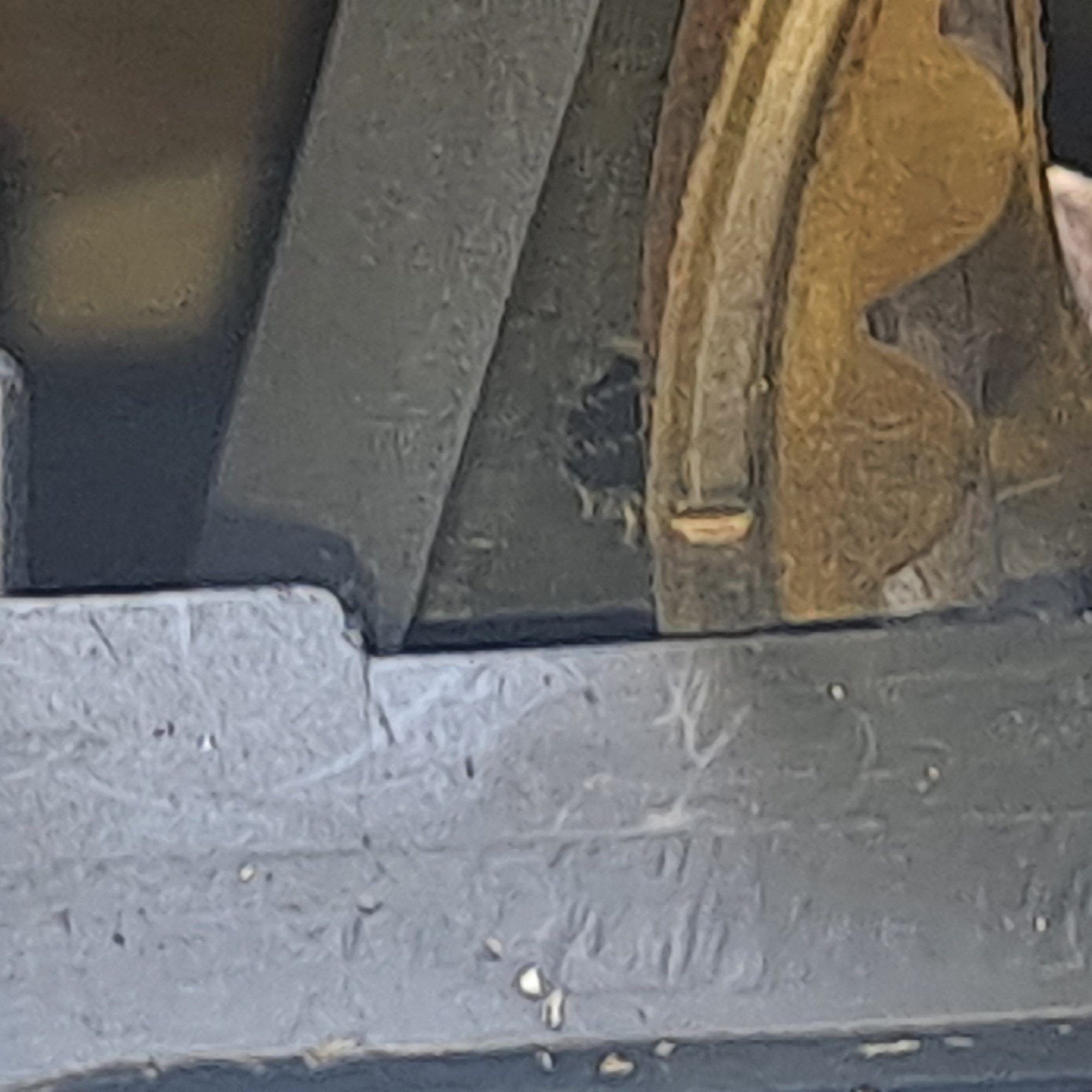

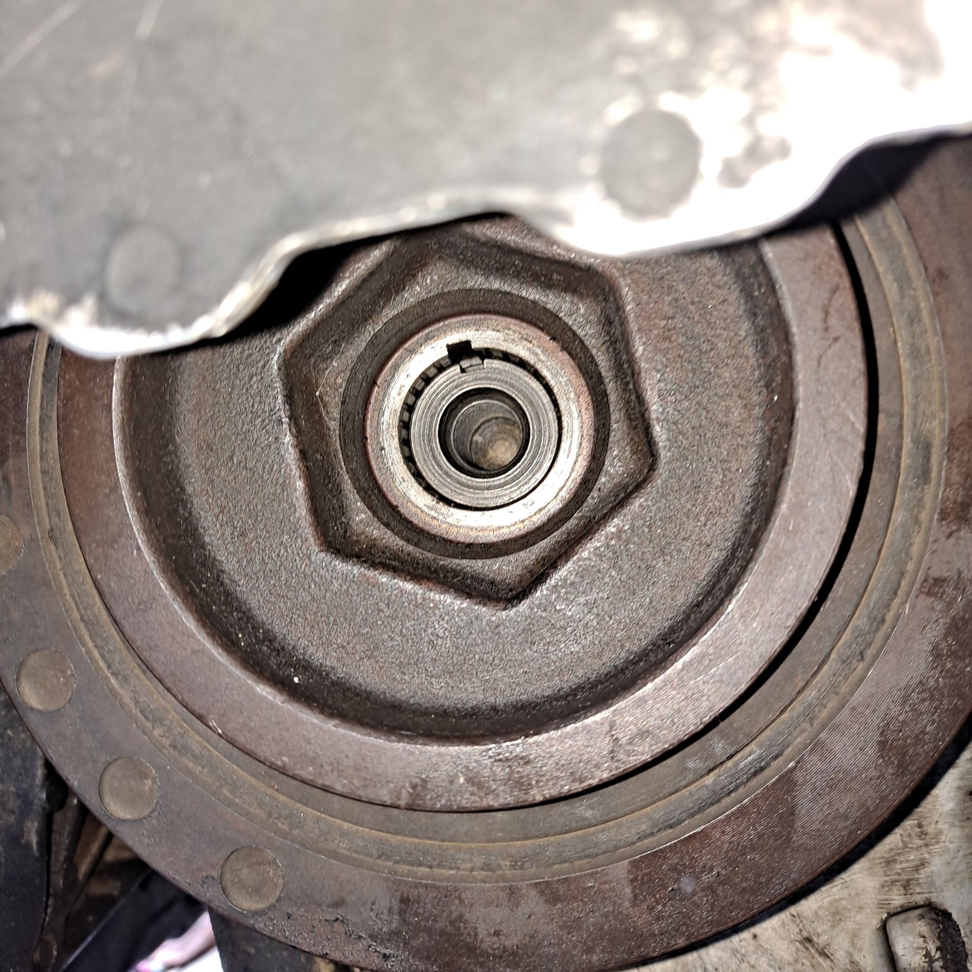

That is aligned no tensioner
Looks rite to me
Off?
The key doesnt line up though. Car is getting ready to participate in a viking burial. And yes the oil pump mark is spot on.
I want my mommy!

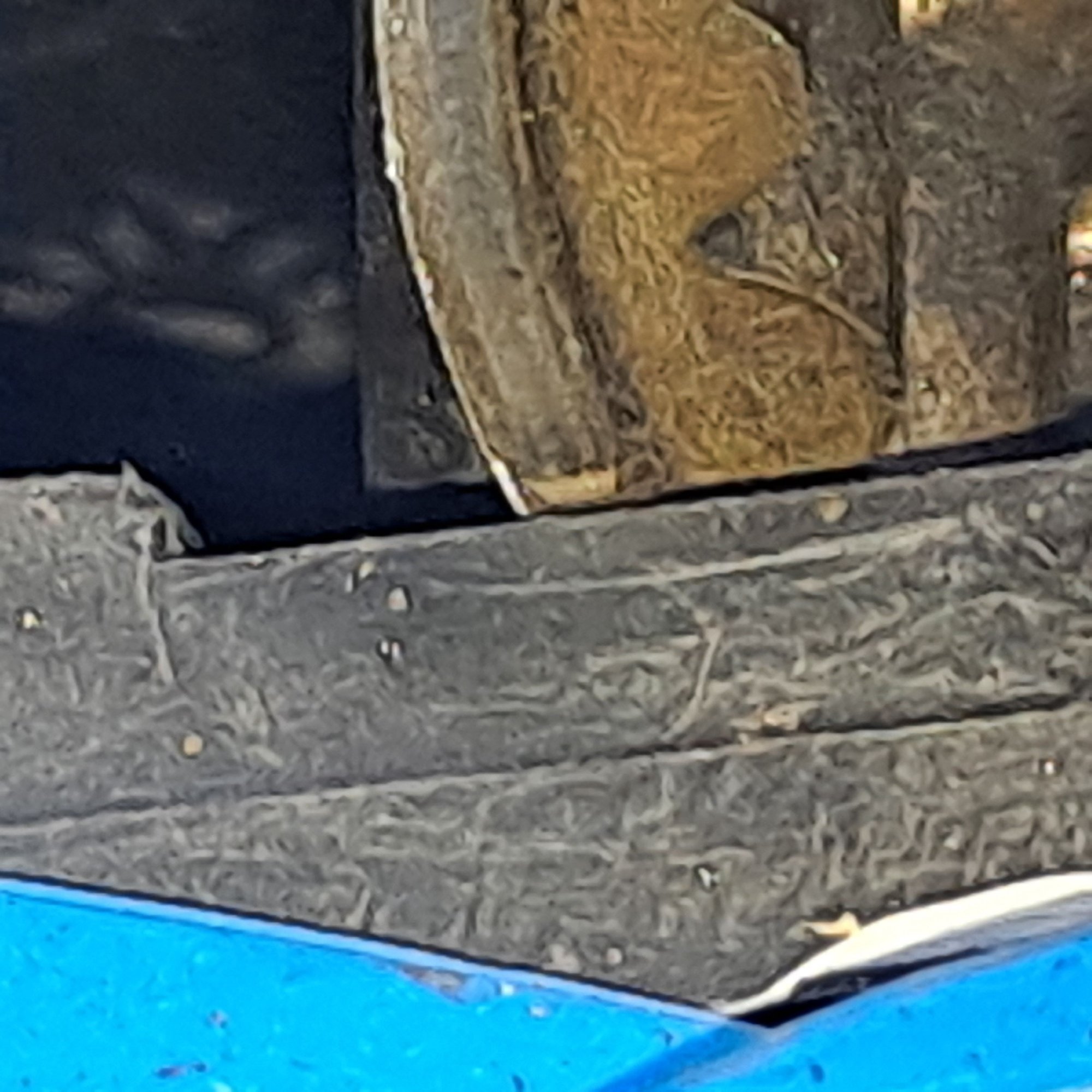

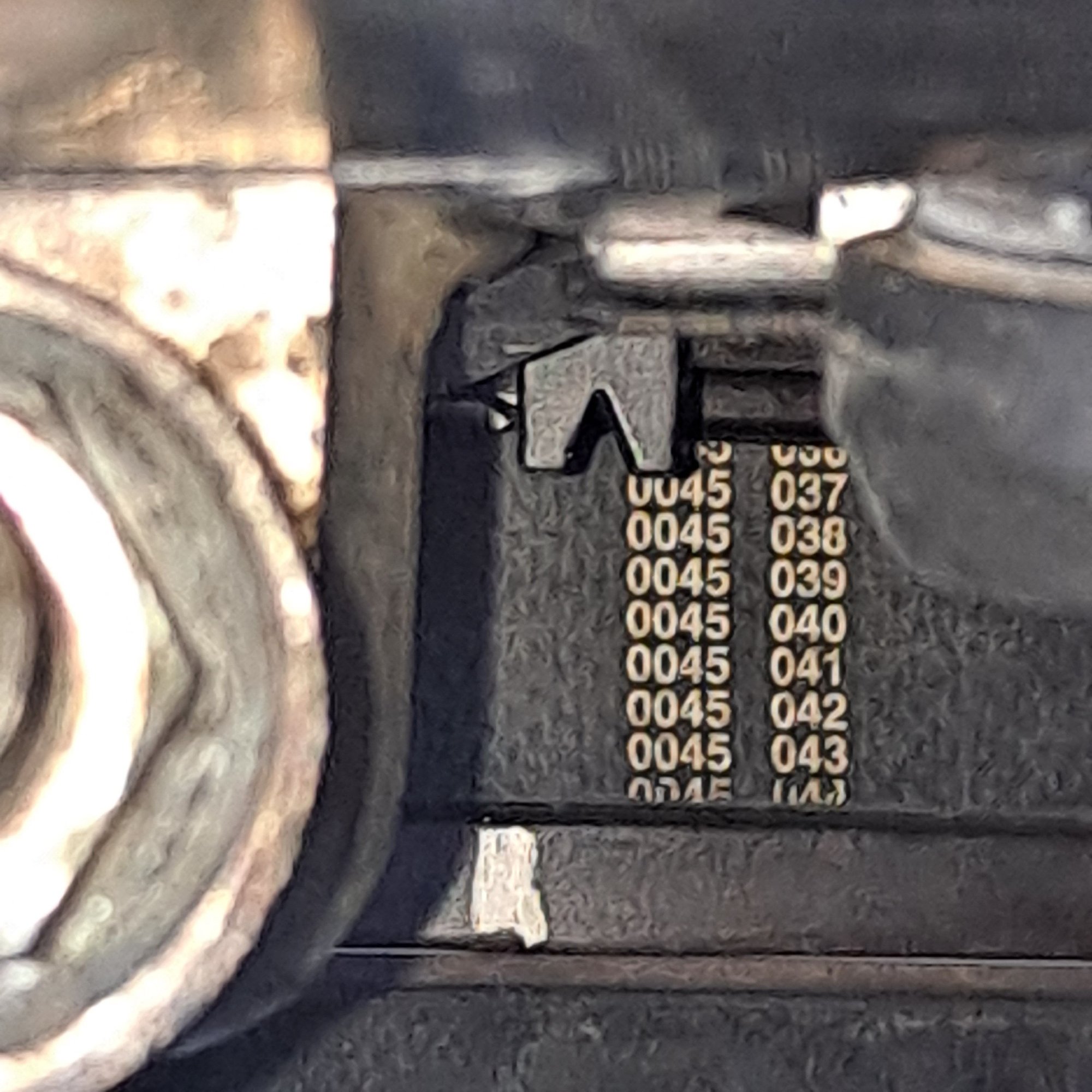

C
Close enuf ? Cam didn't move. Damn thats a hard assed photo to take
I always used a flashlight to cast the shadow of the alignment notch and arrow onto the crank pulley to line it all up.
How close is that notch to the pulley? Looks a lot closer than I remember.

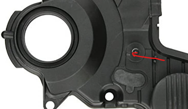

how close ? The notch is on the belt cover.
You should be using the timing mark on the timing belt pulley and block for TDC.
Line the camshaft up at TDC as close as you can, then get pictures of these marks at the crank. If they line up, maybe faulty crankshaft position sensor.

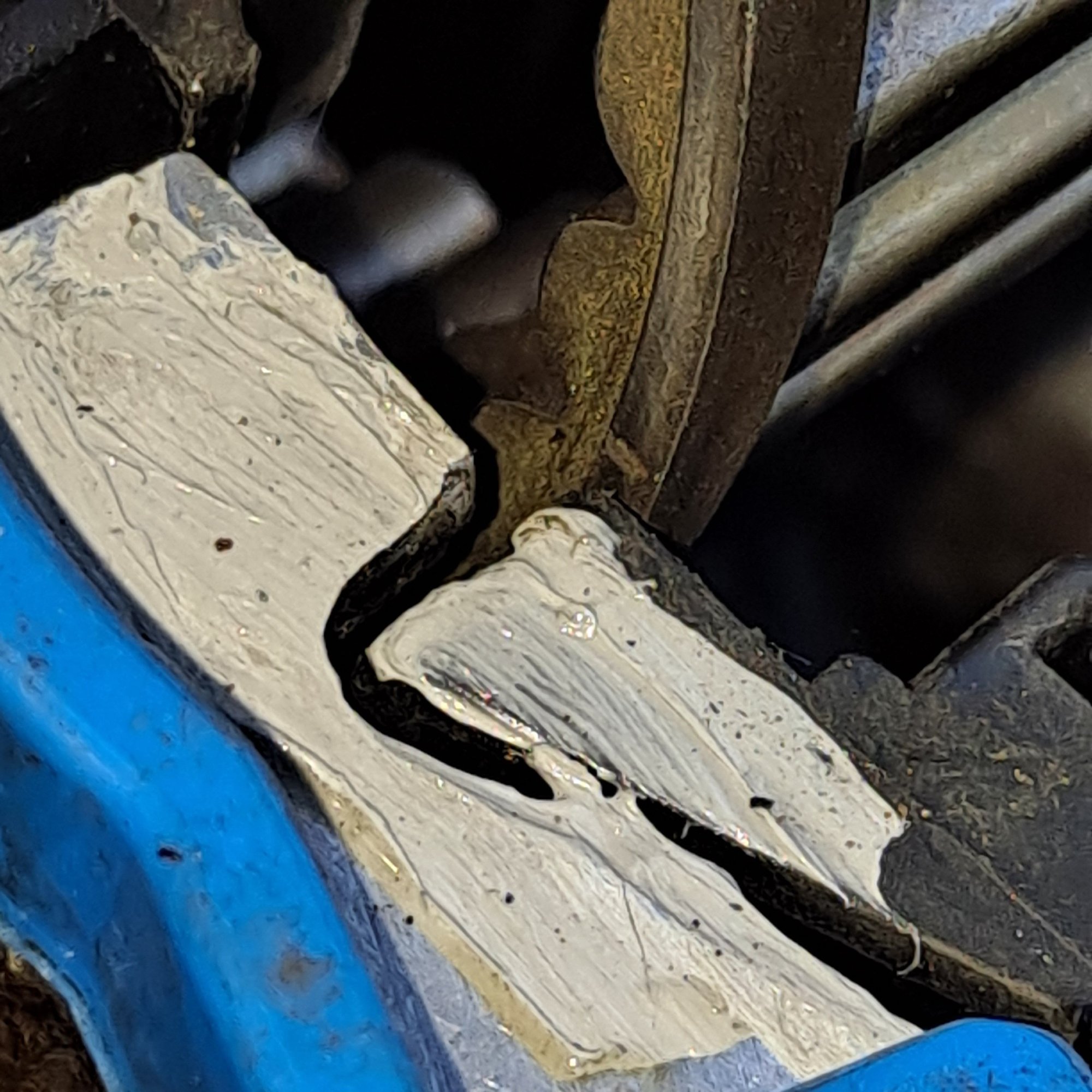

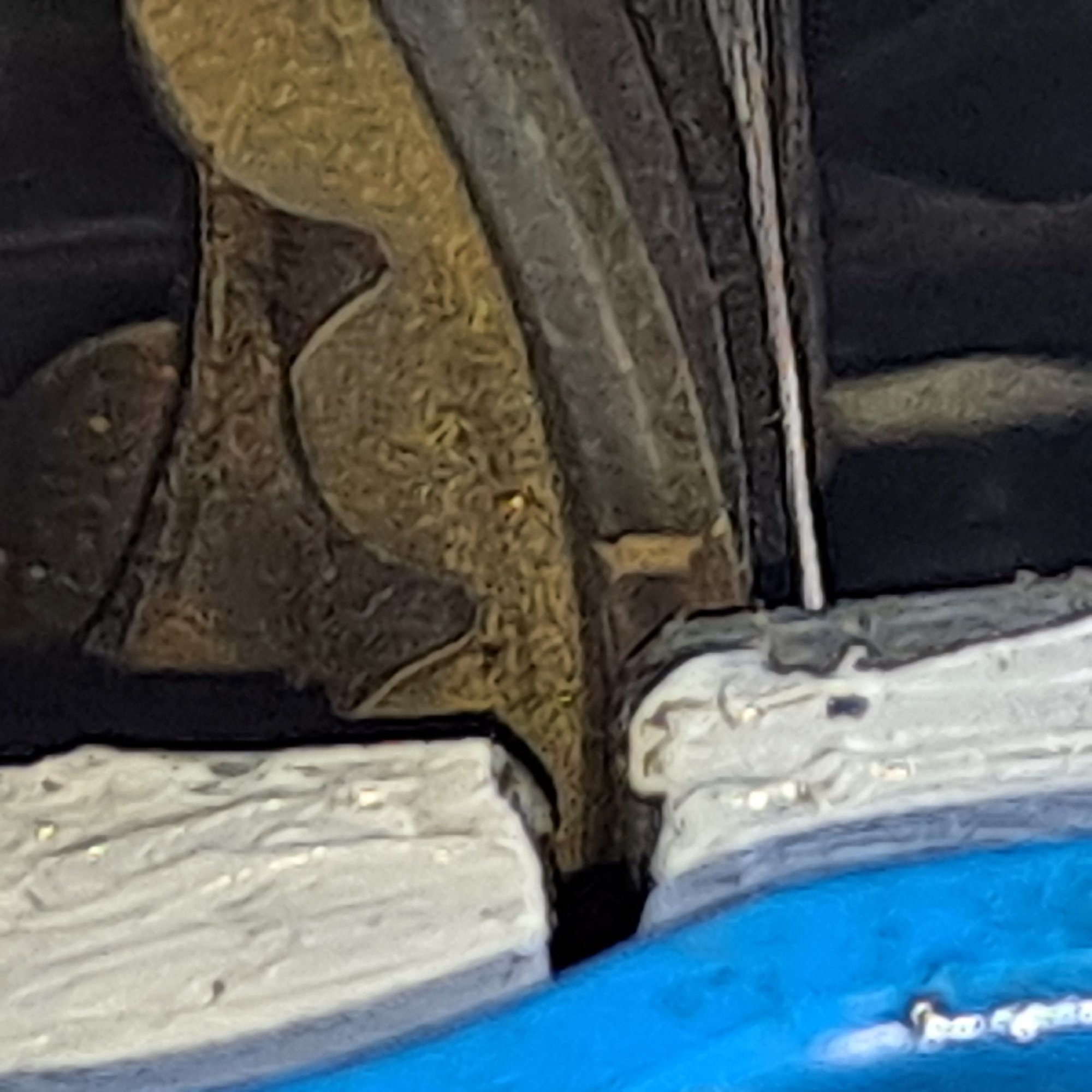

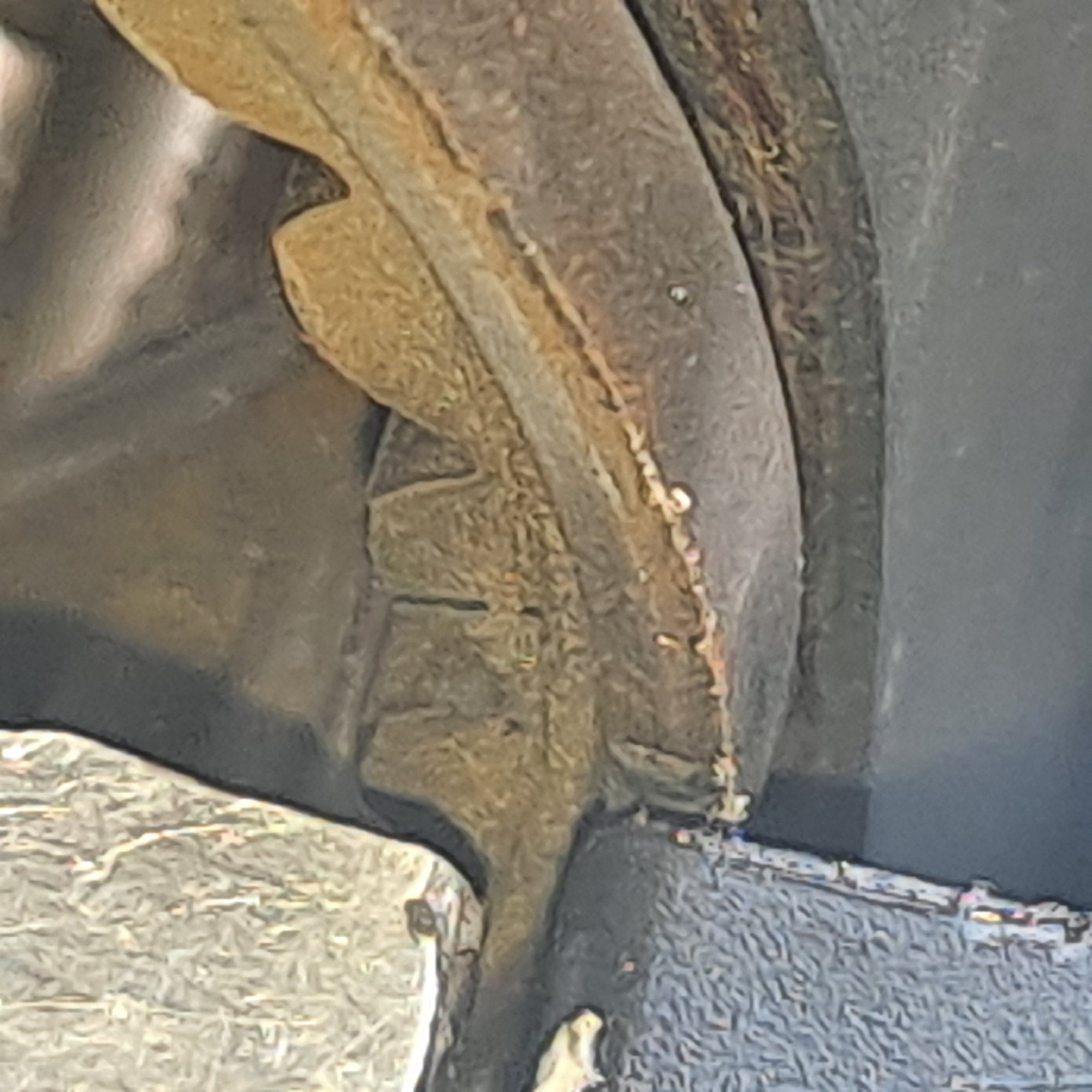

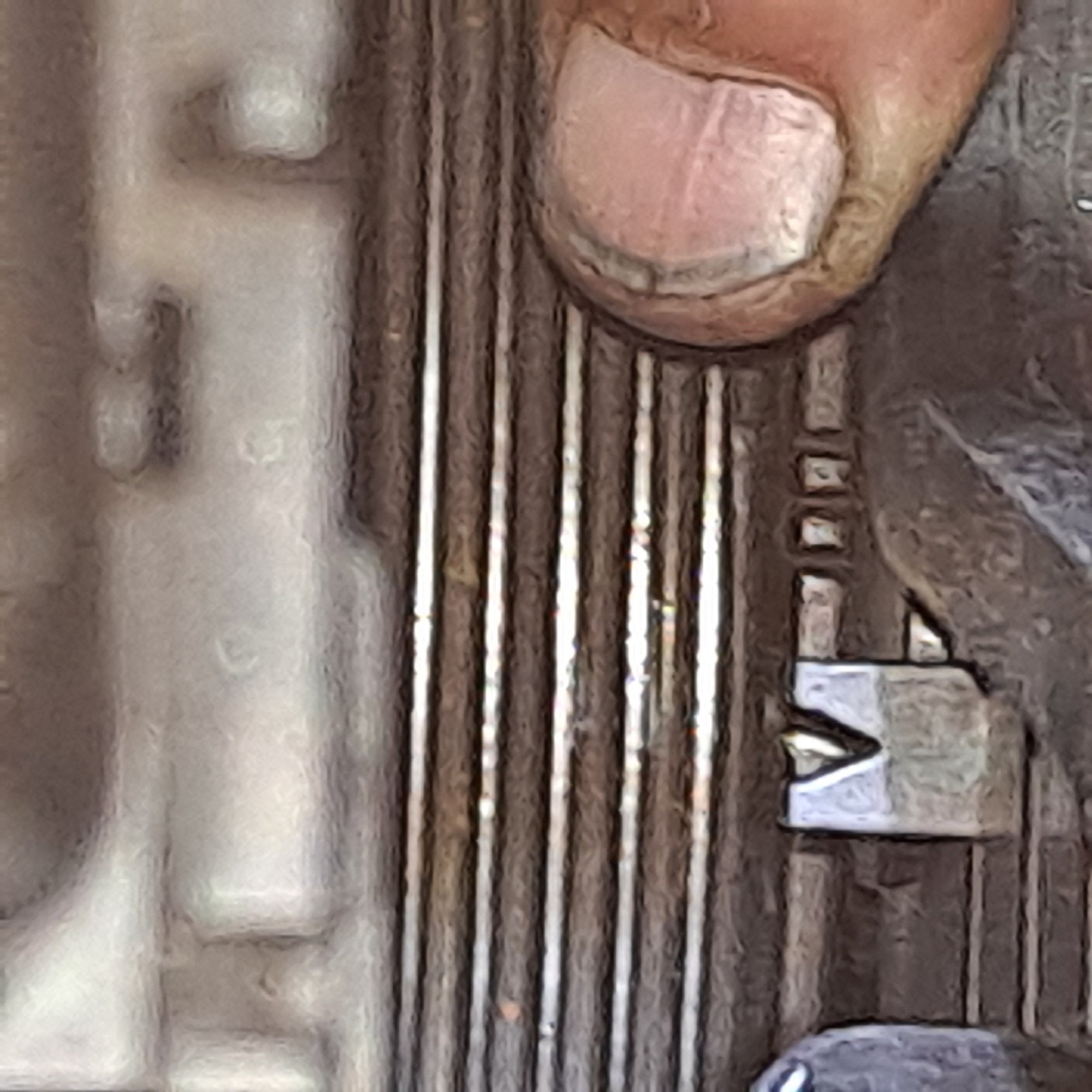

How far off does this look?
All I did was rotate the crank until the timing mark lined up with the cover sight and to be honest depending on which way you turn your head it does or doesn't. I have been sick as well but I think I am over the sinus allergy crap. To me it doesnt look perfect ,close maybe, but not perfect. I havent sacrifice a hanger yet.
as long as it is not a tooth difference...
now, your engine really have a lot of gunk in its surfaces...
Cam sensor isn't reading correctly. I get a slight volt drop less than .5v and then it comes back up to 12.5 v
Eng is TDC According to a hanger and all the marks line up.
