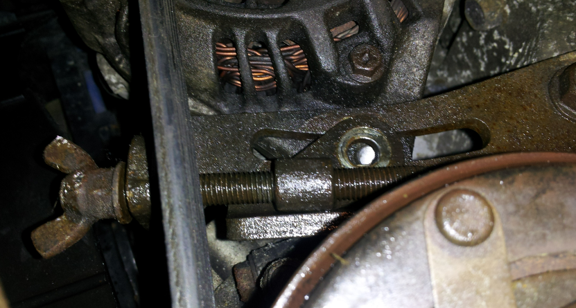

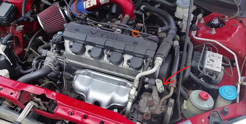

But.. if you're curious, this is where you adjust the belt tensions:
The power steering belt, the adjustment is the wing bolt right next to the belt
For the alternator belt (if you have AC, it piggybacks off this), its a bit more difficult to get to. There's a whole sliding bracket you have to loosen the left-right oriented bolt, then tighten/loosen the wingbolt to adjust tension. Looks like this pic was taken from the outboard side looking in. The left-right facing bolt has been removed, and the hole you see above that wing bolt is where it goes.

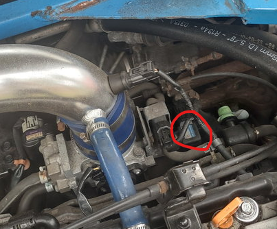

If anyone in the forum has seen something like this they could offer a suggestion. I guess most of these types of sensors come out the same way. I wouldn't know where to get a new one if I messed up.
Old Jun 12, 2023
Rep Power: 512
Re: Cost of tightening both fan belts
This is the MAP sensor
The one sticking out the side of the intake tube is the intake air temp sensor (IAT)
Edit: to remove the IAT sensor, unplug it (to avoid damaging the wires) and give it a firm pull. Should come out. The rubber grommet might come out with it, but that's not a big deal. Prolly won't do you much if you clean it, but it also won't hurt anything.
The map sensor is held on by a screw and, same deal, firm pull upward. That shouldn't give you much issue, either. I remember spraying mine down with some brake cleaner and having no issues. Your mileage may vary.
