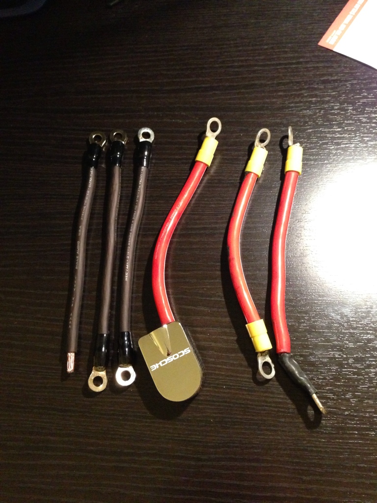

Here are the wires that are done for me. (Black is new, red is my old kit)
Since the first few ones are the ones where you make the most mistakes, I made mine first to get the hang of it first
I made all the cables the same length, saving me some extra time from measuring.
There should be enough length for all 3 connections.
I soldered all the terminals on, to ensure connection and that it wont come loose.

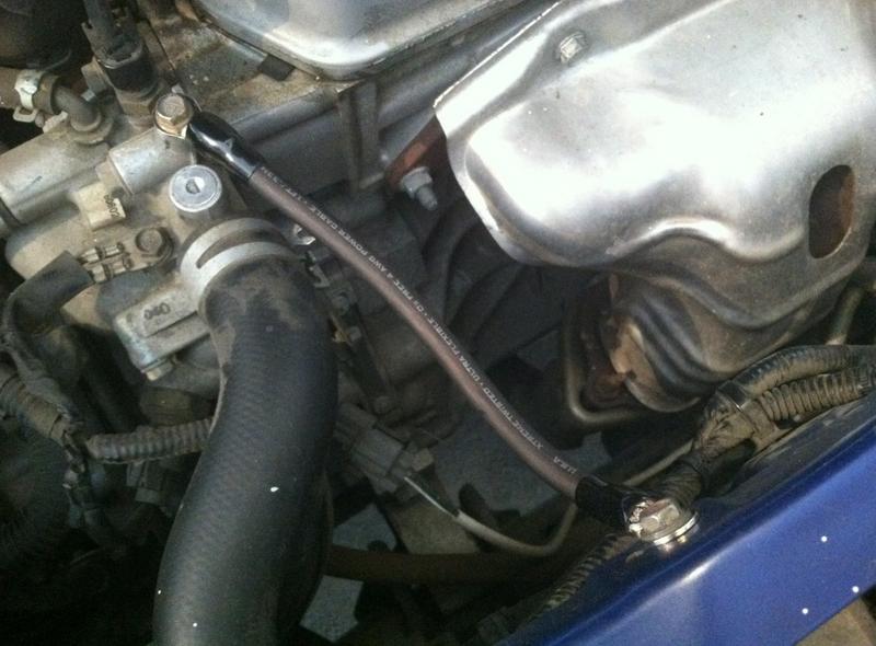

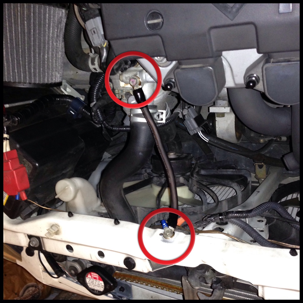

1. Remove the two bolts holding down the stock engine to chassis wire, replace the wire, and bolt it back down in place.

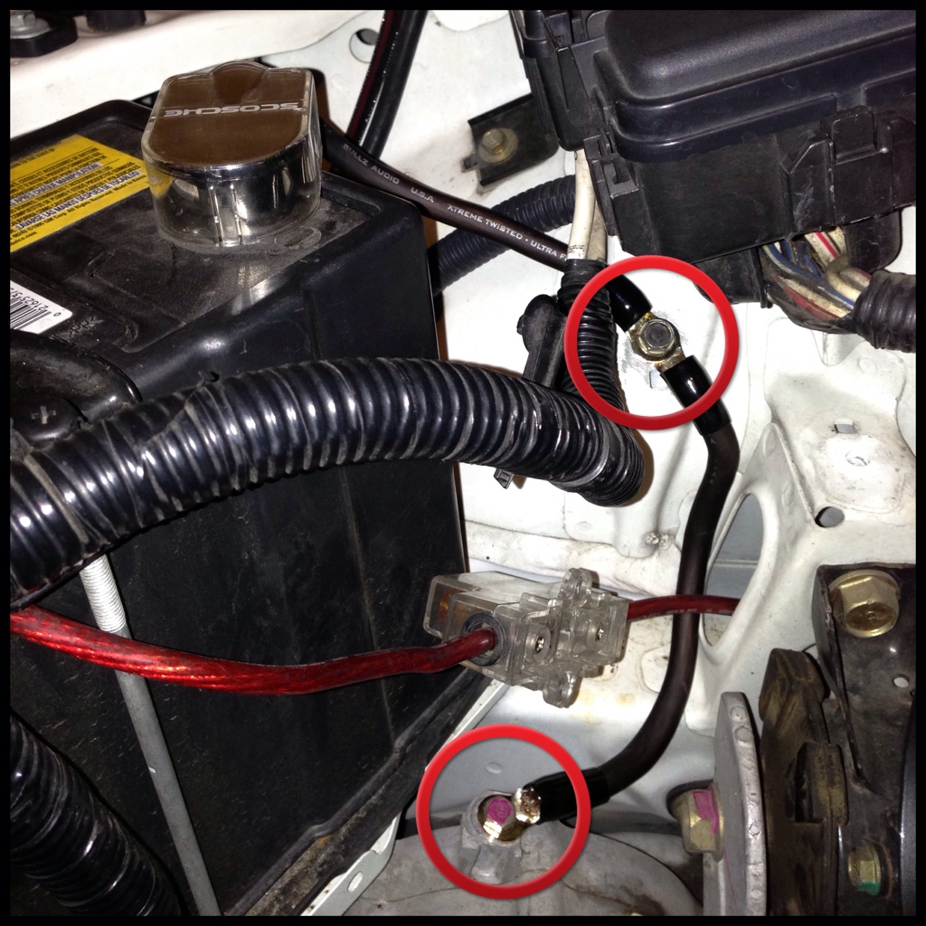

2. Remove the stock Neg battery terminal, then remove these two bolts holding the battery Neg to chassis and tranny to chassis cable. (Stock is one piece of wire)
This connection is under the fuse box, you may have to remove the stock/aftermarket air filter to access it.

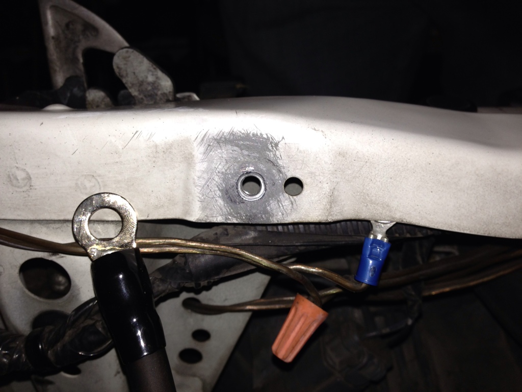

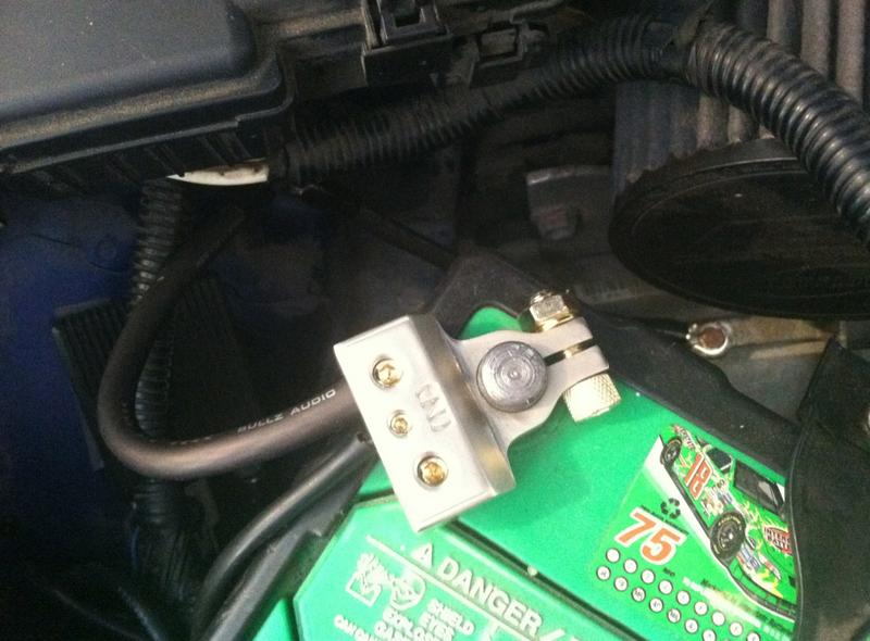

BTW, my positive terminal lead was so corroded, I had to shear the end off to make the connection. Good thing I got these cables when I did.
