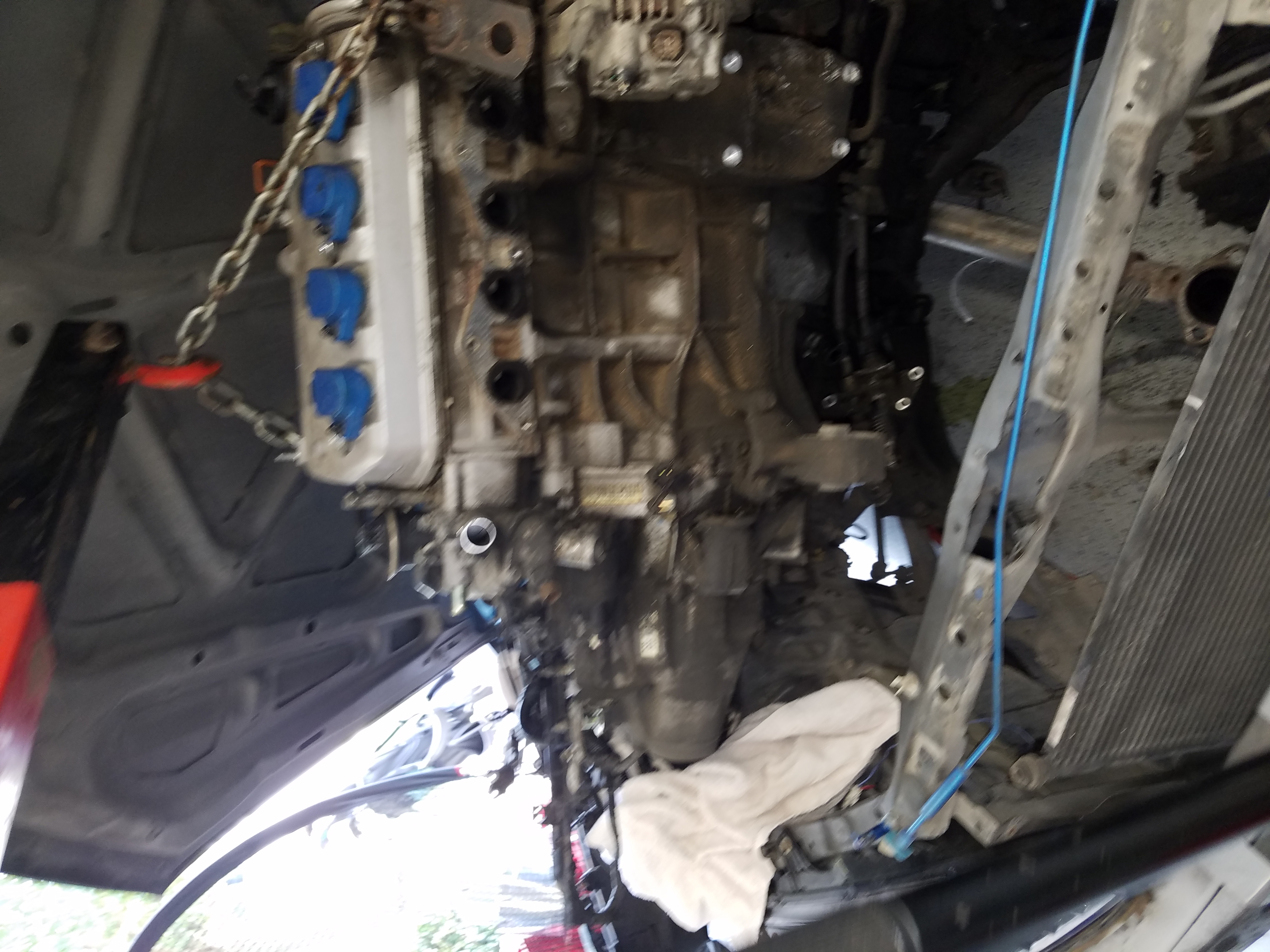

I recently took the engine out and wiped it clean.

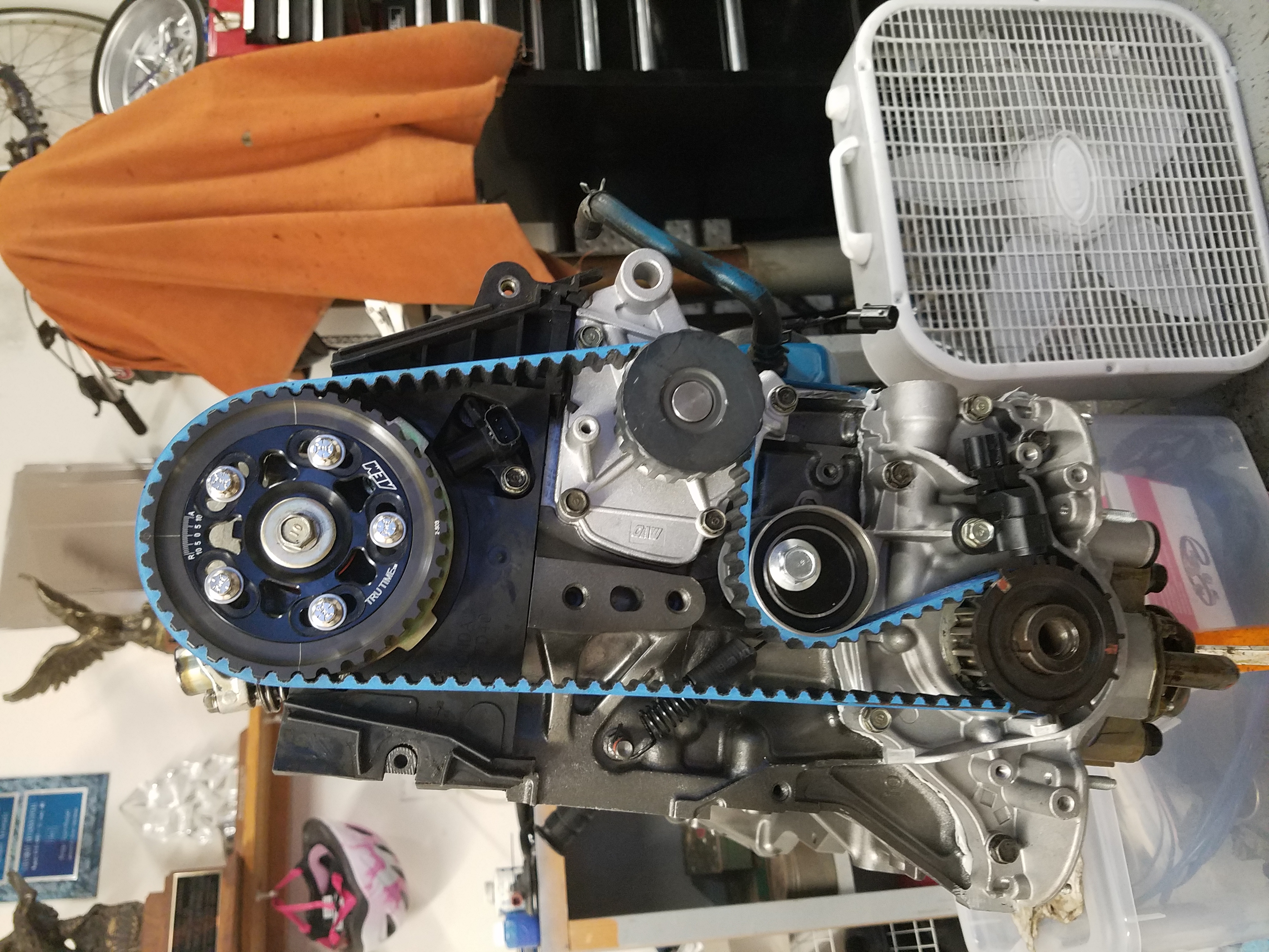

Since the engine was out....i installed a new water pump, oil pump, all new gaskets, Gates racing timing belt, fx racing stage 3 clutch w/8.6lbs flywheel, drilled the oil pan for a turbo oil line return and capped it.
The plan is to help get this new alternative ecu running efficiently then slap on an ebay turbo. i have a new fuel pump and 660 cc injectors ready to play with the turbo...

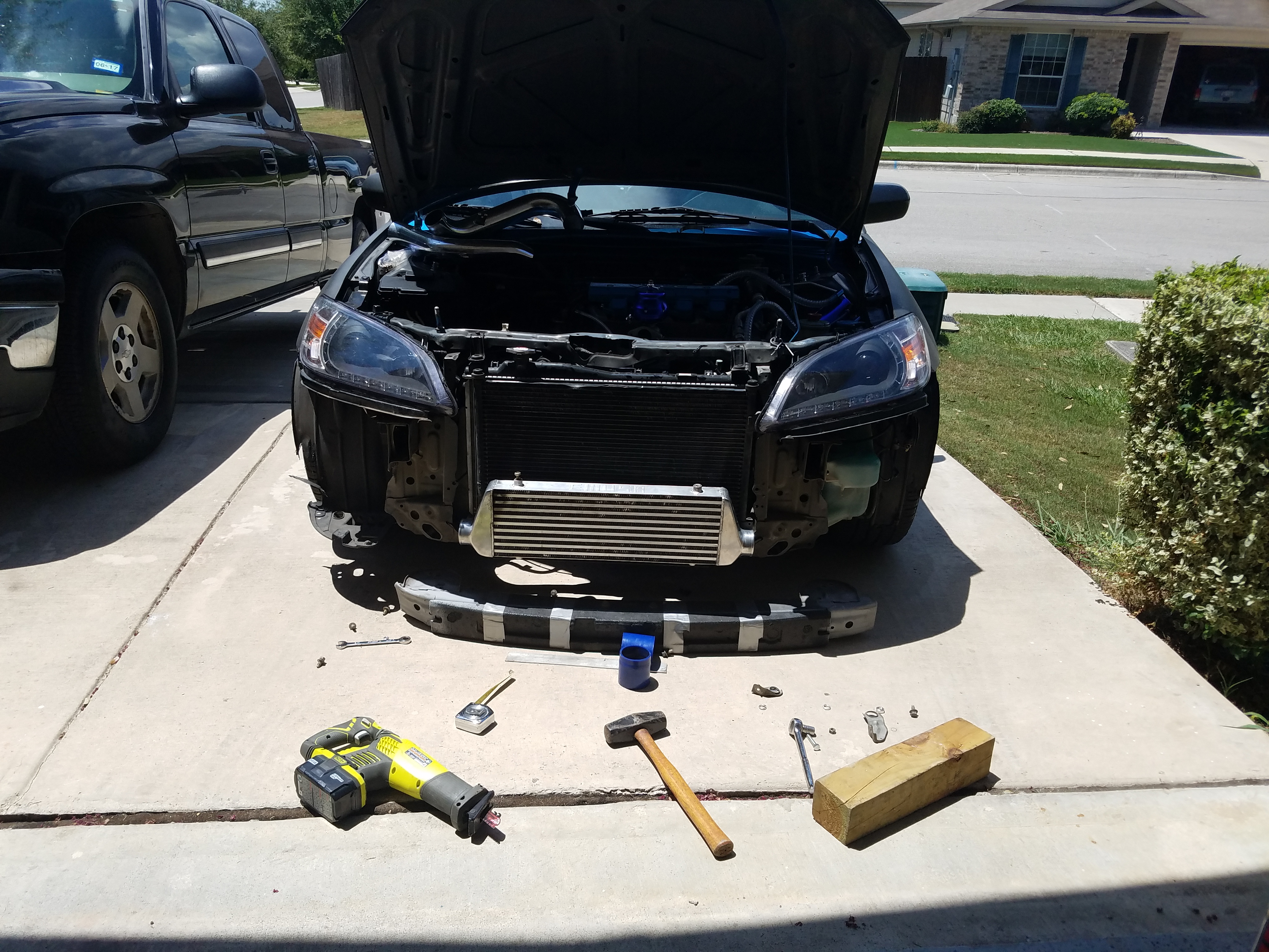

guess what i picked up today.....

hrm.. I know in the past it was an issue, mostly with the d17a2, but people had issues fitting in intercoolers with the inlet and outlet on opposite sides. My boost setup had the inlet/outlet on the same side for that very reason

If i can't make it fit then i'll live dangerously and not have an inter cooler....jk.
Thanks for the info!
Old Jul 14, 2017
Rep Power: 513
Re: Ktuner and the D17
Another thing people have done is route the plumbing from the driver's side (ic inlet) across the front bottom of the IC, then around the passenger side to make it all fit. I think it was AC plumbing that got in the way. If you dont have AC, then carry on, my friend

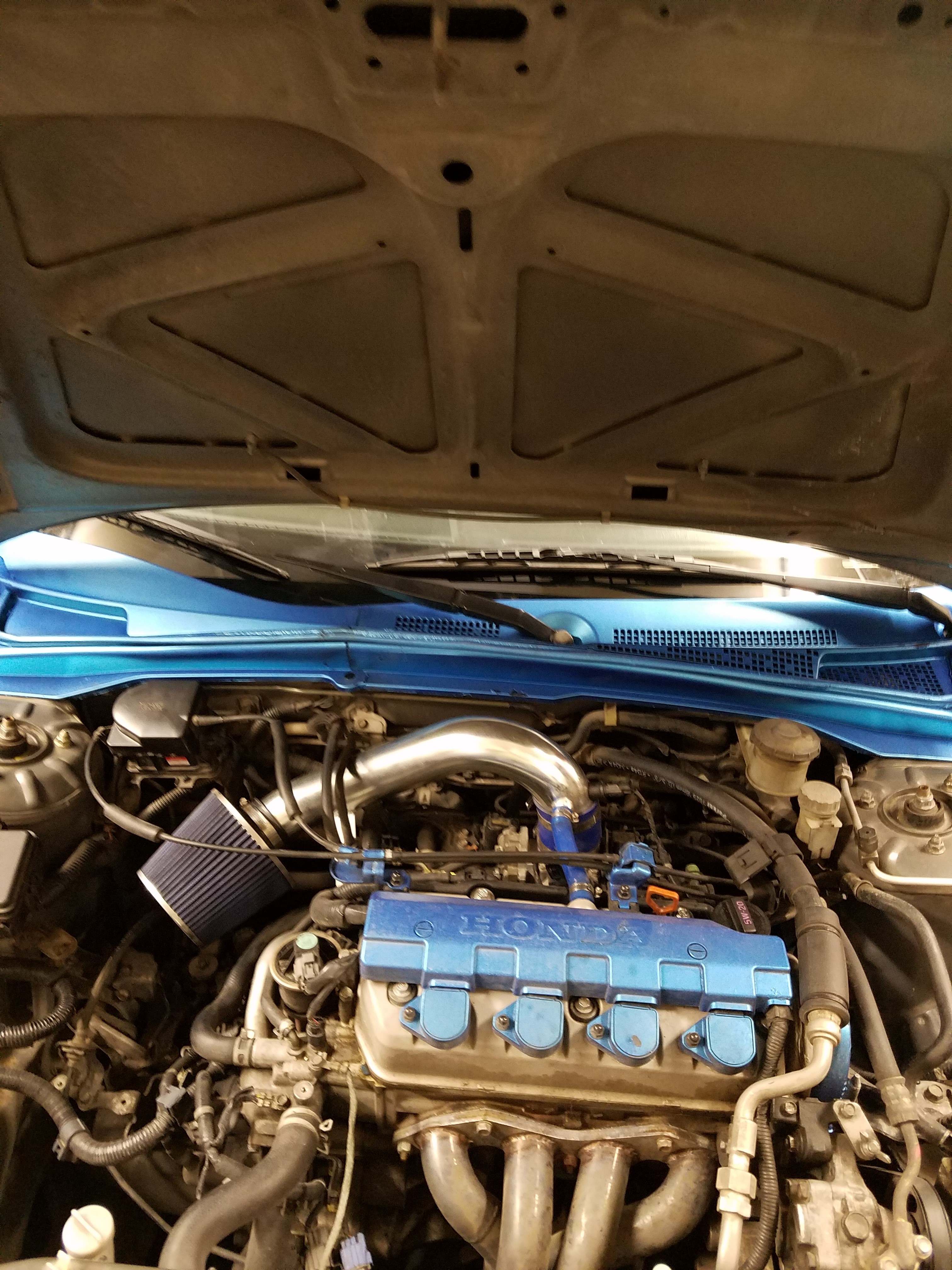

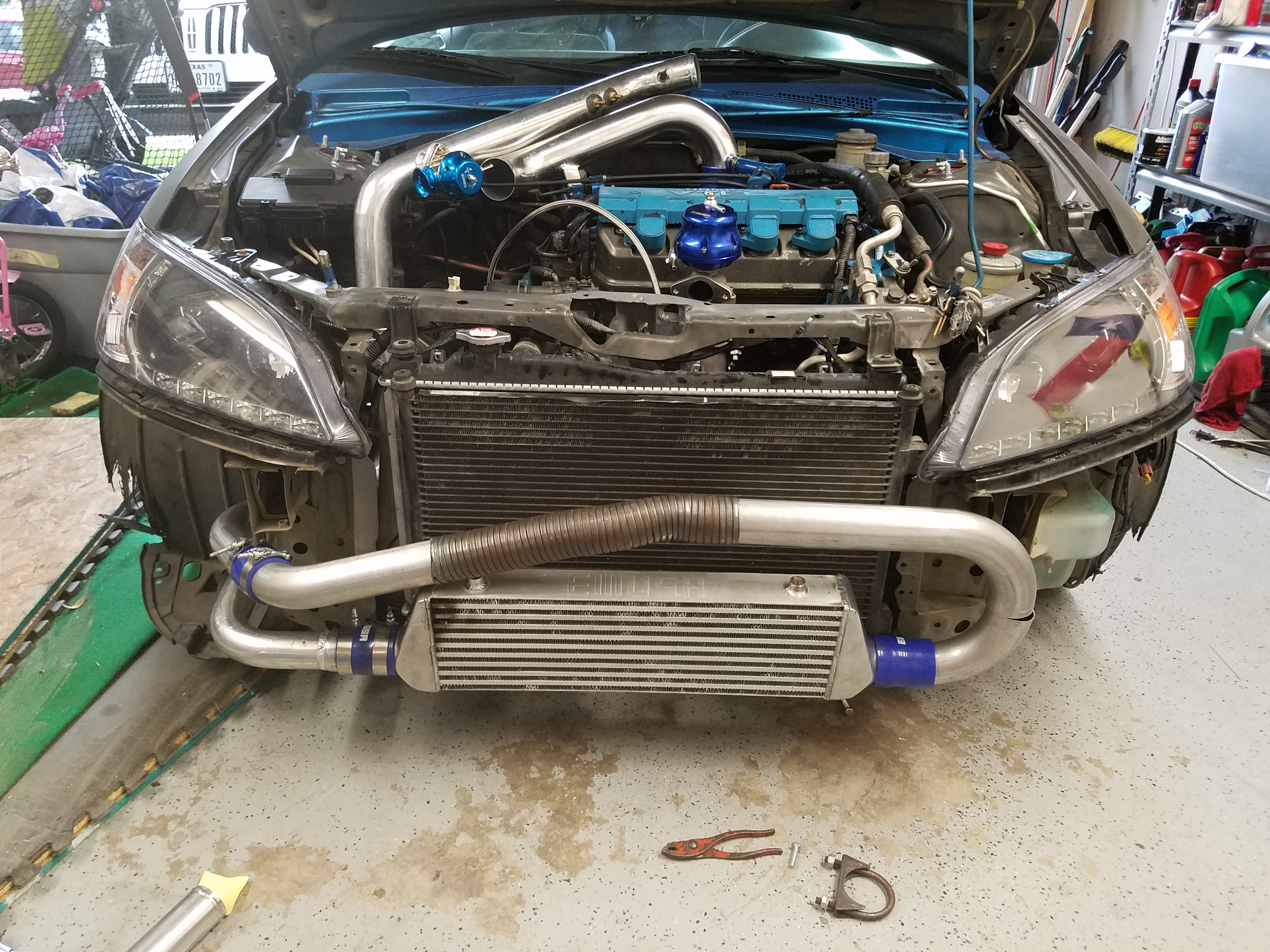

its been a long day to say the least...anything that would not fit...didn't...good thing i can fabricate things...

I take it you tried and realized the IC piping wouldn't go around the drivers side? Lol

I actually did throw around the idea of no intercooler, then a budy of mine running a 900 hp turbo S-10 talked me out of it...
Anyways, the oil lines are installed and waiting on the last few couplers to come in. I'm hoping to have it started by Thursday evening!!

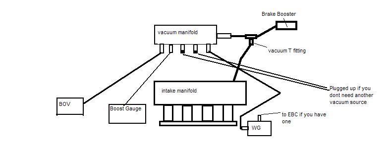

Does anyone have any good diagrams showing how to properly hook up the vacuum lines?
I have a vacuum box which will be coming off the brake booster.
I have a mechanical boost controller.
The wastegate has an upper and lower fitting..
Obviously the turbo has a fitting and the bov has one.
The pipe after the bov going towards the TB has two...
CANT WAIT!!!!!!!
As far as the boost controller lines go. It goes like this. WG Actuator Port-->>>Boost Controller-->>Pressure Port on Compressor
The other port on your Wastegate will vent to the atm.
Hope this helps. Added an image attached.

Thanks!
I still could use a diagram of the vacuum lines....

Need a vacuum manifold? Lol. I have a golden eagle one laying around I think
Edit: when tapping your brake booster line, make sure you're upstream (engine side) of the check valve. You can feel it by physically feeling around for it.

Originally Posted by Erf_Em2
CANT WAIT!!!!!!!
Thanks for the help and the pic!
Thanks for the offer...i bought a manifold a while back.
Also, thanks for the booster reminder.
