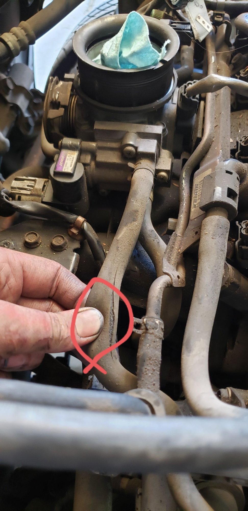

Thank you for putting that list together! I used it to buy all of the gasket kit parts separately from the Honda estore and saved a bunch of money compared to buying the bundled gasket kit. Not to mention that as someone who's often guilty of cheaping out and buying aftermarket parts, the discussions in that thread lead me to seriously consider and eventually decide on OEM parts for this job.
Also, I just pulled the air cleaner and found my first impending issue not directly related to the repair. Looks like one of the coolant lines to the IAC (although honda seems to call it a rotary air control) is cracked and will need replacing...

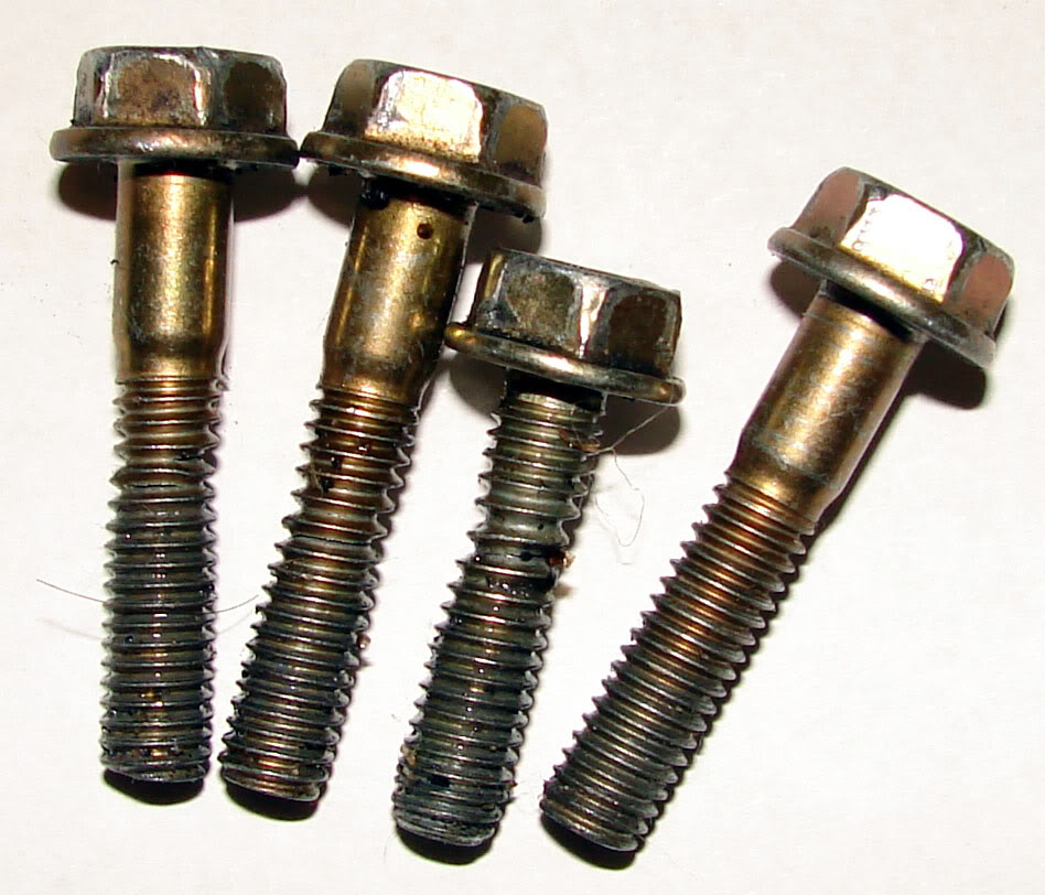

what type of torque wrench are you using?
I twisted my water pump bolts because I was using a higher end torque wrench, click type. The ones that uses the click, they need to be chosen by torque range. The regular bigger ones does not have enough sensitivity for low torque.
I had to use a needle beam type for lower torque bolts.
I use a 1/4-inch drive click-type torque wrench that measures in inch-pounds for the small bolts. It feels like there's barely any torque on the bolts but that's all they need. Same with the valve cover and oil pan bolts. The 3/8-inch is not sensitive enough at that low range.
Having said that, I stripped yet another valve cover thread over the weekend. I have a small leak and wanted to loosen and retorque the valve cover bolts. Sure enough, one of the two remaining threads without a Helicoil has stripped out. This was the rebuilt cylinder head I bought. Which works fine, other than the valve cover threads.

for low torque, you need a needle type wrench
click is not sensitive enough.

I was wrongly calling beam wrench back then :P
click in attachment below to see how much bolts liked them...
Originally Posted by sdaidoji
OK, then, for low torque applications, it is recommended to use a beam type torque wrench. The "click" type is not recommended since it is not too accurate for lower ranges.
Now, a quick quiz: Which of these 4 bolts are still good? (they are my water pump bolts...) I used the click type on them...

as long as the target torque value falls between 20-90% of the indicated range, it'll be accurate enough. Nevertheless, I never liked deflecting beam torque wrenches. At least, that's what the navy drilled into my head with regards to quality assurance training in a nuclear power plant. For low torque, I'd recommend converting to inch pounds (literally just multiply the ft-lb value by 12) and grabbing a in-lb torque wrench
For damn near anything you'll need to do on a civic, a 0-150ft-lb and a 0-250in-lb micrometer torque wrench (clicky type) has served me quite well
