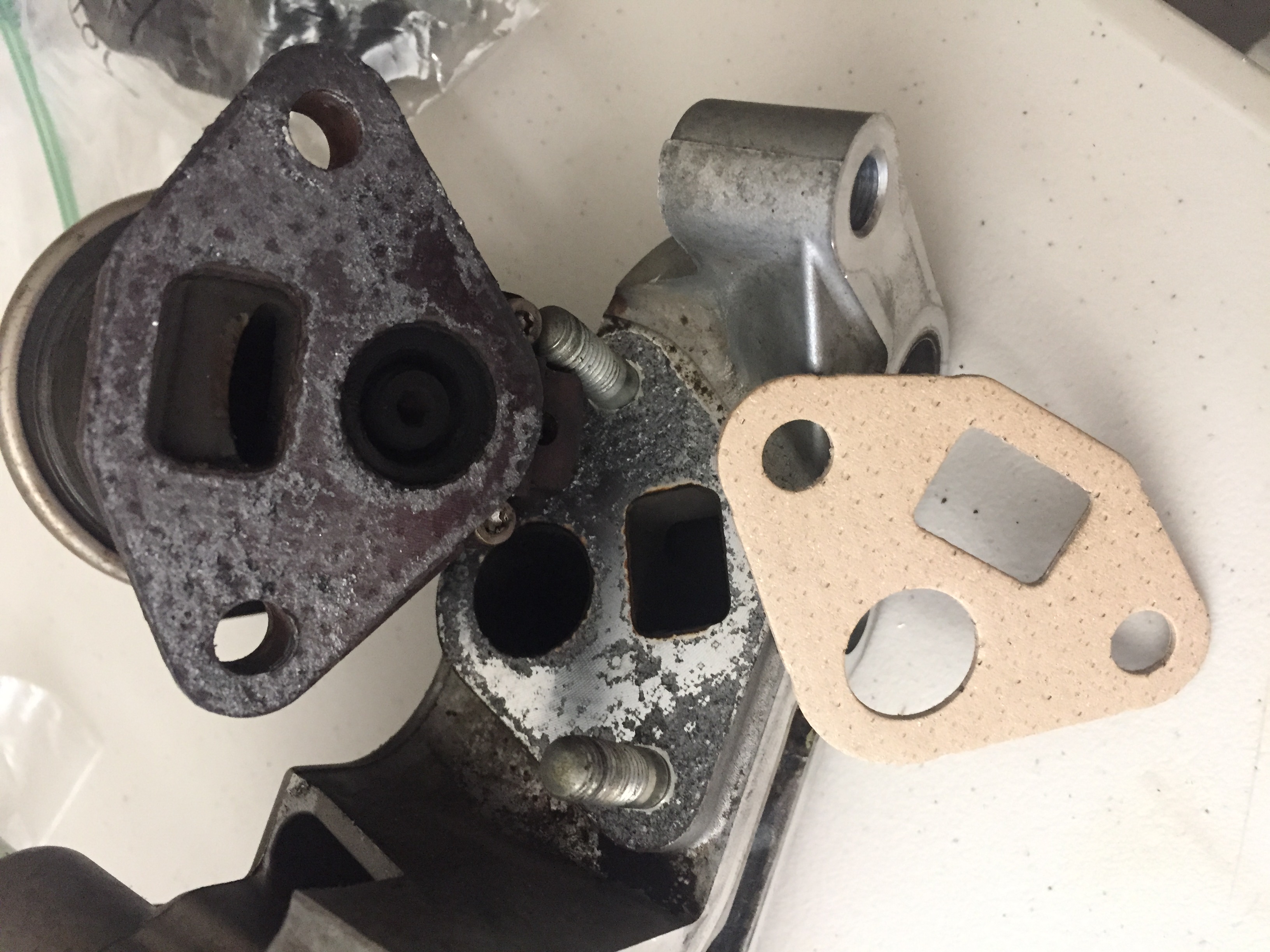

Ok, took of the EGR canister thingy. Little concerned now. It looks like there is a metal gasket on the bottom of the canister now. It started to peel up as you can see in the picture attached, but it feels fairly well fused with the EGR canister. The new gasket feels like cardboard. Is this really what I am supposed to use?
If so, I suppose I have to peel the old gasket off? The cardboard gasket has a flat side and a rounded edged side, not sure which side goes up or down.
Any help?

Re: Head Gasket + Timing Belt DIY
Any help?
It's usually pretty safe to use the specs for other similar 8mm fasteners like the intake manifold hardware, 16 ft-lb
(I like to use a thin layer of aviation sealant on that steel gasket for peace of mind but it's not supposed to be necessary)
The EGR gasket is a sandwich type there is a layer of metal in the center of it, paper (not really paper) on the outsides. Either way will work (except backwards), it's just got to seal up all the holes.
Yes, scrape off the layers of old gasket.
