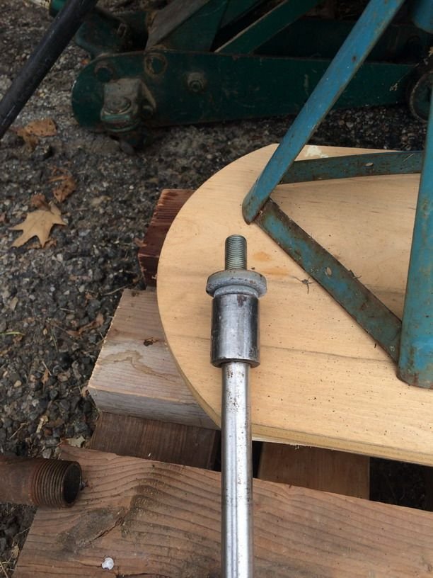

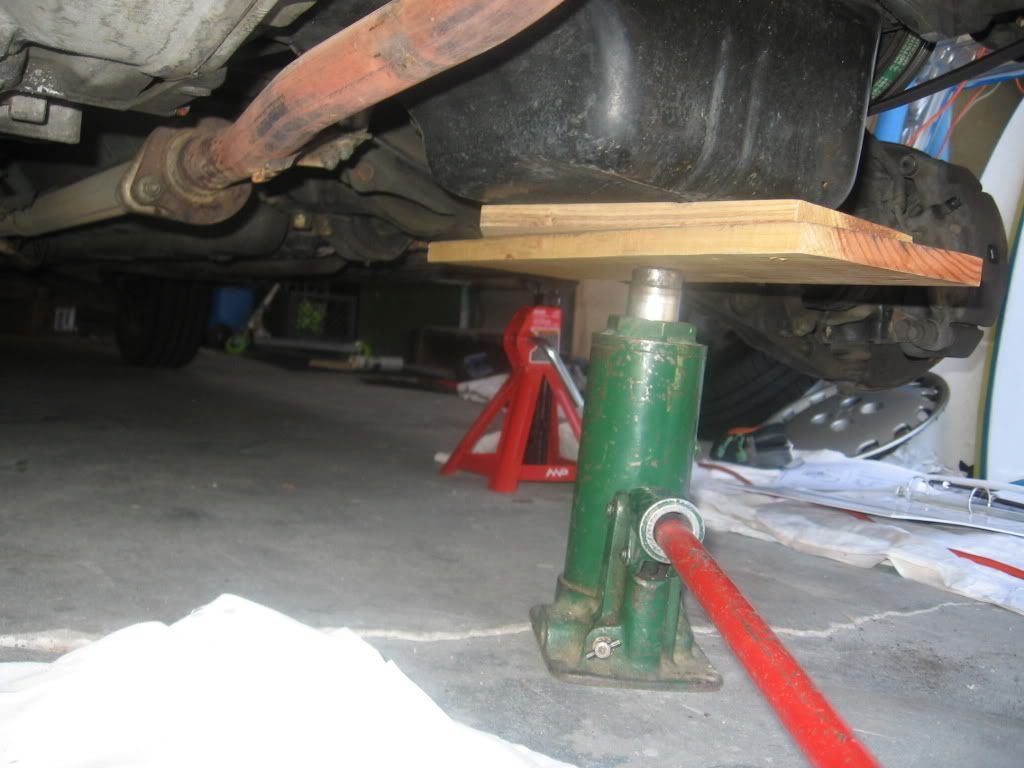

Thanks again Mikey, that video was great!
After setting things up like in the video I got the Crank Pulley Bolt off in less than a minute!
I use two pieces/ lengths of 3/4" black pipe.
You can see why/ how I used two pieces in these pics.
good job....that is exactly the way i do it

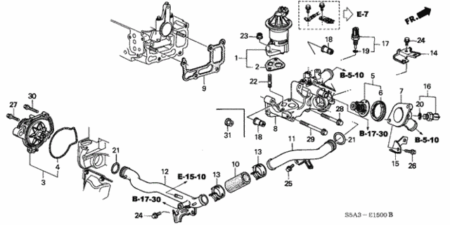

I replied here earlier about an '03 EX I was considering buying, but decided not to. Glad I didn't, as I've purchased two '09 CR-Vs within the past two years.
Our '04 Civic LX, though, needs the head rebuilt most likely due to a burned valve (no compression in #2--I may have posted about it here in another thread). I'm gathering up all the bits and pieces for removing and reinstalling the cylinder head. I'm good on gaskets, except for this one:
This is part of a larger photo showing a "gasket set" for the engine. I have no idea what this gasket is for.
Old Aug 16, 2018
  #225
Rep Power: 513
Re: Head Gasket + Timing Belt DIY
That's the water passage gasket, opposite side of the engine as the timing belt. #9 on the drawing below

I've started disassembling everything. I am hung up on the coolant bypass pipe (#11 above). I can't get it to move enough to pull out of the housing since there is a black clip attached to the bracket where this pipe is bolted to the engine (where part #25, the bolt passes through), and that black clip is strapped to a wire harness which does not have any play in it. I can't get the clip off of the metal tab. I'm afraid to pry on it due to it being plastic. (I can post a photo of it tomorrow, if it helps.)
Also, when reassembling this pipe, do I have to replace that gasket/o-ring or whatever it is (#21) or is it OK to reuse?
Next--for the exhaust manifold/catalytic converter (this is an LX), can I remove it without removing the top heat shield? The top two bolts for the heat shield come out no problem. The bottom two are rusted to the point where they rounded off very easily. I don't have a bolt extractor--I would need a 9mm since a 9mm socket fits on the now-rounded bolt, and the 10mm extractor I have just spins on it. I can reach the bottom middle manifold nut with no problem.
Finally, having read through all of this again, would it be easier to pull the head out with the intake attached, and remove it while the head is off? I have a rebuilt head ready to go, so I'm wondering if it's easier to transfer all of this stuff over to the new head while it is out of the car, vs. fumbling in tight awkward spaces to do it.
I am replacing the PCV valve while I have it all apart--it's cheap enough.
Old Sep 8, 2018
  #229
Remove wire harness mount from the metal tab. There will be a release clip you push or pull in order to take it off of the tab.
Also, remove the upper spring clamp from the short rubber hose coupler #10 and work a pocket screwdriver between hose and metal tube to get the rubber to 'let go' of the tube and give you more room to get the pipe #11 out of the stat housing.

the intake mani is definitely a pain in the *** to unbolt from the head. If you can finagle it out while attached to the head, it should be easier. I think that's how I did it back in october. There are a couple brackets connecting the bottom of the IM to the block; 3 bolts IIRC. Remove those, remove the air cleaner/resonator box, and carefully wiggle it the head/IM assembly out.
As for the water pipe that connects to the water passage (the aforementioned #11), undo the clamps holding the rubber hose to #11, remove bolt #25 (pipe support onto... something..), unbolt the water passage from the head, and it should give you more maneuverability to remove it all. I never replaced the o-ring (#21) and I never had any leakage issues. Also, what ezone said. Coolant probably crusted on the rubber hose/metal pipe interface effectively sealing it together. Break that seal by twisting or with a screwdriver. Or both. I had success breaking that seal by grabbing the outside of the rubber hose with some channel locks and rotating the rubber hose until you feel it break loose.

I think it's part number 91302-PLC-000, but the picture is very small. It seems like it'd be more expensive to produce than the soft rubber ones, so I'm leaning toward that. It might be 91301-PLC-000, but I think that's the fatter, soft-rubber one. They're pretty cheap, so might as well replace all 4 of each just in case!
edit: No issues with the fuel rail side ones. Mine aren't exactly like the diagram on the Honda website, and I kinda wonder if they're a different style or aftermarket ones or something. Mine had a soft rubber o ring on the end on the injector side that gets shoved in, and a harder plastic-like ring that was more like a washer with a slight bulge in the center, that snapped on and held the o ring in. I guess I should've taken a picture when it was out!
edit2: I didn't remove the injectors from the fuel rail. The one for Cylinder 1 came out, but it still looked fine, so I shoved it back in. I don't see the end nub thing I'm talking about on the parts diagram at all. I'll keep looking!
