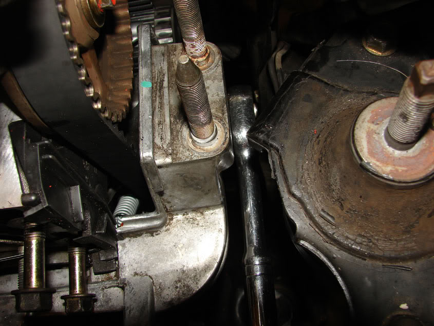

here is why the alternator bracket was a pain. Yes, there is a socket in there...
