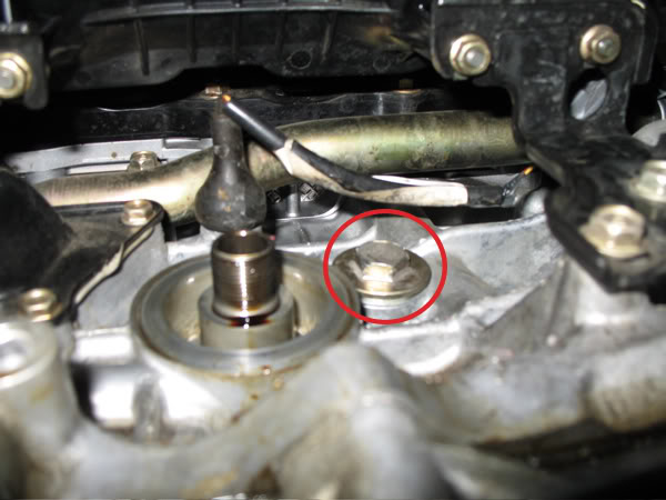

Did you remove the coolant drain bolt from the back of the block? It's located above and to the right of the oil filter.

Re: Head Gasket + Timing Belt DIY
Nope. I'm guessing since you posted this. I should.

I know what I disassemble when I do the job. I DON'T know what other people feel like taking apart when they do the job.
The nut with attached washer looks to me like the one that was supposed to secure the big wire to the alternator hot stud. Starter cable would usually have a similar nut with attached washer. Did you remove either of those?
IDK where the bolt came from. It's not a timing cover bolt, at least not from the factory.
Ground wire maybe?
The stripped VC bole holes would probably get some helicoil repairs if I did it in the shop.
