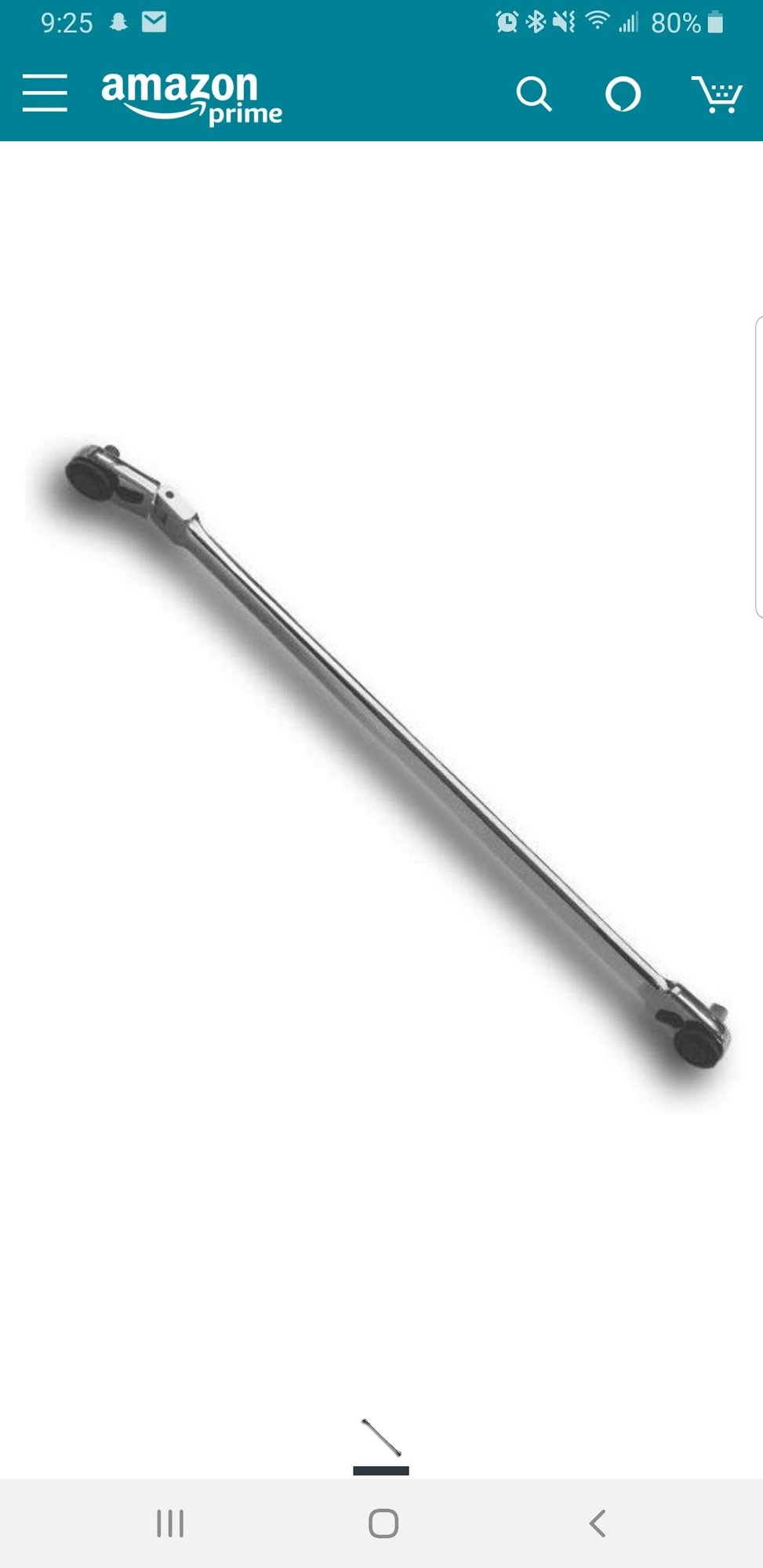

It took me almost a year, but I finally got the Civic put back together and running! Now I can stop pestering this thread every few months with updates.
I ended up buying a Neiko ½" breaker bar from Amazon, and that thing is a monster. I also bought some sections of 1" galvanized steel pipe to give myself some leverage. Oddly, the crank bolt did not "snap" when it broke loose (as old bolts tend to do), but it moved very stiffly, to where I thought my breaker bars were moving. That wasn't the case. About half a revolution of stiff turning was all it took and the bolt came out.
That intake manifold nut really wasn't too bad. I have a set of ratcheting box-end wrenches and I managed to get it loose and tighten that nut with it. It's easiest to get the car high enough on jack stands to slide fully under it, then with some light, it's easy to see the nut and get it removed. Installing it was a little more tricky but still, it was only a minute or so to get it located enough to start spinning it on.
