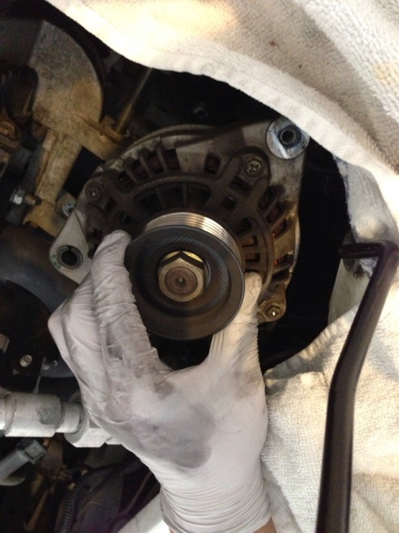

12. Now for inspection.
Check if your new alternator is same size and shape as the old one. (Higher alternators may be larger in size, or have a larger pulley)
Notice there's a bracket where the black clip was held on to on the old alternator. You're going to have to move it onto the new one.

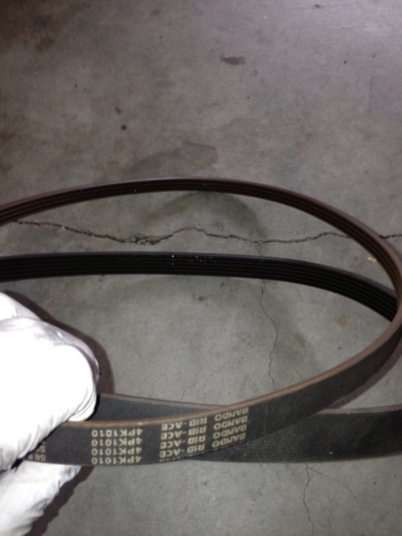

Now is also a very good time to inspect the belts you removed.
If any of them are cracking, shows signs of age, you should have them replaced.
Mine seemed fairly decent, so I didn't replace them.

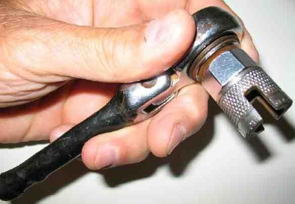

Originally Posted by lemmiwinks
step 13. (this one was a REAL pain until I finally learned how to do it the right way). To tension the alternator and power steering belts, you should put in the top and bottom bolts but do NOT fasten tightly! Once the top and bottom bolts are in, adjust the belt tension with the wing nuts until you can't tighten anymore (try a small set of pliers since there's really not a lot of space to tighten with your fingers). Only AFTER tightening the wing nut should you tighten the top and bottom bolts.
I have battled the alternator wing nut for a couple years. Just today I realized it is not just a wing nut: It's an OEM "wing nut and hex nut." One can fit a 12 mm open end wrench on the hex from the inbd side of the car. I attached a rope to the box end and pulled vertically up. See my sketch below. For final tightening, I could turn the nut about a quarter turn using this method. I see a poster named s10xtremist at clubcivic.com took this a step further: He removed the bolt, cut off the wings, reinstalled it, and used a socket etc. on the 12 mm hex nut. He reports: "Made tightening the belt a breeze!" See photos for other tools for the wing nut. A poster at honda-tech.com says the wing nut socket can be bought for $4. I have not found it for sale online yet. The PVC wing nut socket wrench is made from a 1/2-inc irrigation tee and I presume a grinder or hacksaw. The other homemade tool is made from an old abandoned socket wrench and I presume a grinder.

ID:	86596   Click image for larger version
ID:	86599   Click image for larger version
ID:	86600   Click image for larger version

Now that I removed the old alternator, I go to put in the new one and of course it doesn't fit.
I bought the same exact one as in this thread and there is a groove on the right side making it not fit in properly.
I looked at a video online of replacing the alternator and the guy just easily puts in the new one.... Any suggestions??
Here is a couple of pics to show what I'm talking about.

i have no idea what your talking about looking at those pics, can you circle the part you are talking about in the picture?
what is hitting and where?
are you able to install the top bolt?
maybe have somebody else take a picture while you are trying to install the alternator so we can see whats hitting3and where?

Edited the pics so you can tell. And if you go back and look at OP's pics his doesn't have the bulging groove mine has even though they are the same alternator...
The groove is on on the top mount on the right side.
