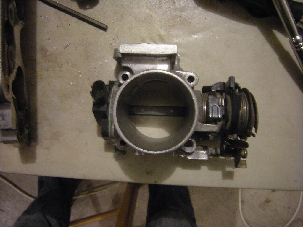

I don't recall this ever being 'too hard'. I did this swap way back when, and while your solution works, it is far from elegant. Now, I will be interested to see your solution for deleting EGR. With K-pro, this swap is simply a matter of making the throttle body bolt up, and the mani bolt to the head (along with a few other minor issues). However, without K-pro, you will have serious issues. The first is that it won't idle worth a damn. The second is that tip in from a stop will stumble, along with other tune related issues. And on top of the driveability issues, you still have to remove EGR.

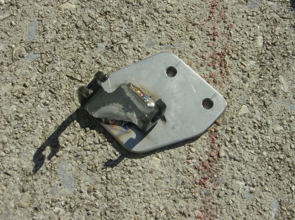

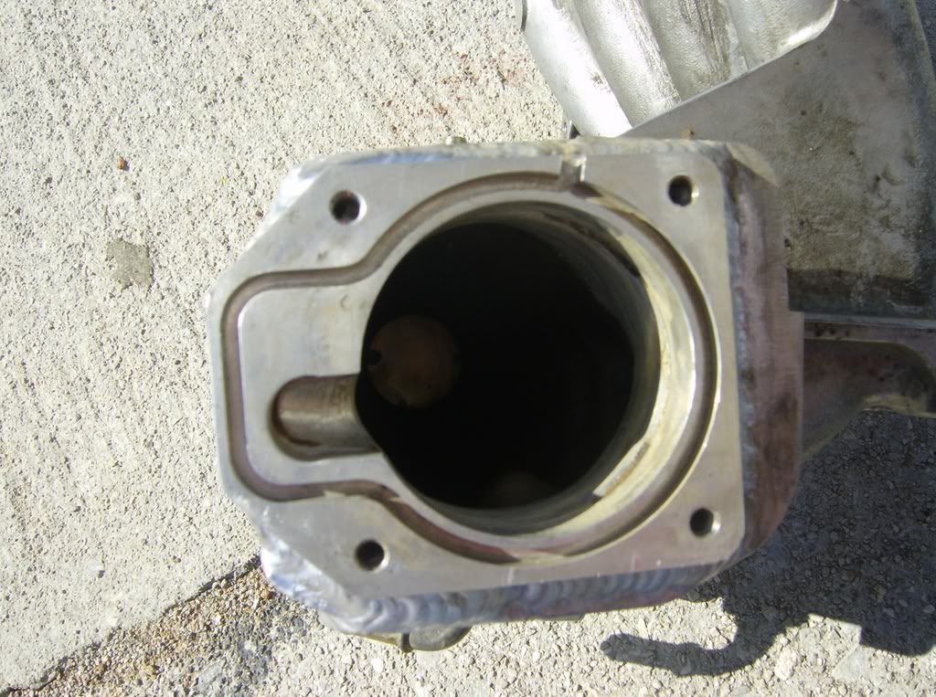

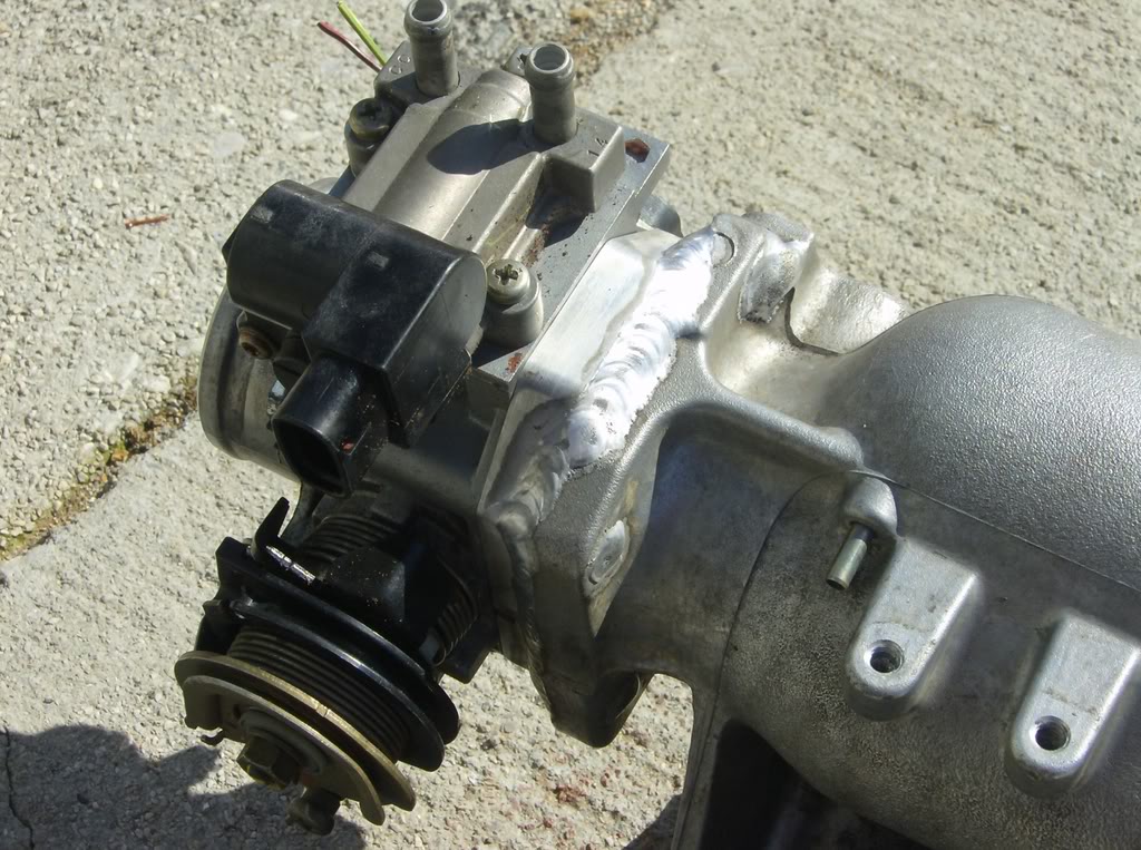

Oh yeah, I almost forgot, you have to figure out how to make injectors fit, along with a fuel rail. I found that srt-4 injectors fit quite well into the y8 mani with a little enlarging of the injector bosses on the manifold. And I just welded a couple mounting tabs onto the stock rail. Here's a few pics for some inspiration (and hopefully posterity since the diy I had on 7thgen seems to have disappeared).
I've read up on the swap many times to see if I could get anyone who knows a great deal about this, and many people said putting the d17 throttle body on the manifold was too hard. It is far from elegant, but who is going to care? If my car was a show car, then yes, I would've done it differently. But it's going to be just a fun car to drive.
And I own a 2001 Lx so my model didn't come with the EGR function And what tune related issues will i have? Other people have said it will idle bad, but no one who has actually done the swap said that. I think most people are based on theory than the actual swap. (MindBomber said he thinks the velocity of the air changes once inside the manifold...) I'm hopefully getting E-Manage soon fyi.
And I was planning to weld the d17 injector plate on the manifold, my buddy has a welding kit. But until then, i'm just working on struts.

HI, how did you weld the tb to the mani, did you use a spacer? And if you did what spacer did you use I would like to do the same to my setup. D17 tb to y8 mani. Thanx man
