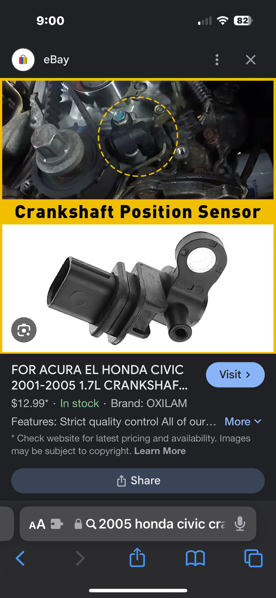

I had just recently finished up a valve job on the d17a2 head, put everything back together started car ran codes and had crank sensor code which I then realized that it was broken and not plugged in ( free hanging in bay)due to my timing belt breaking and hitting it. So I replaced the sensor with an aftermarket one and no start whatsoever just cranks. I figured that the sensor was bad or bad connection so I had another oem sensor off a donor civic same gen, and plugged it in and same thing just cranks. I unplugged the sensor completely and car starts up every time. I am stumped and would appreciate any help!

get a new denso or NTK sensor.
Hondas hate aftermarket sensors.

Sdaidoji, I have tried even with a new denso sensor it is doing the same thing

I cannot find the thread now, but at one point someone found some of the teeth broken off the crankshaft timing gear. The teeth that the crankshaft sensor reads.

I had thought that it reads where it sits in the block it doesn’t seem like it reads the little teeth

The sensor reads the teeth sticking out from the crankshaft timing belt pulley. I wish I could find that thread. Maybe @sdaidoji remembers?

I
thought it read through the small hole, I will check out my teeth and see if so I have another gear for it
