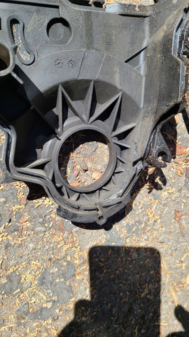

Found a/the problem... all of the teeth on the timing gear are sheared off!
I'm beginning to belive this isn't a 30k mile engine. ..

How in the heck did that happen?
I am thinking a lucky rock or bolt got in there.

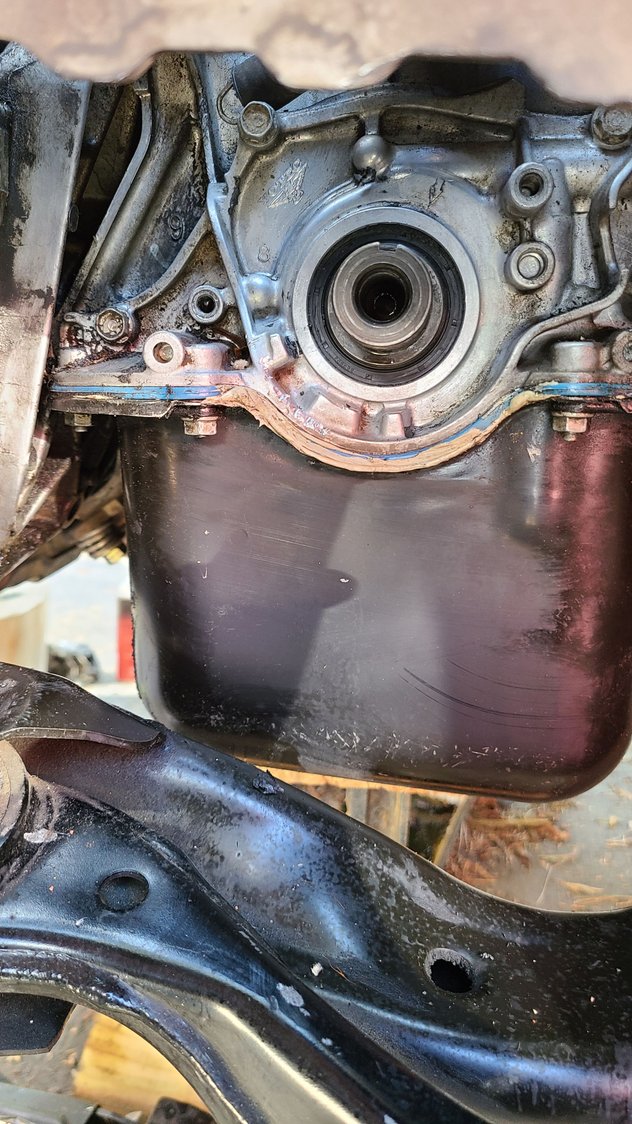

only 1 of the lower timing cover bolts were connected, the cover was cracked/separated/broken on the other 3
what I don't understand is how the car drove the past 10,000 miles with all this stuff wrong with it and not throw a code

it looks like my assumption was correct. Something definitely got in there shredded the teeth and exited violently out the bottom left side tearing the lower timing cover and creating a jagged mating surface on the Block

Replaced the timing sprocket and lower timing cover, put it all back together and she's purring like a 20 year old kitten.
The exhaust manifold bolt holes had been helicoiled before and will not hold full torque but it did not leak, also had to helicoil a hole for the valve cover and it seeps a little in the corner (didn't replace the gasket I've had enough throwing parts at this thing)
